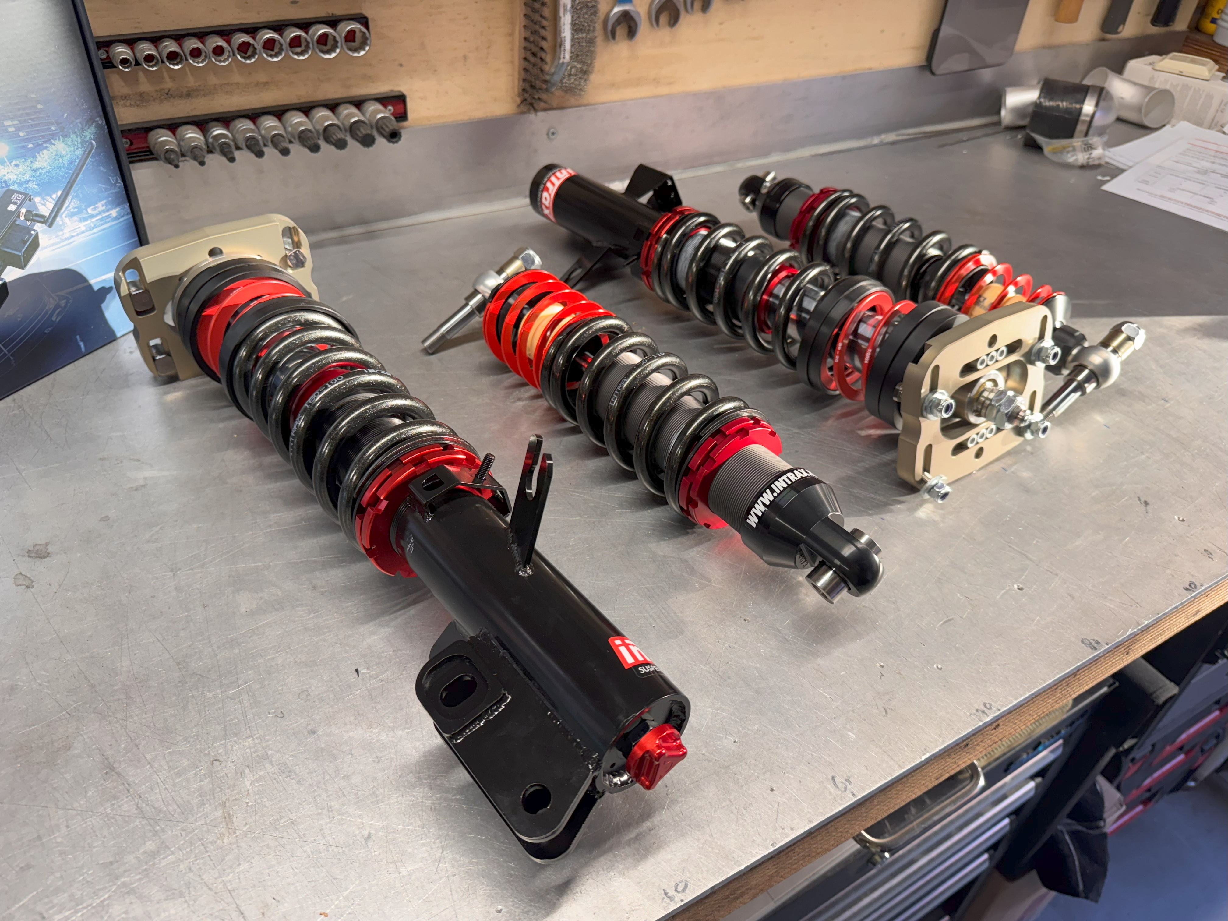

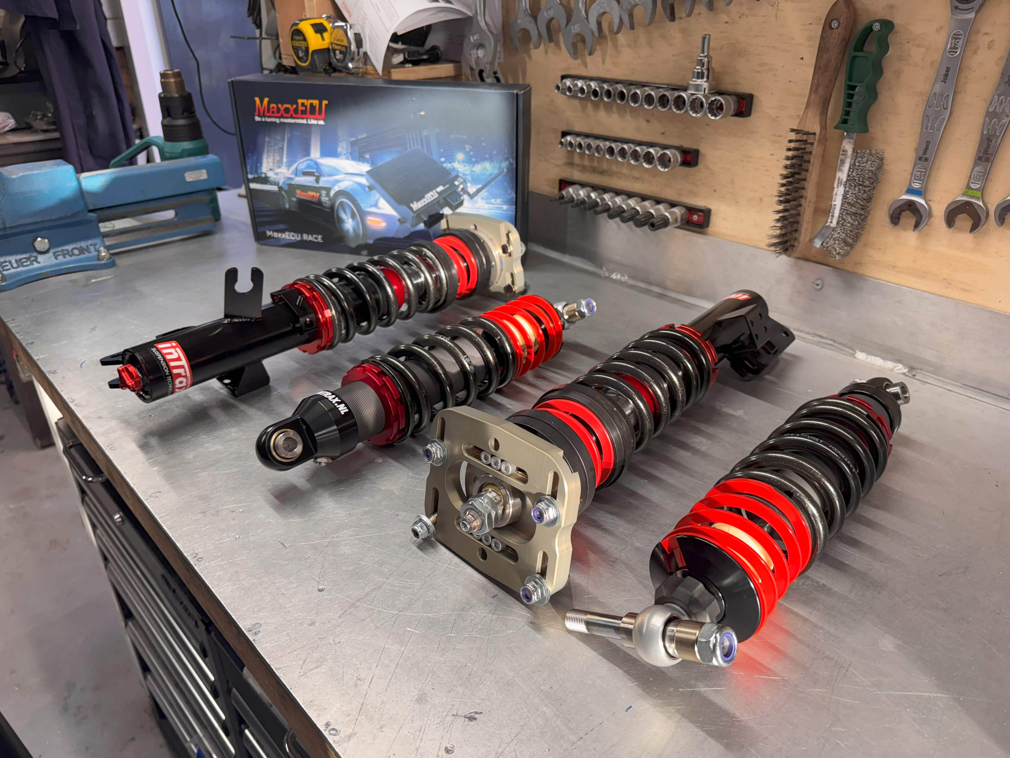

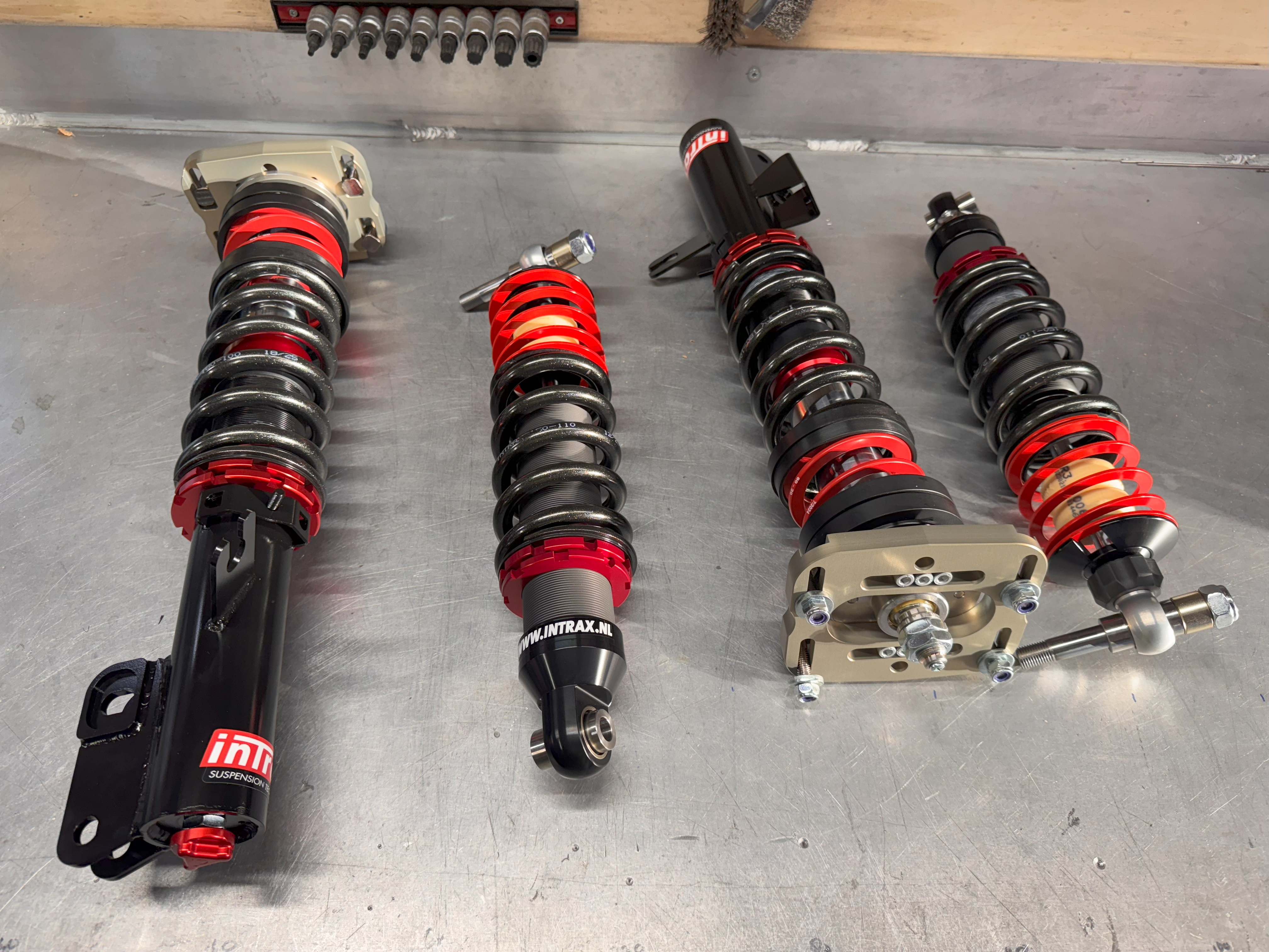

As I had a really nice set on my 944 from Intrax, the 1K2 stock version, I wanted to have something similar for my 968.
When the time came, I reached out to Donald from Intrax Suspension Technology (https://www.intraxracing.nl/) who hooked me up with the same set but now with a discount! :)
But while talking to them, we discovered that they were in need of making motorsport cabling for their EMC system.
The EMC system is the Electronic Magnetic Control system, that allows you to change the stiffness of the shocks electronically from inside the car while driving.
Now of course, I had my set changed to that too, but now this is where it gets interested.

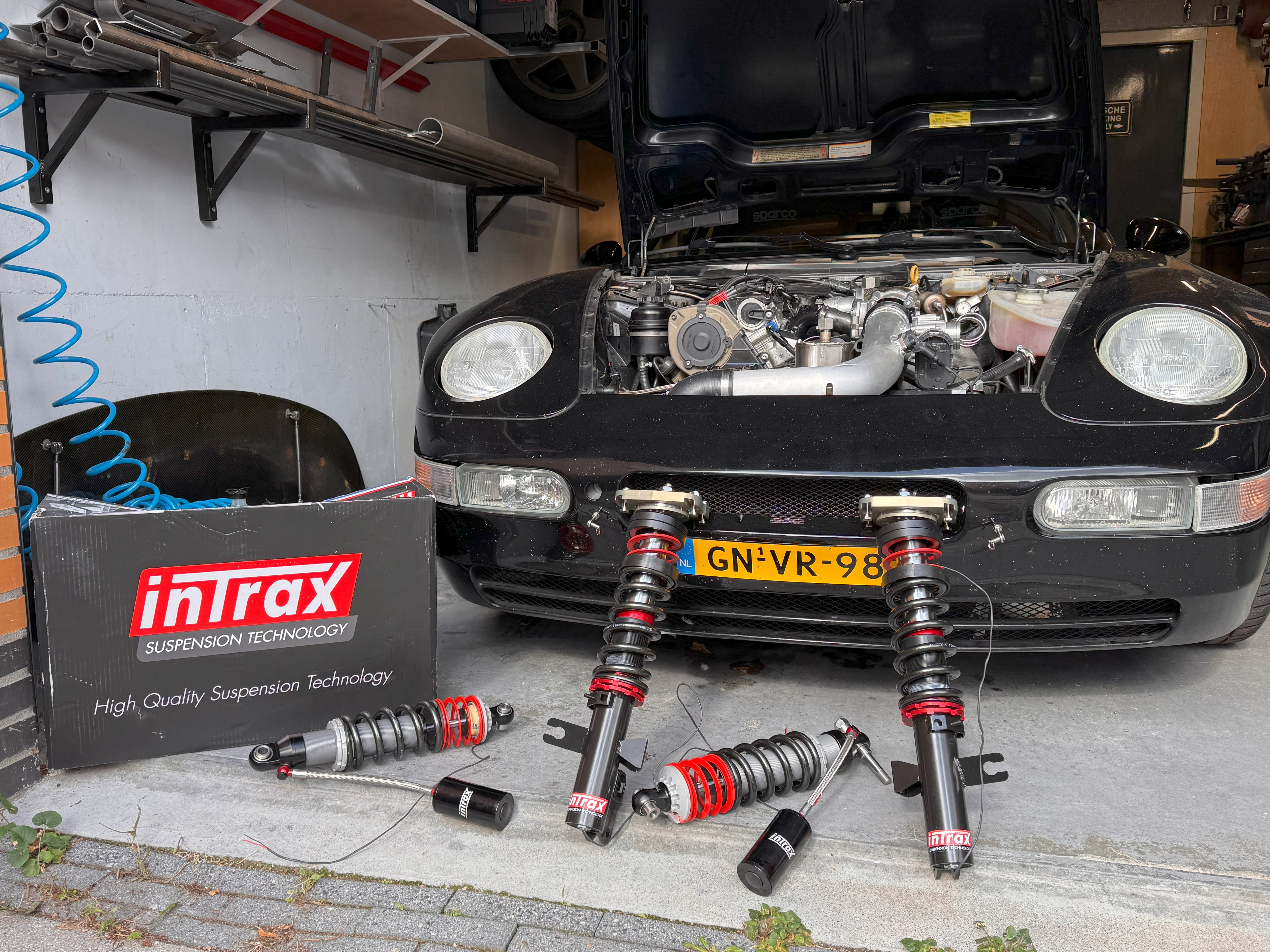

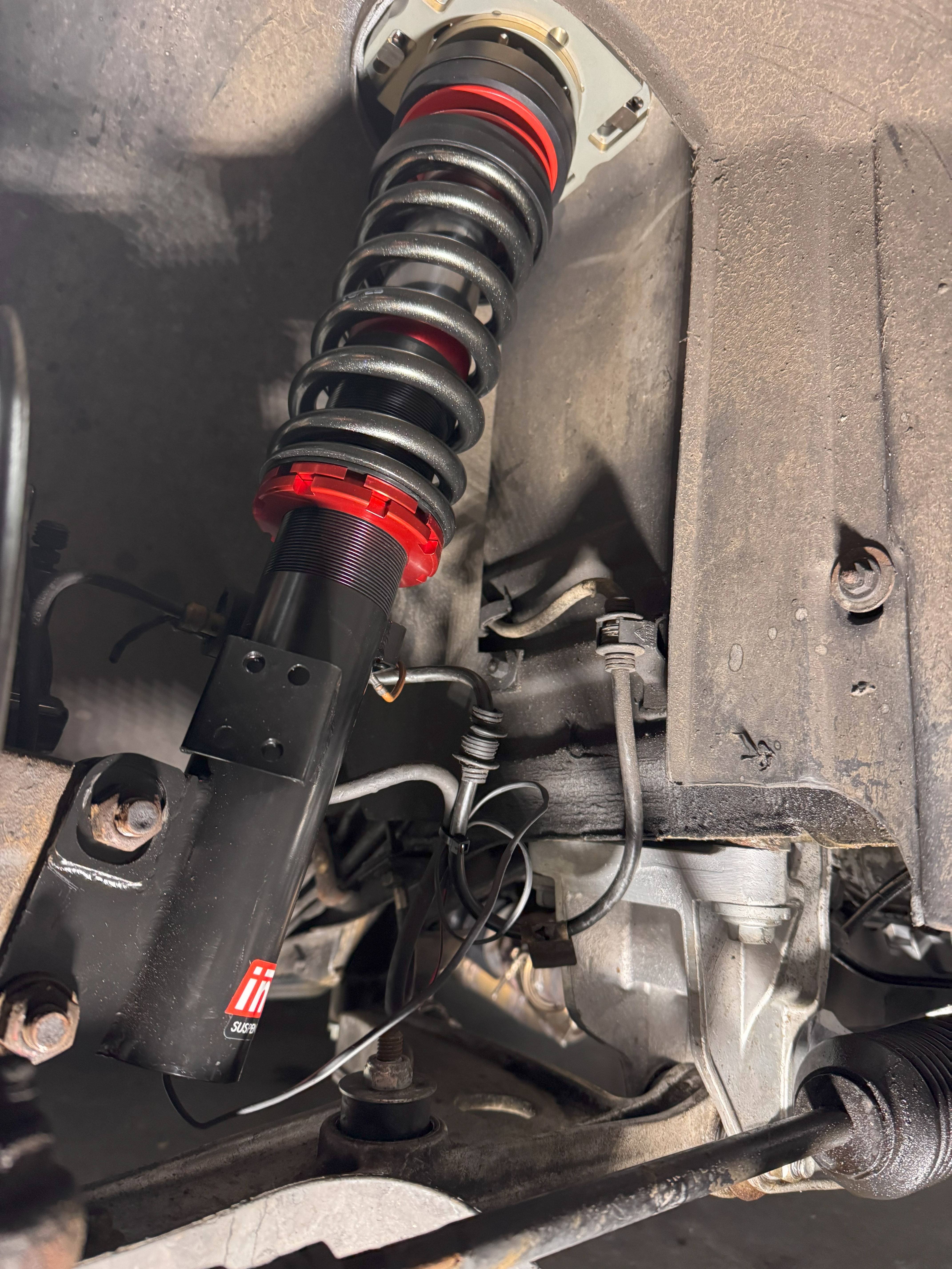

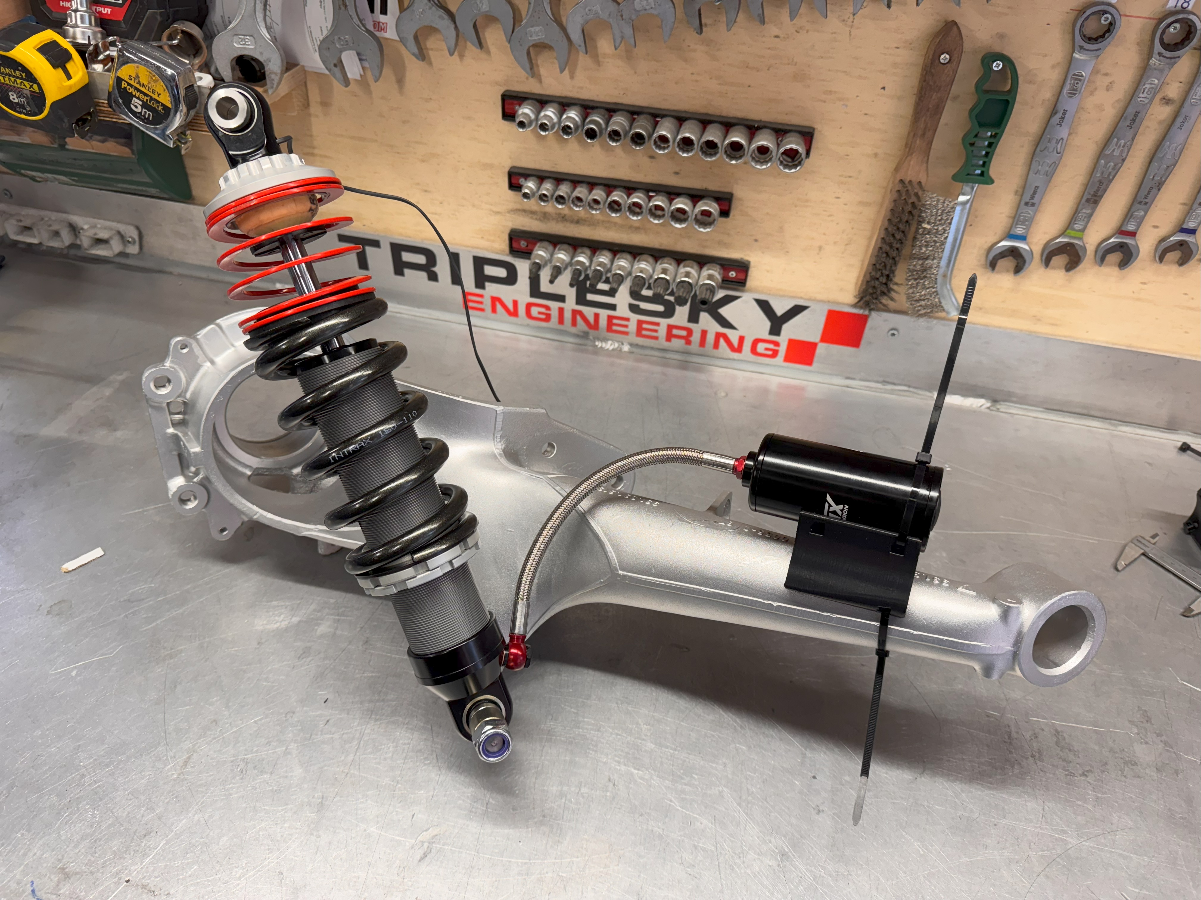

Update on this:
Picked up my set last Friday from Intrax and started with the installation.
Front shocks are mounted, rears are a bit more difficult as I need to remove the full rear axle..

Front shocks are installed, waiting for some parts for my Kokeln rear axle and some stuff that is being galvanized.
I hope to have it installed next weekend!
