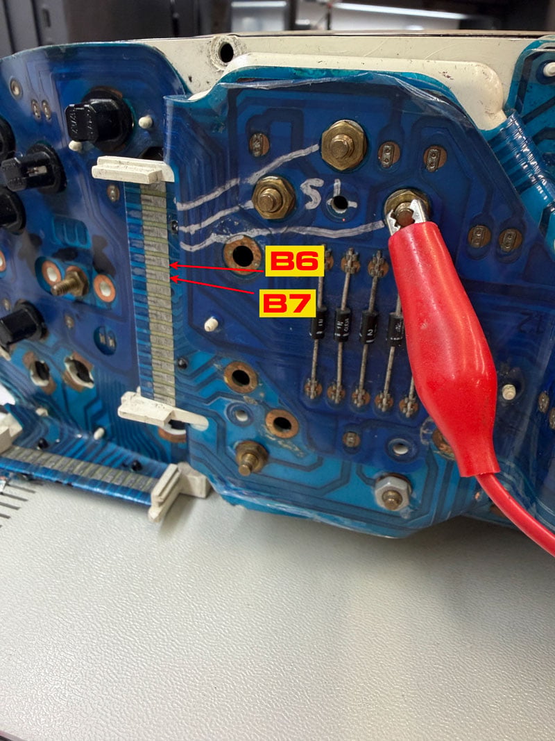

blade7 wrote: Wed May 27, 2026 3:48 pm I did the reflector foil refurb, and the backlighting has improved. Changed to LED's too, but still no indicator warning light, or the big red warning light above it :( . I'm wondering if the fault is in the cluster, or the wiring to it.
Ok, I got out the test cluster and can help you test if the main warning light is working or not. That light goes on when edge connector B4 has 12 volts and A13 has is grounded. Importantly for LED conversions, in the light socket for the main warning light, the lower copper pad carries 12 volts and the upper pad carries the ground. There are a number of diodes in the circuit that make checking continuity with a multimeter a challenge, so it's easiest to power it up and see if the light goes on. If not, the LED is getting the wrong polarity, the LED doesn't work, or there's something wrong in the flexible printed circuit board. If it does light up, then your problem is most likely not in the cluster, but rather the signals going to it....
This red clip has 12 volts from my adjustable power supply, but any 12 volt source is fine. I traced edge connector B4 directly to that copper post so just used that post since the clip holds better there.
Then put ground on edge connector A13 (behind the fuel gauge) -- careful not to short to the other fingers.
With 12v and Ground applied as shown, the warning light 'should' pop right on.

In the cluster, the turn signal / flasher light bulb is powered by pins B6 and B7. B7 is the lower pad on the bulb socket and appears to be positive only when activated by the relay (so LED positive side down). At first I thought the circuit flipped polarity as the lights flashed, but I don't think that's the case. The circuit is still funky though, with the B7 supplying 12v from the relay but the ground being supplied through the blinker bulbs when they are not on. LEDs may act oddly as a result. If in doubt, try a regular bulb.
After scratching my head over the schematics, I convinced myself that the cluster light could not be on when the blinkers are on, so it dawned on me they must alternate. Sure enough, the cluster light and outside lights flip flop -- the interior indicator can only light up when the outside lights are off. Here's a video of theory in action.

Thanks again, I'll try a known good standard bulb. Is it just a coincidence those 2 bulbs next to each other aren't working ,or do they have something in common?
#26
Posts: 8935
Has thanked: 932 times
Been thanked: 3996 times
blade7 wrote: Fri May 29, 2026 2:29 pm Thanks again, I'll try a known good standard bulb. Is it just a coincidence those 2 bulbs next to each other aren't working ,or do they have something in common?
The traces are close together on the flexible circuit board, so if part of the board is damaged, maybe it took out both... Or the edge connector could be damaged. Does the high beam light work? That's the closest other bulb on that edge connector. The flasher bulb has a very separate and discrete circuit in the cluster -- b6 and b7 go straight to the bulb socket, so it's not like it is electronically inter-connected with the warning light bulb in the cluster. I suppose there could be some interaction downstream in the chassis wiring, but that doesn't seem likely to me.
