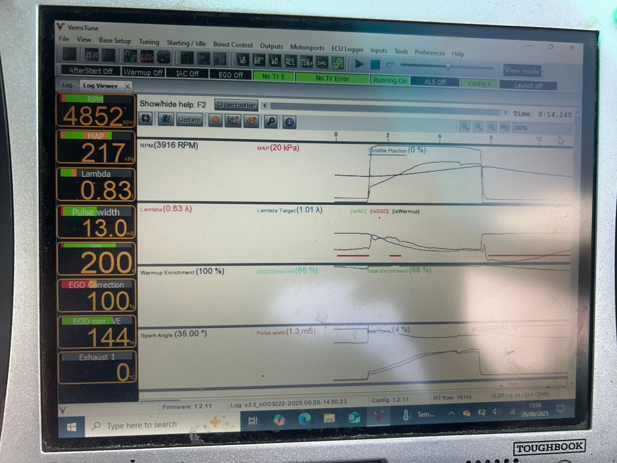

So latest update the boost leak appears to be fixed we have done a couple of street pulls I’ll show wider below any thoughts from the limited data on the video before we get back on the dyno

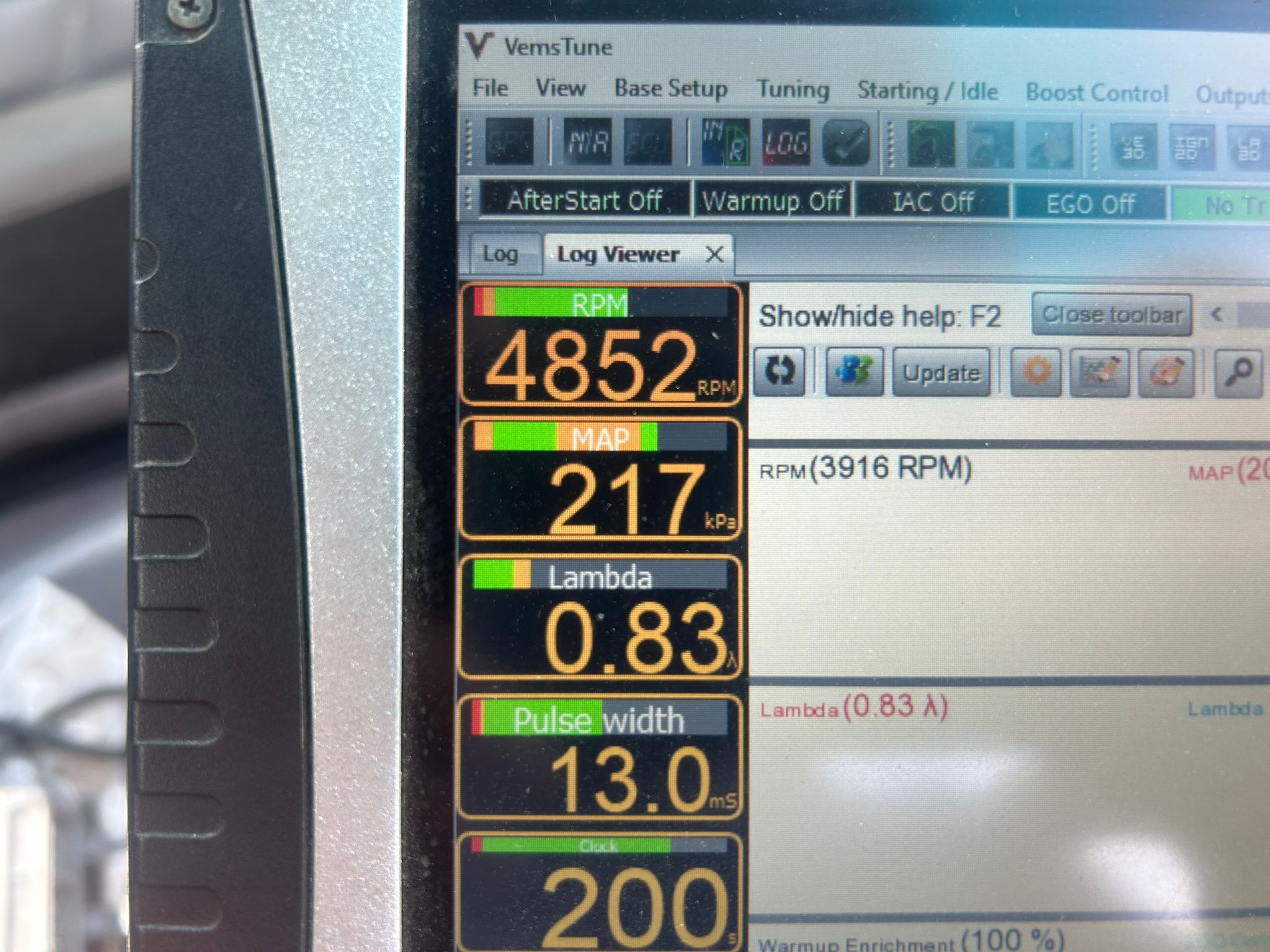

In that screenshot, which appears to be a snapshot in time during a pull, AFRs seem ok, looks around low 12's (lambda 0.83), boost approx 31psi (217 kpa), but I am not sure what you are asking for feedback on with those screenshots.
What might be concerning is that Im also seeing your target lambda at 1.01 which is about stoic (14.7 AFR), and your EGO correction appears to be trying to pull fuel (88% enrichment), which tells me your target lambda/afr table may not be configured right and that is why EGO is trying to pull fuel in order to hit that 1.01 lambda target. That would be way too lean for running boost and should be corrected since EGO correction will be trying to constantly lean your mixture. 14.7/stoic is ok at partial throttle/cruising (ie cruising at highways speeds) but obviously under load you want more fuel or bad things happen. You may want to look at your target lambda/AFR table and make sure the cells are all set to the correct target based on load/rpm - but maybe I am not reading your screenshot correctly.
I am more familiar with Megasquirt/MegaLogViewer so I am not familar with the VEMS logger interface and how to fully interpret what you shared in the screenshots.
Sharing your target AFR/lambda, VE and Ignition timing tables in a screenshot would be helpful and could try to review those, if desired.

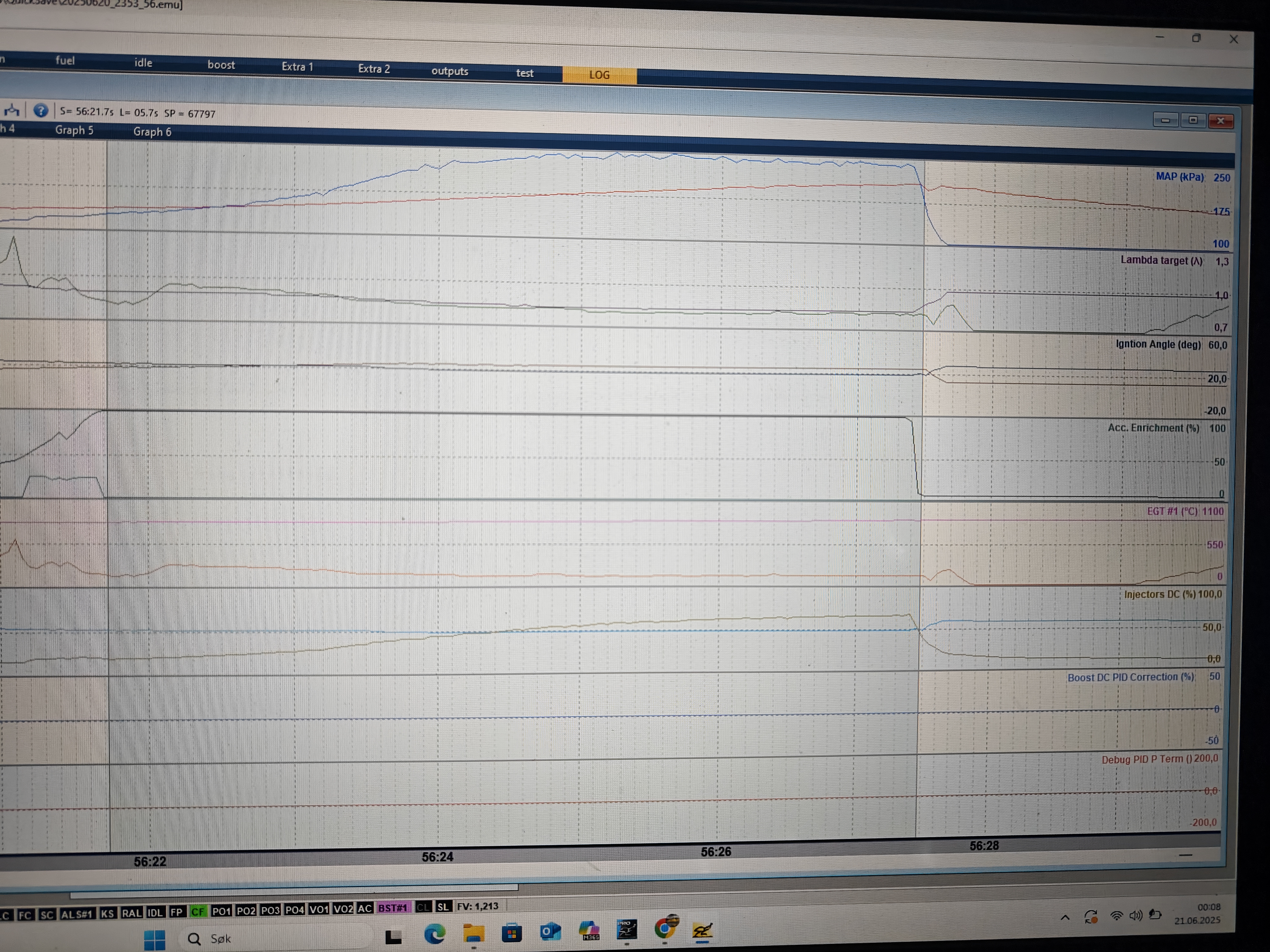

You need to figure out the enrichment.
How does your VE tables / ignition look like?
Here is a screenshot of my log.
11.8 af / 0.83 lamda is a bit rich but safe.
How are your EGT?
