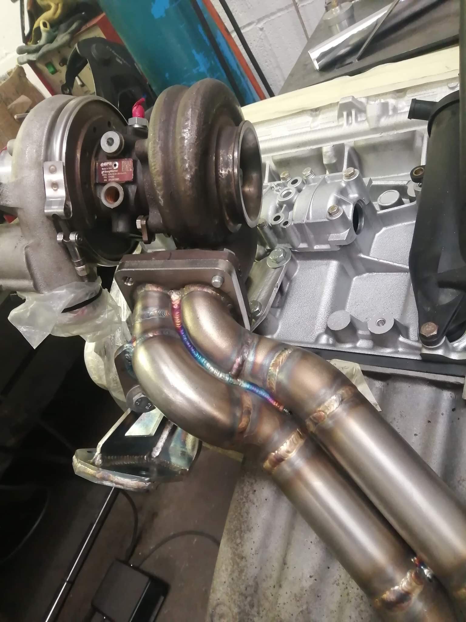

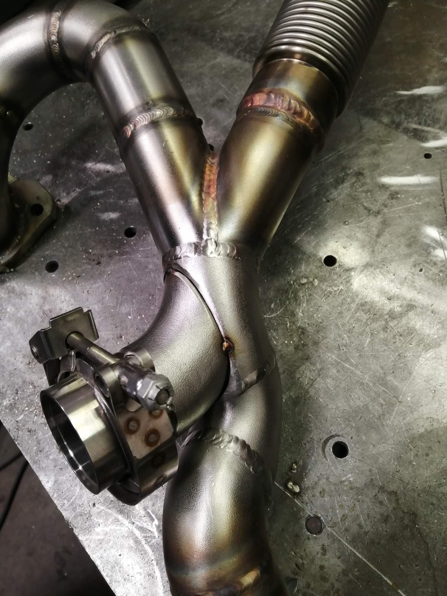

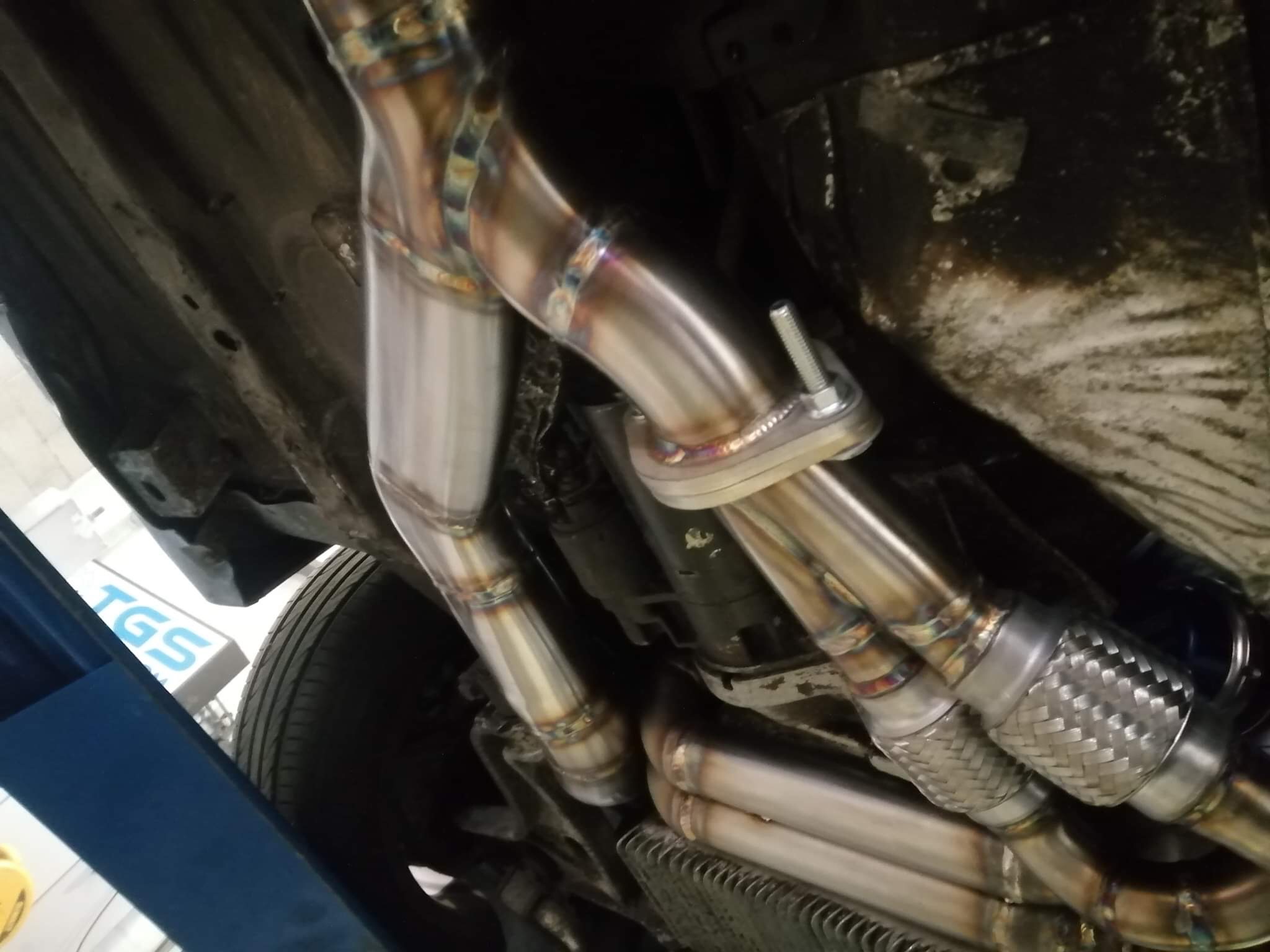

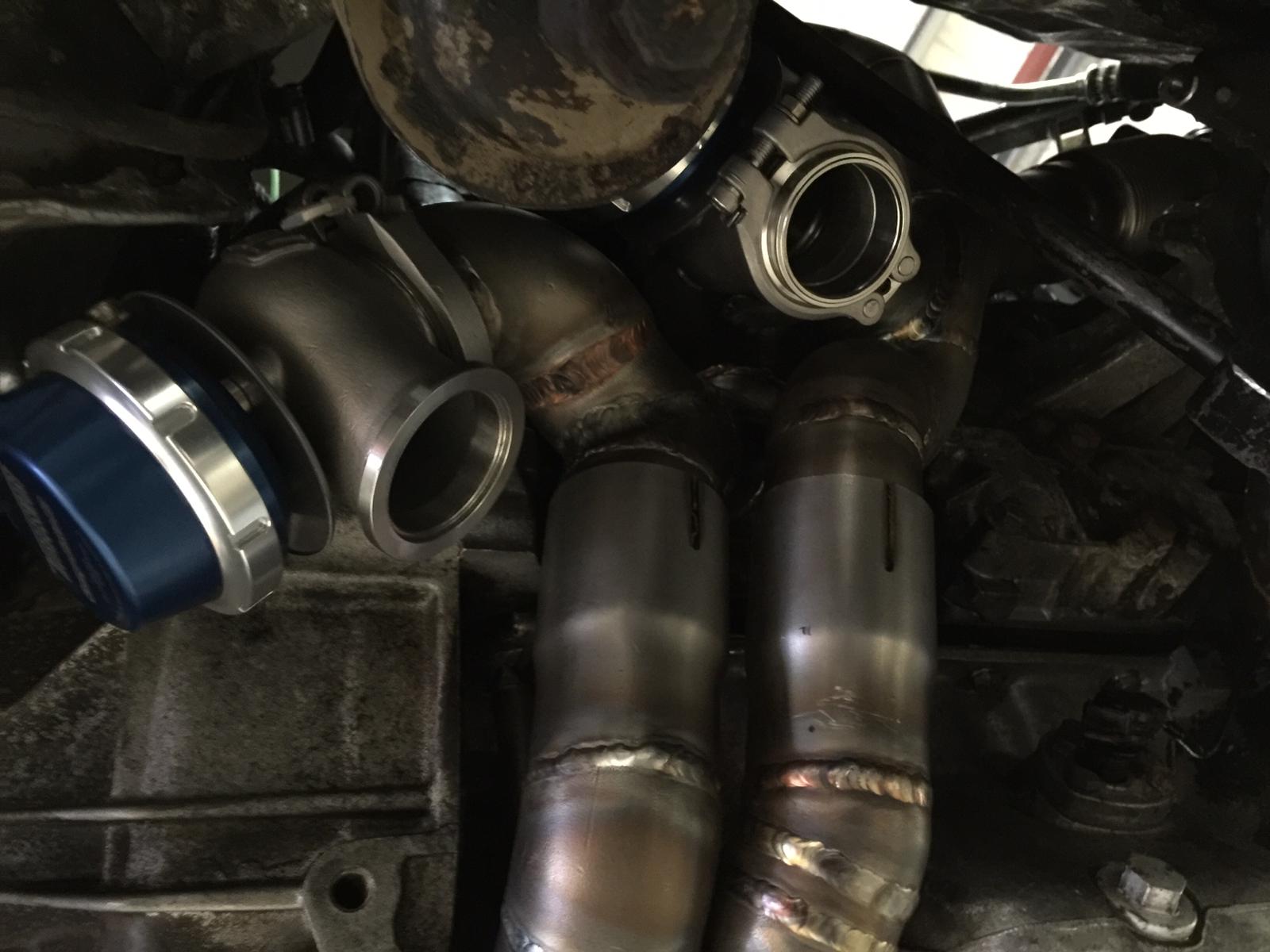

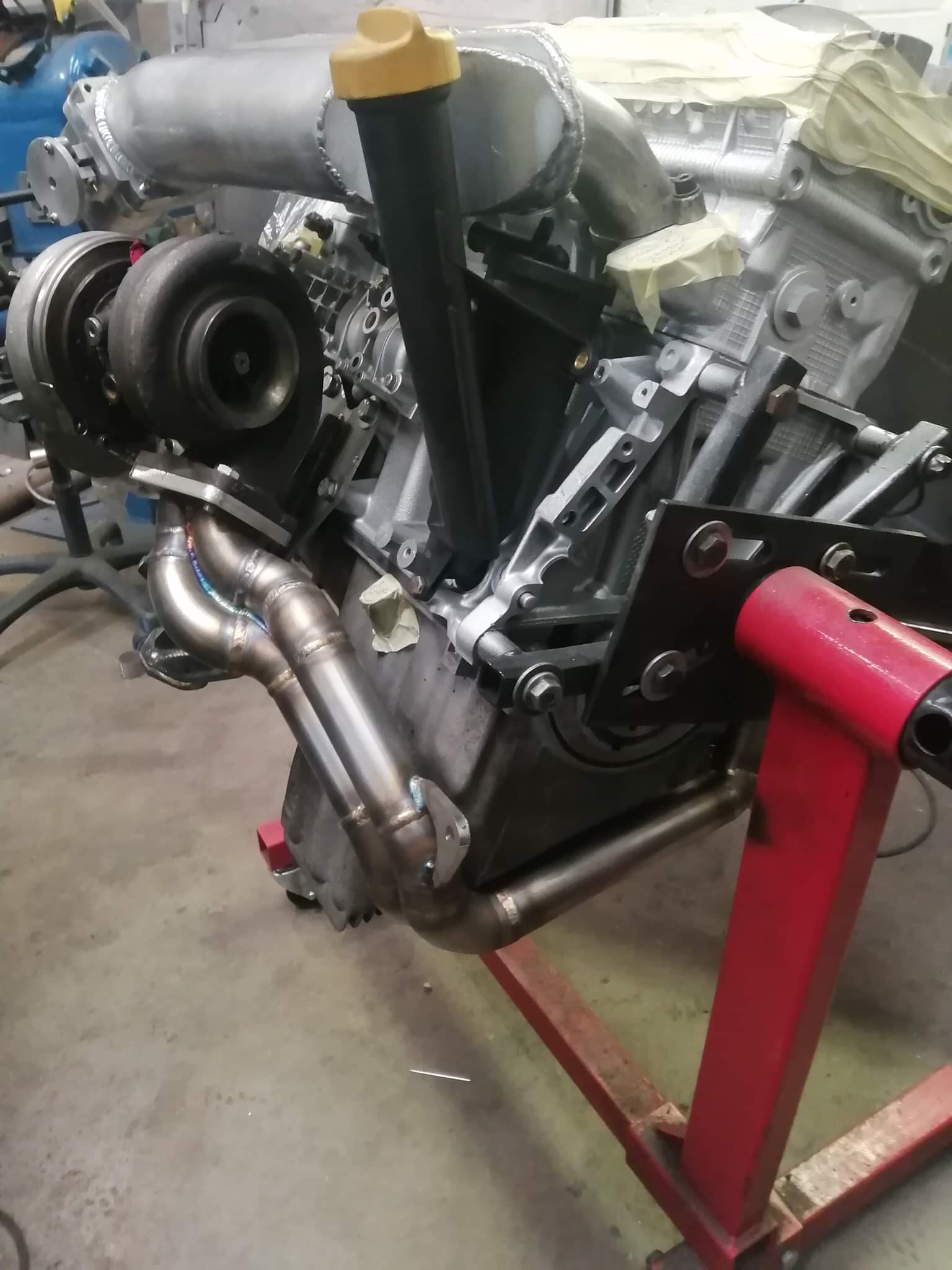

What header/crossover/wastegate setup are you running? I would have though you'd be over the limit of the stock setup with a turbo that big.
Rickuk1
Posts: 31
Joined: Wed Mar 19, 2025 8:28 am
Has thanked: 16 times
It’s all custom headers and exhaust and two turbo smart comp gates
