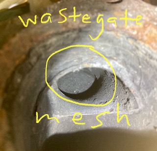

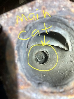

This is a duplicate post from over on RL, but thought I would also check here. I was just looking inside my factory exhaust pipe and noticed that the main catalytic converter was a straight through design (with mesh only around the outside), while the small wastegate pipe had a "mesh" design similar to current cats that I see online. The small pipe seen in the back of the first picture is the other side (front edge) of the catalytic converter section.
Am I missing a portion of the mesh in the main cat or were they designed this way, with mesh only around the outside of the catalytic section?

I have my old factory converter somewhere and can take a look. Can you see that just looking down the flange pipes, or did you have to snake some kind of borescope camera down there? Sure seems like a hole down the center of the mesh would defeat the purpose, but I'm no emissions engineer....

Hi Tom, you only need to shine a flashlight down through from the exhaust side. No Borescope needed. I agree, so I'm thinking my mesh blew out at some point.

My apologies, I couldn't find my old cat and now vaguely remember giving it away when I moved a few years ago. I'd bet a nickel someone smashed out the center with a pipe/dowel to make yours flow better -- someone who doesn't live in California that is.... ;)

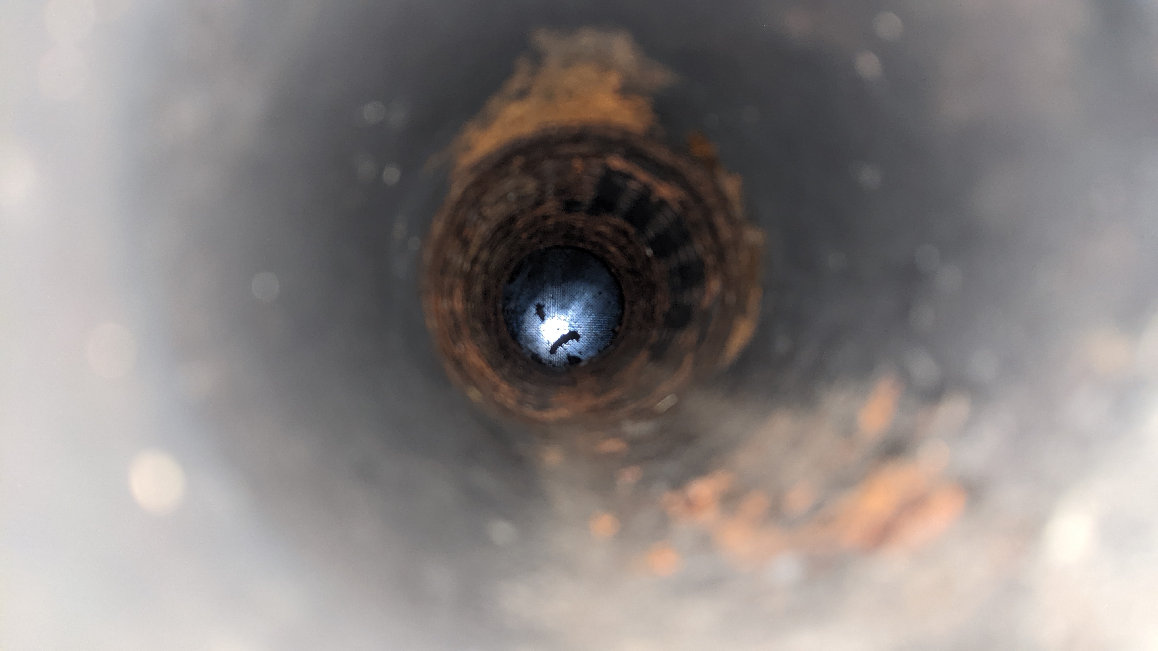

Thanks for the feedback. Painenneck's pic confirms I'm missing the screen/honeycomb bits. I've had the car since 2000 and know the previous owner going back to '91. Didn't know of the cat being hollowed out, but apparently it was.
