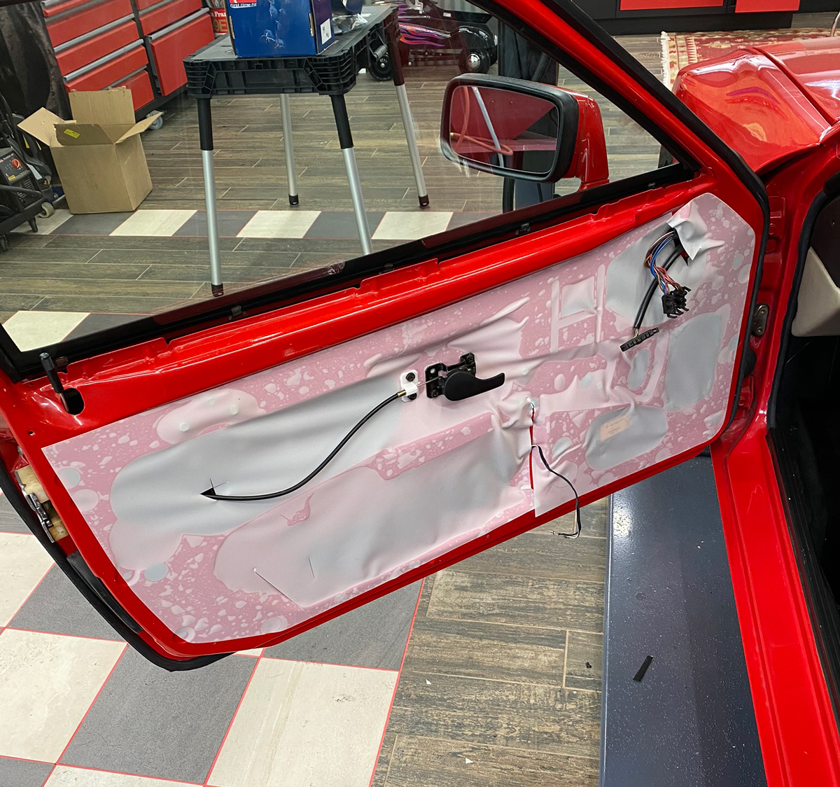

On my 944, the cardboard door cards were still in decent shape, thanks in no small part to the still intact plastic moisture barrier.
However, I went a step further and applied a "3M Scotchgard" waterproofing spray (green can) to the back side of each door card. It's designed for camping gear. I've used it on motorcycle denim pants for a degree of wet weather protection, and on motorcycle covers to restore a degree of rain protection.
It's not perfect nor actually waterproof. In conjunction with an intact plastic moisture barrier on the door however, it should help ensure the door cards last another 35 years. I did this with the rear interior panels as well.
As far as (re)adhering the moisture barrier, I used a common Elmer's glue stick. The kind kids use for construction paper projects or scrapbook projects. It is sticky but not super sticky. You can peel and reposition after application. It's not messy like the black butyl rubber stuff I've seen recommend on other forums. And you might already have some at home.

I know you posted this months ago. For the benefit of others who find this post in the future, I repaired similar damage around my door card clips, and the clips in rear interior panels too.Darwin wrote: Sat May 21, 2022 1:15 pm My issue right now is trying to repair the existing cardboard backing. I have some of the clips that have ripped the door card and I've been trying to think of ways to repair/restore functionality/integrity.
I used a high strength spray adhesive like "3M 77" to attach new strips or squares of thin cardboard to the damaged sections of the back side of the door cards, cutting holes and capturing clips as needed. Do this before any water proofing spray (since such sprays probably contain silicone which makes sticking stuff to it pretty impossible).
When I say thin cardboard, I mean like a cereal box. Anything corrugated would probably be too thick.
I don't seem to have any photos of this repair, unfortunately. Hopefully the description is helpful enough to give the next person finding this post a starting point in approaching their repair.
