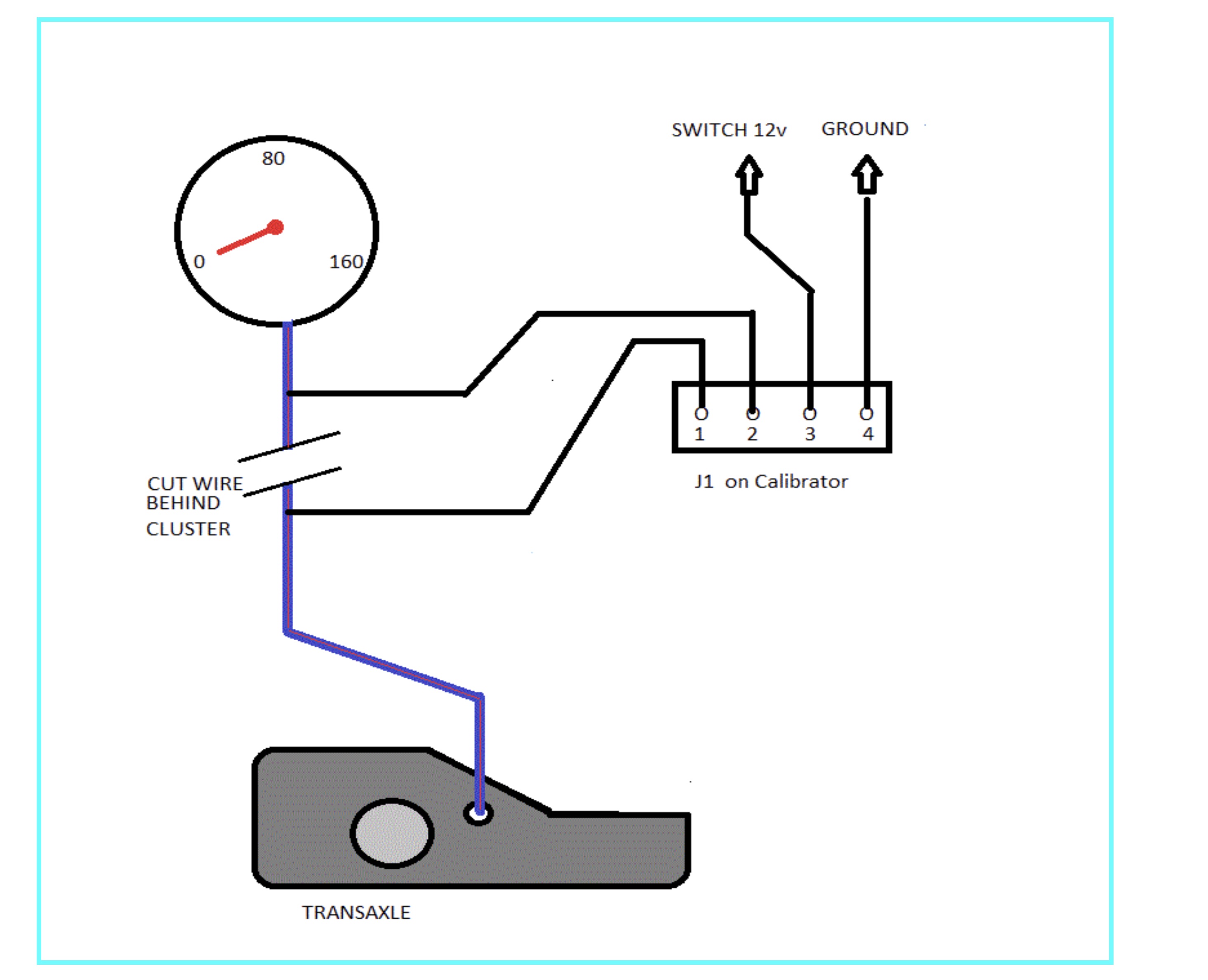

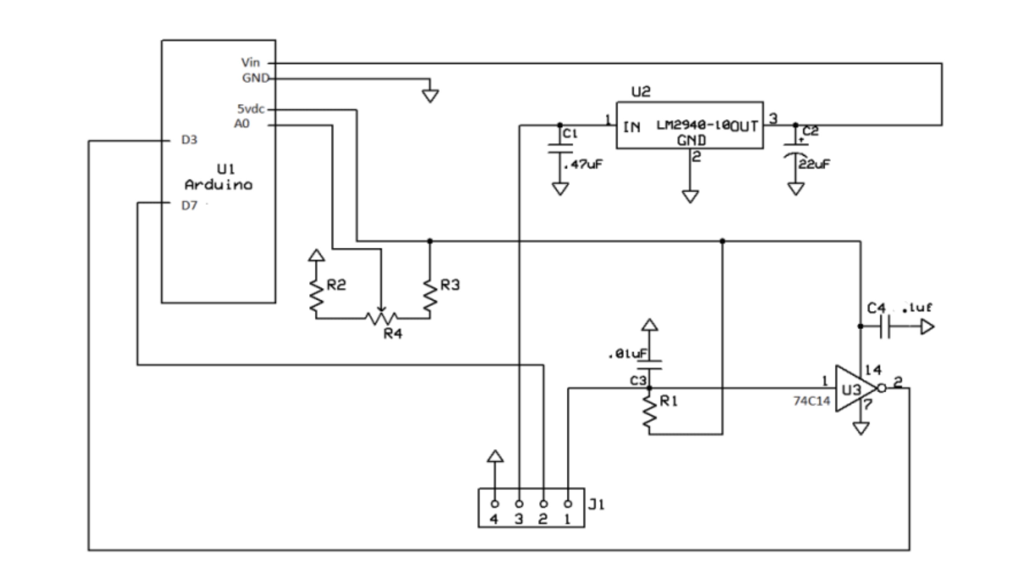

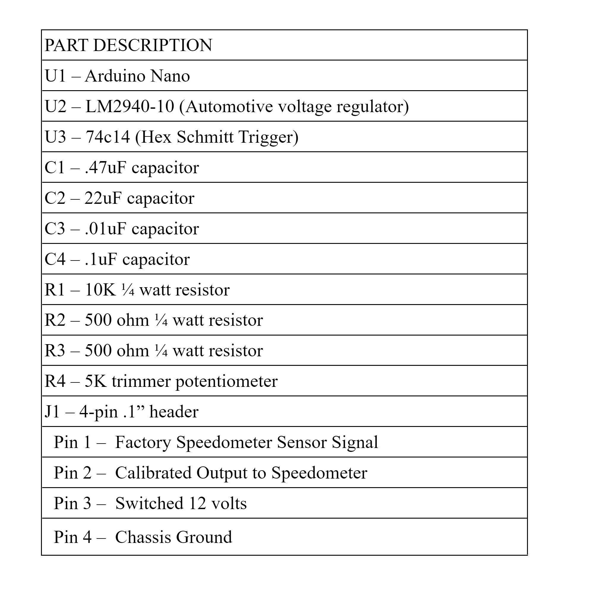

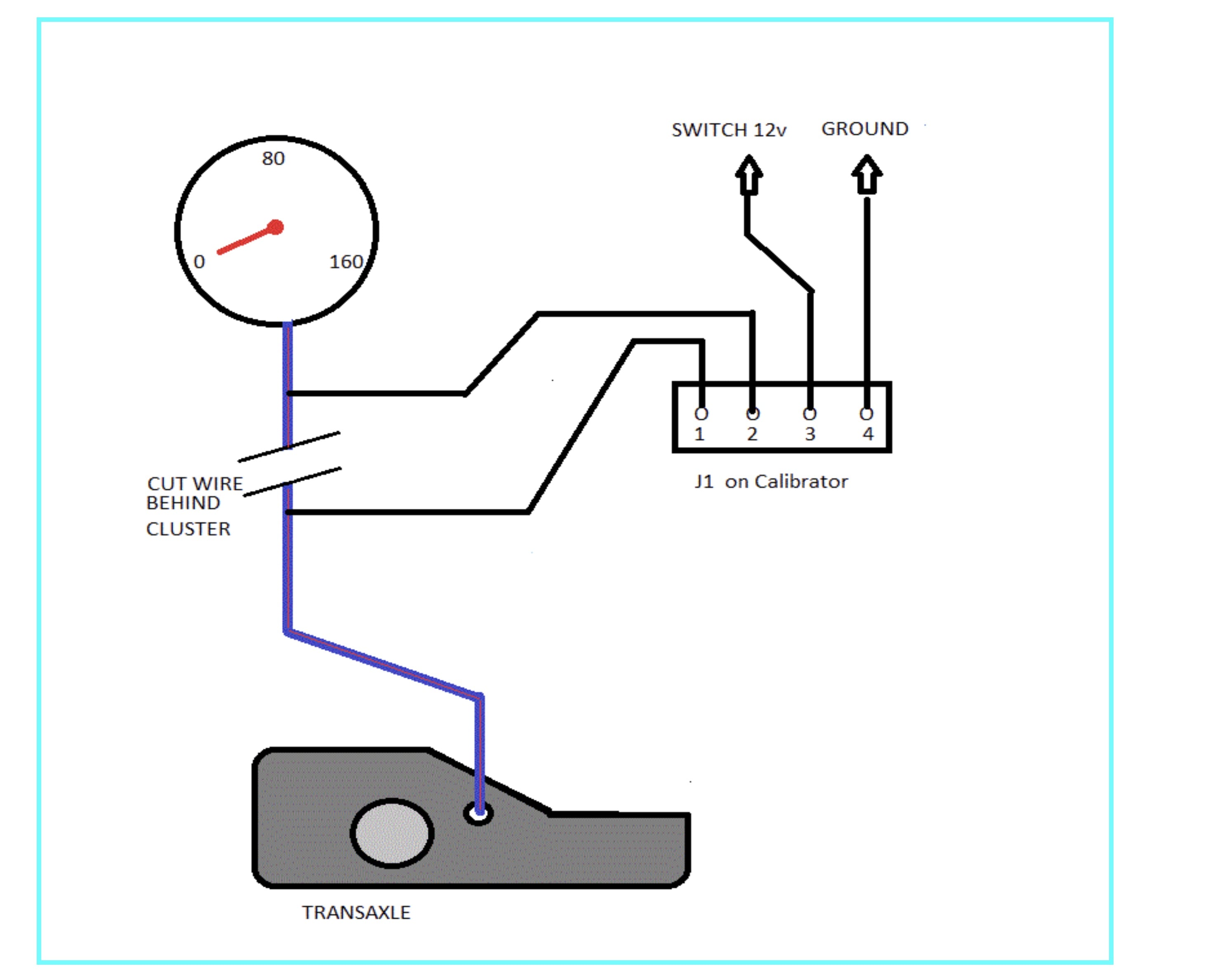

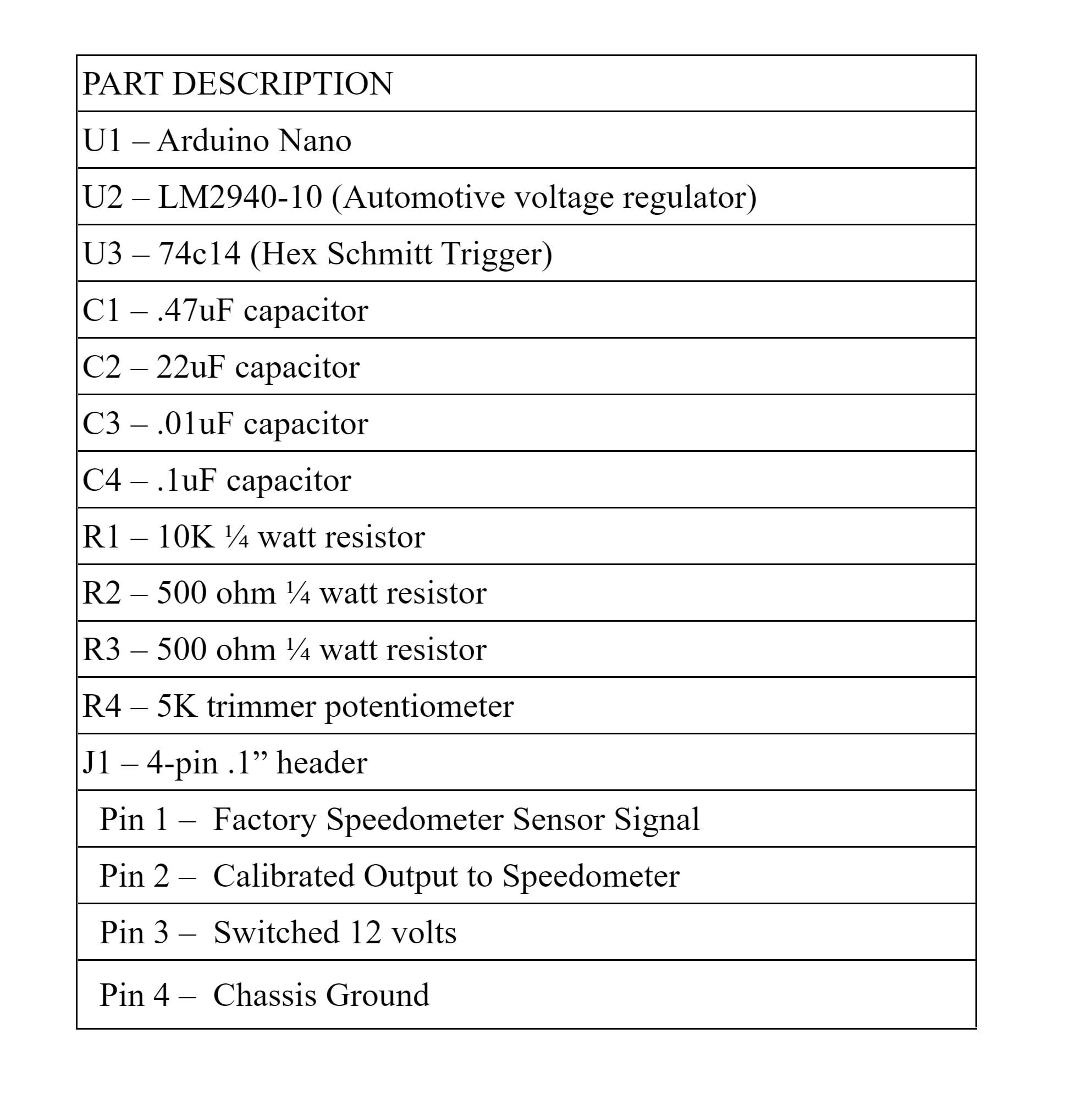

Next, here is a summary of how I made the very first speedometer calibrator, based on an Arduino Nano. The key breakthrough was adding the 74C14 "inverting Schmitt trigger" in the circuit, which filters out the electrical noise on the speedometer sensor calibrator. Without it, the Arduino interrupt pins are so fast that they interpret the noise as super fast ground pulses. With it, the Arduino picks up only the real pulses and gets a perfect reading. R2, R3, and R4 are the trim pot input signal, which the arduino reads to decide how much to speed up or slow down the modified speedometer output signal.
In order to install this circuit in the car, the factory harness wire carrying the speedometer sensor signal must be cut and routed into Pin 1 of the calibrator. Pin 2 of the calibrator then feeds the speedometer with the new pulse created by the Arduino. The sensor wire is the blue wire with red stripe in the middle edge connector on the back of the gauge cluster. Pull the gauge cluster out to gain access to the edge connector. Cut the blue/red wire on pin 14 of the middle edge connector and connect the sensor side of the cut wire to Pin 1 on the calibrator, and connect the speedometer side of the blue/red wire to Pin 2 on the calibrator.
And finally, here is the Arduino code I used to drive the hardware. It won't win any coding awards, and has remnants from pre-Schmitt-trigger filtering efforts, but it works and demonstrates the basic concept. It's difficult without additional hardware to untether output pins to simulate the un-connected state of the speedometer sensor, but as shown in the code below I found that the speedometer works just find toggling between ground and 5v (rather than ground and no connection). Whether the same is true for the cruise control computer, I do not know!
