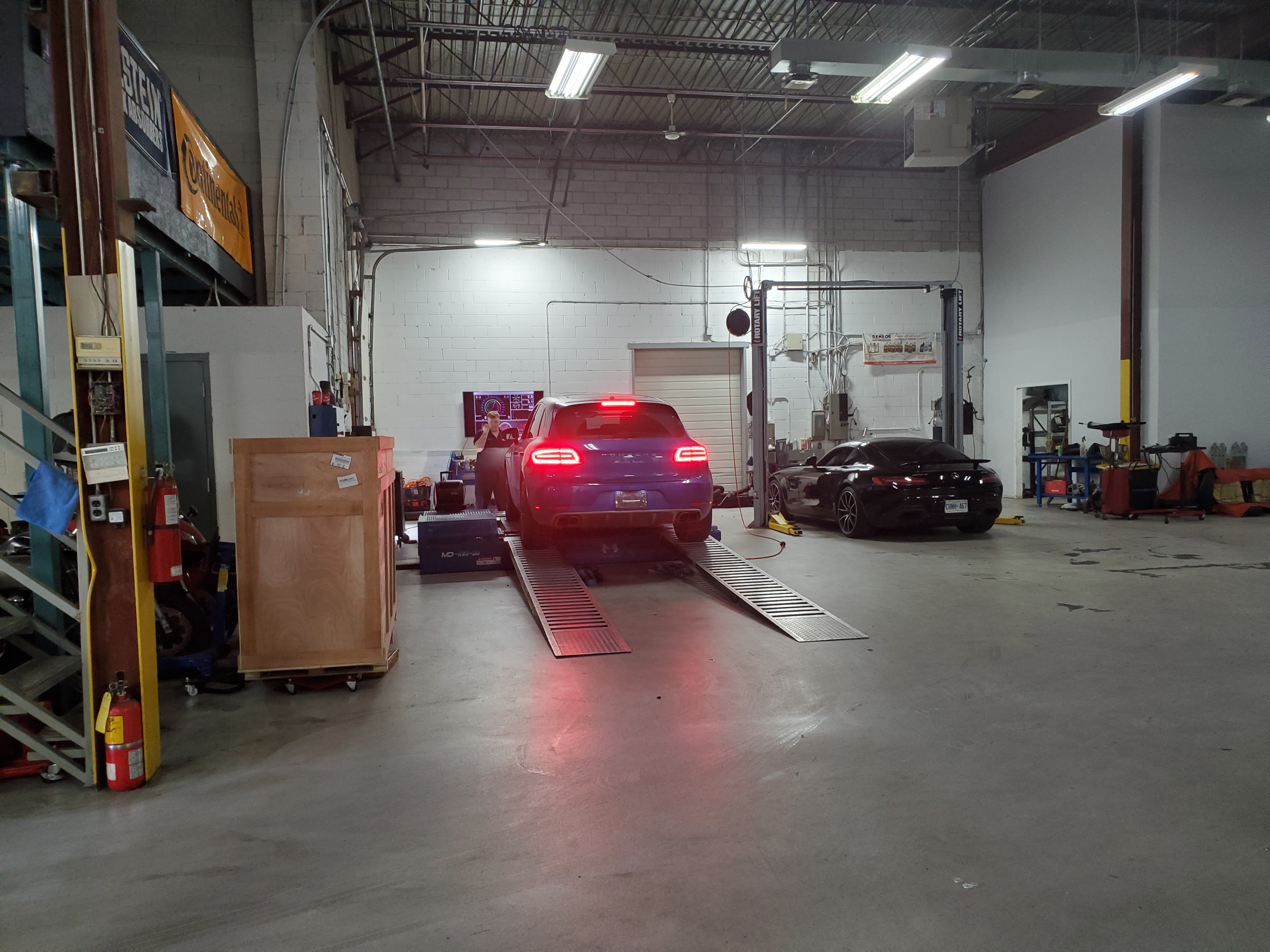

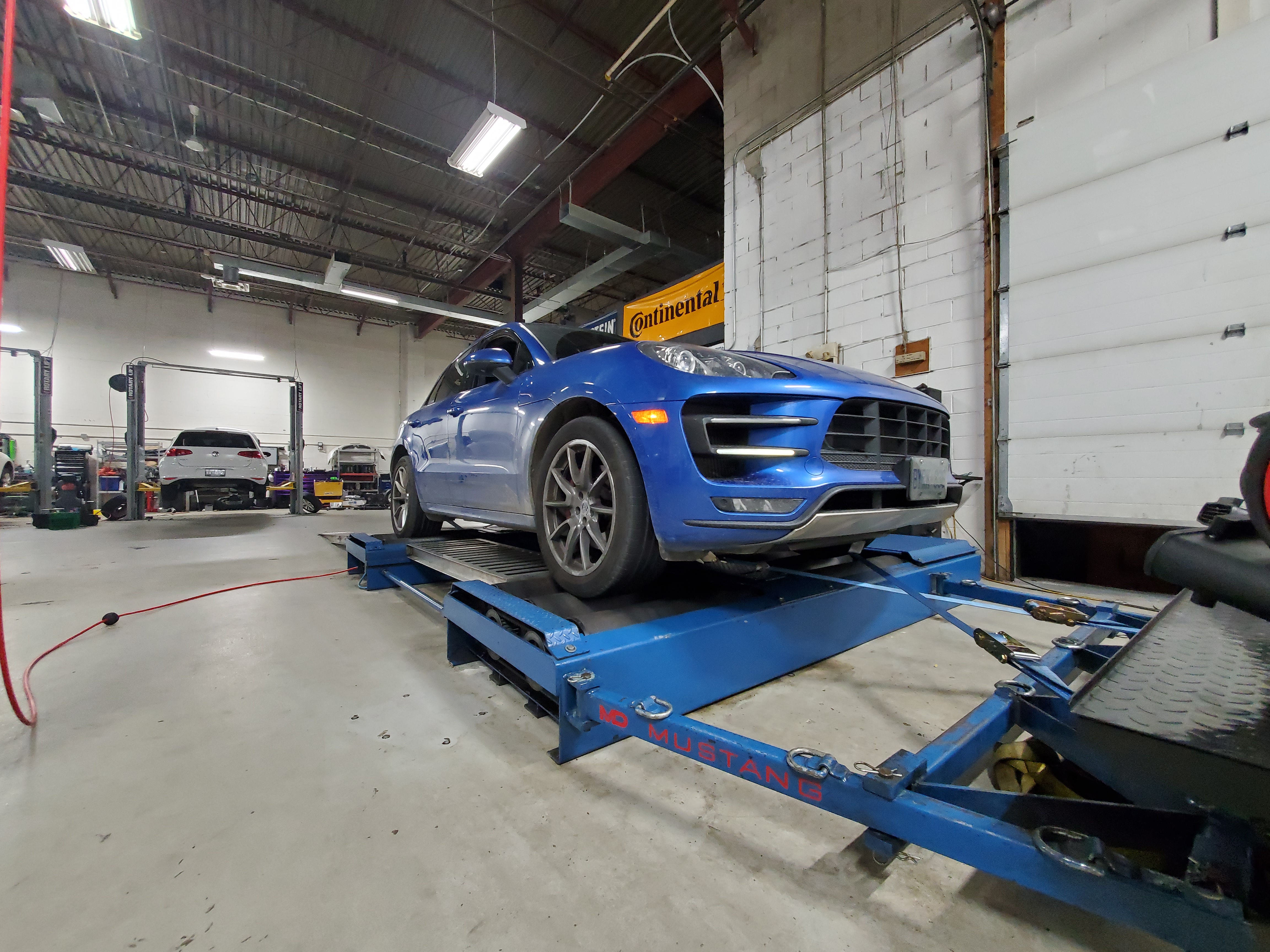

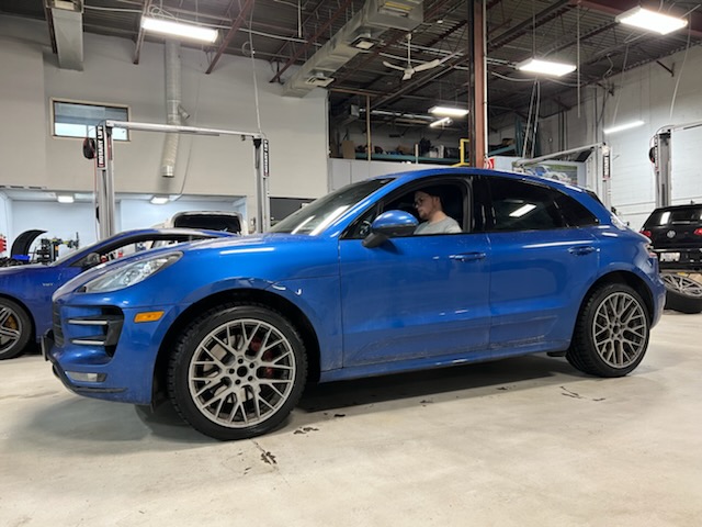

Took the car to Garage Auto Sports in Newmarket, Ontario. @GASBill and his crew have been taking care of my cars for the last 10 years.

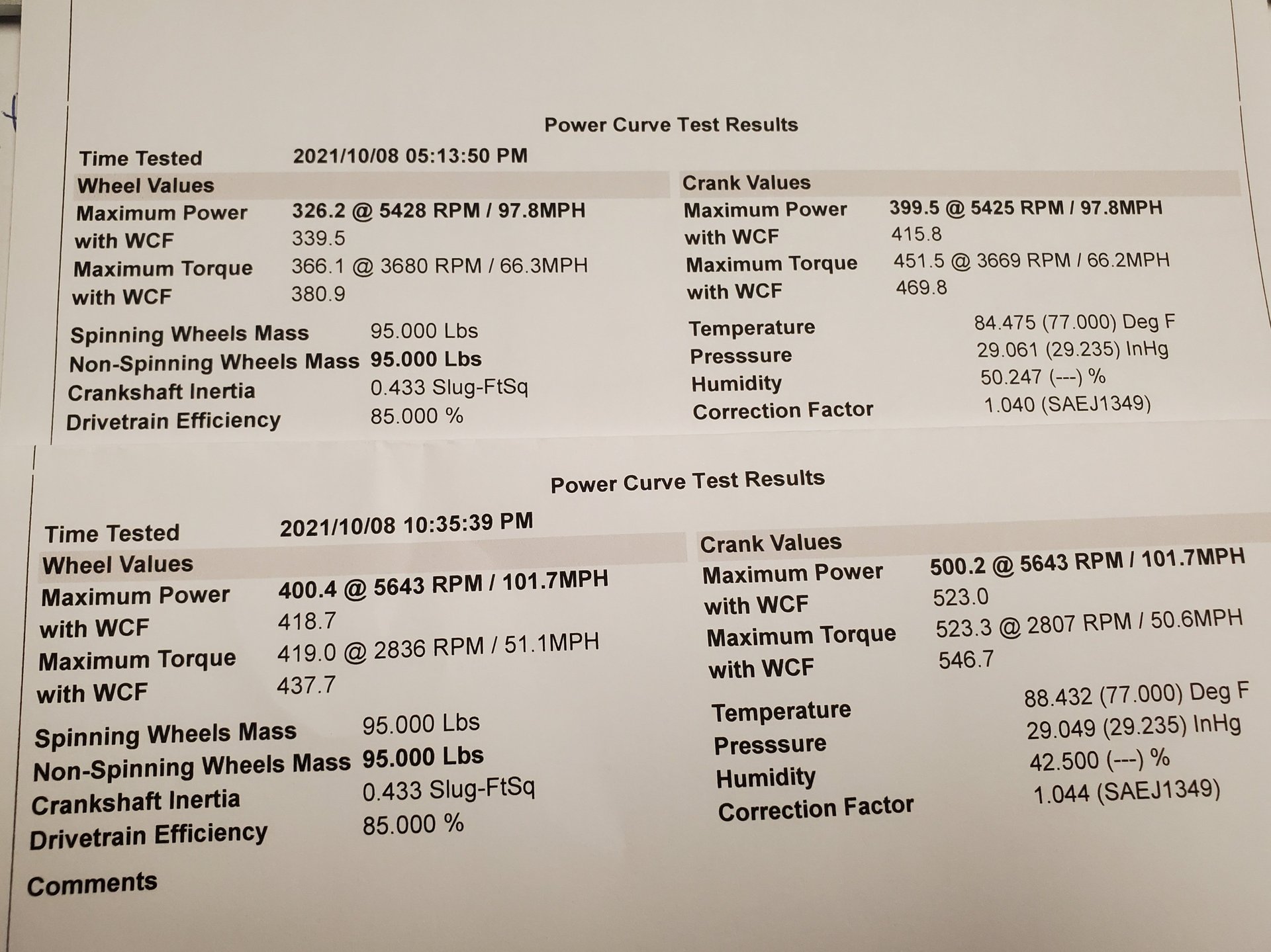

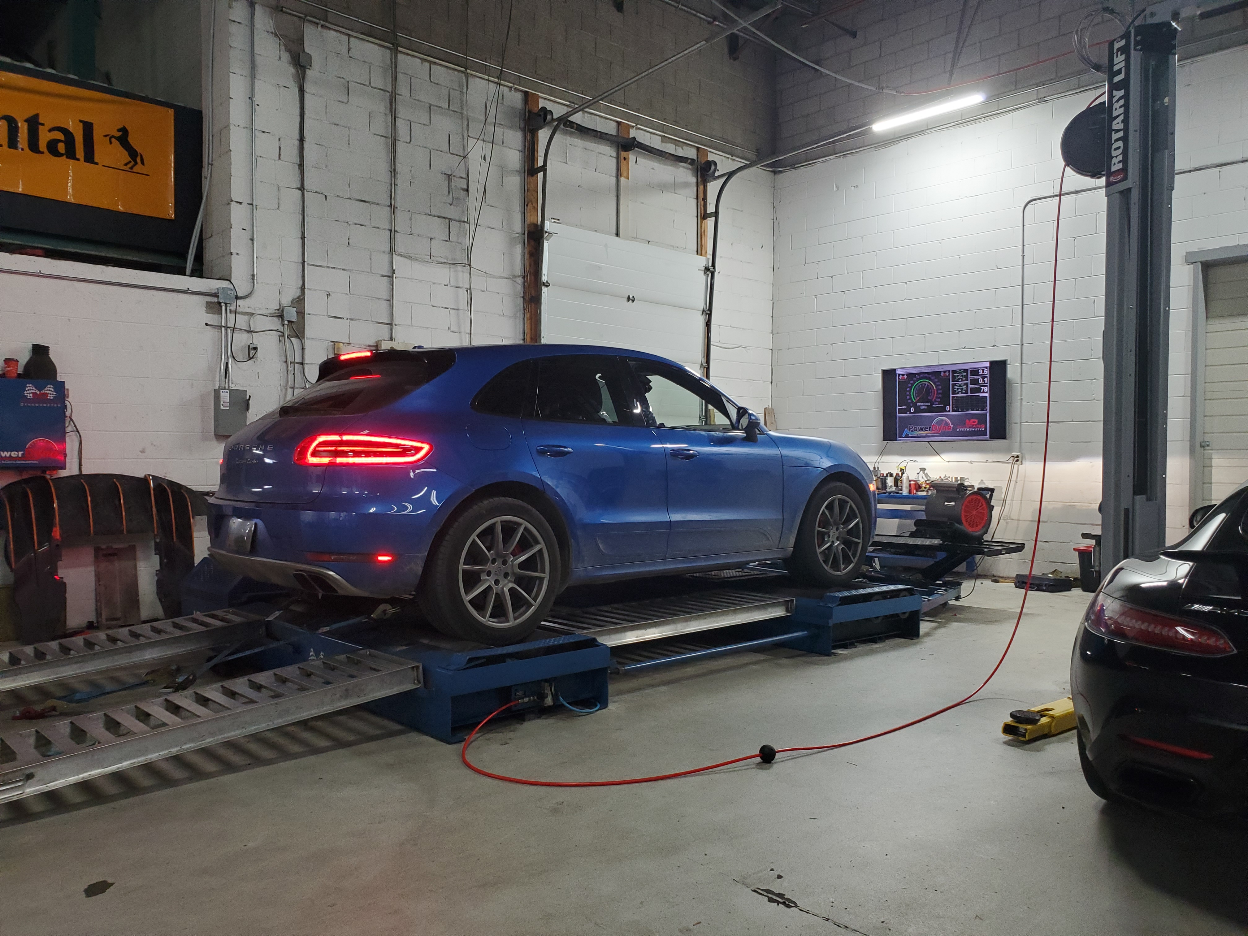

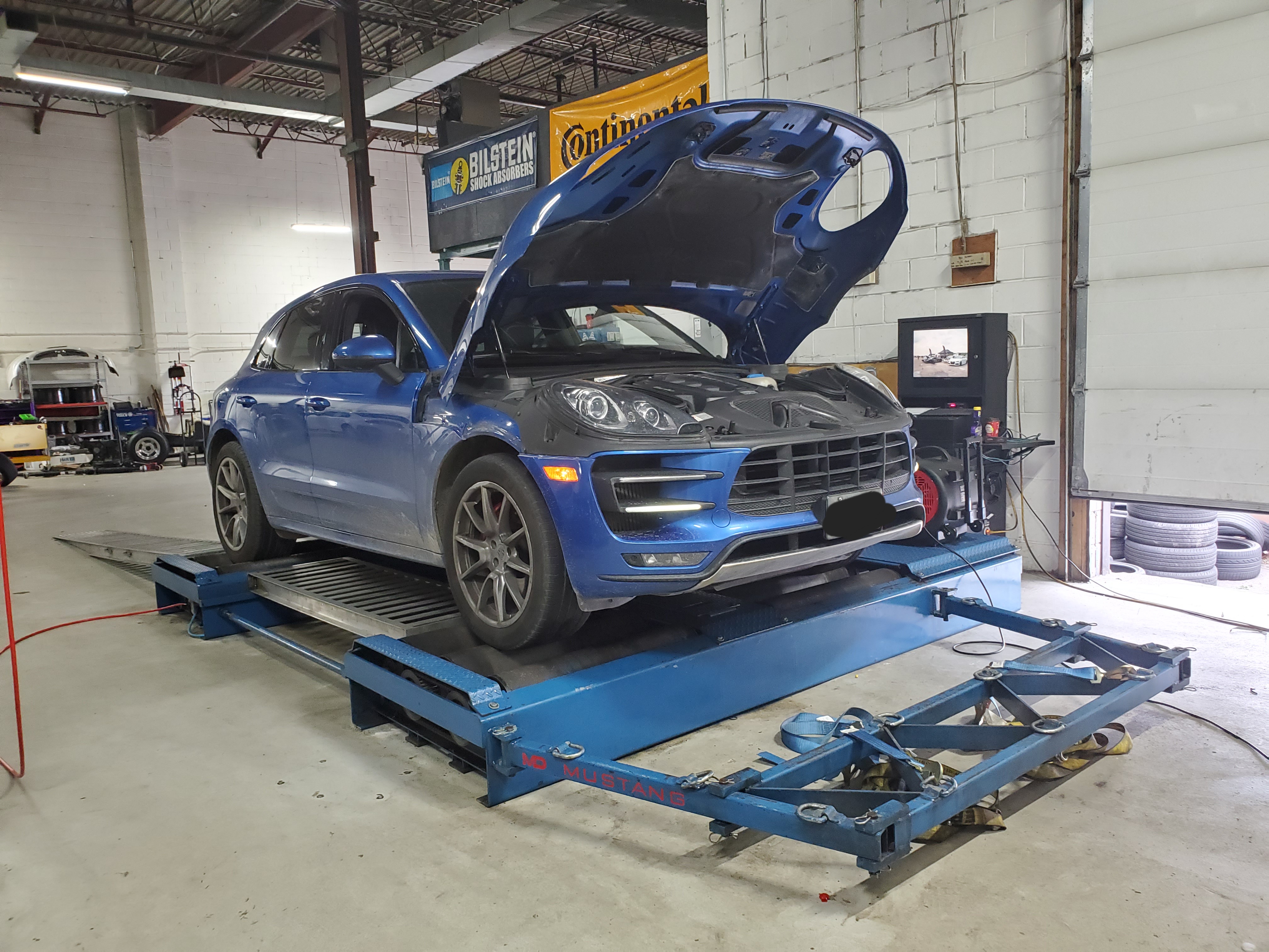

They have a 4WD Mustang dyno so naturally we had to get some baseline runs & add a stage 1 flash. I went with Bill's custom tune, he knows I'm not easy on my cars so he makes sure they can take the abuse.
Garage Auto Sports been tuning Euro cars since 2015 and Bill has been tuning personally for about 10 years
I am very pleased with the numbers we have achieved so far. All runs were done on Esso 93 octane.

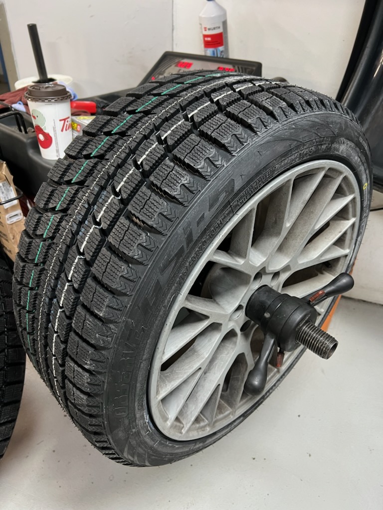

First Oil change at Garage Autosports included an engine flush and Ceratec treatment.

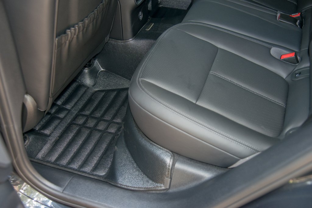

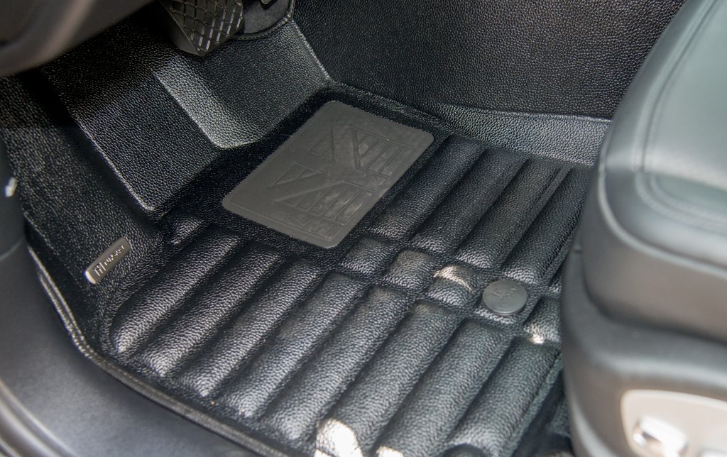

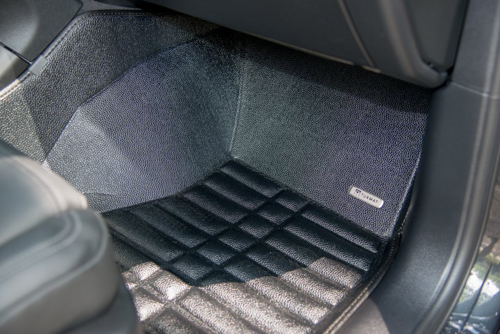

- Winter wheels and tires installed
Wheels are RS Spyder reps 20x10 with 275/40/20's Toyo GSI-5s all around.
I then installed tuxmat floor liners and a kurgo rear seat and door cover for the dogs.
Back seat cover is a Kurgo wander bench seat cover, 55" wide.

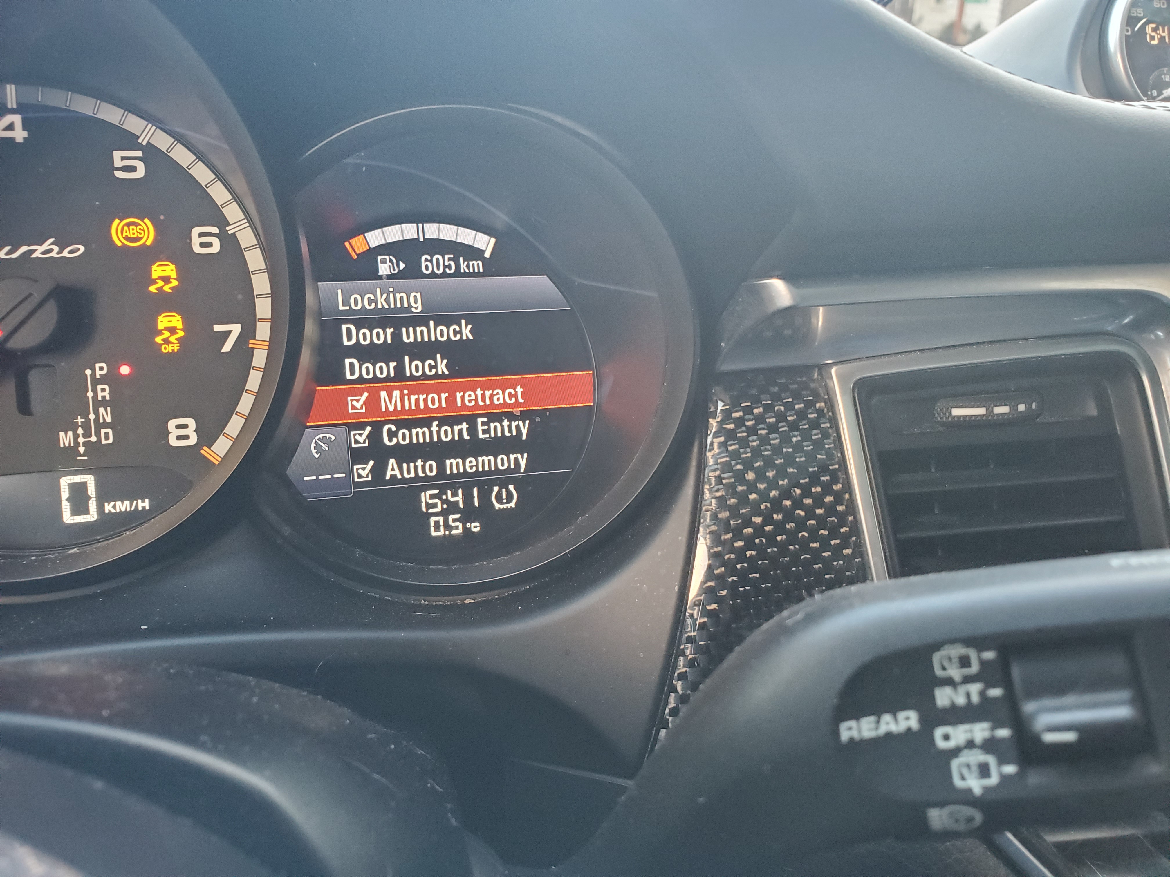

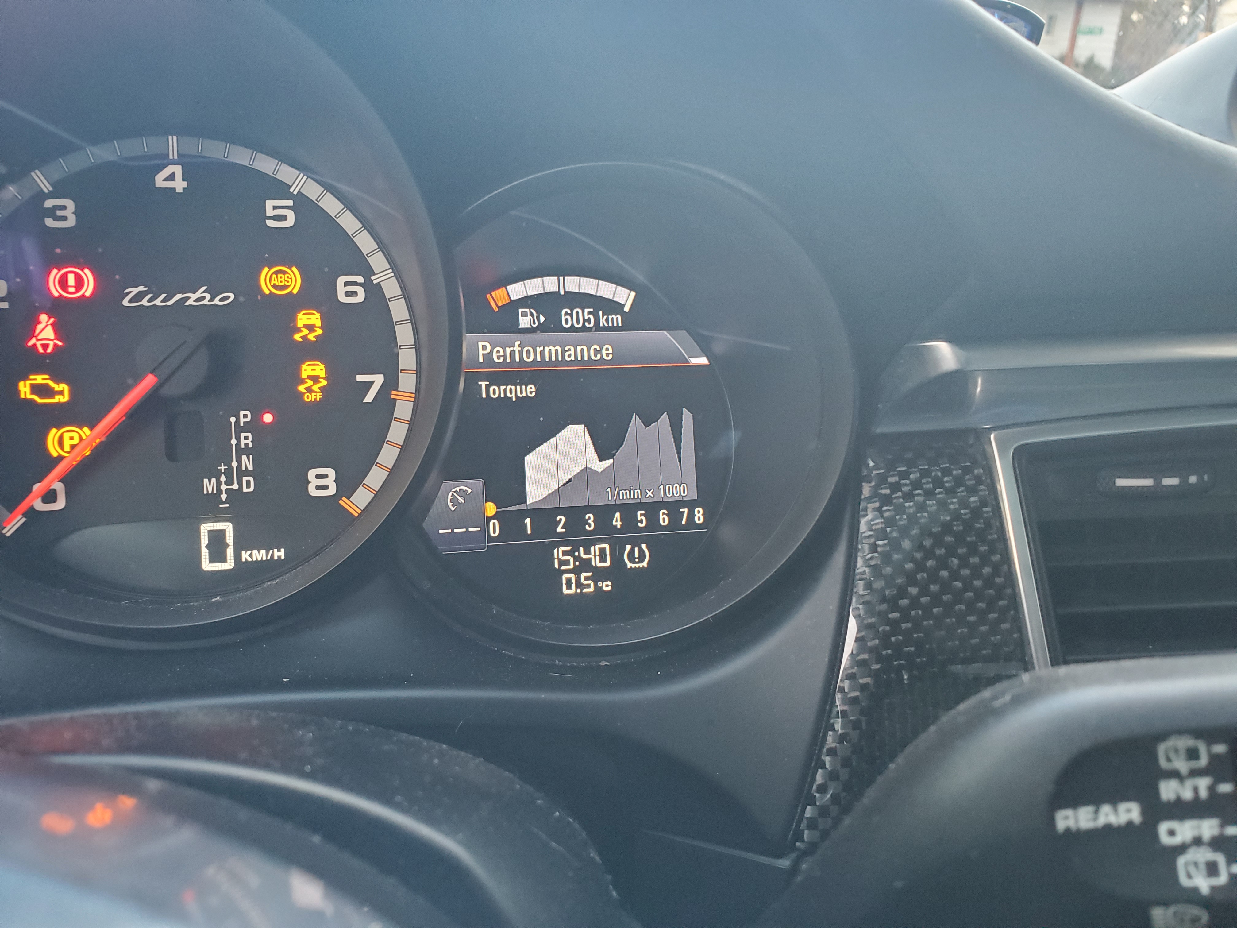

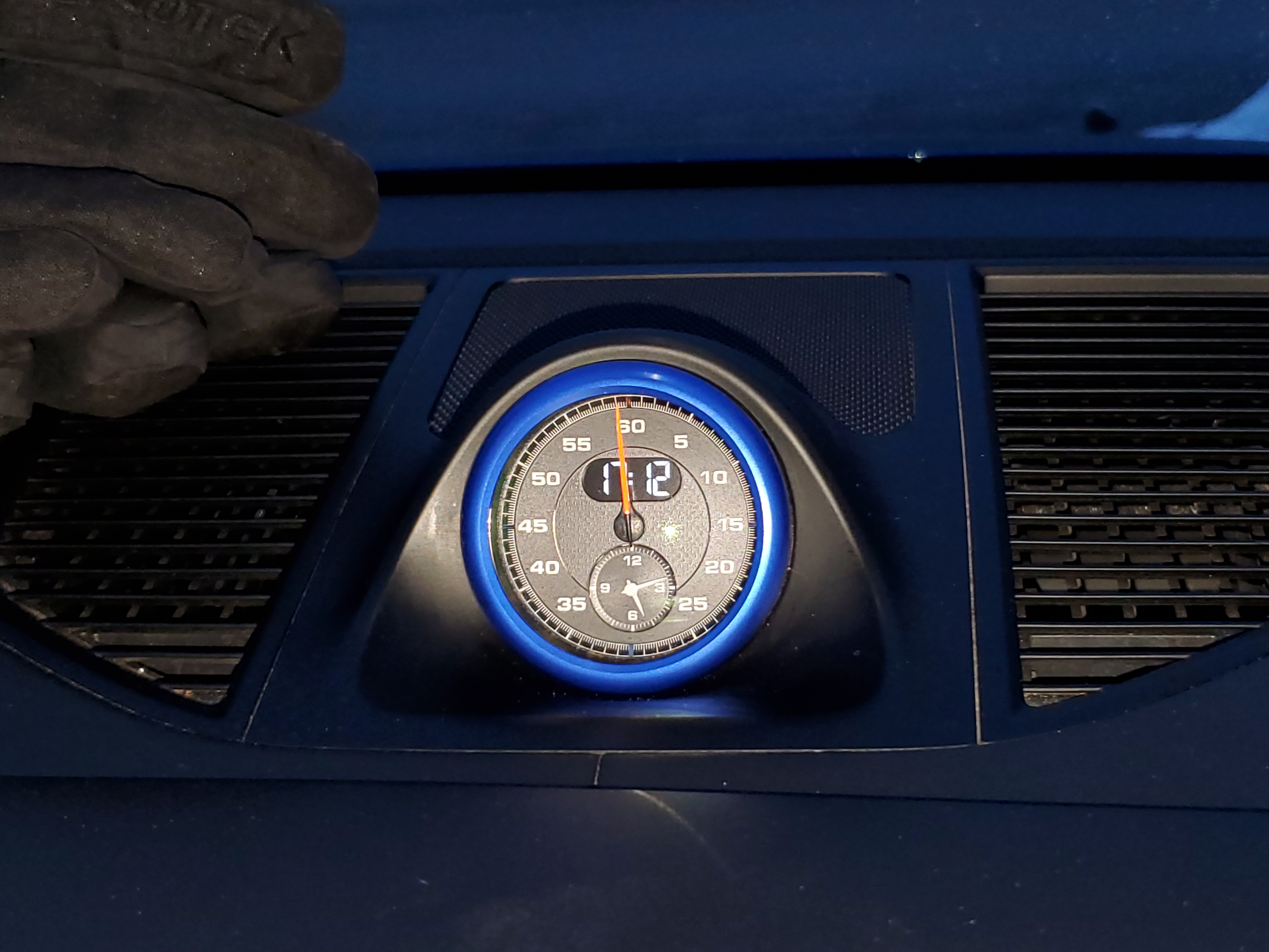

Met @Teddis through another forum and the coding fun began :-)

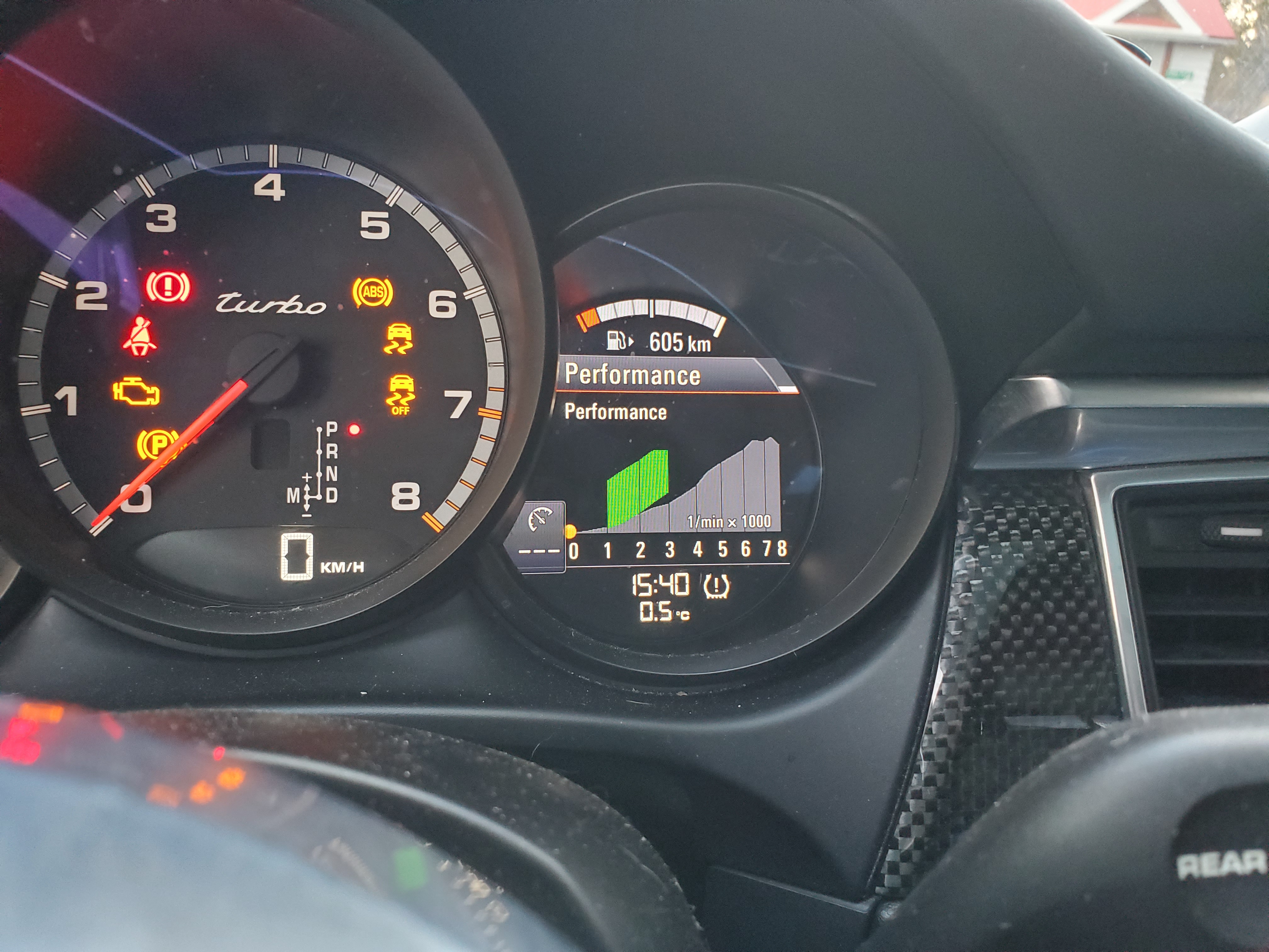

Added mirror retract on Lock to MFD
Added performance pages * partially working (any 718 cayman guys will to try and help us figure out coding on this?)

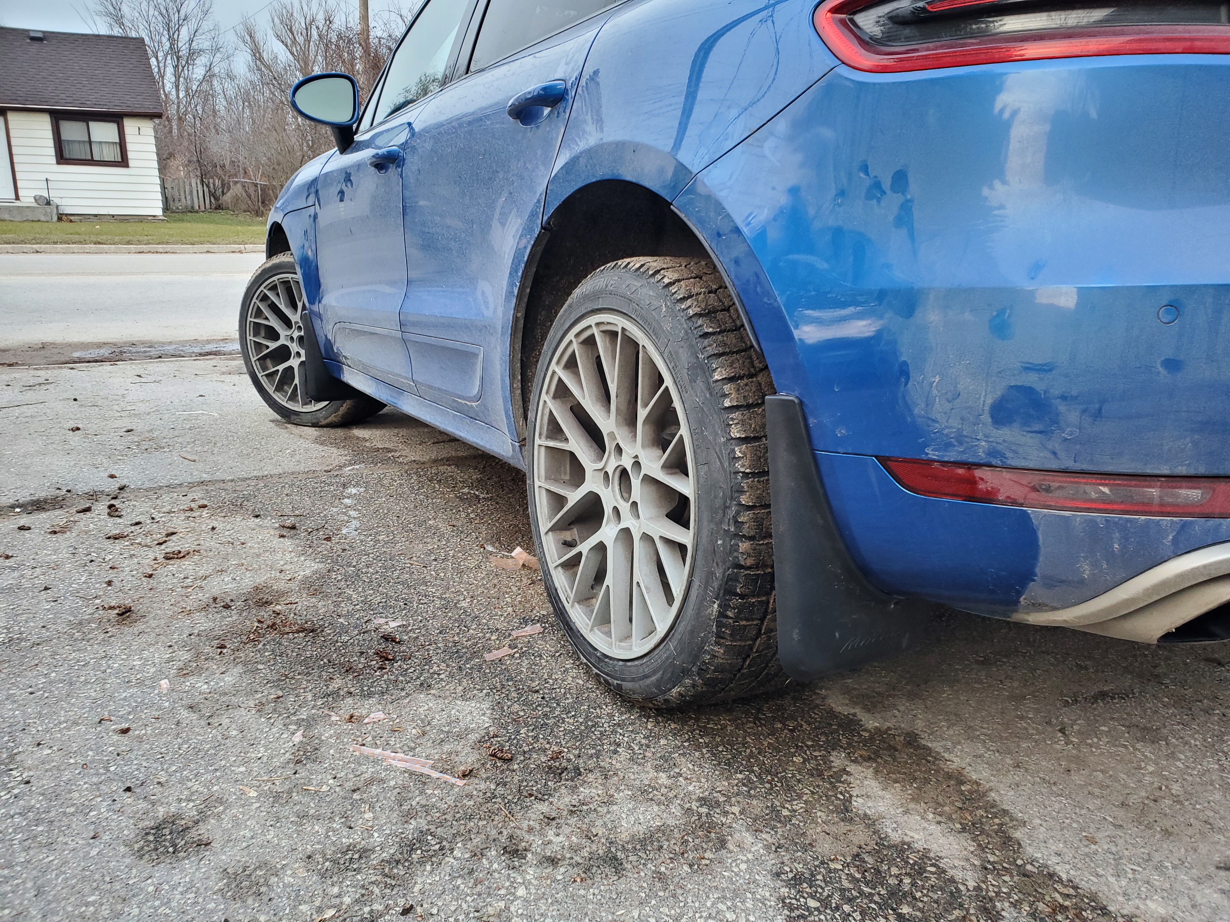

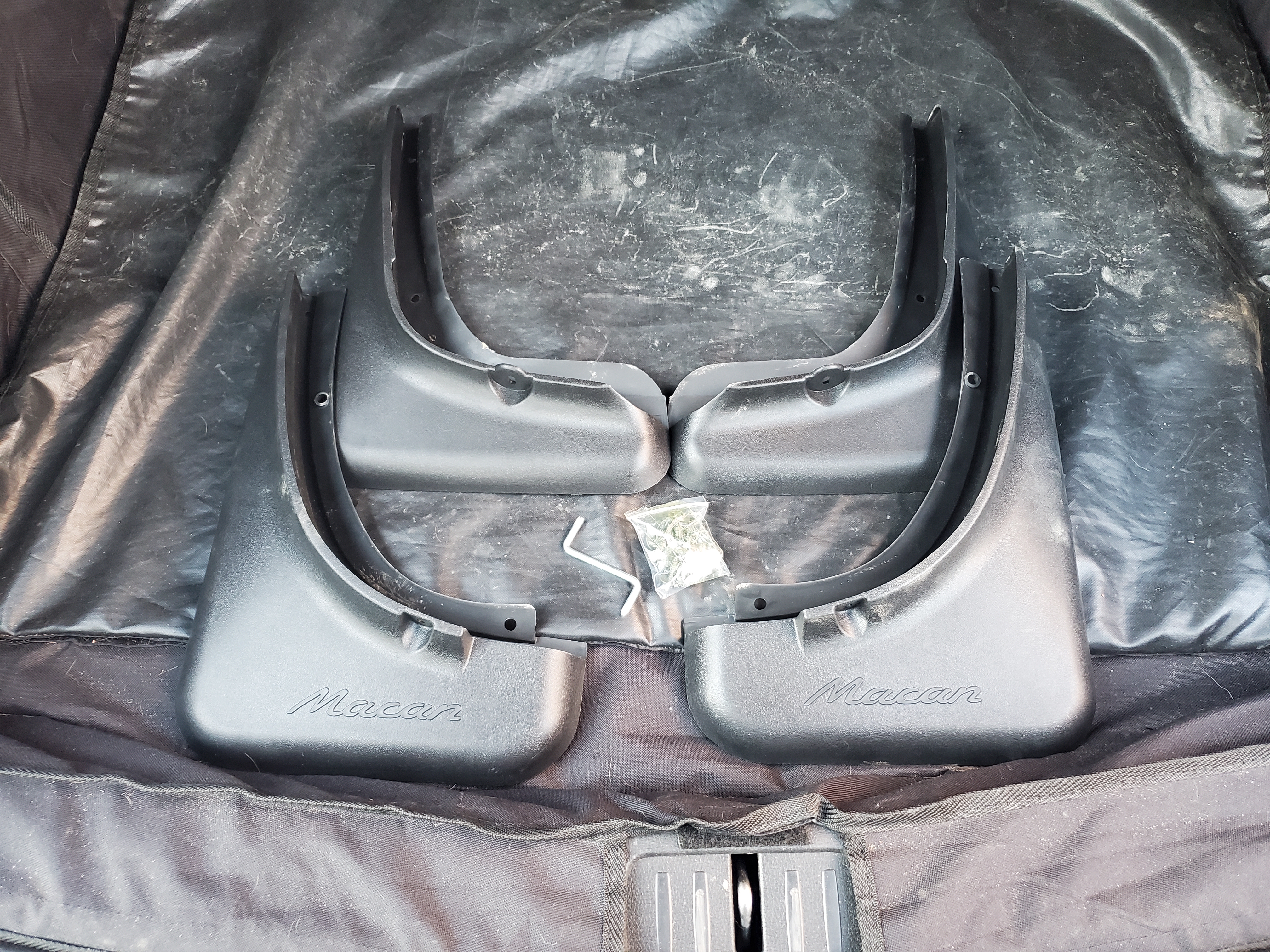

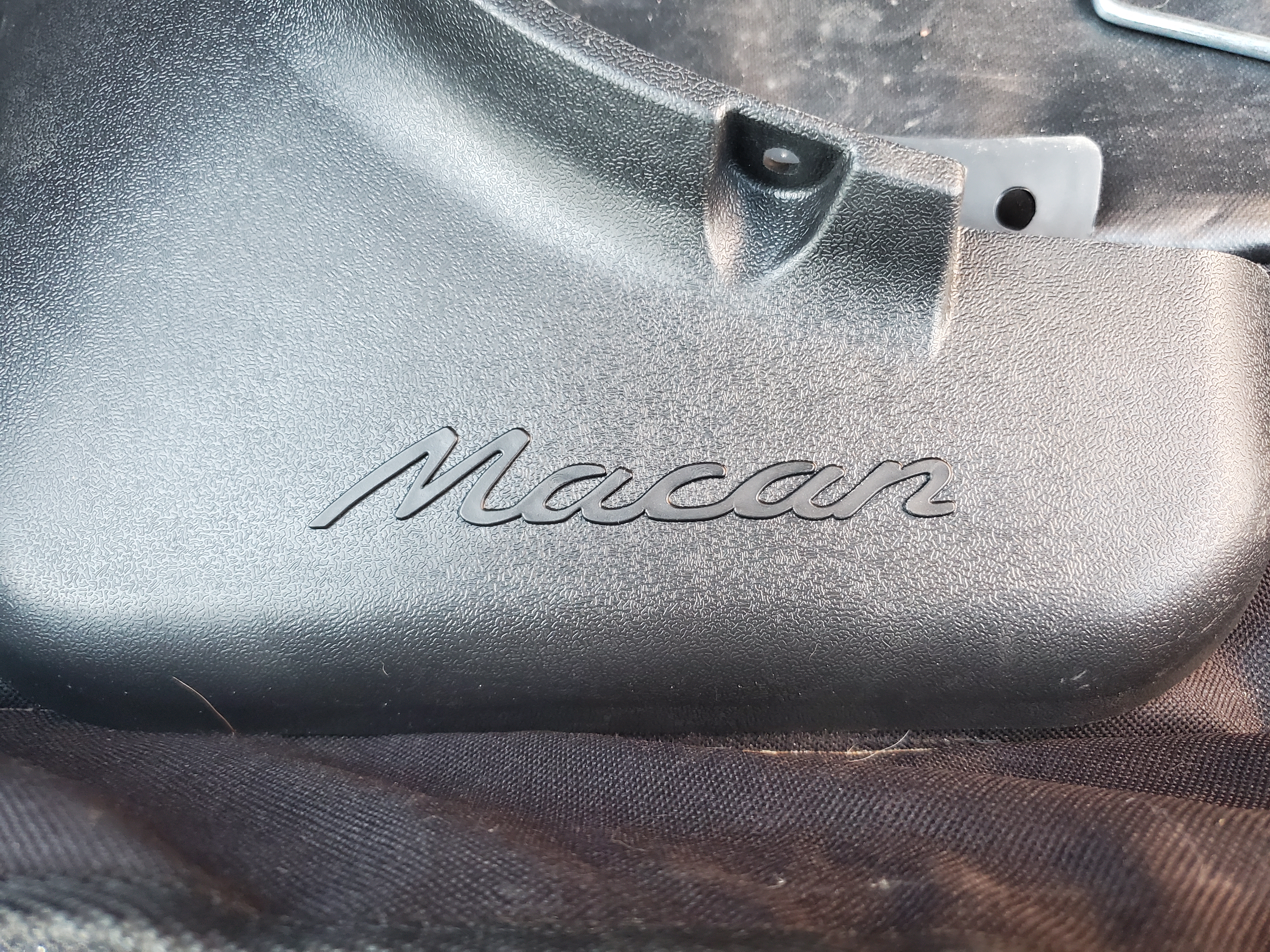

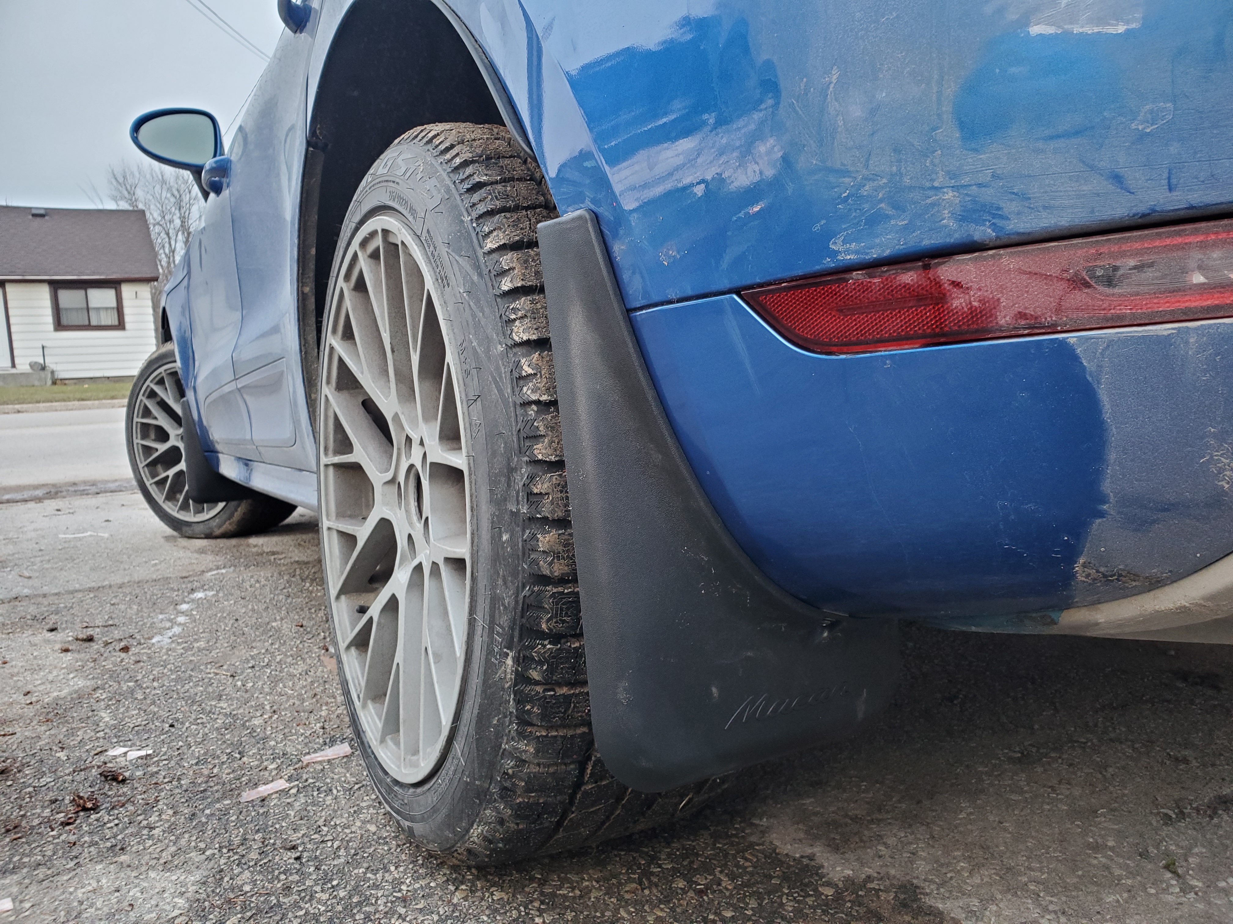

Installed Mudflaps from Ali express.
I love how the mudflaps look(WRC and Group B rally fan)

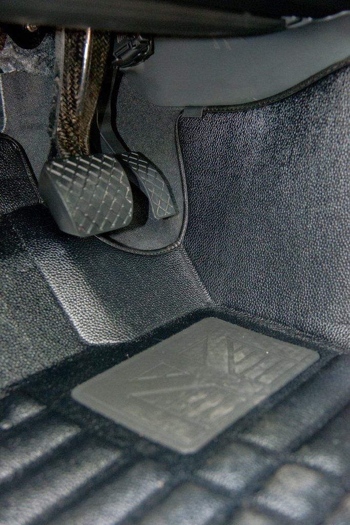

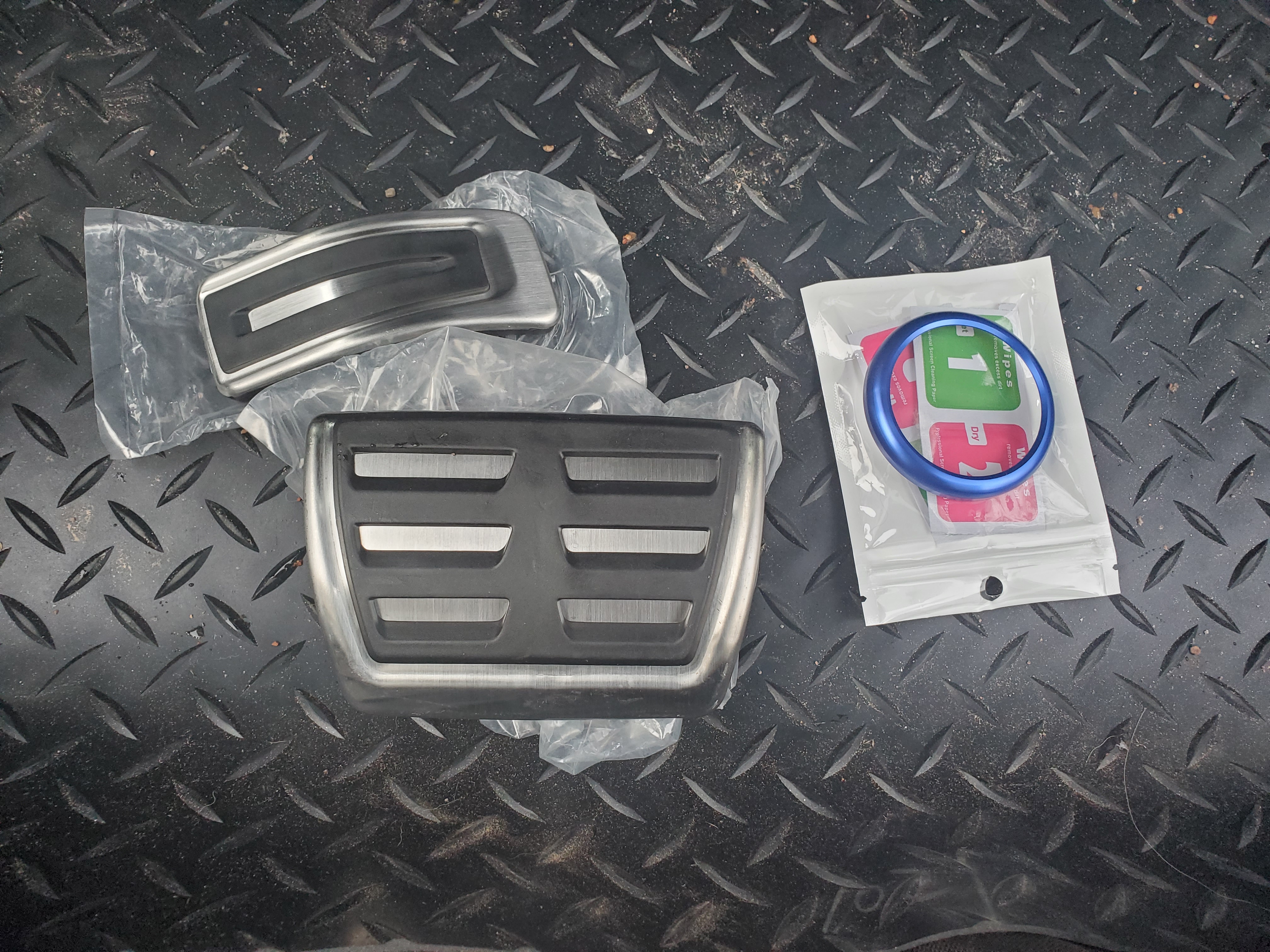

More Aliexpress stuff(so cheap it's easy to say screw it,lol)

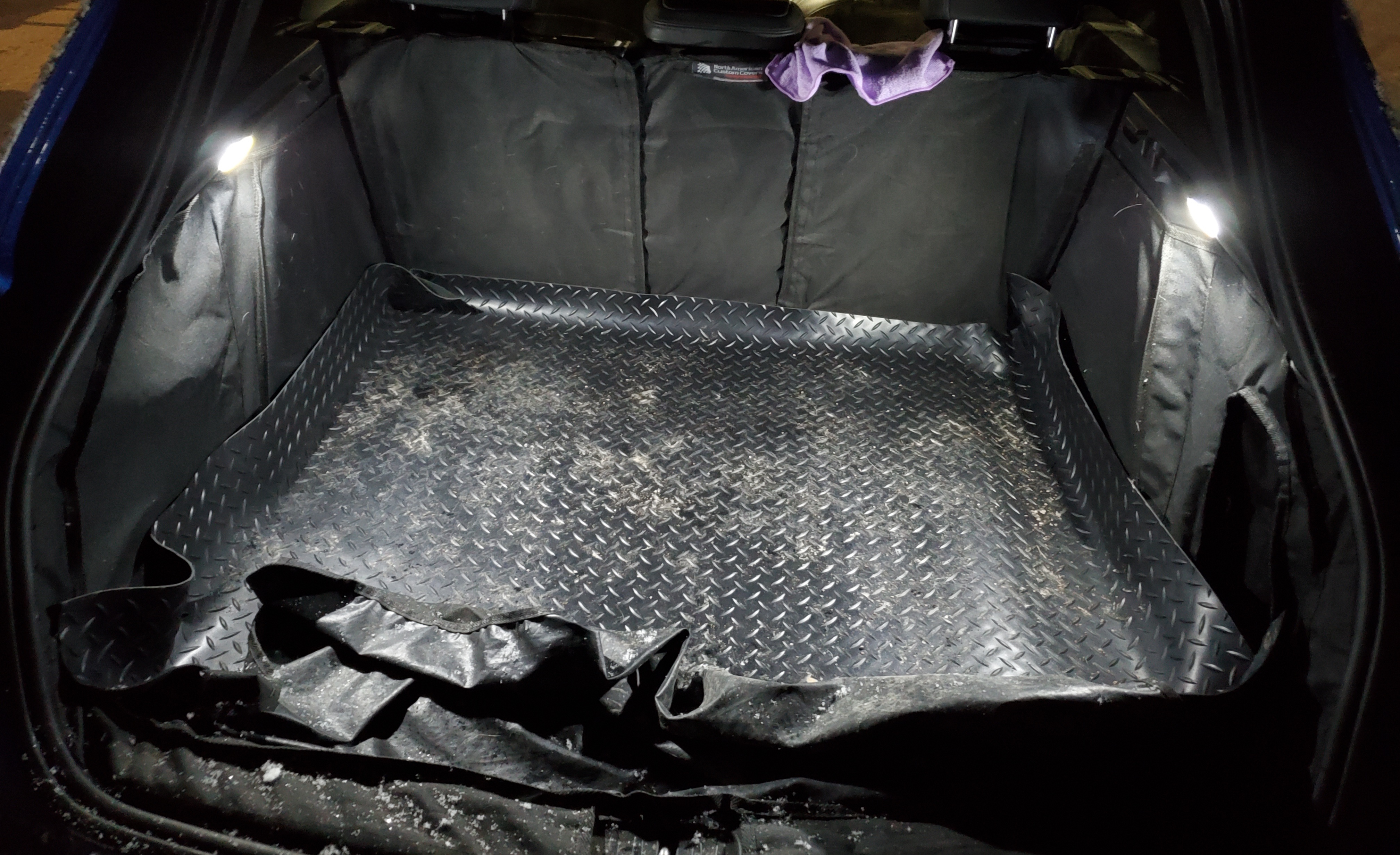

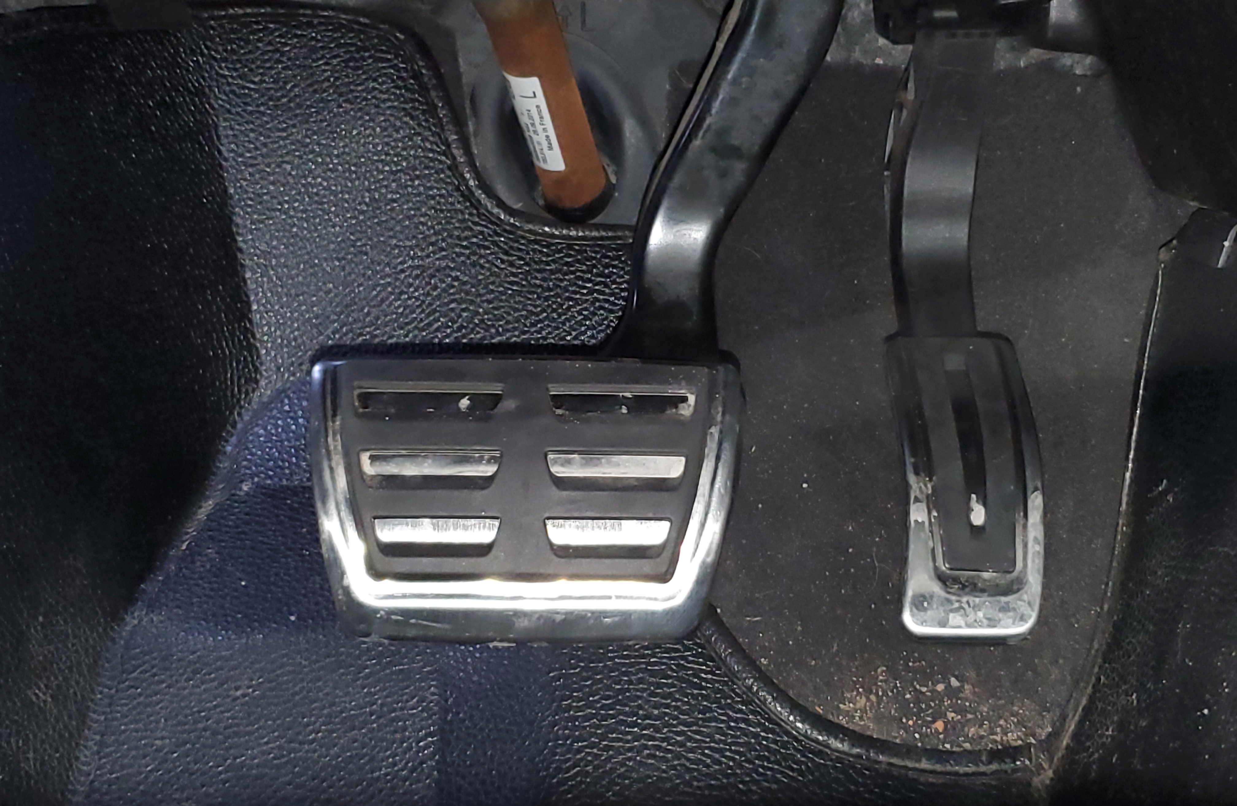

Pedal Covers,key covers, SC ring in blue and cargo lights.
Cargoliner is from a company from Amazon.

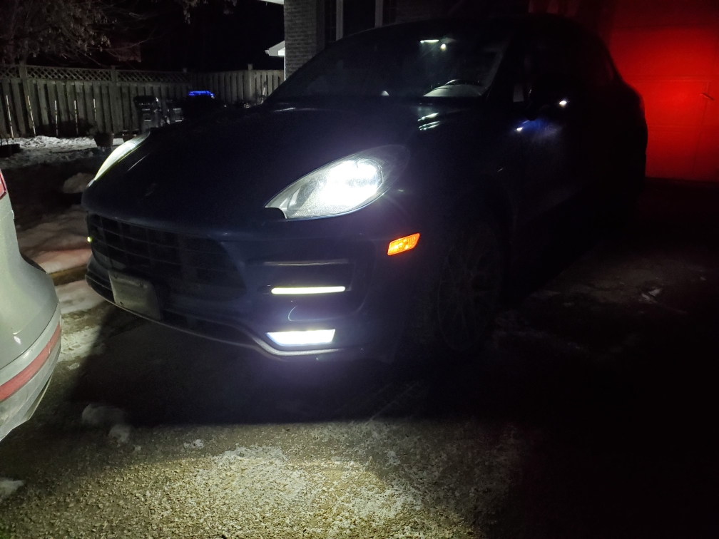

More coding:
- Coded the parking brake to automatically come on when cars is shut down and locked or the key is removed for cars without entry and drive
95b.1 Macan turbo. parking brake automatically on when key out or ignition off.
https://youtube.com/shorts/ko1XqlahLok?feature=share
ignore the beep my phone connected to my wifi.

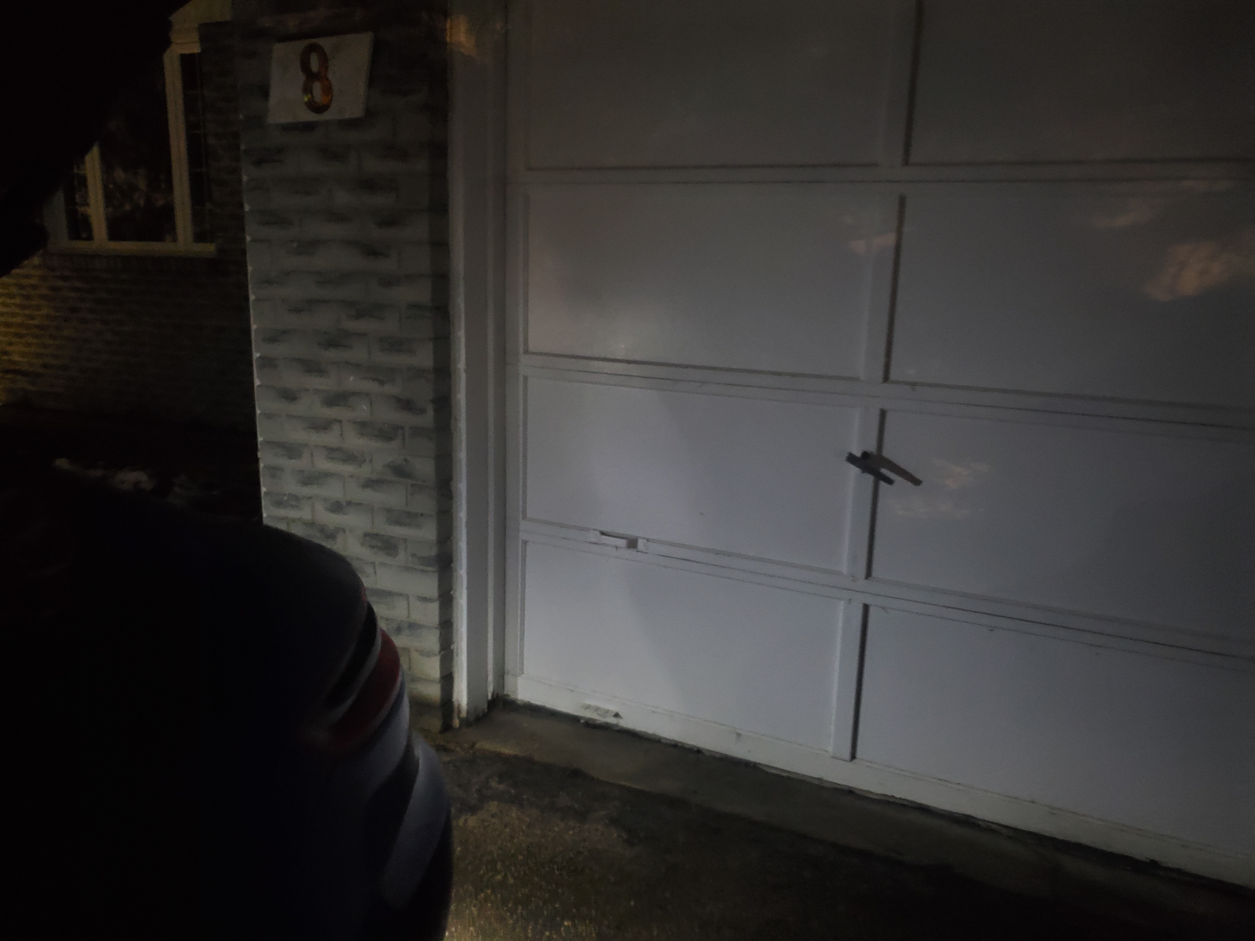

- foglights coded to come on with welcome/leaving home lights(use in dark driveways)

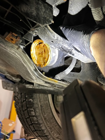

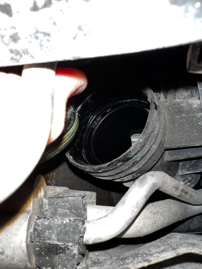

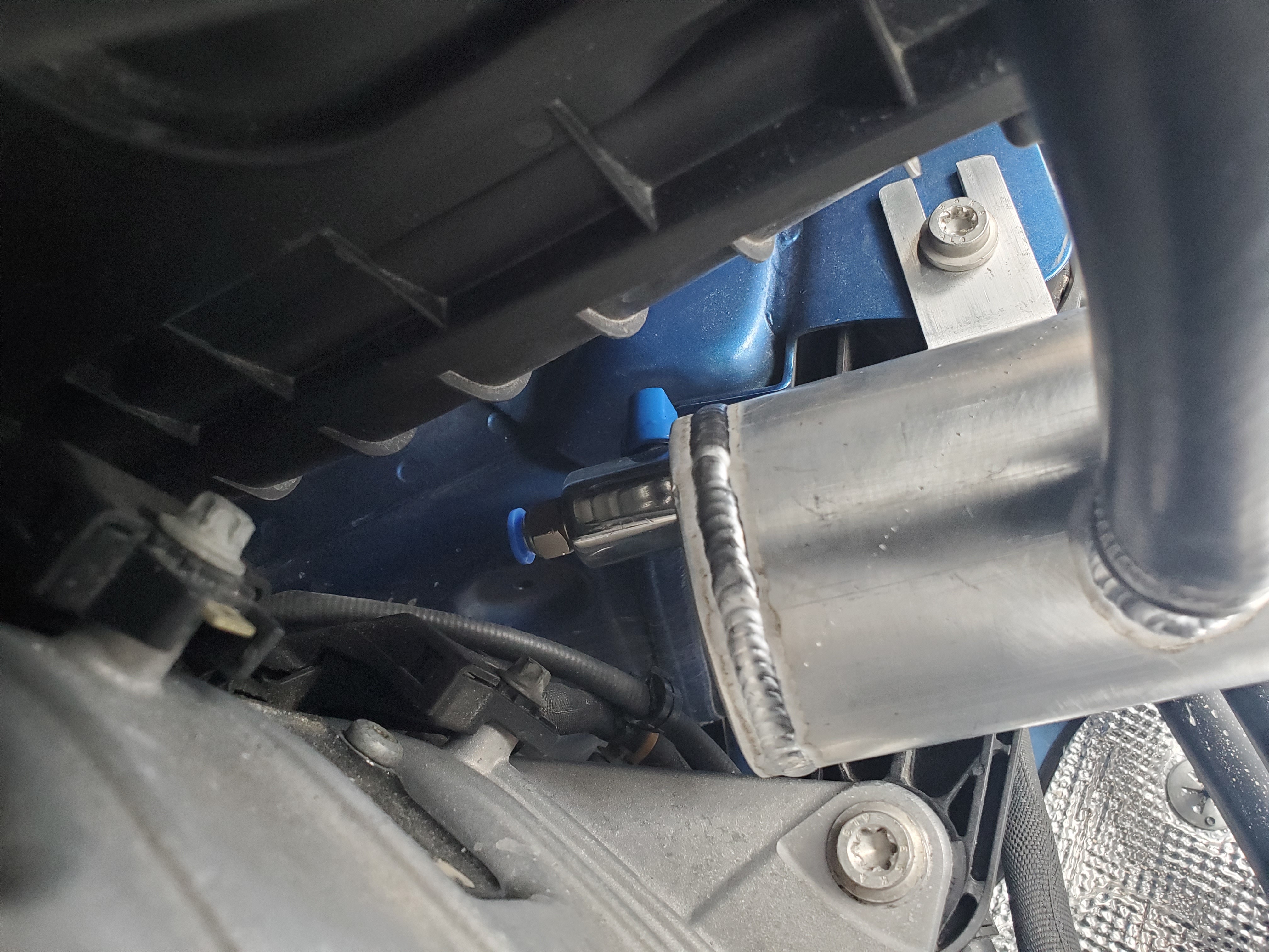

Jan 2022 :-(

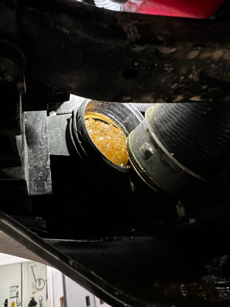

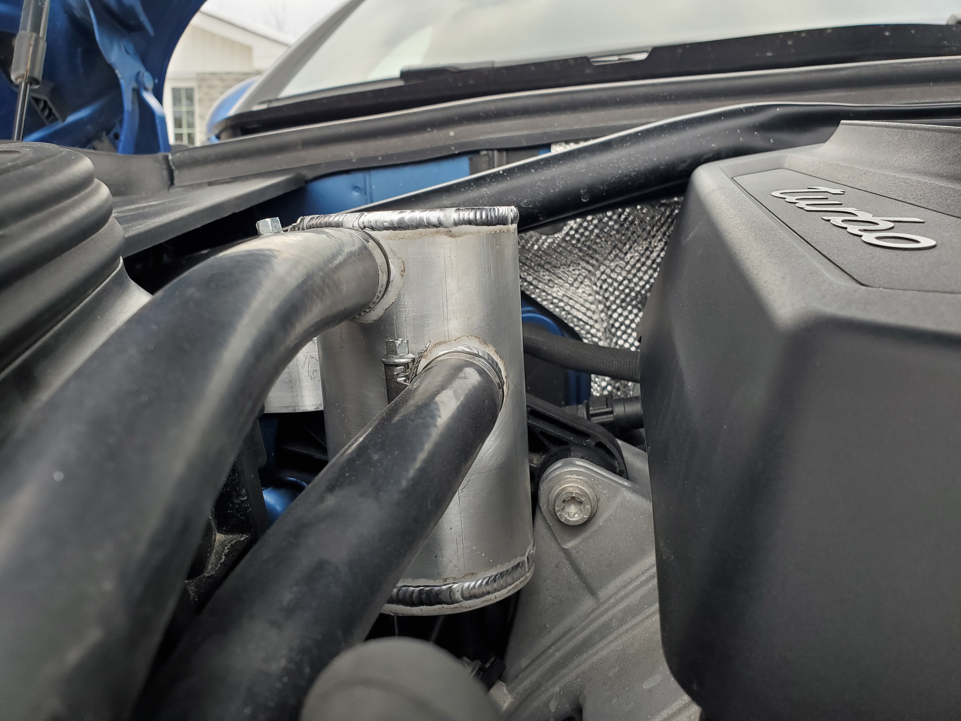

I set off a check engine light and reduced power fault about a week ago when I was out for a late drive(2nd gear WOT, ambient Temps were around -25c).
Pulled over and a Restart cleared the reduced power fault but check engine light was on. I could also hear the turbo & DV noises coming from the passenger side(think big turbo car building boost sound) Took it to Bill at Garage Autosports and left it for an inspection
Here is what was found:
Driverside Intercooler:
Passenger side:
The air/oil separators drain into the passenger turbo inlet & due to my short drives and other snow activities there was a significant accumulation of snow, and frozen water(oil, fuel, water vapor). Drain line from Oil separators to the turbo inlet pipe was frozen solid.
Intercooler pipes where also disconnected from the core(hence increas turbo noise and also a burning oily smell in the cabin)

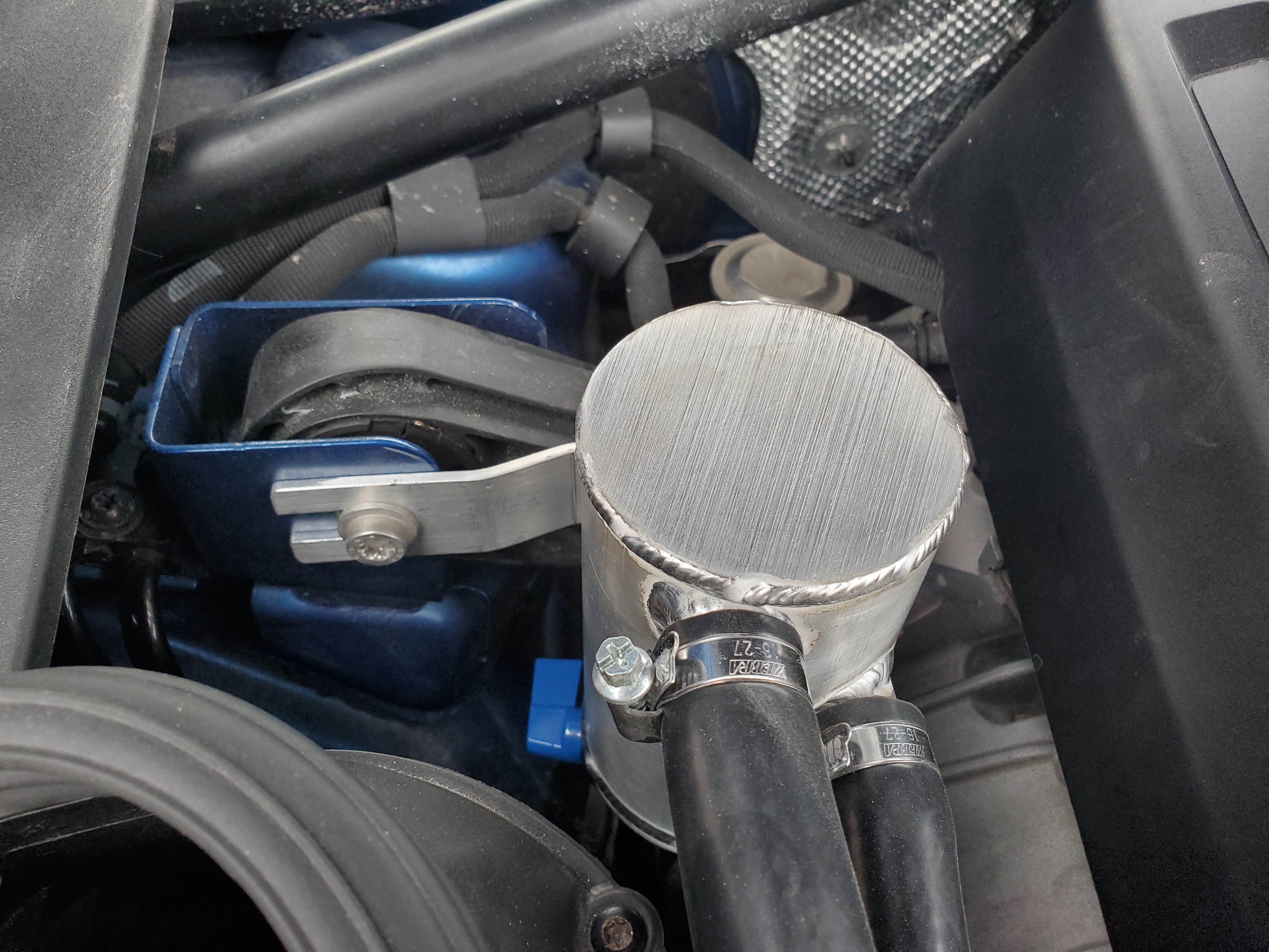

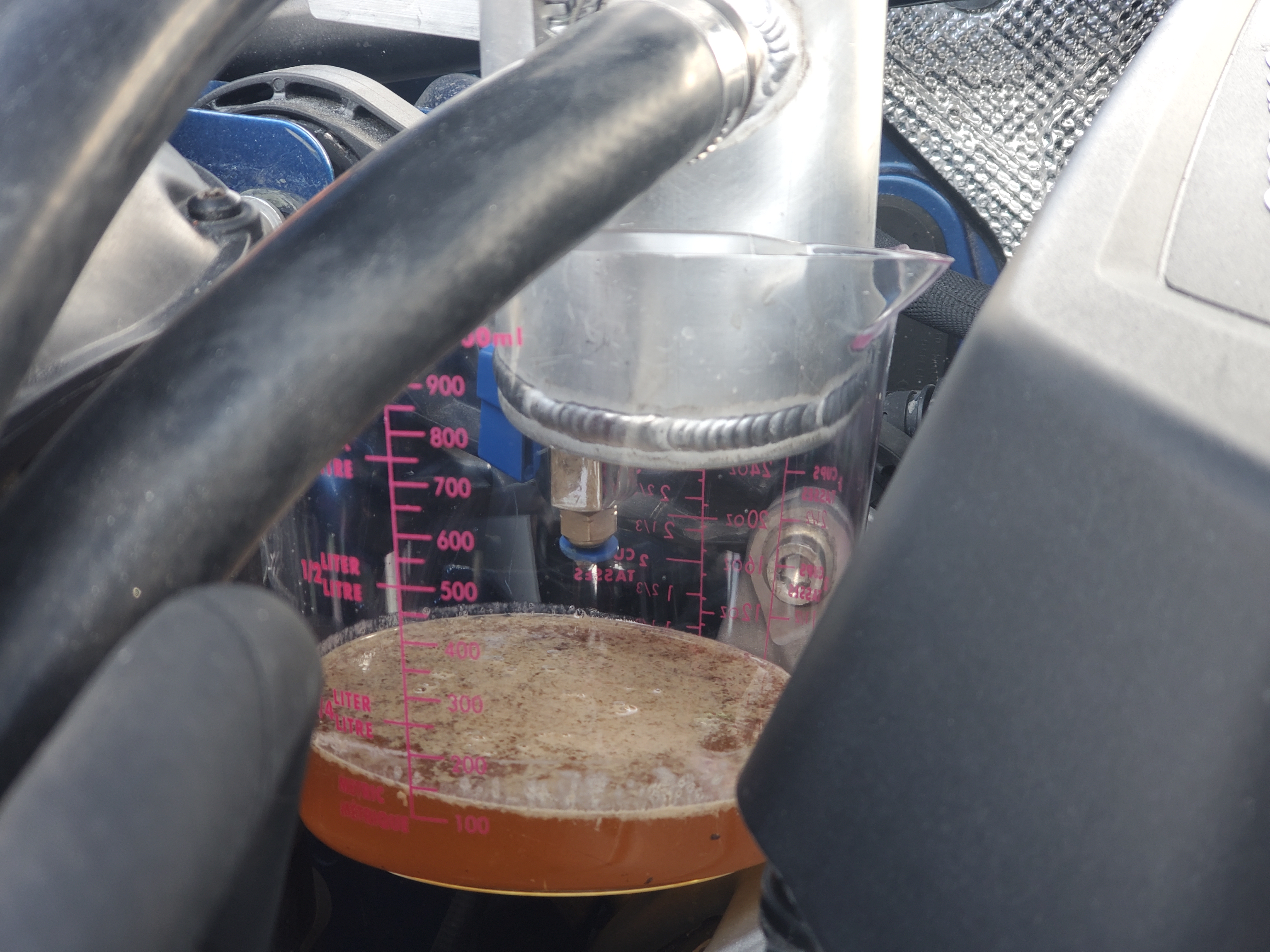

I left the car with at the shop so it could be thawed out and have all the ice build up removed at the ice. Once that was done, they built a catch can to hopefully prevent this from happening in the future. I asked for the can to be left with the raw uncoated finished.
Drain valve at the bottom. Eventually there will be a line that will exit out at the bottom of the front Fenderwell.

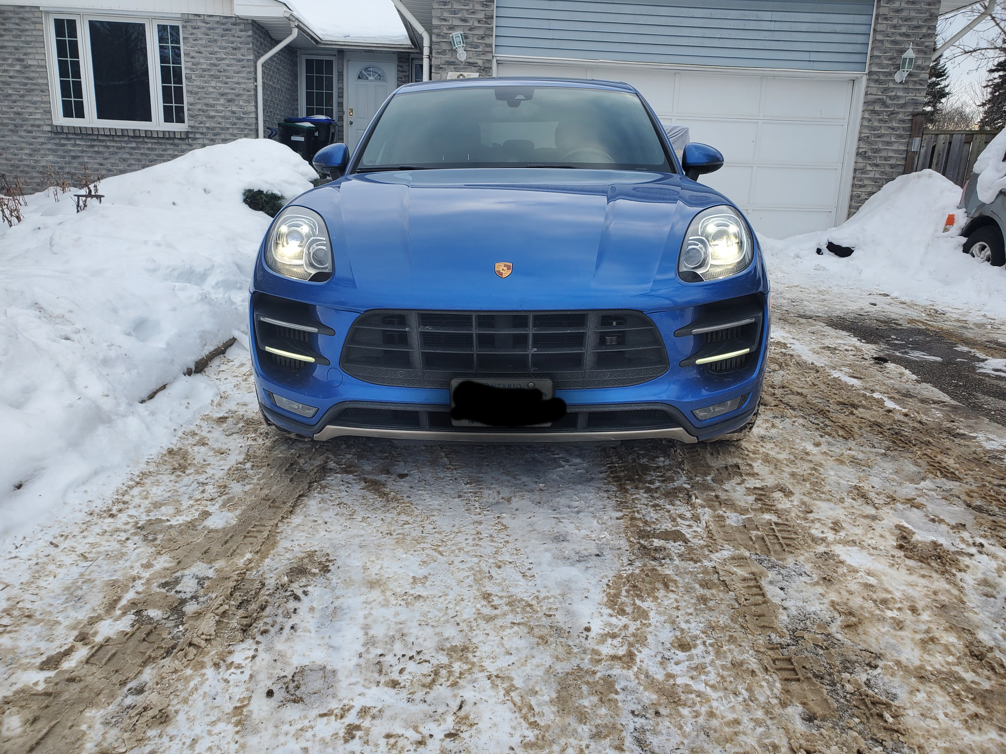

Also met up with @Teddis . Coded my 4 dot LEDs to stay on with the lowbeams

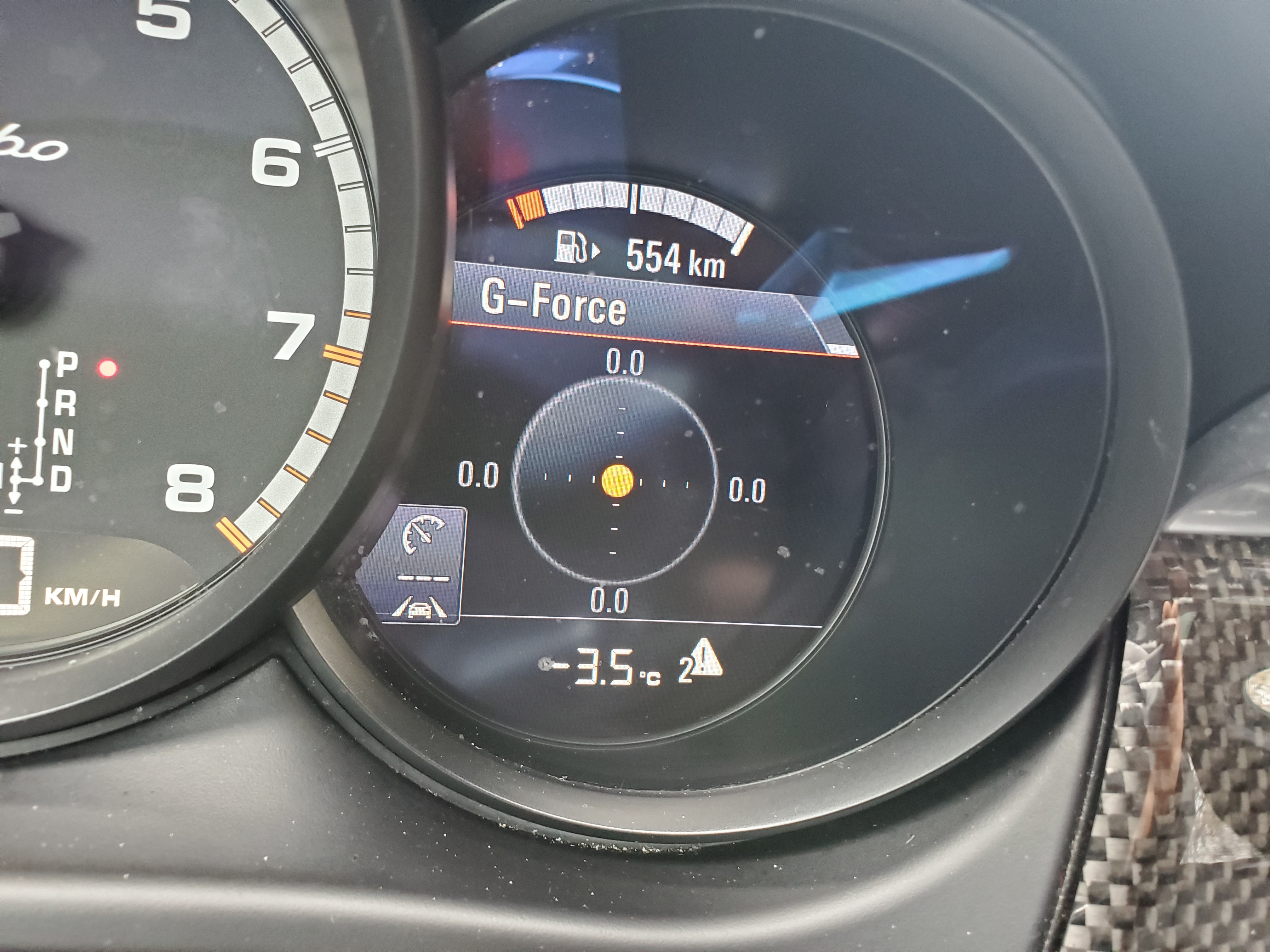

More coding. Thank you @Teddis for letting me use your tools.
Decided to lower the car an additional 10mm. So new normal height is 40mm below stand & with mode ride height is drop be a total of 50mm.
Low mode: 50mm total drop
Normal mode: 40mm drop
offroad mode looks the same as stock.
Coded rear lights to come on with DRLs
Added the G-force cause why not

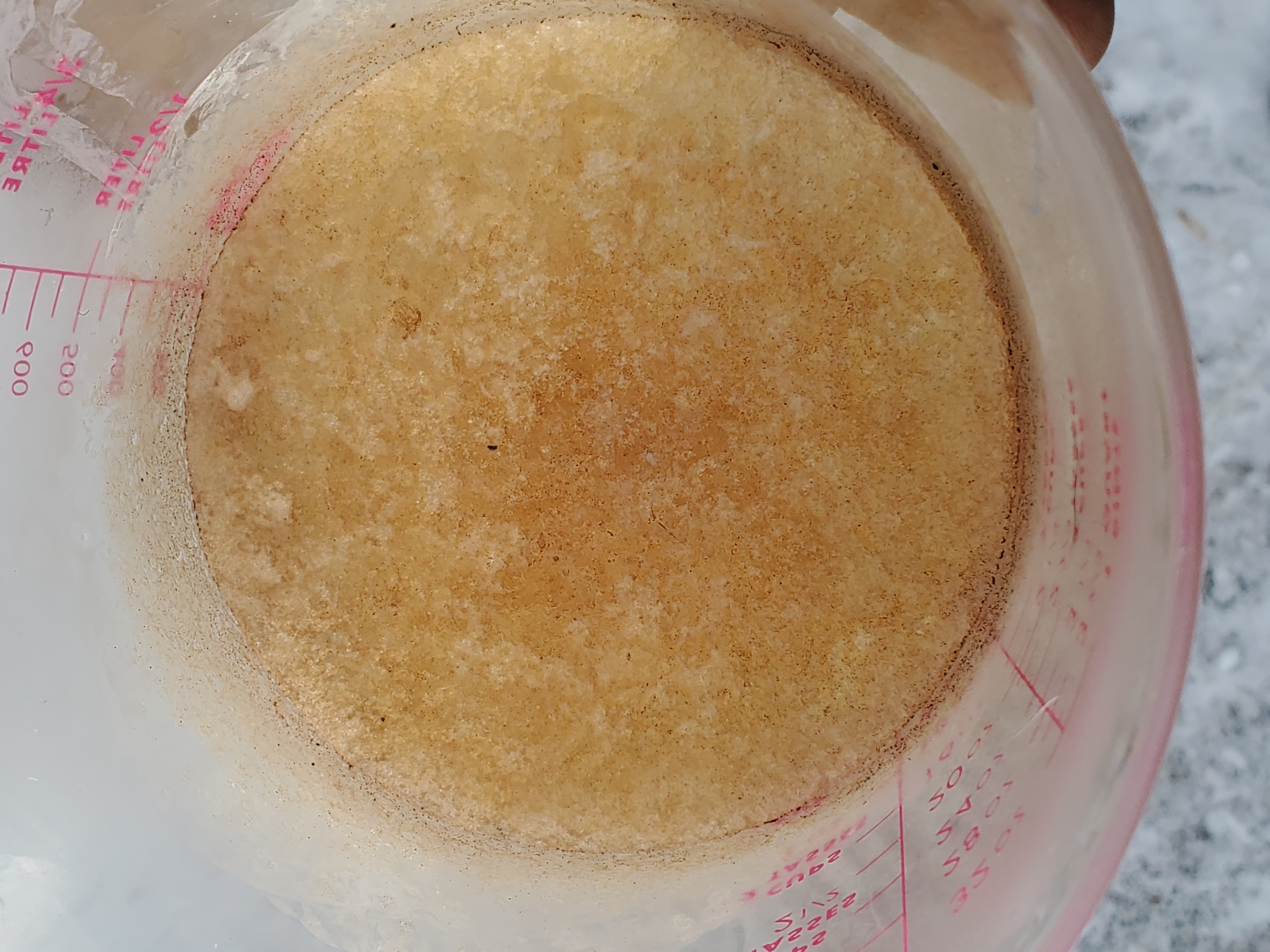

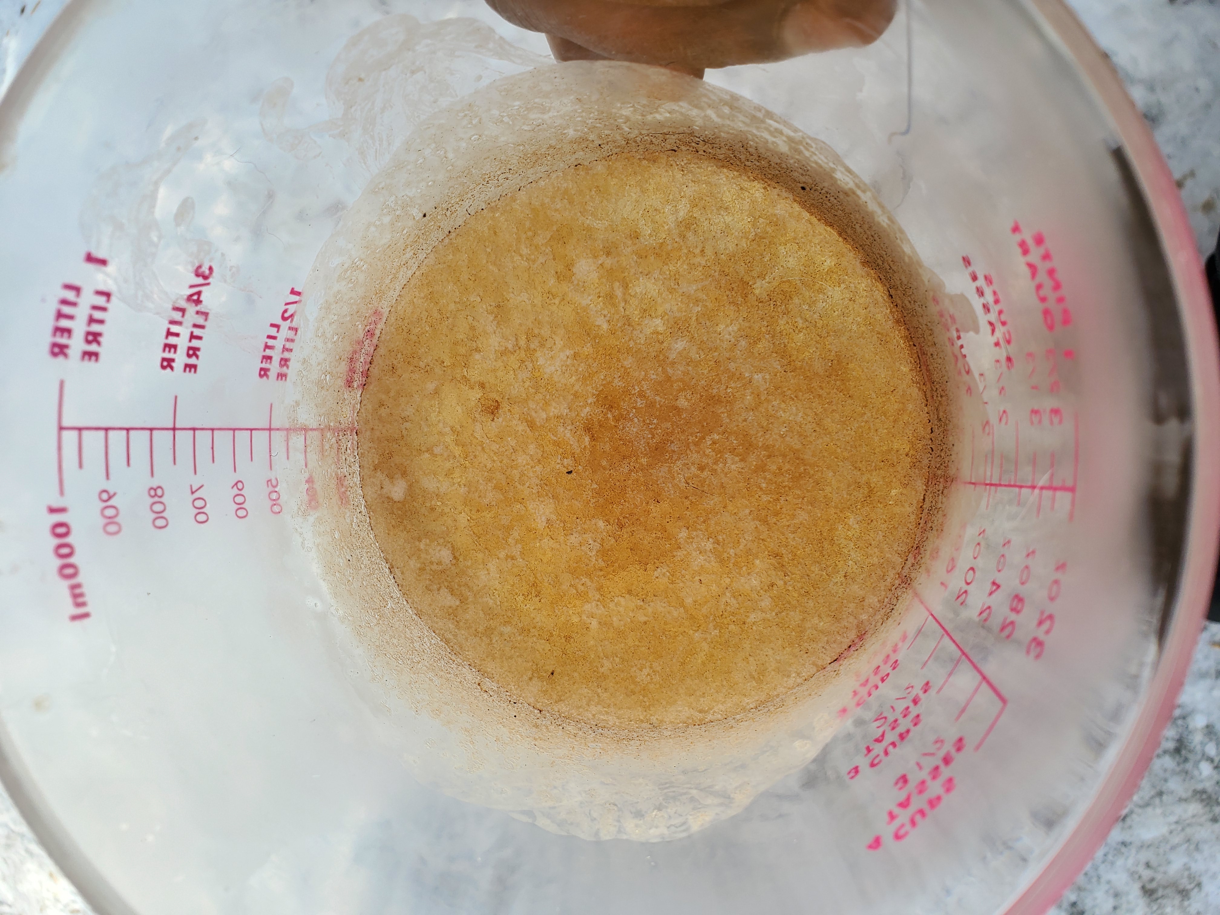

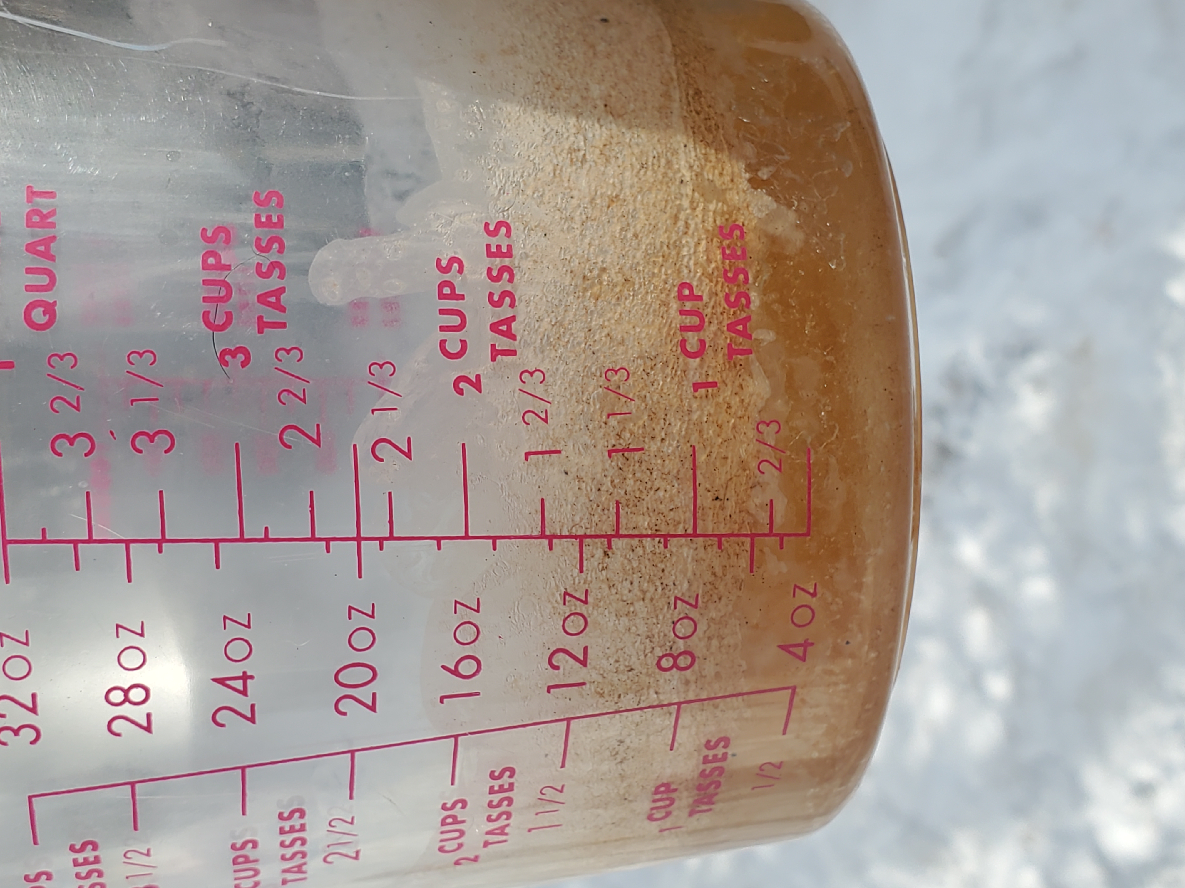

Catch can has been on for 1029kms.
1st drain = 8OZ
Had a few weeks of -30c during the winter so I let the catch fluid sit outside
