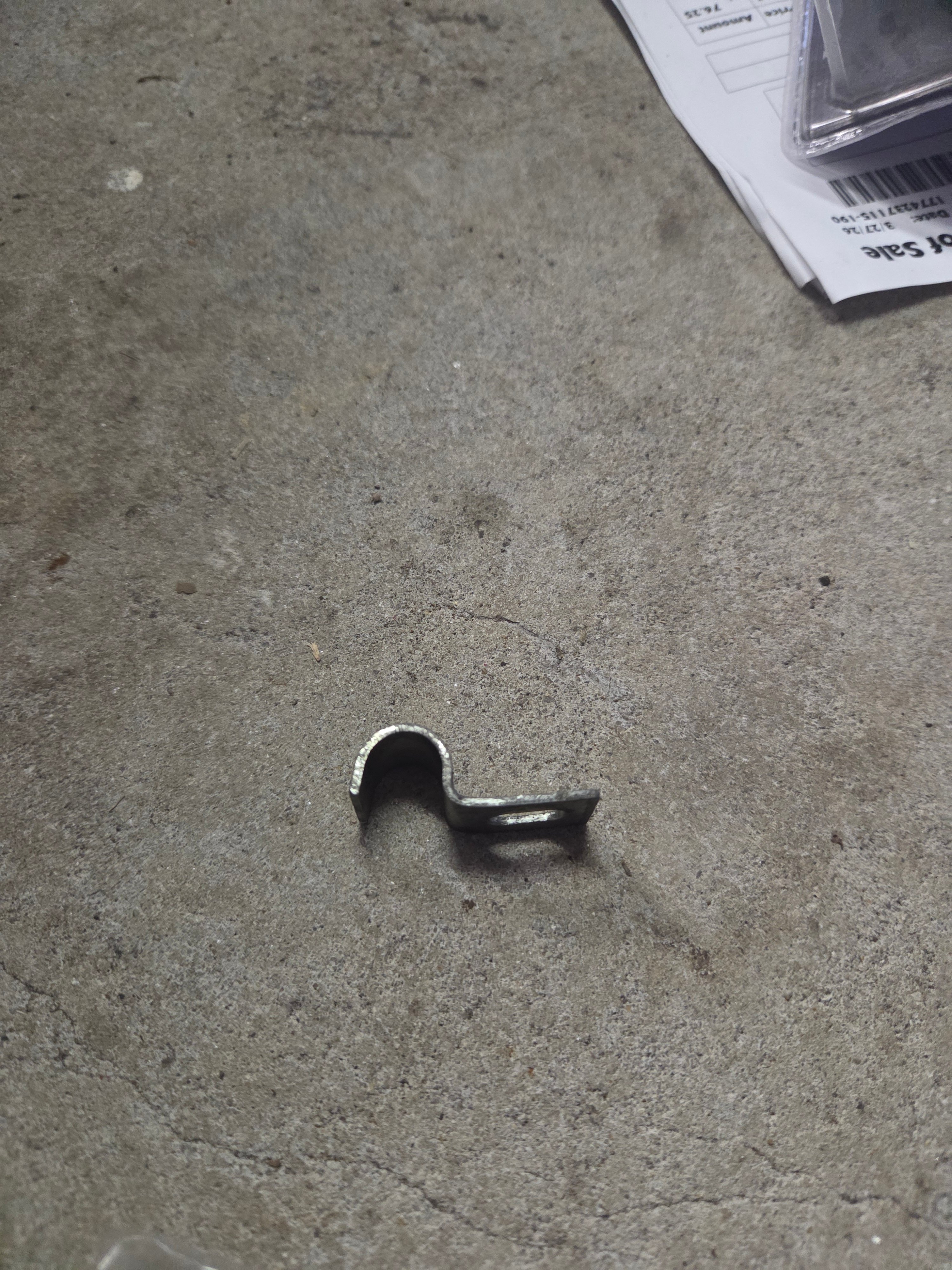

Putting the car back together after long period apart.
In the "intake manifold" parts bag I have this.
Where does it go?
Can't see it on parts diagram.

If you are trying to post an image it is not visible.
944 NA ROW -86

Photo this time!

Oil dipstick tube retainer? It would be helpful if you also shared with us what the car is.

1983 944.
Dipstick retainer sounds likely I will look into it.

Second or third that. Looks like dipstick retainer although it should be bonded to the dipstick.
