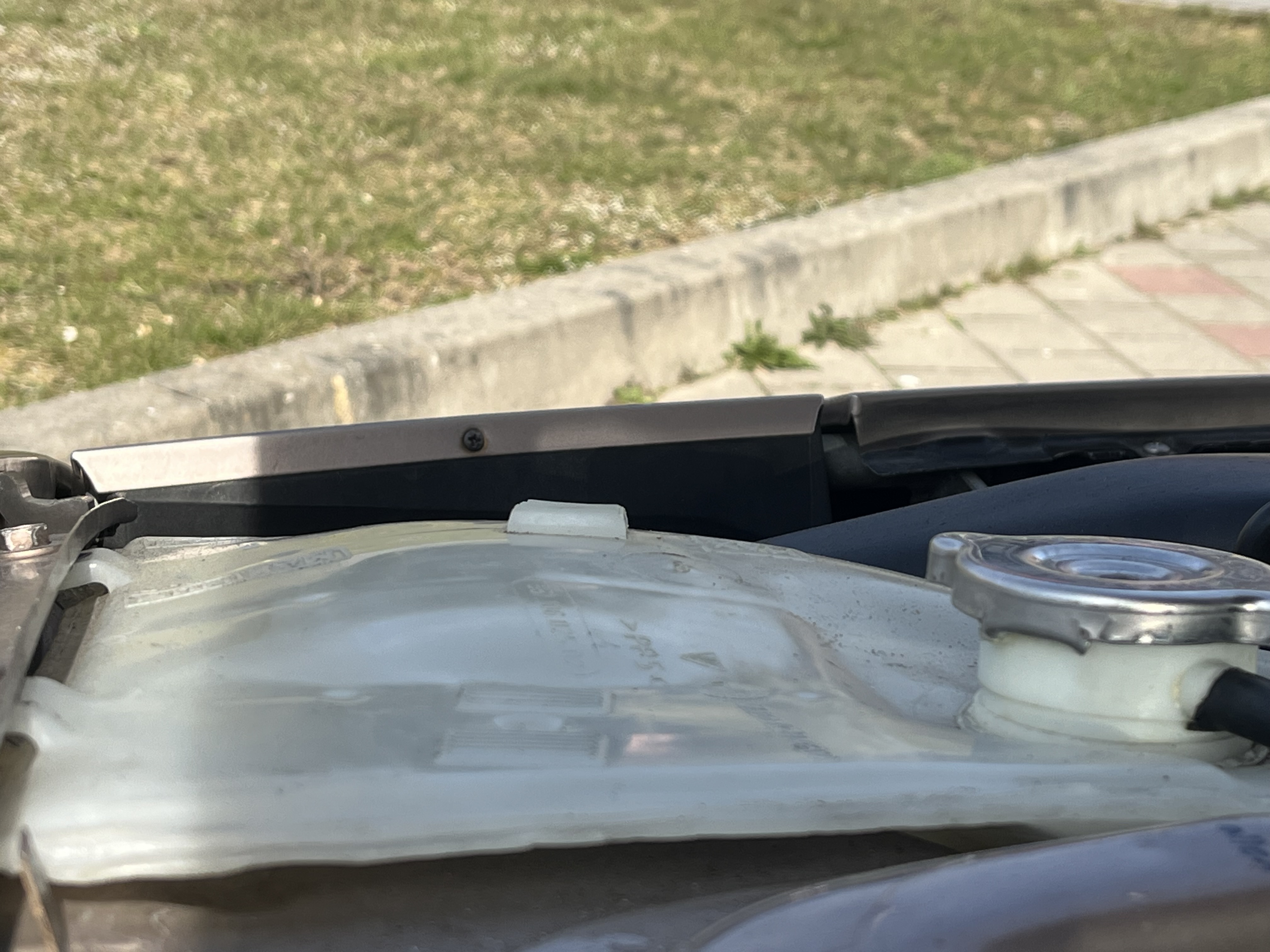

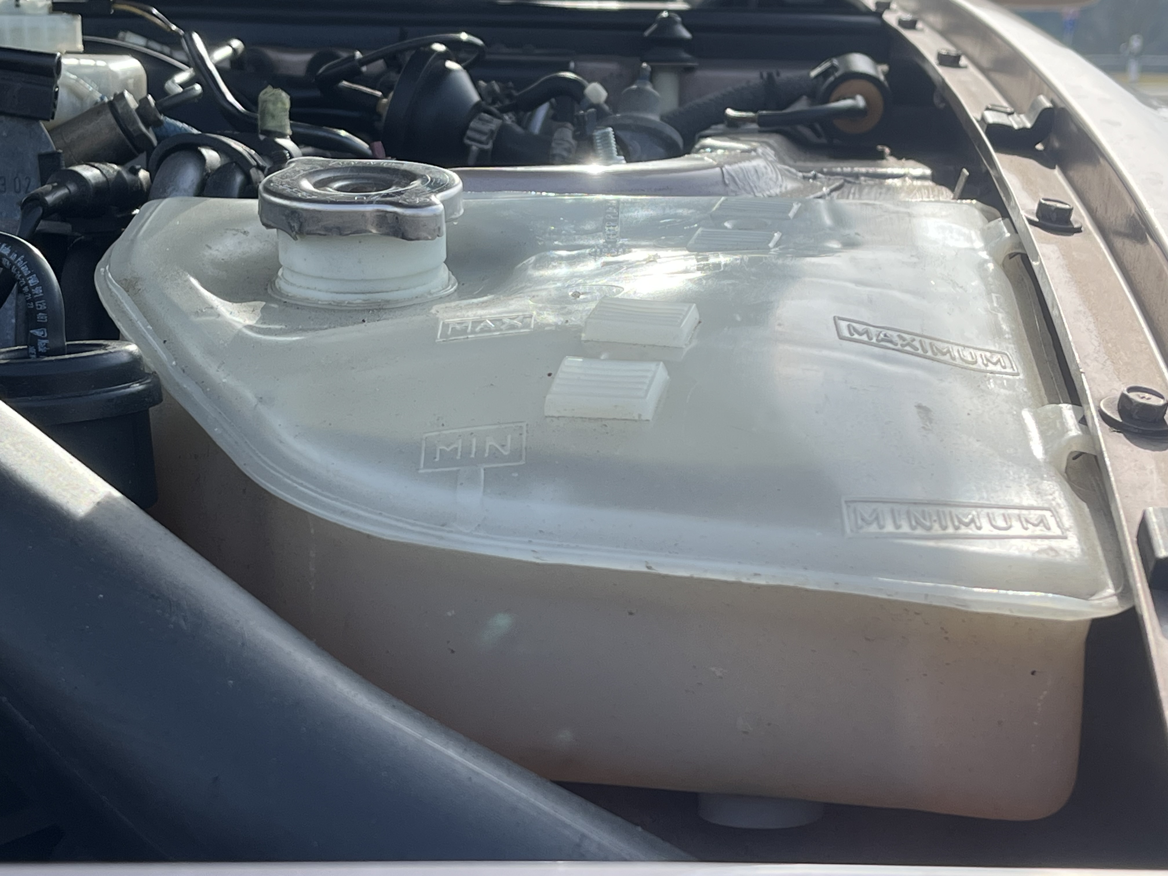

Photos of bulging reservoir

Yes, I saw them, and I also saw Chris’s photos and the cap info (Mahle Behr MAH-CRB17000P).
From the photos, that tank is more than the normal “old 944 tank” swell. The top is clearly ballooned, and if it’s close enough to affect hood fitment I’d stop trusting that reservoir. They can split without much warning once they’ve deformed like that.
Next practical steps are to confirm the cap is the correct pressure rating for the 951 and that it’s actually regulating pressure. Even a good brand cap can be wrong spec or defective. If you can, have the cap pressure-tested or swap in a known-correct OEM-spec cap.
At the same time, I’d do a cooling system pressure test and a combustion gas (block) test. The reason is simple: a bad cap can deform a tank, but combustion gases will keep over-pressurizing the system and will just wreck the next tank too. A big clue is whether the upper radiator hose gets rock hard very quickly after a cold start.
If Chris can confirm whether there are rub marks on the underside of the hood and whether it pressurizes quickly from cold, that’ll point us toward cap-only versus over-pressurization from the engine.

Yikes! The humans agree -- that's not normal! Is that a Porsche part or the new, cheap AliExpress knock off? I've never seen a Porsche tank do that, and I've blown more head gaskets than John McEnroe. The fact that it blew up like that before something else burst makes me wonder if it was just defective.
