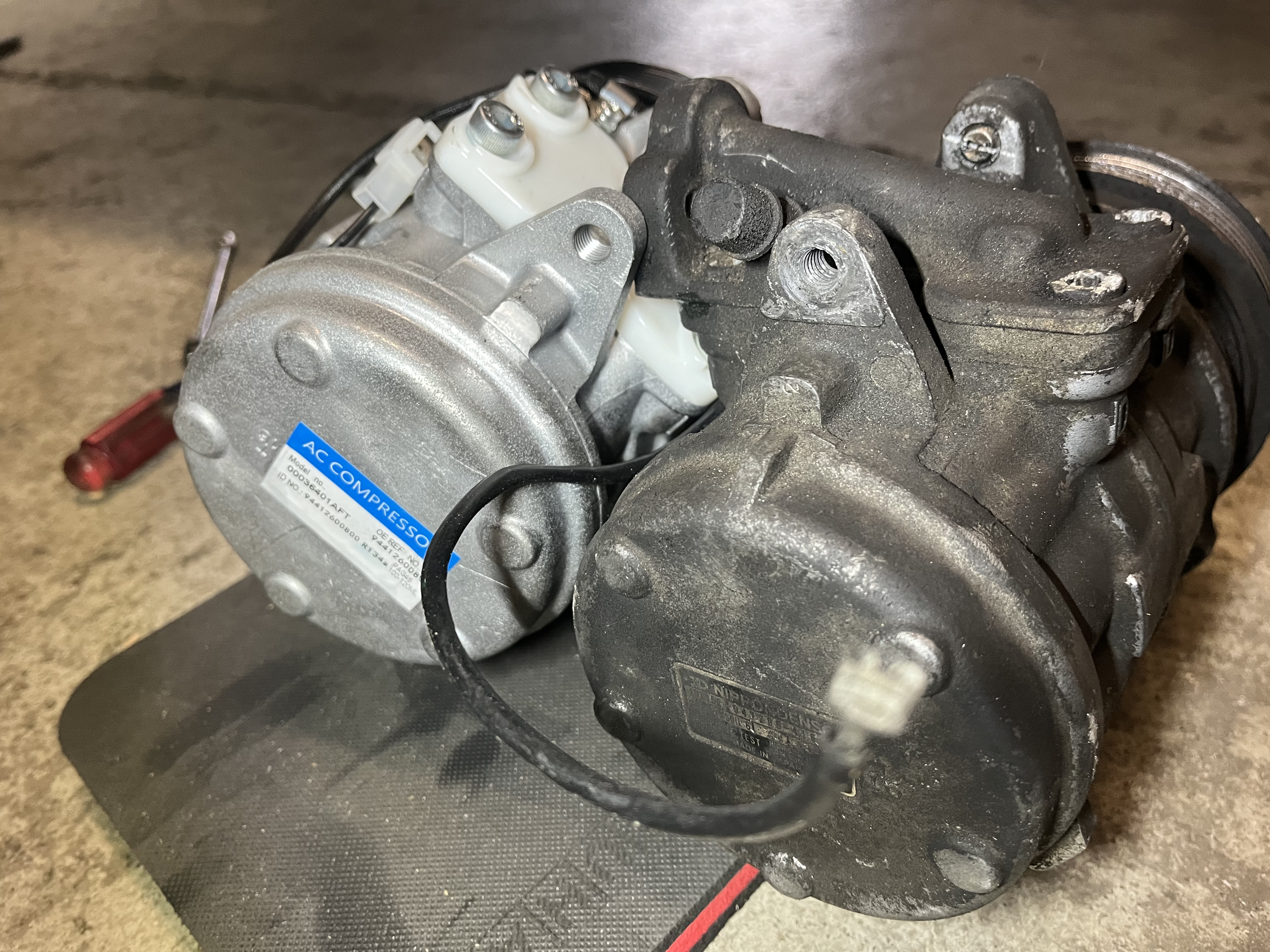

Thanks for the feedback. The compressor looks like a rebuilt Nippondenso unit. It's from a rebuilding company in the Netherlands. Everything looks the same except for the female bolt threads on the rear mounting ear.
I did a temporary installation using a nut on the end of the M8 bolt. I'm going search for a thread adapter. The hardware store had one to adapt coarse thread M10 to M8, but I need fine thread M10 to M8.

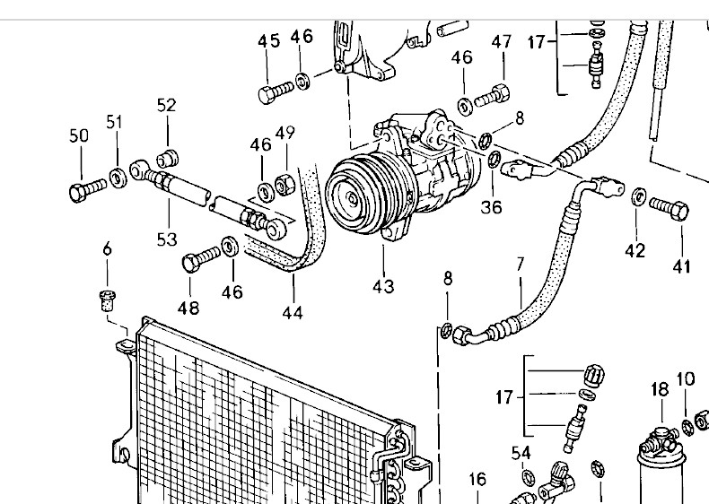

I'm trying to understand the hardware that's used to connect the tension arm to the lower compressor ear. Does a M10 bolt (#49 in the diagram) thread onto the bolt prior to threading into the compressor?

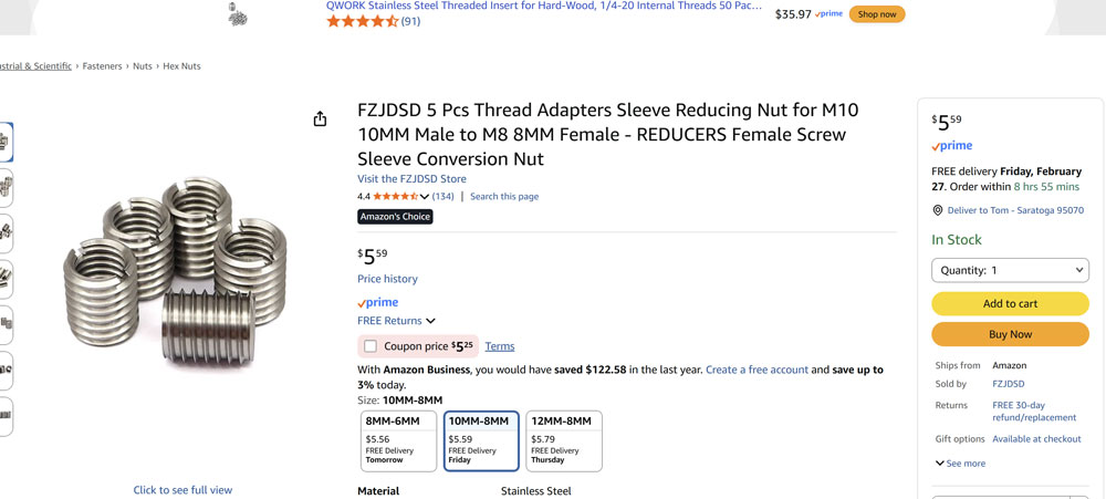

I've heard that that same basic unit was used on a lot of cars, so I'm wondering if the supplier just use the wrong case variant for the 944. I'd be inclined to call them on it and see what they say. If you don't want to bother, I wouldn't drill the mount myself, but rather use some kind of thread adapter so you can stick with the factory hardware. Something like this:

Thanks Tom. I will check out the compressor tutorial for tips. Yes, I'm ordering those adapters. The local hardware store had the standard m10 to m8 adapters, but I need m10 1.25 thread to m8.
So, I'll be doing removing the compressor again next week and will install the insert. Now the only thing I need to resolve is removing the hose manifold from the top of my original compressor. The hole in one of the allen bolts is stripping.

M10x 1.25! Boy, that supplier isn't doing you any favors, but it looks like adapters are available. With stripped allen heads, I've had luck just drilling down the center until the head pops free and spins. Either that or vice grips...chrischrischris wrote: Tue Feb 24, 2026 11:37 am Thanks Tom. I will check out the compressor tutorial for tips. Yes, I'm ordering those adapters. The local hardware store had the standard m10 to m8 adapters, but I need m10 1.25 thread to m8.
