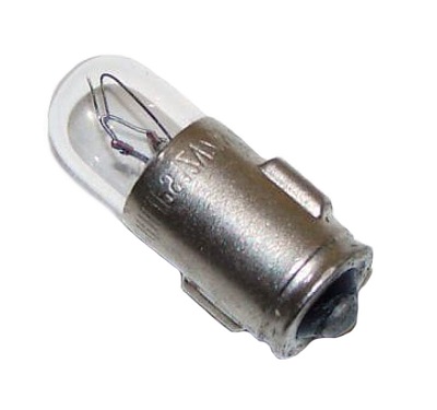

OK, here is how it works:
It is correct that the gauges need to be pulled out from the dash.
Next: the socket for the illumination need to be pulled out from the back of the gauges. The socket are reused, and only the old bulbs are removed. These bulbs are the bajonett style bulbs which are remove by push and left turn and pull out.
The new LEDs are direct replacement and installed reverse way and cannot be installed incorrect, since the + is at the socket tip and the - is at the socket sleeve.
There is no need to disassemble the gauges, which would require special tools and not recommended as a DIY project.
The LEDs are dimmable with the factory rheostat, as long it is in good working condition.
The Carmagic LEDs for 911 1965 to 1988 are the BA7s with the twist-lock style socket, just like the original bulb shown below.
