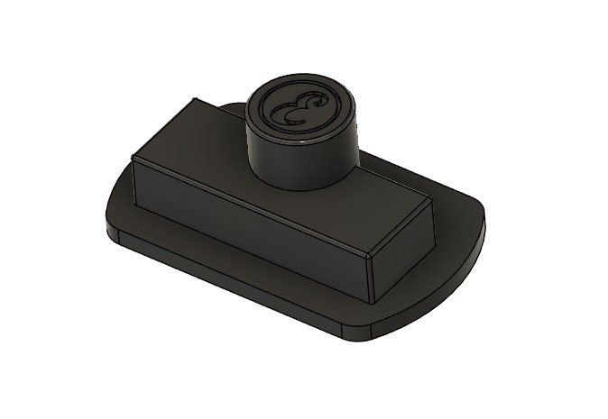

I designed jack pad adapters for the Macan, and I’m sharing two versions here.

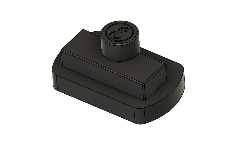

I’ve been using the 5 mm version on my 2017 Macan GTS several times now and it works great. However, I realized that having a little more clearance to the chassis would be nice, so I created a 15 mm version as well. That one is currently being printed and not yet tested.
My final parts are printed in TPU 95A HF, but my initial prototype was printed in PETG — and surprisingly, it worked perfectly and held up for multiple uses.
Print settings for TPU 95A HF:
  • Top & Bottom Layers: 7
  • Walls/Perimeters: 6
  • Infill: 90%
Happy printing! If you have any questions, feel free to ask. I can also print and ship a set for the cost of materials and shipping.
