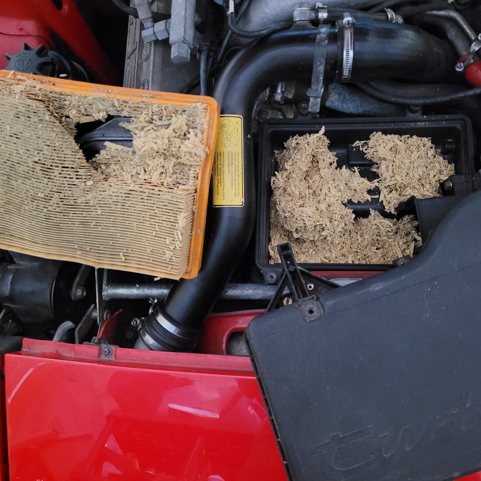

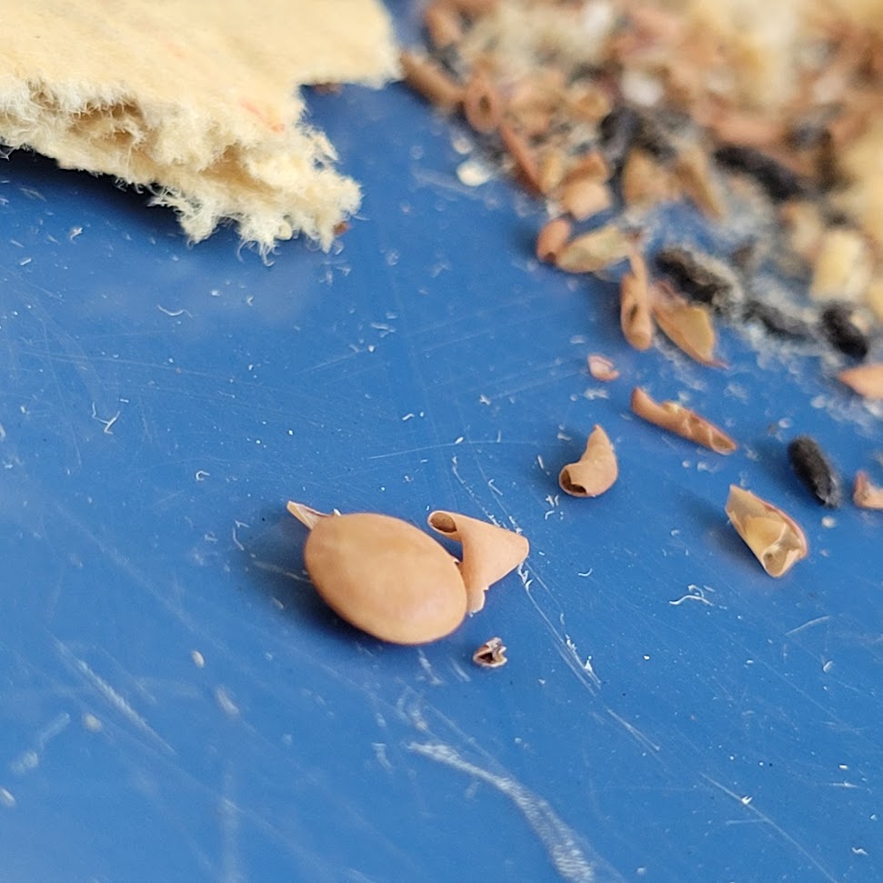

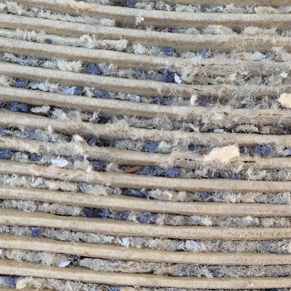

Well I think I might have found the problem. Or at least, *a* problem. The ignition stuff didn't fix it so I decided it was time to pull the airbox and do a leak test. I wasn't expecting the filter to be great after the car has mostly sat for the last few yeas, but I definitely wasn't expecting this either...
I don't know when I last opened the air box. It's definitely a few years because I just haven't driven the car much in that time.
It has to be the work of a mouse. There are lentils in there. Lentils!
The question is how much of this stuff, lentils and all (and how much mouse) did my engine injest? I won't know until I get a new filter so I can drive it. But it looks like there's more than enough air filter material there for the hole in the filter so I'm hopeful that not too much stuff went in there. The turbo could be toast, fingers crossed though!

Darn it, filter-eating rodents was going to be my next guess! :shifty:
It's official, now I've seen everything. Sorry that happened. Cue @dr bob and his four-dimensional rodent regulation routine....

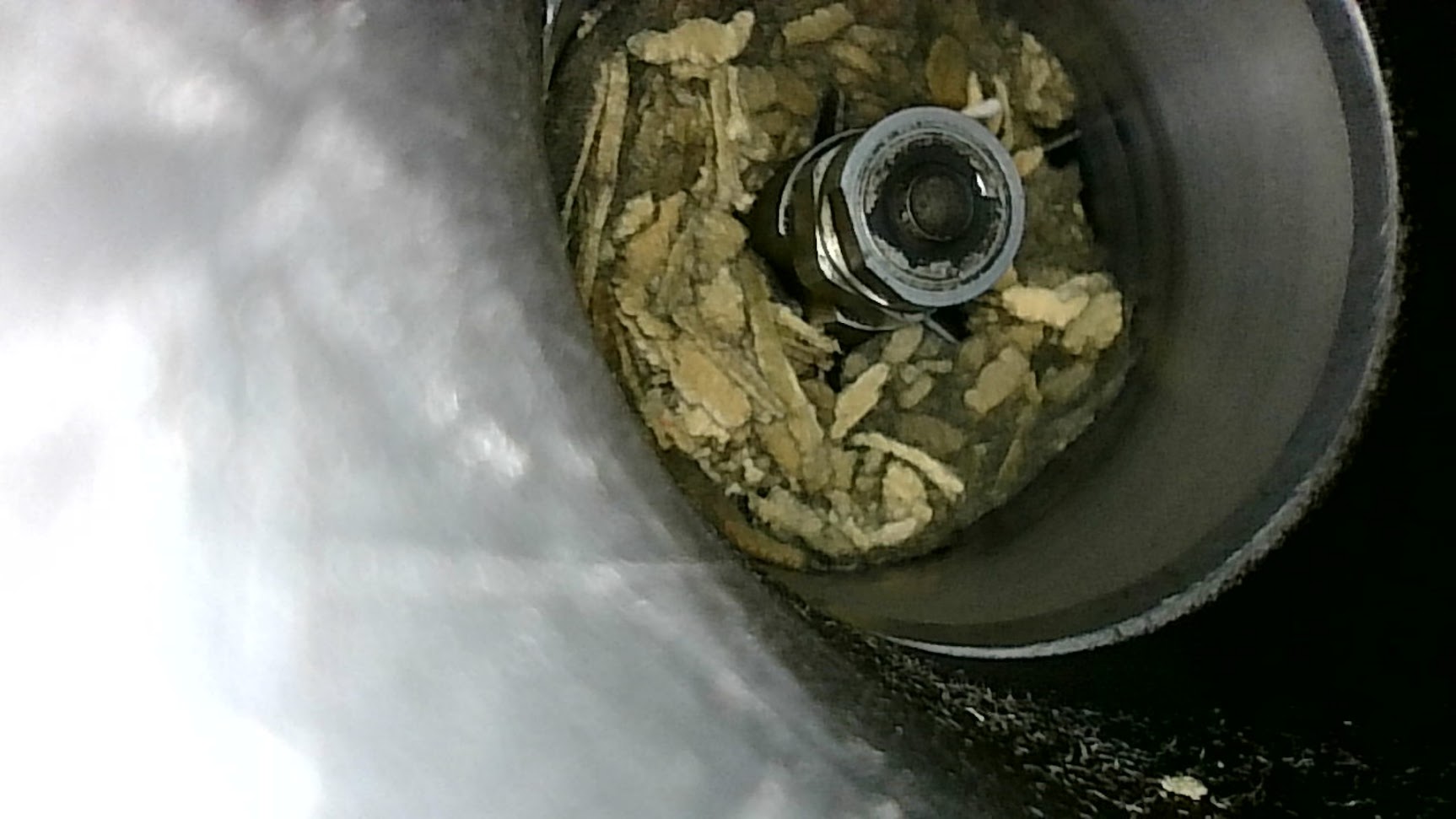

I'd pull the i/c pipes and j-boot and see that you find. You can also get a visual on the turbo impeller that way. I recently used a cheap endoscope on my exhaust and, if I saw that in my car, might be temped to snake one into the intake and cylinders to see if anything is in there.
