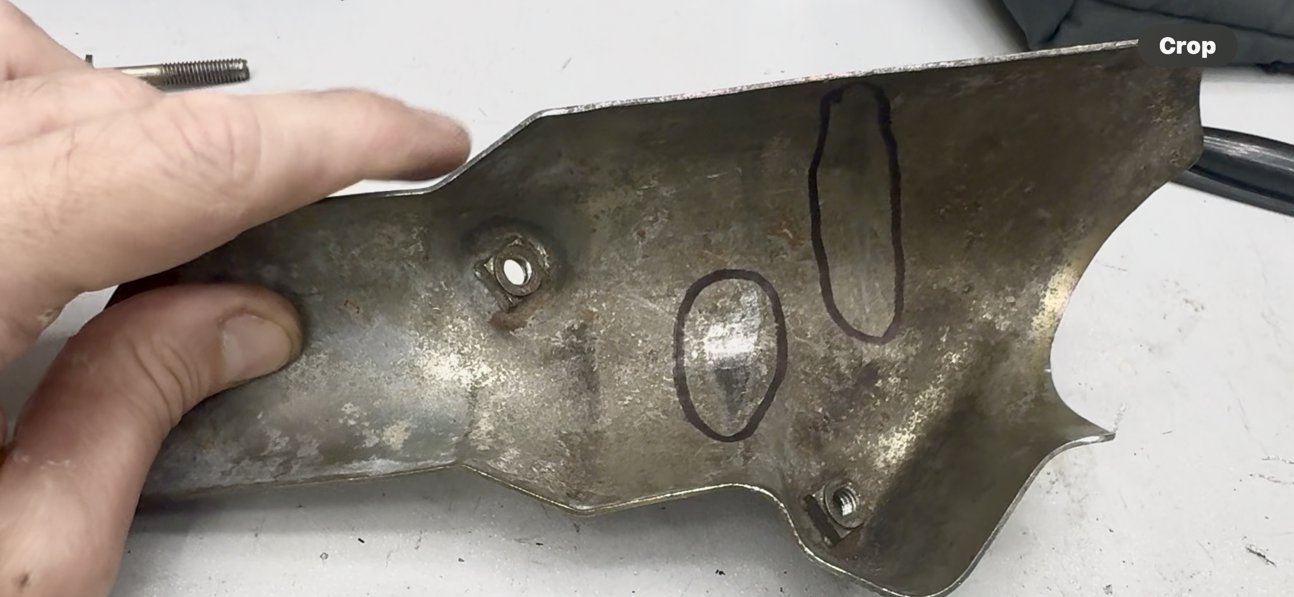

It’s really hard to get a good camera angle with it in the car, but here is the heat shield. I circled the points where it is rubbing. I'll try to get a picture of where the u-joint is attached to the rack after work this evening.

Hey Folks - I hate open ended threads, so wanted to pick this back up with an update. I actually made a video about it on my Youtube Channel (shameless plug). Be nice - I'm new to making/editing videos, have a full time job and family and I'm no Matt Ross. :lol:
Seriously - his videos are great!
Actually, posting the video helped find the source of the issue. My initial thought was that the channel on the steering rack's splined output shaft was the same exact size as the through bolt in the u-joint. It appears I was wrong! Someone placed a few comments on the video and said they had the same heat shield rubbing issue and there IS some play in the channel on the splined shaft.
While I was able to stop the rubbing by grinding away some of the metal on the heat shield, that didn't solve the root cause of the problem. My next step is to do what the commenter suggested - loosen the nut on the u-joint and try to slide it down just a bit more WITH the bolt still inserted. He said it shouldn't take more than a few minutes.......I need to figure out how to get some leverage to push down on that u-joint - without dismantling half the driver's side of the engine bay.
