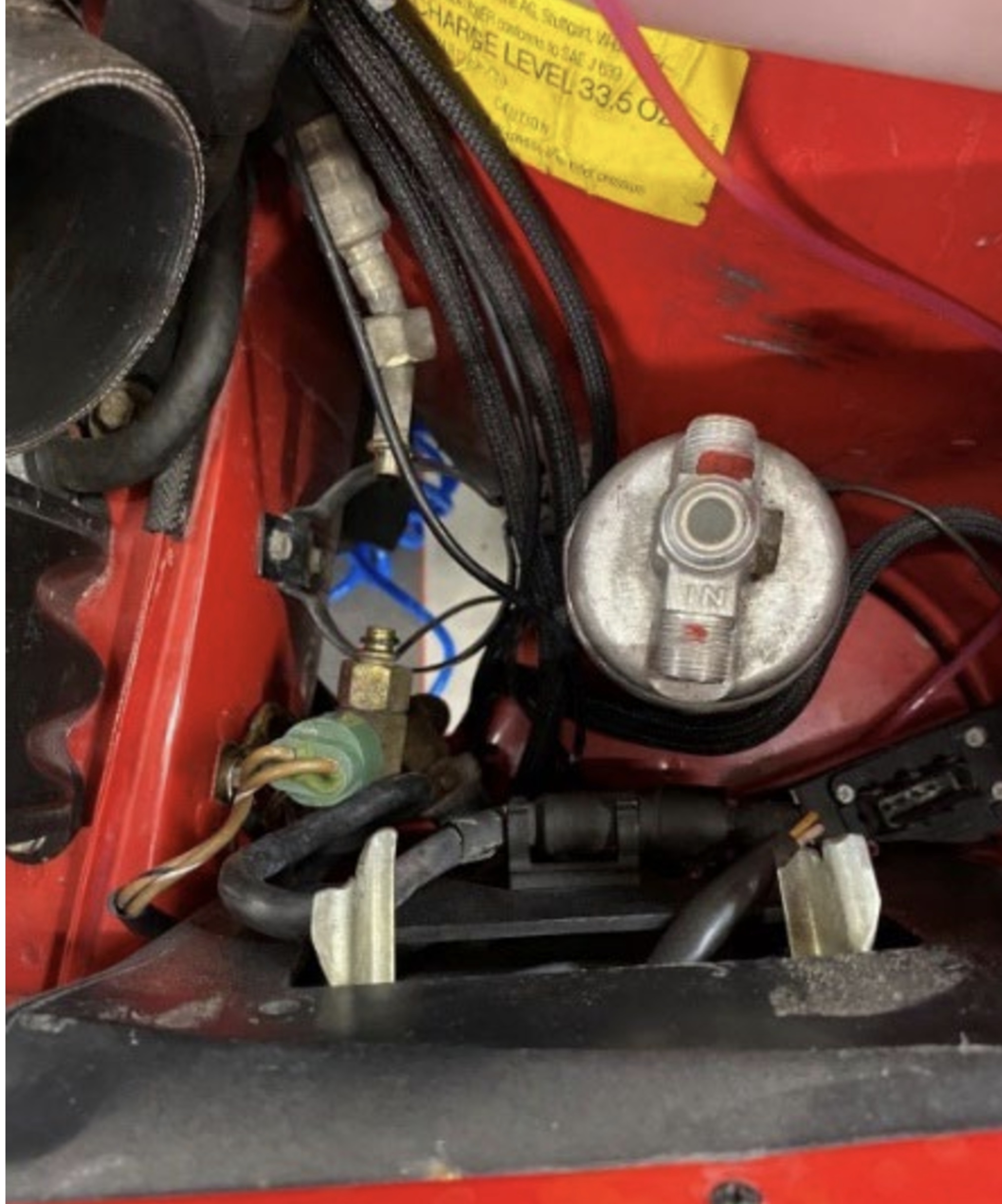

The pressure switch is the green thing on the receiver-drier, in the driver-side headlight bucket. This pic shows it from the top with the receiver-drier siting to the right. Not sure if there is a connector nearby for easy jumping. You can also hotwire the a/c clutch but disconnecting its spade connector and giving it 12 volts positive straight from the battery (with in-line fuse if you're not feeling lucky). You might start by just removing a cap and pushing on the Schrader valve to see if there is any meaningful pressure in there. Should be like letting air out of a full tire, just messier. Wear gloves and goggles. :)

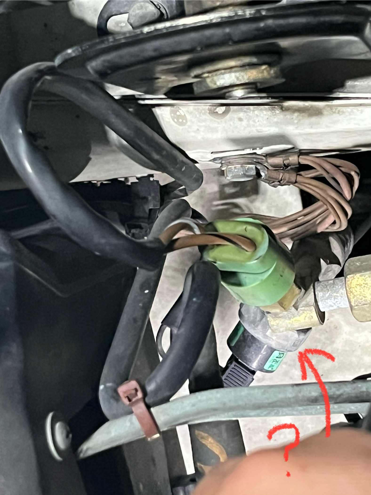

does that green connector just pull straight off? And I would assume that is the one I would need to short between the two terminals on the green part right?
I also have what looks like another pressure switch down there too as indicated by the arrow. Does anyone know what that would be for?

Good point, sorry for the confusing post above. The green one I believe is the high pressure switch, and the one you point to is the low pressure switch. The few times I have had to jumpstart the air conditioner, I just use the spade connector on the compressor itself as I mentioned above, so I would need to dig in a little to confirm that, but pretty sure. I bet @gb951 can confirm. I think the connectors do just pull off the low pressure switch with spade connectors. So if you suspect low pressure, that may be easy to jump...
gb951
Posts: 80
Joined: Mon Apr 03, 2023 10:09 am
Has thanked: 23 times
Been thanked: 36 times
I have pulled the spade connectors off that switch in the past and have used a jumper to cycle the compressor.

No, no, I was referring to my own post because I pointed to the green high-pressure switch instead of the low pressure switch below it.
