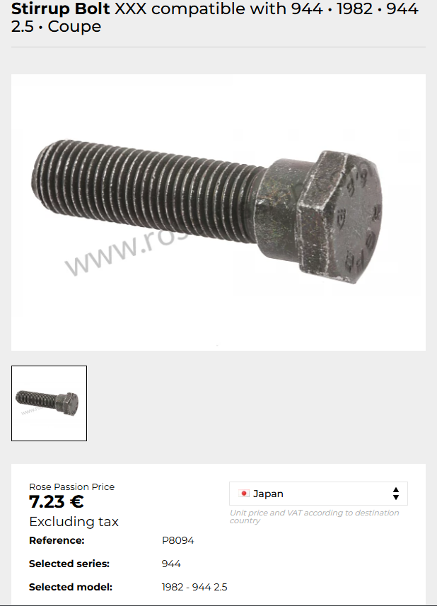

I'm struggling to find a bolt for mounting the seatbelt buckle to the seat. I went to Porsche Seaside and they said this bolt (P8094) has been discontinued. I tried searching online but am having no luck so I'm curious if anyone knows a secret site that may have some in stock OR if anyone knows a similar bolt that will work. I would love to use the OEM seatbelt instead of my 5 point harness to drive around the car. Cheers

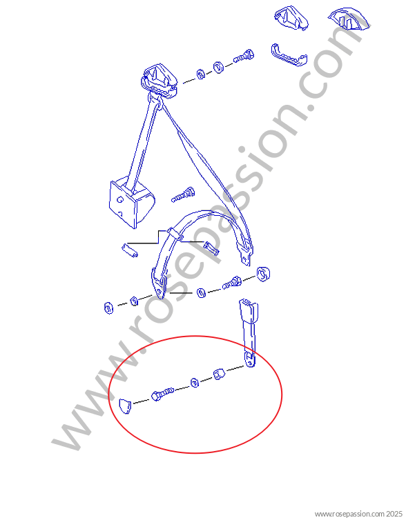

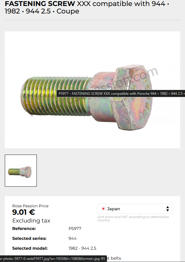

Attached I shown some images of possible bolts, seeing that this website shows that the rear bolt shares that part number, I'm curious if I can just use the rear bolt. I'll check it out today.
The bolt with part number from the dealer but shows for rear belt.
According to this website this is the actual bolt.
The bolt assembly
The bolt assembly

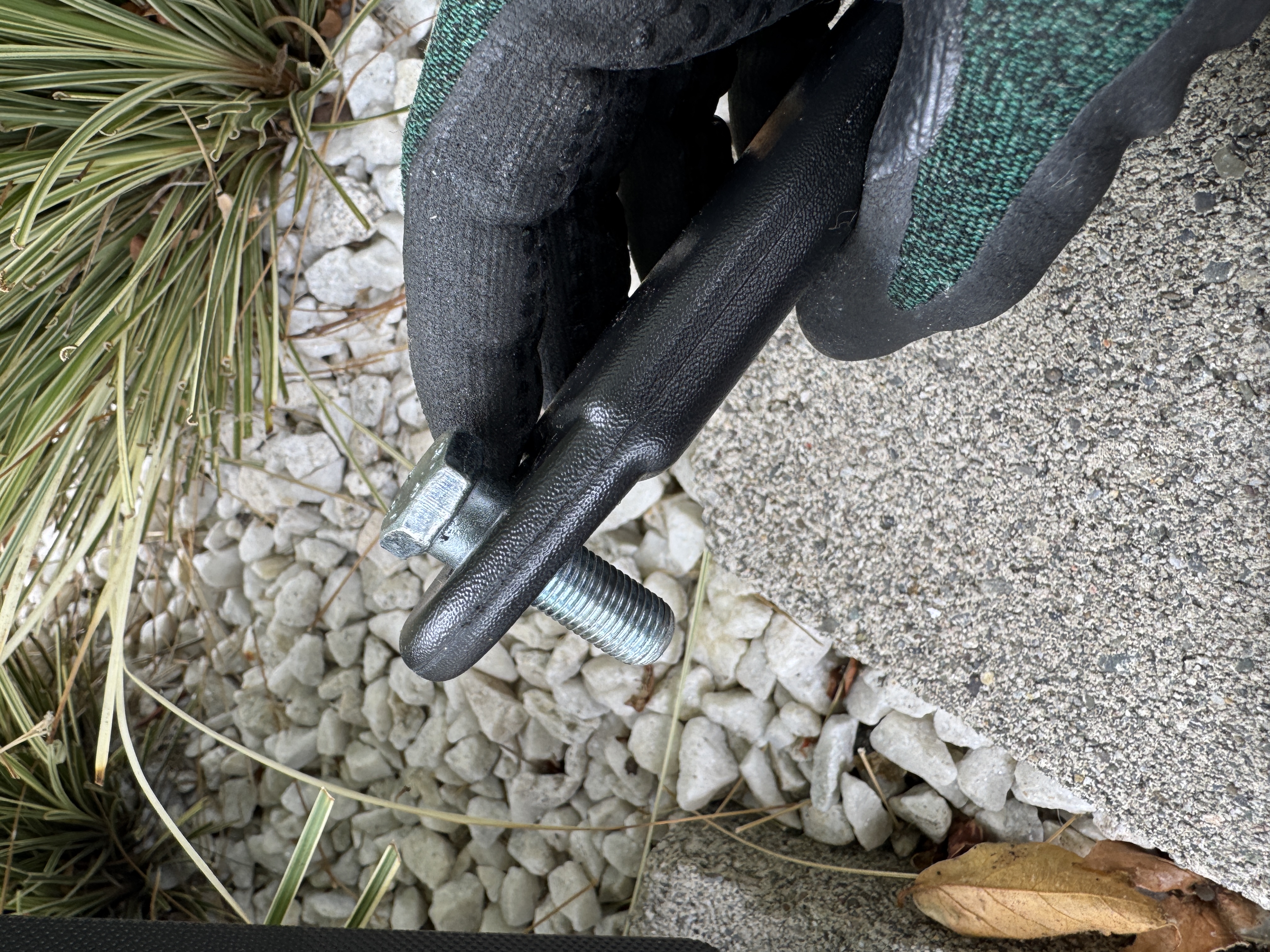

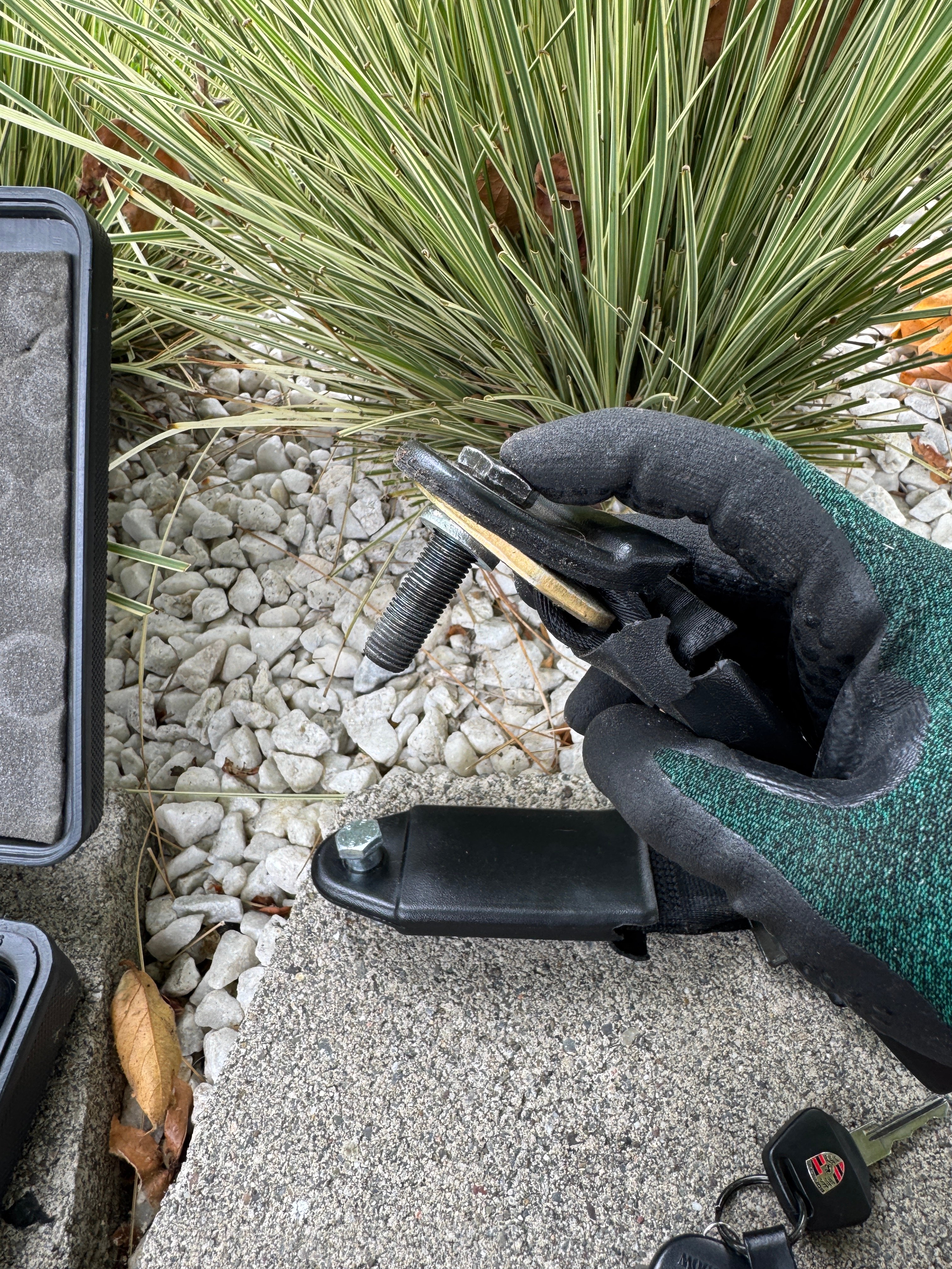

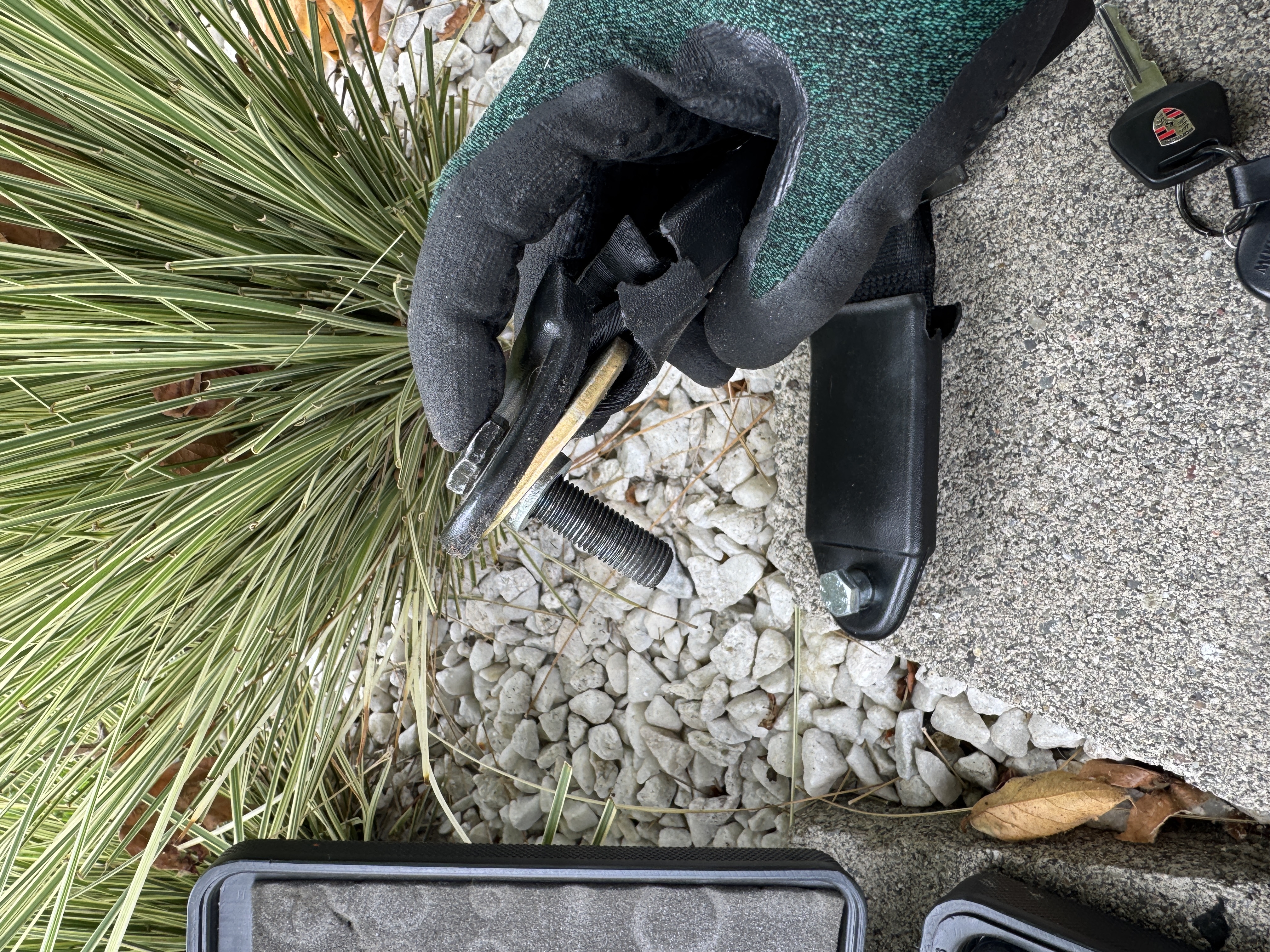

Okay I made it work! I took one of the bolts from the rear seat buckles, removed the spacer and added the plastic washer and regular washer. However, it runs against the carpet on the tunnel but I’ve managed to thread it in and torque. Used the silver bolt as it was shorter with the washers from the black bolt
