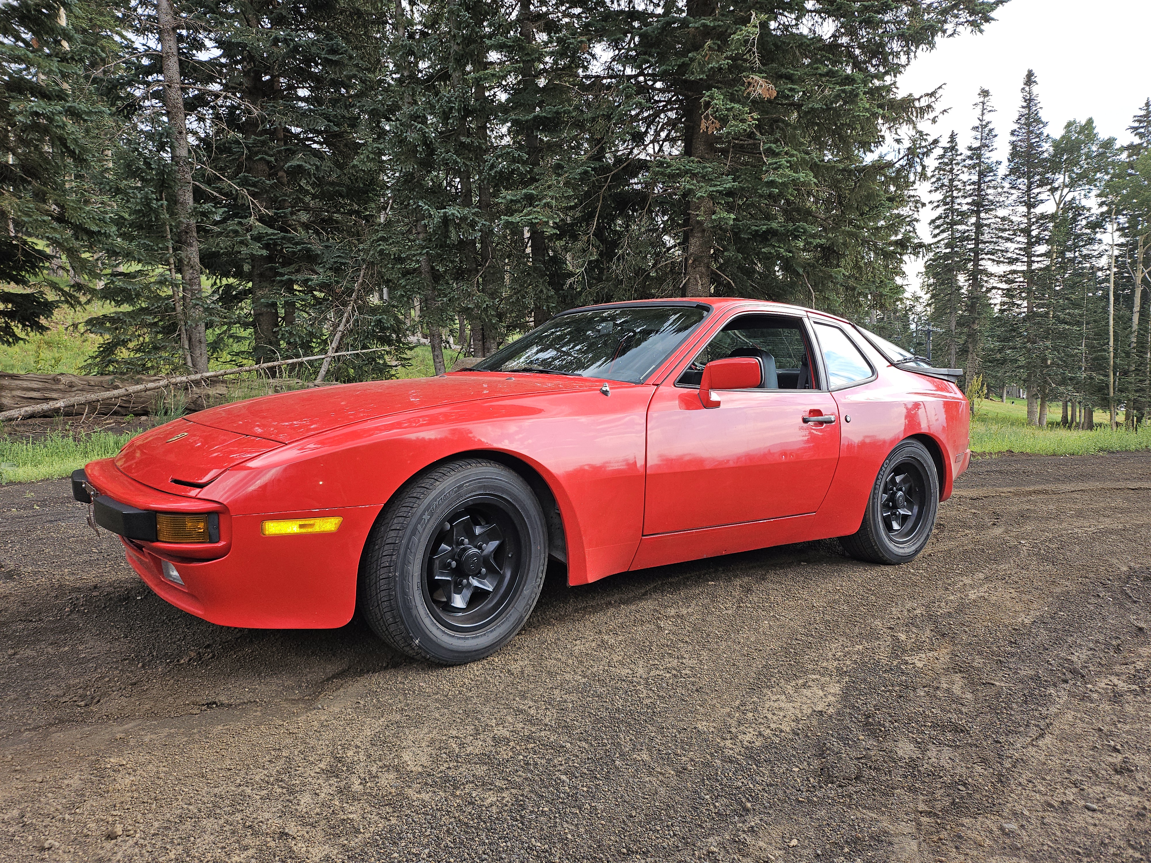

My baby got the forbidden glitter! Ran great till it had a mysterious dip in oil pressure and then made horrible noise. Of course it was right after I rebuilt the A/C compressor (which then leaked!) on the test drive. And no, not related, just a coincidence. Drained the oil, and found glitter chunks of bearing and debris in the oil filter. Still had plenty of oil, not overheated, it just ... failed. Nice car overall, and its a blast to drive. If I don't go overseas for a new job I'll pull the engine and inspect, not gonna leave it in pieces for 2 years in the garage.
So, if I pull the motor and find more than just the bad bearing, like scored journals and cylinders, what do I do? If its just a blocked oil passage (motor was rebuilt(?) by previous owner, but I don't know much about his skills) or damaged bearing from the chocolate milkshake experience, I should be able to fix it; and I will. But serious damage? then maybe some kind of upgrade? (no smog test where I live, so many options)
