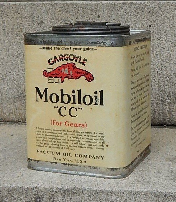

vintage-gargoyle-mobiloil-cc-gear-oil_1_f429c9fda803d963f0a71d3db76bd111-3673391201.jpg
vintage-gargoyle-mobiloil-cc-gear-oil_1_f429c9fda803d963f0a71d3db76bd111-3673391201.jpg (191.5 KiB) Viewed 457 times
Ignore the recommendation for use in Fords. It works fine for other makes too. Coats and Cushions the gears for quiet operation.
