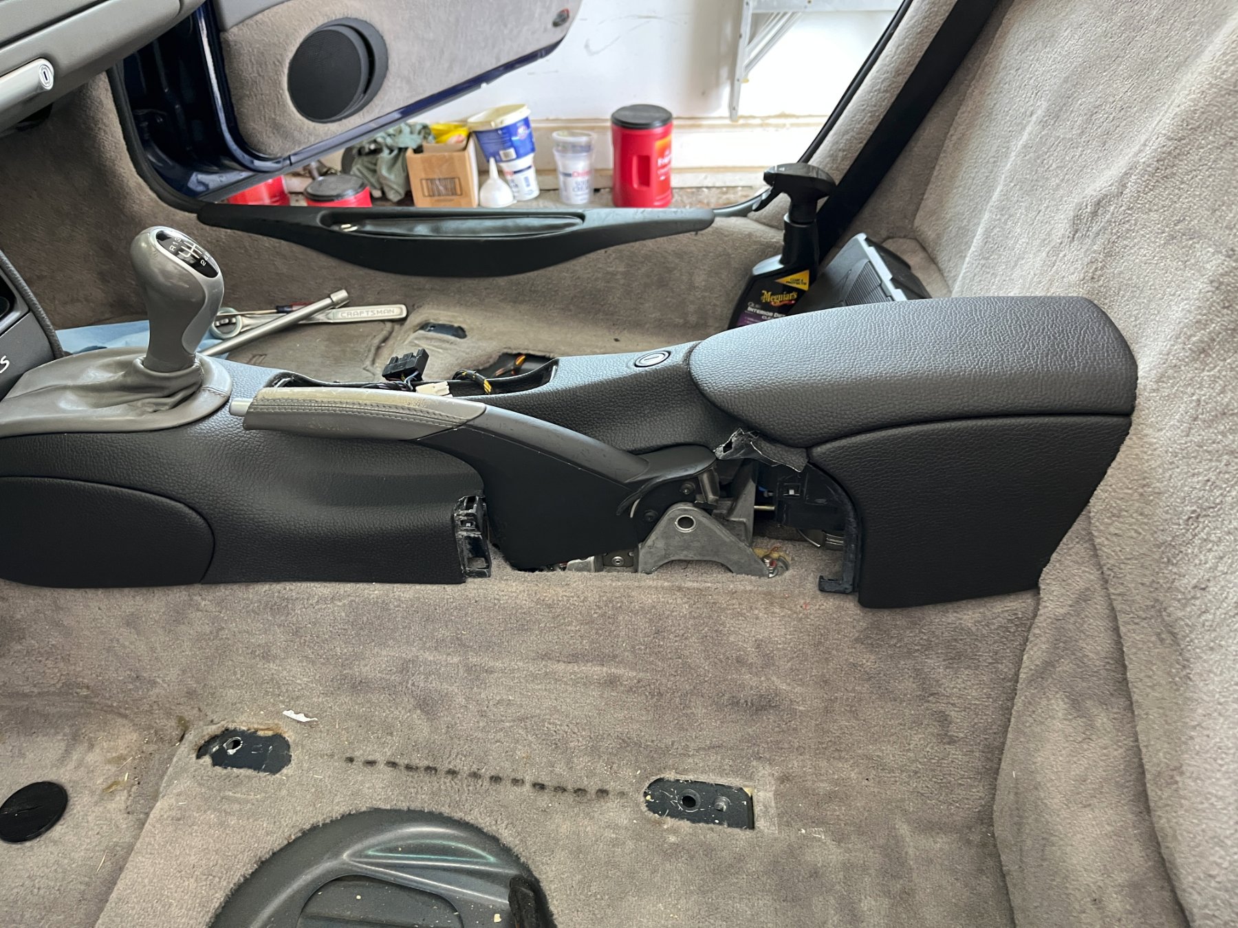

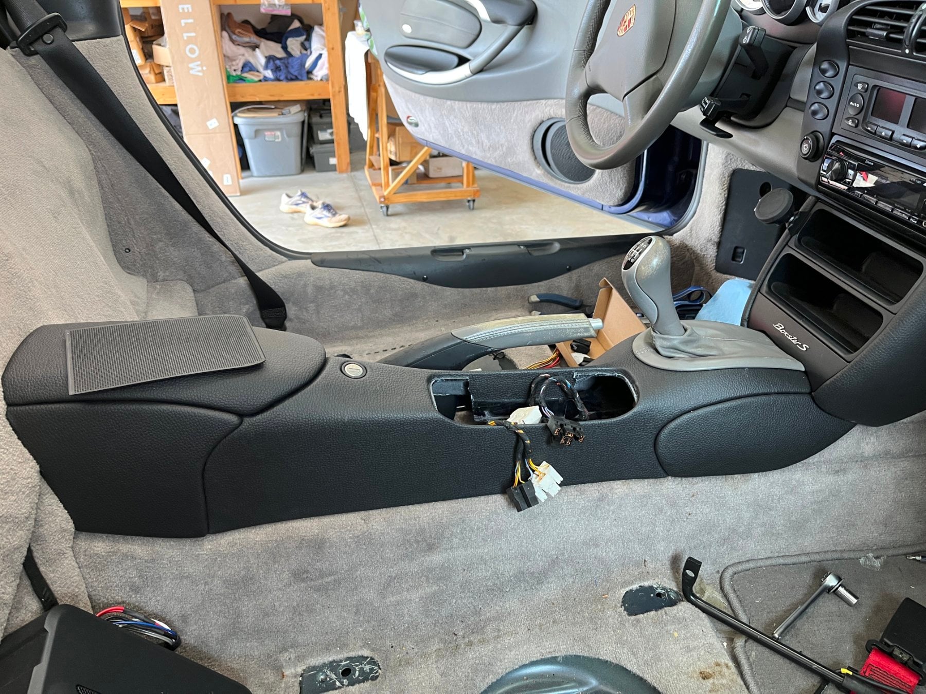

First attempt to post pictures.
I should have documented the process. It was easy, just very time consuming. Re-installation really required at least the passenger seat be pulled. Pulling both made things much easier.

I have an update on my use of vinyl materiel. Went to the Tail and The Rattler for the week. The sun caused some of it to peal up. Make sure you use FRESH glue. Use plenty of heat to stretch the material so it lays very flat. There are way to many hills and valleys on the console. I use 3M General Trim Adhesive Part # 08088. The upside is I can pull the console quickly!

This is an update on my reburb of my console. I pulled all the vinyl I used off and reapplied the original Porsche vinyl on the 4 pieces initially covered. I cleaned and sanded all the glue off and painted the console and vinyl with SEM Color coat obtained from my local auto paint shop. I was told to let the paint cure at least 3 days before installing. I think I waoted a week. It seems to be a very solid and durable surface and it looks great. If I had to do over would have started with the SEM Color Coat (flexible coating for vinyl surfaces, flexible and rigid plastics, carpets and velour).
