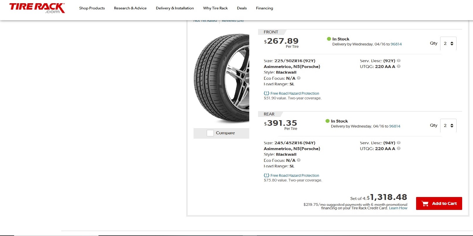

Tire Rack has a few options for the 944 turbo S

@dds28, I looked again last night and that Pirelli showed up for the first time. Prior to that it was only competition tires and the p7.
With that said, I was hoping there would be other options besides the Pirellis, I have never had a set but they have never been a brand that I have had a desire to try. If anyone has had any experience with them, I would love to hear your thoughts.

Yokohama A-008P is pretty much the only option, other than Pirelli, and Puck Firelli. Prices are insane, but you can get 205/55R16, 225/50R16, or 245/45R16. Basically they were meant as a "classic car tire" and Yokohama finally started selling them outside of Japan in the last year I want to say.
Prices as of April 13th, 2025.
205/55R16: $230.16
225/50R16: $314.84
245/45R16: $323.13
https://www.tirerack.com/tires/yokohama-a-008p
