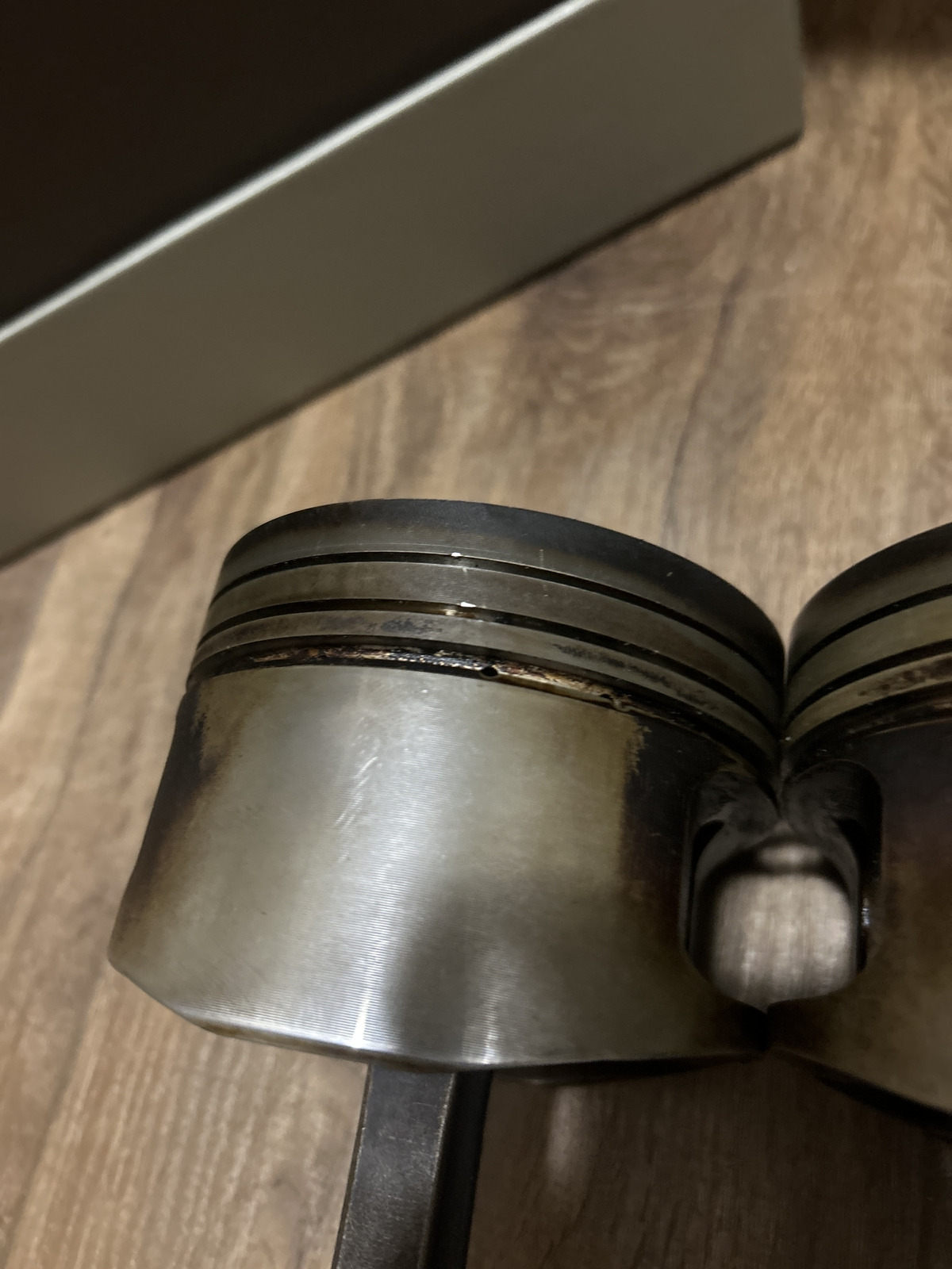

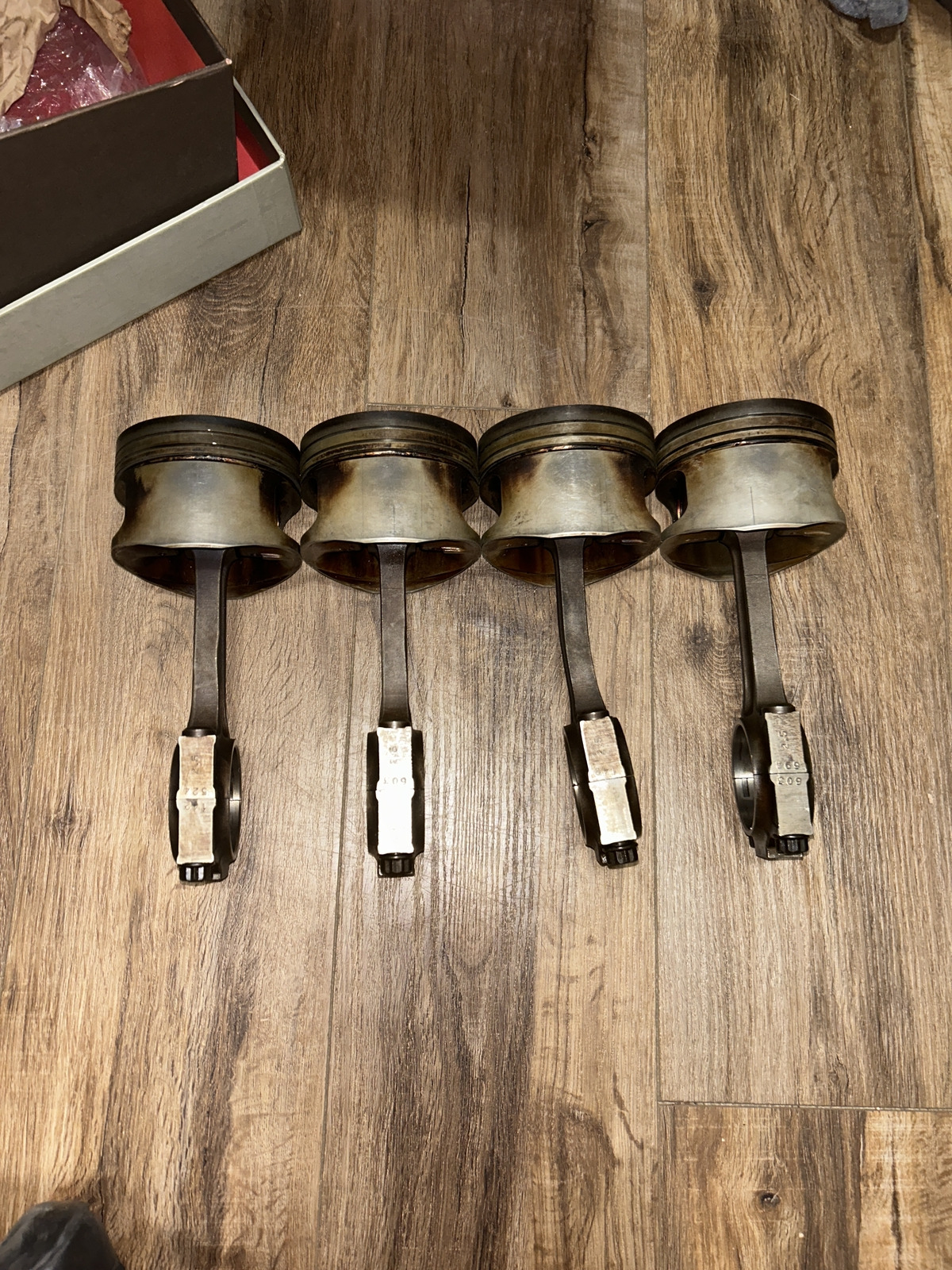

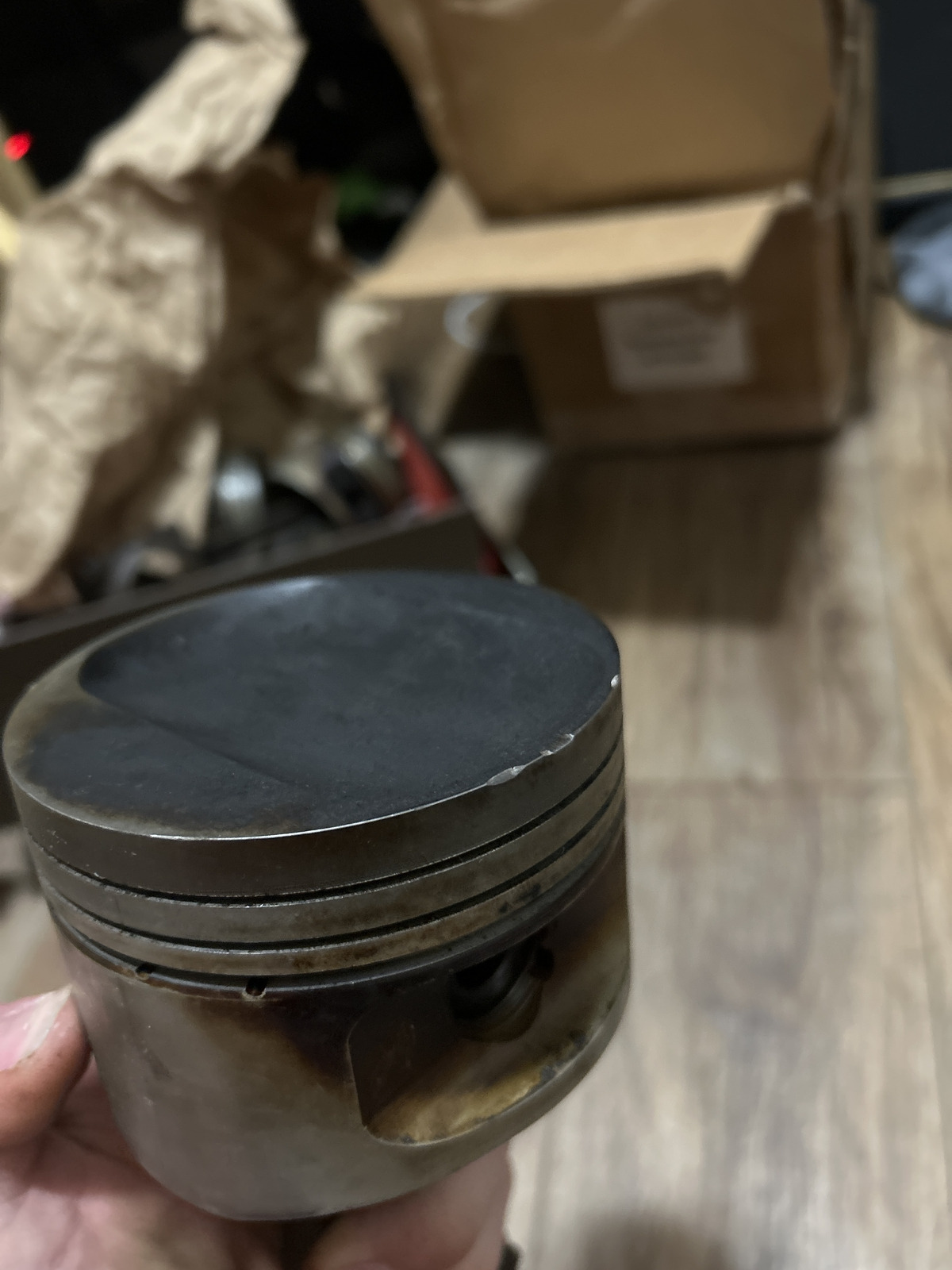

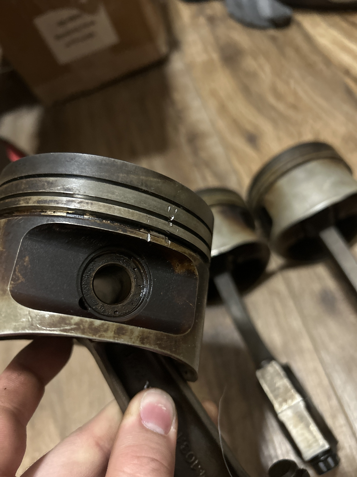

I recently bought a 951 crankshaft and set of pistons w/ RARST connecting rods off ebay, the motor they came out of was described as not running, but that they appeared to be in good condition, matching the 120k miles on the odometer(according to seller). They looked great in the photos(maybe I'm just blind :roll: ) , but when i got the pistons/rods, 3 out of the 4 pistons had scratches/dents and are totally unusable, and one of the rods was bent. I'm not sure what happened, but I'm waiting on a response from the seller. Crankshaft appears ok, but I don't know if there is any damage I am unable to see with the naked eye. I am going to attempt to see if ebay will reimburse me for the pistons/rods through their money back guarantee, if the seller doesn't respond by this weekend.

Here are some photos of the damaged rod/pistons

BTW, don't just buy one rod. They need to be a matched set to avoid having to balance them. Get your $ back for them - too many scoundrels on Ebay.
The pistons can probably be used with some very careful deburring to address the damage in the ring grooves. They should also be soaked to remove the grunge and carbon so you can inspect them thoroughly.

That’s good to know about matching rods, I thought that may have been the case but I wasn’t totally sure.
Im worried one of the pistons has too much damage, but I’ll take a closer look and re evaluate. I’d hate to cause damage to my block
