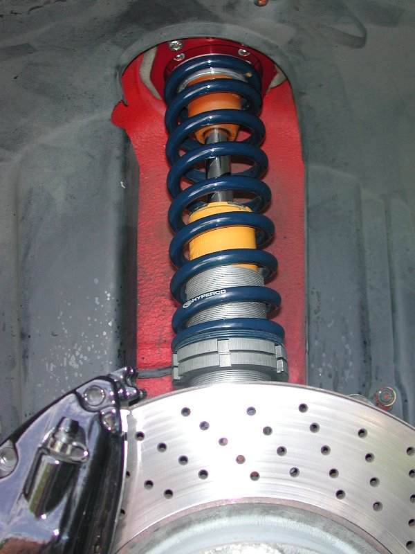

Spencer, if I were going to the trouble of replacing springs on a 1989 951 and I was using the stock Koni struts, I'd be inclined to do what I did with my S2, which was to fit 2.5" ID linear rate springs using a custom lower spring seat that threads onto the M030 collar, a jam nut, and upper seat, all from Racer's Edge. I've been running a set of Hyperco springs on this setup for close to 25 years now (wow, time flies!). I also have Racer's Edge camber plates.
The issue with progressive springs on the track is the handling can change once you compress the spring in a turn and hit the higher rate, making them trickier to drive, I think.
Cheers, Tom
Edit: here's pic of the front spring setup.
Cheers, Tom

I'm running 300 lb/in spring rate, and the spring length is 10 in, but could possibly be a bit shorter (especially if you go stiffer and can avoid coil bind) since there are plenty of threads on the collar. This rate is stiff enough for me on the street

From Racer's Edge:
We would recommend you order two of the following seats at this link: https://racersedge-inc.com/lower-spring ... query=M030
And two hats at this link: https://racersedge-inc.com/upper-spring ... query=hats
Then order some springs at This link: https://hypercoilonline.com/hyper-coilo ... /2-25-i-d/
Stock M030 rate is approx. 170 Pounds per inch. Most street drivers that want a stiffer street spring go to about a 250 pound/in spring. You would need a 10” at this rate. This of course will increase understeer unless you do something to stiffen the rear as well.

No idea. My struts are the double adjustable ones, which of course I never adjustSpencan wrote: Tue May 20, 2025 9:48 am How many turns on your struts do you have it? All the way stiff, 3/4, 1/2?
For the rear I have Koni 3012 coilovers with 275 lb/in 2-1/4" ID helper springs running in conjunction with my reindexed stock 24 mm torsion bars.
