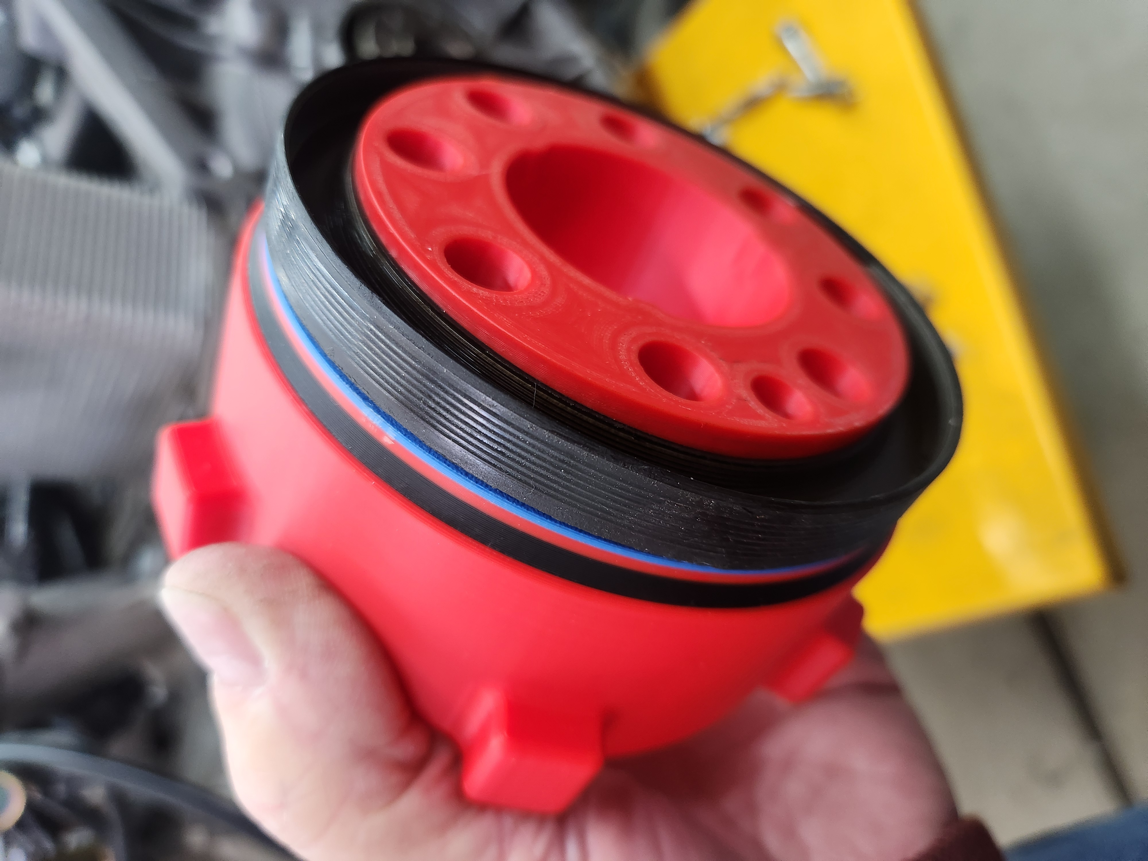

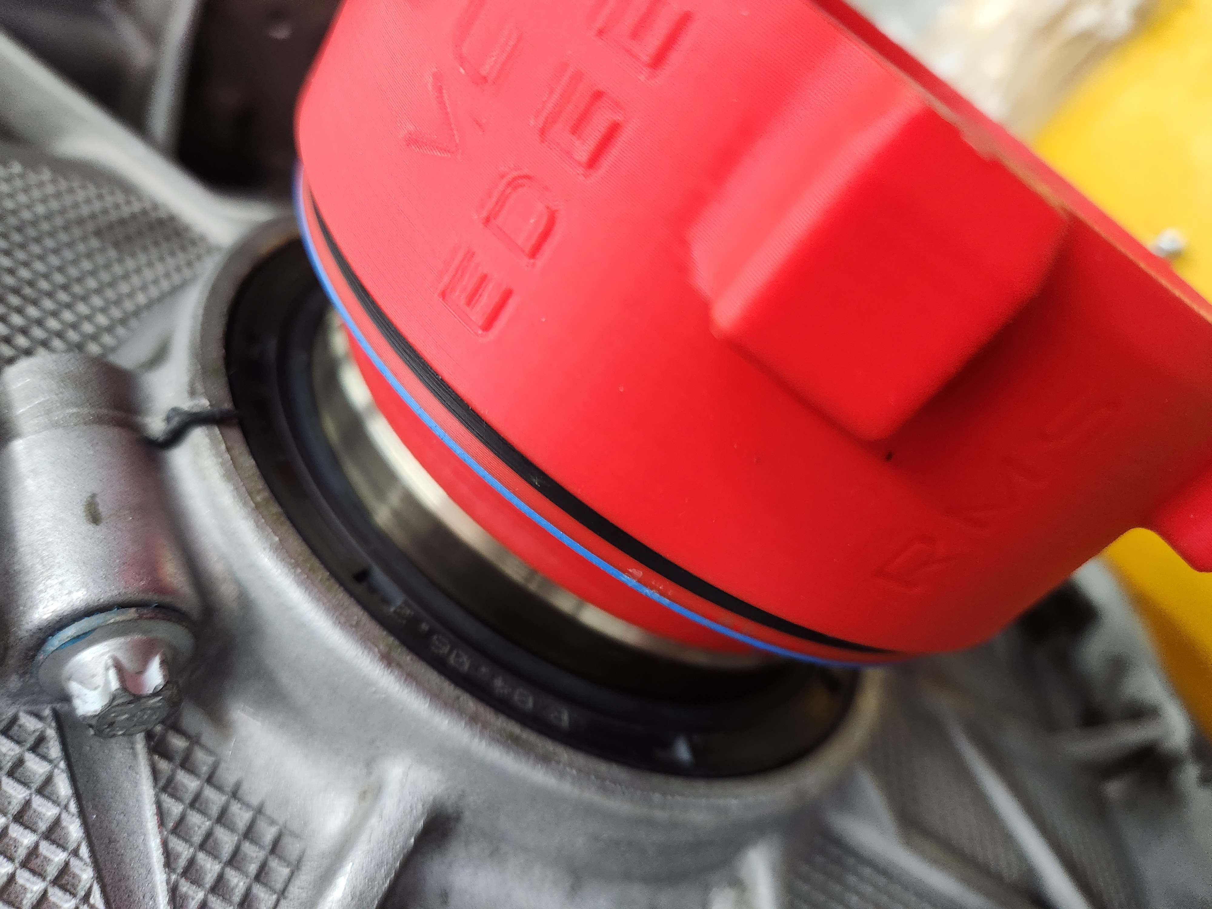

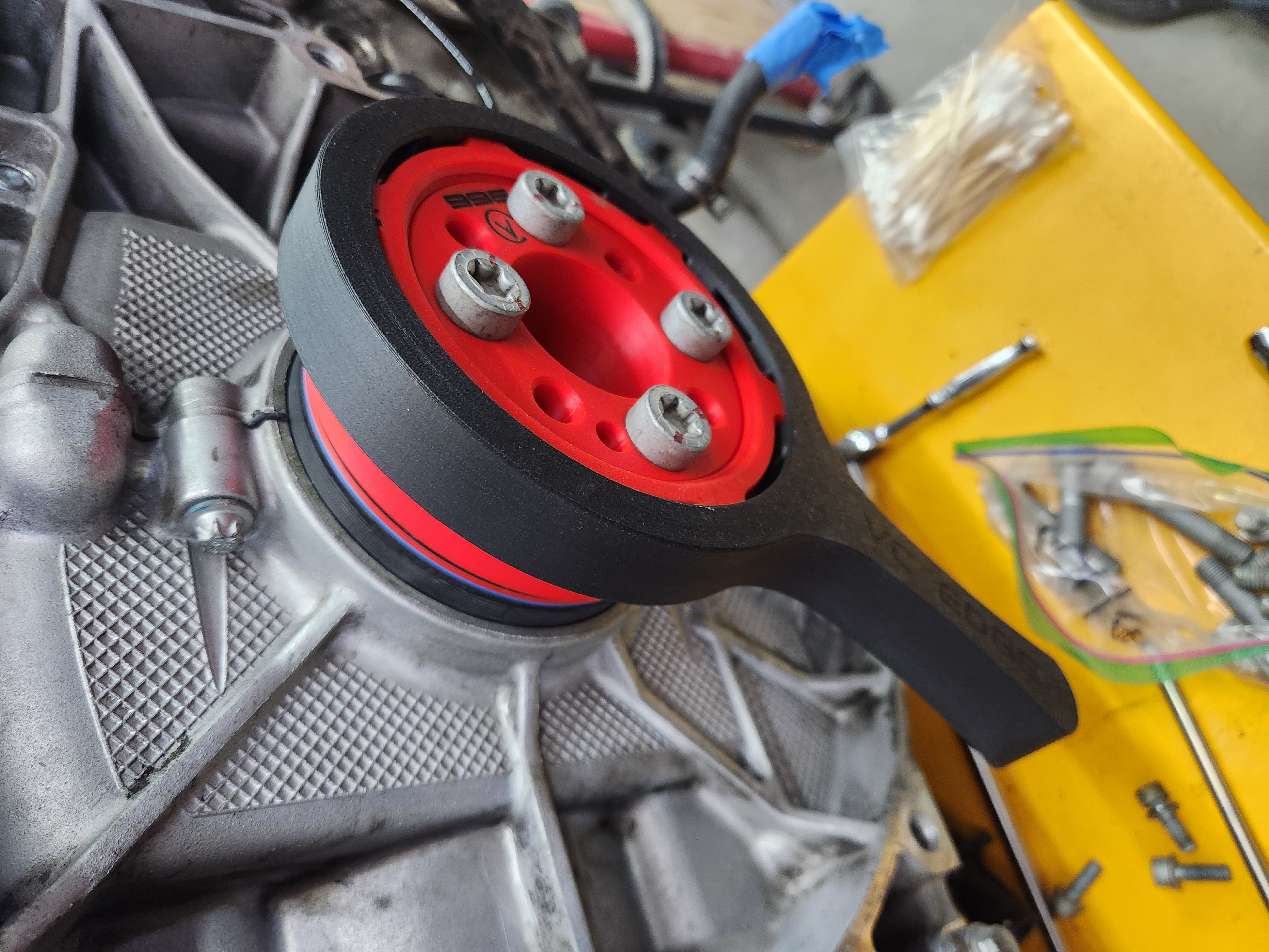

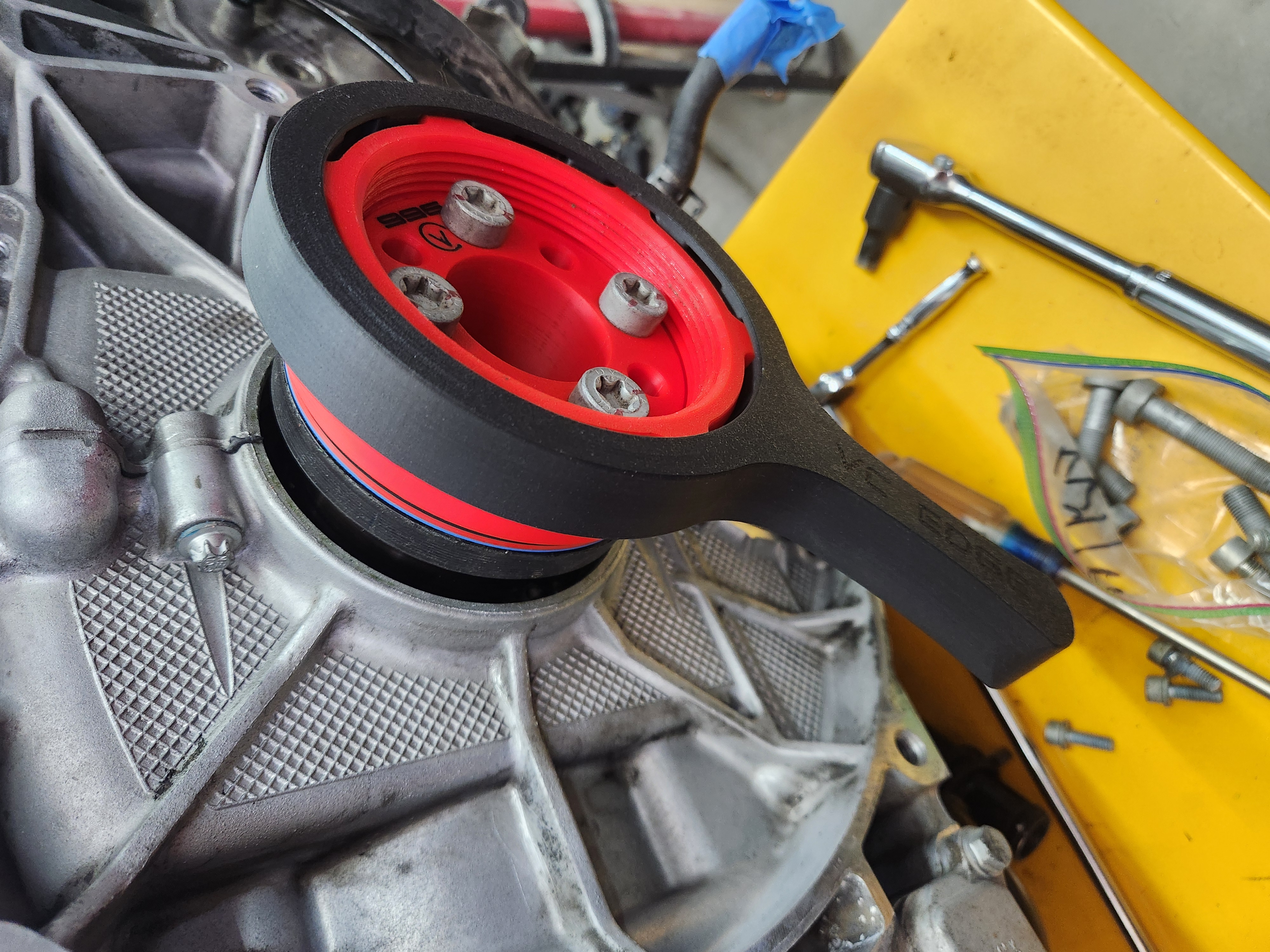

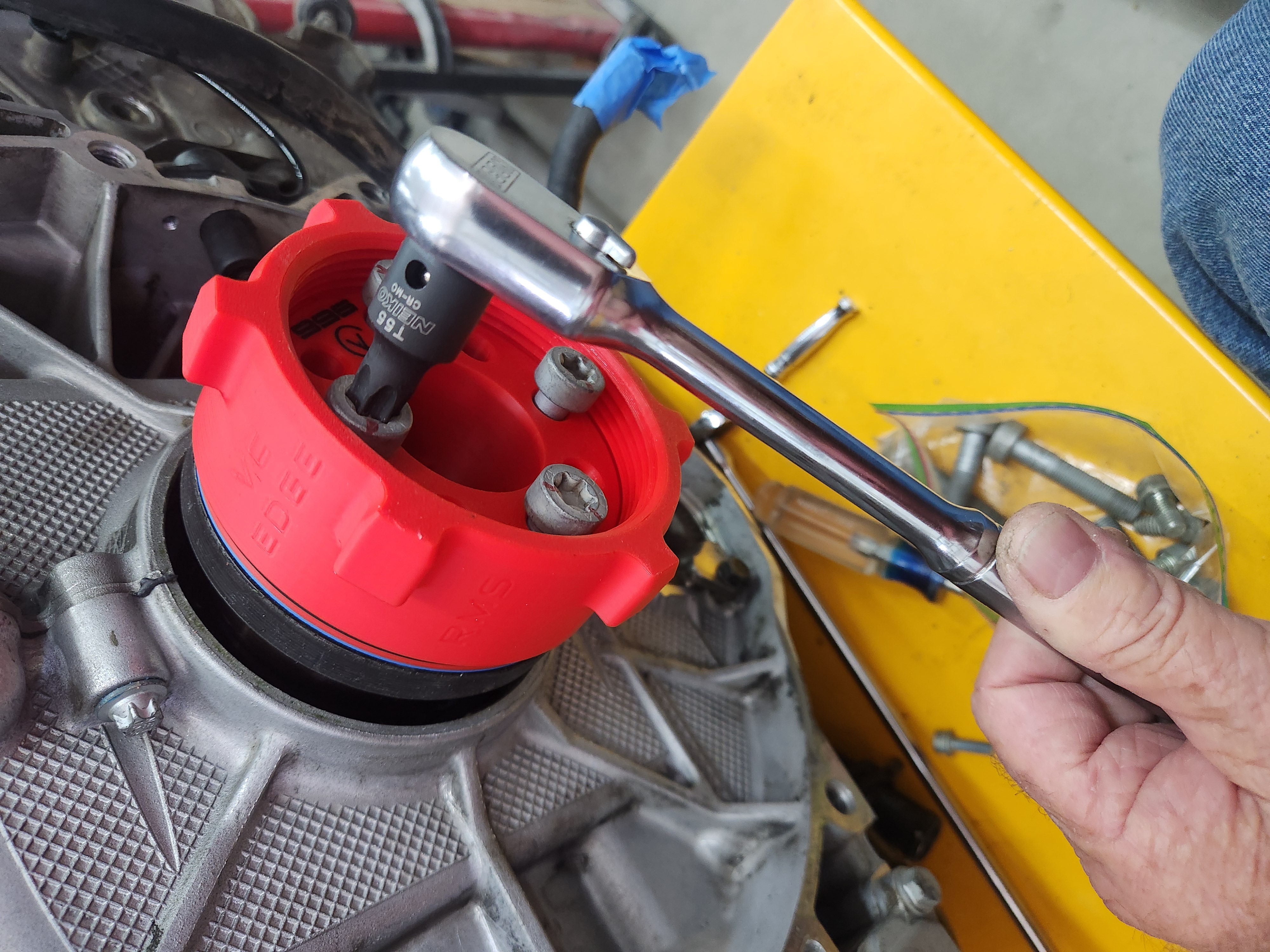

Like many of you I've had trouble getting the Rear Main Seal to install correctly. The Porsche tool is insanely expensive! I found this inexpensive tool that makes it so easy to install the RMS it's scary! Thought you all might like to know about it.
Designed by a custom Aerospace Engineer, Custom knife maker and Porsche enthusiast Jayson Van Camp ([email protected]). I've used his tools to install RMS seals on my 944 turbo and now on my 996 and they work fantastically. Check out the pictures, makes this an easy job to get right.
This link shows the 996 tool but he has the same tool for 944/928 (different crank size/bolt pattern)
