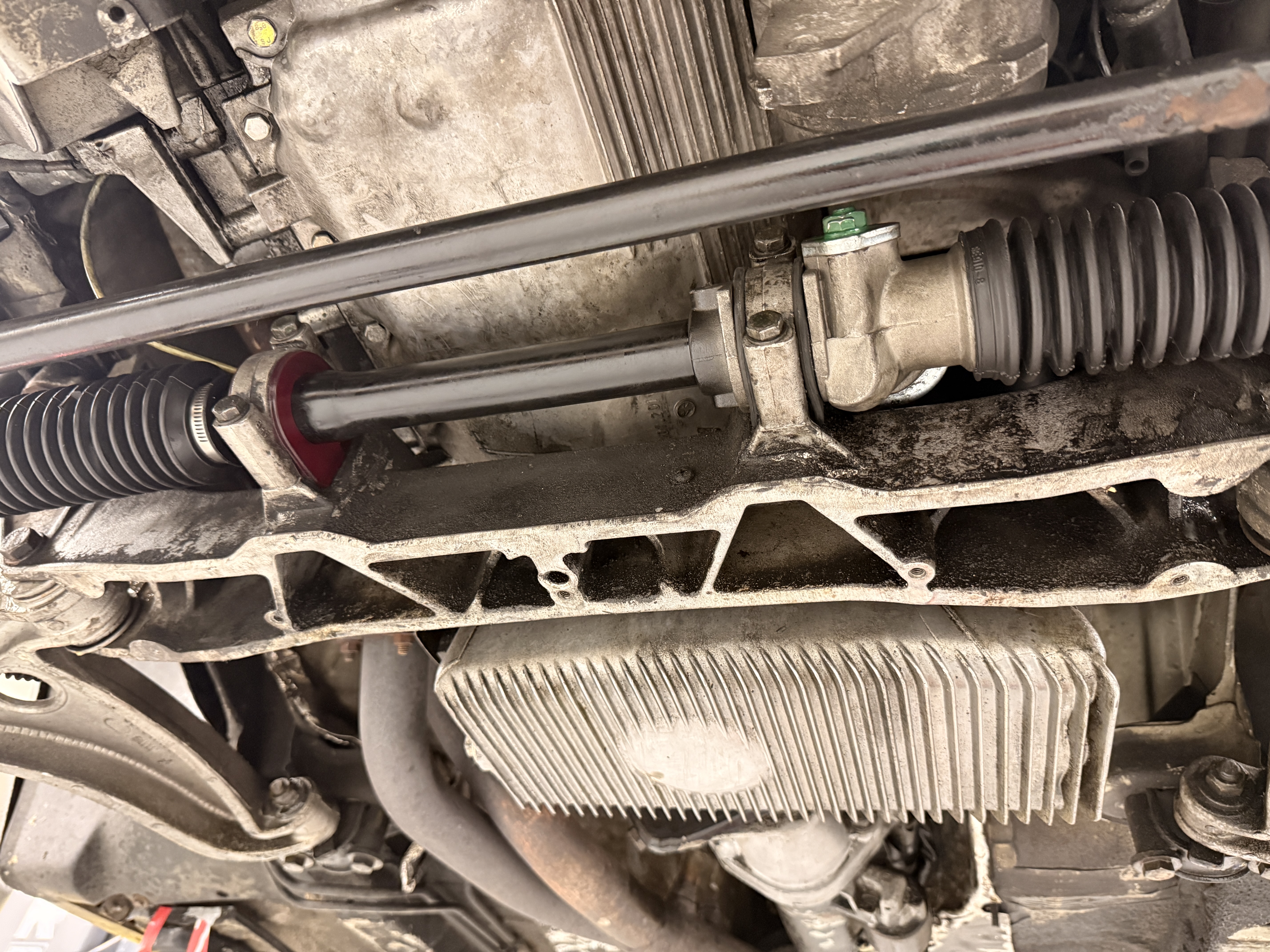

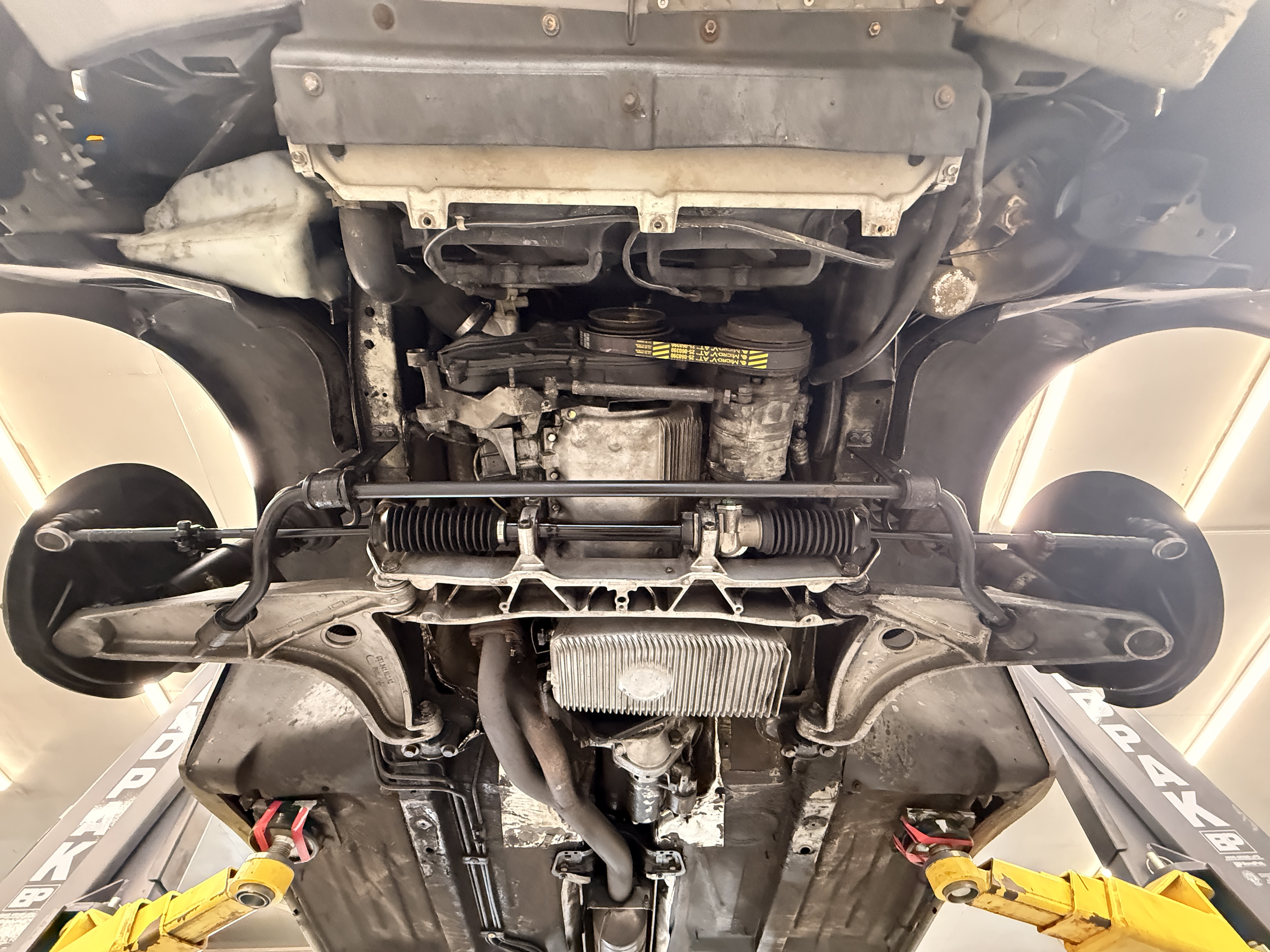

spacecad3t
Posts: 296
Has thanked: 89 times
Been thanked: 72 times
Gaspowered wrote: Tue Jan 28, 2025 6:38 pm Hi Tom,
I know you asked for factory, but you might check out this video by NC944er.
He pretty much uses VW parts that bolt into place.
Cheers
Edit:
It's a kit mainly comprised of VW parts that's made by this gentleman.
https://mwthemachineshop.com/steering-solutions
I have this kit installed, its very high quality, and I would recommend it.
