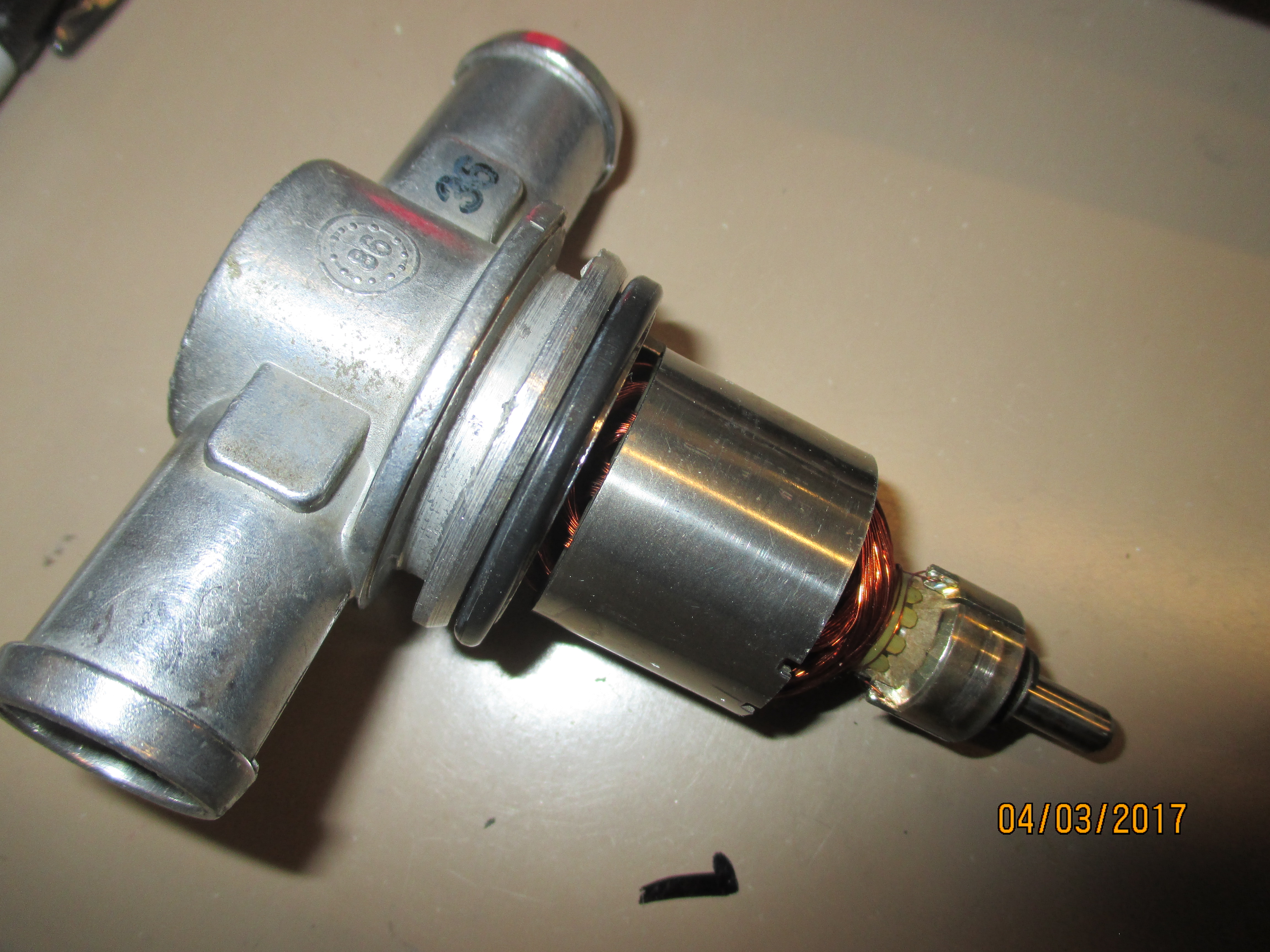

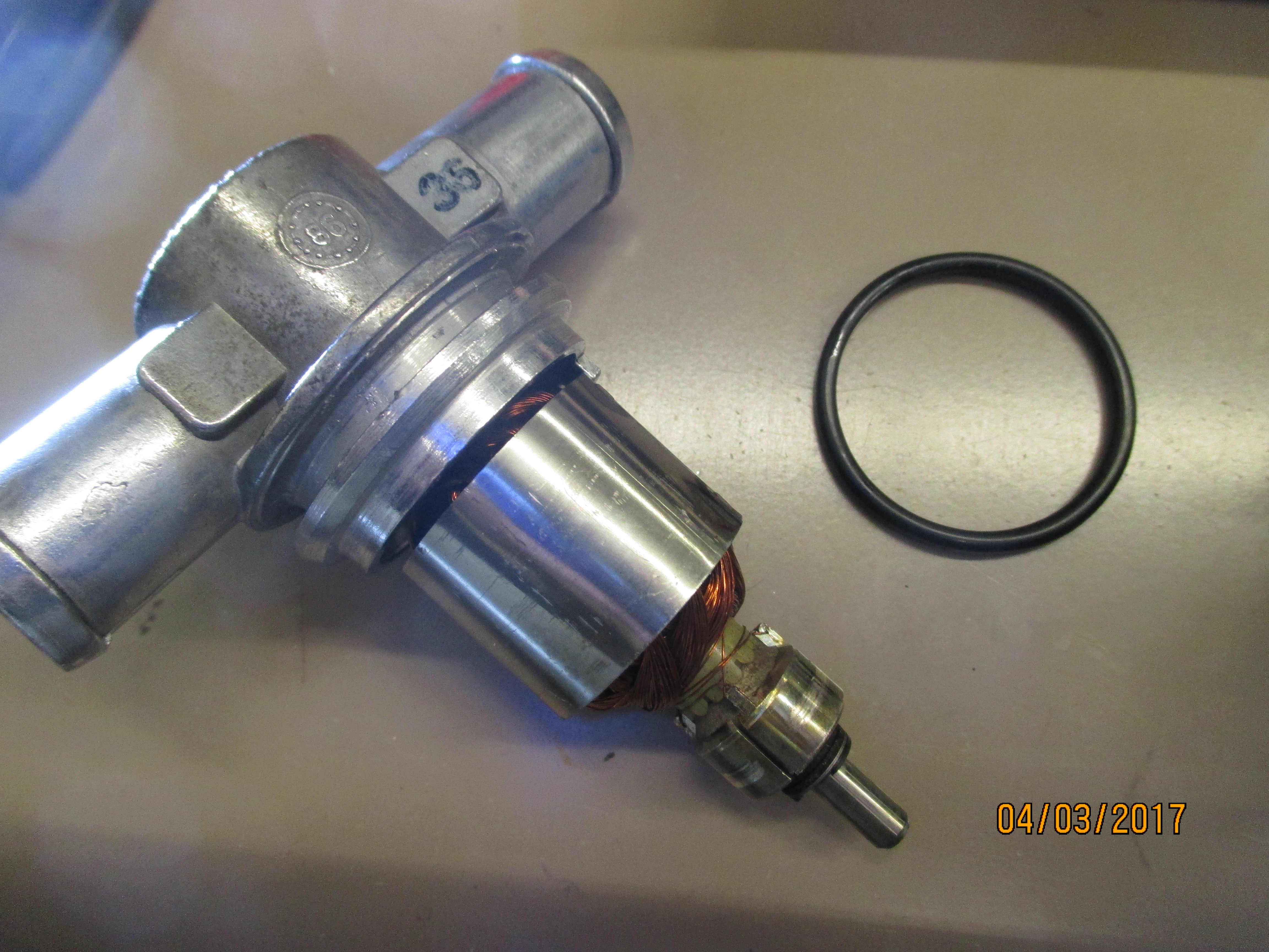

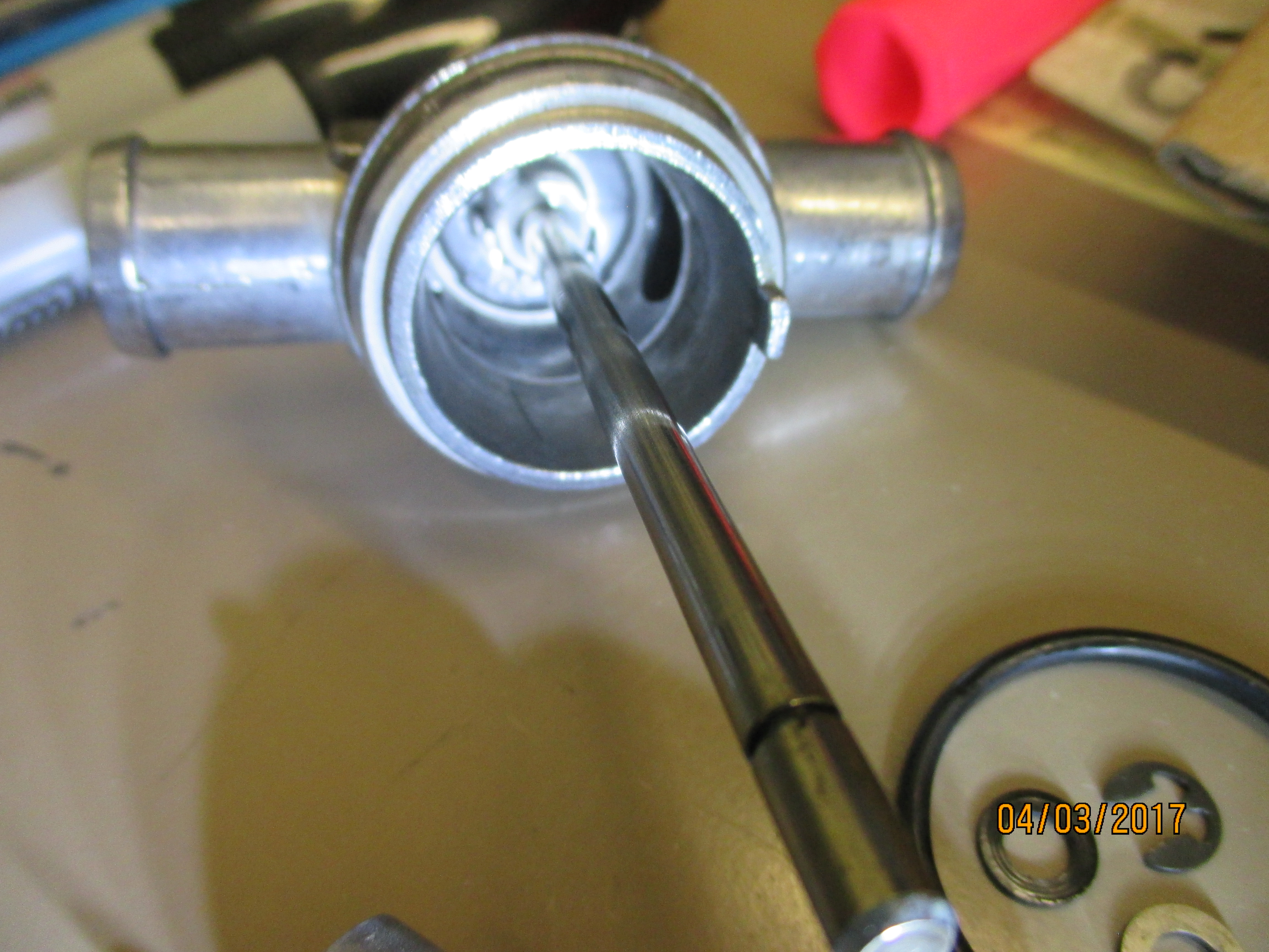

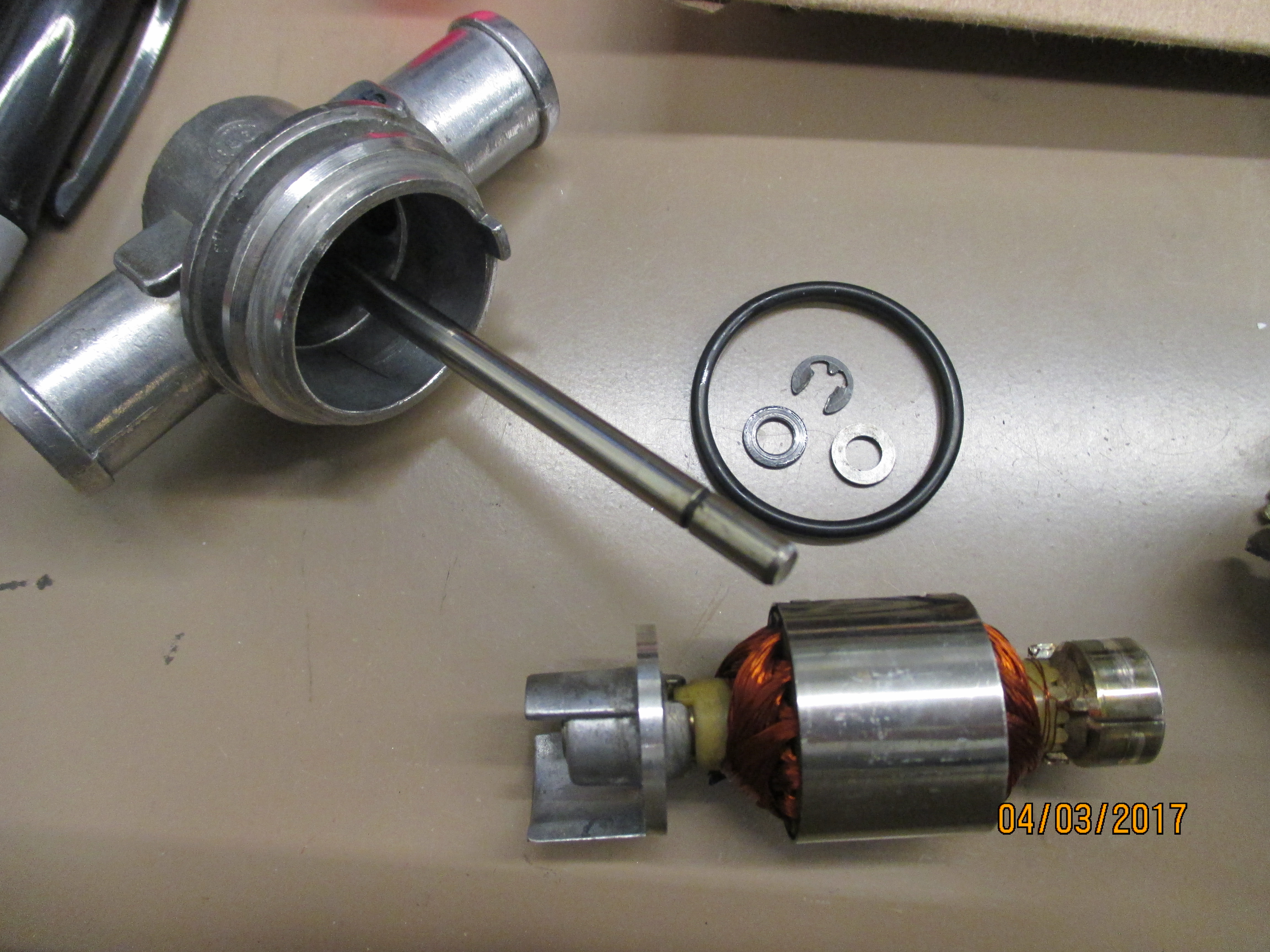

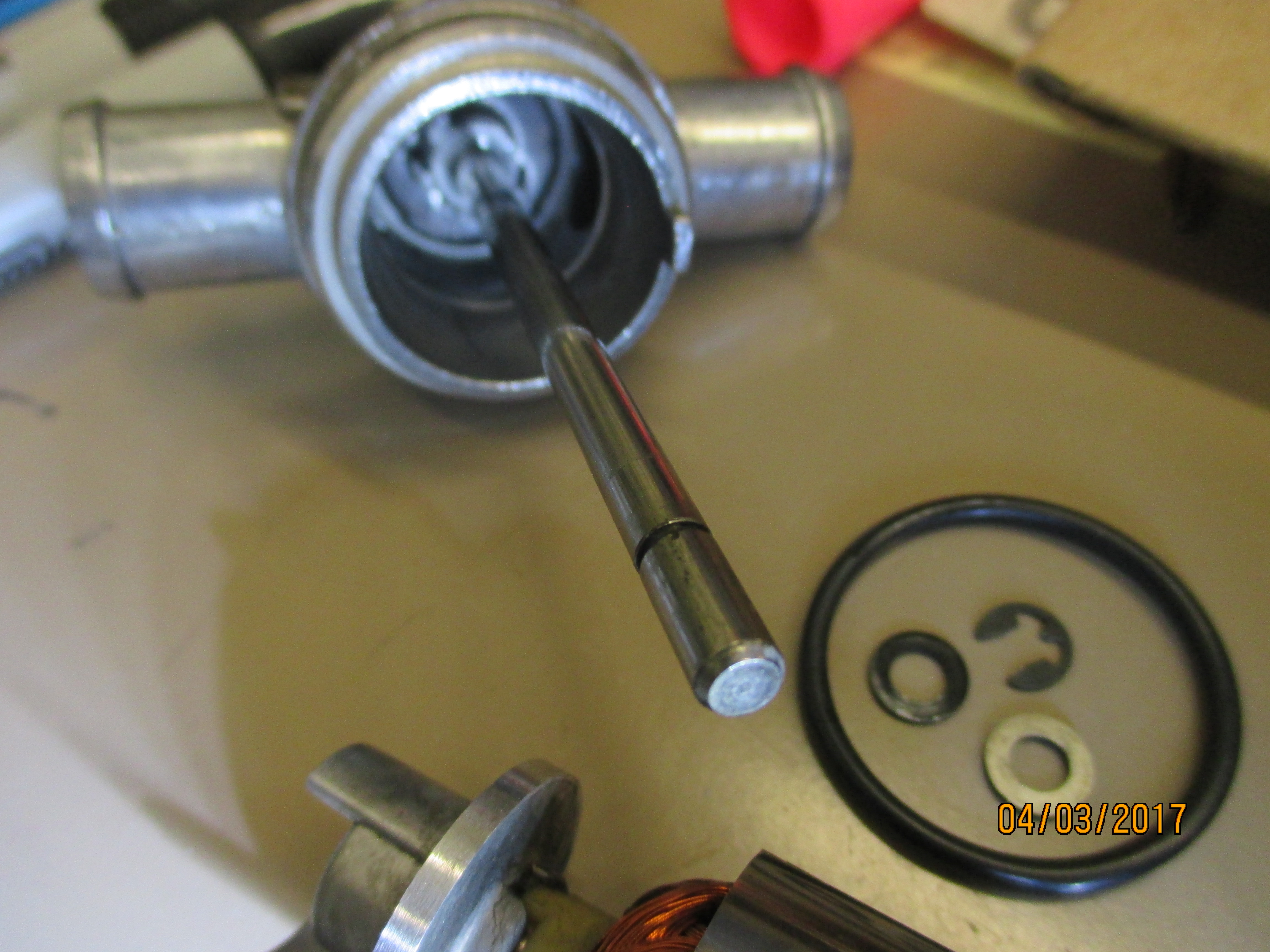

Here are pics of mine I took apart a few years ago.
I measured the O-ring and I get 38mm outside diameter x 3mm thick approx.
The seat where the O-ring sits is 33mm.
I cleaned it with isopropyl alcohol. The alcohol worked very well and it is safe for use on the electrical parts.

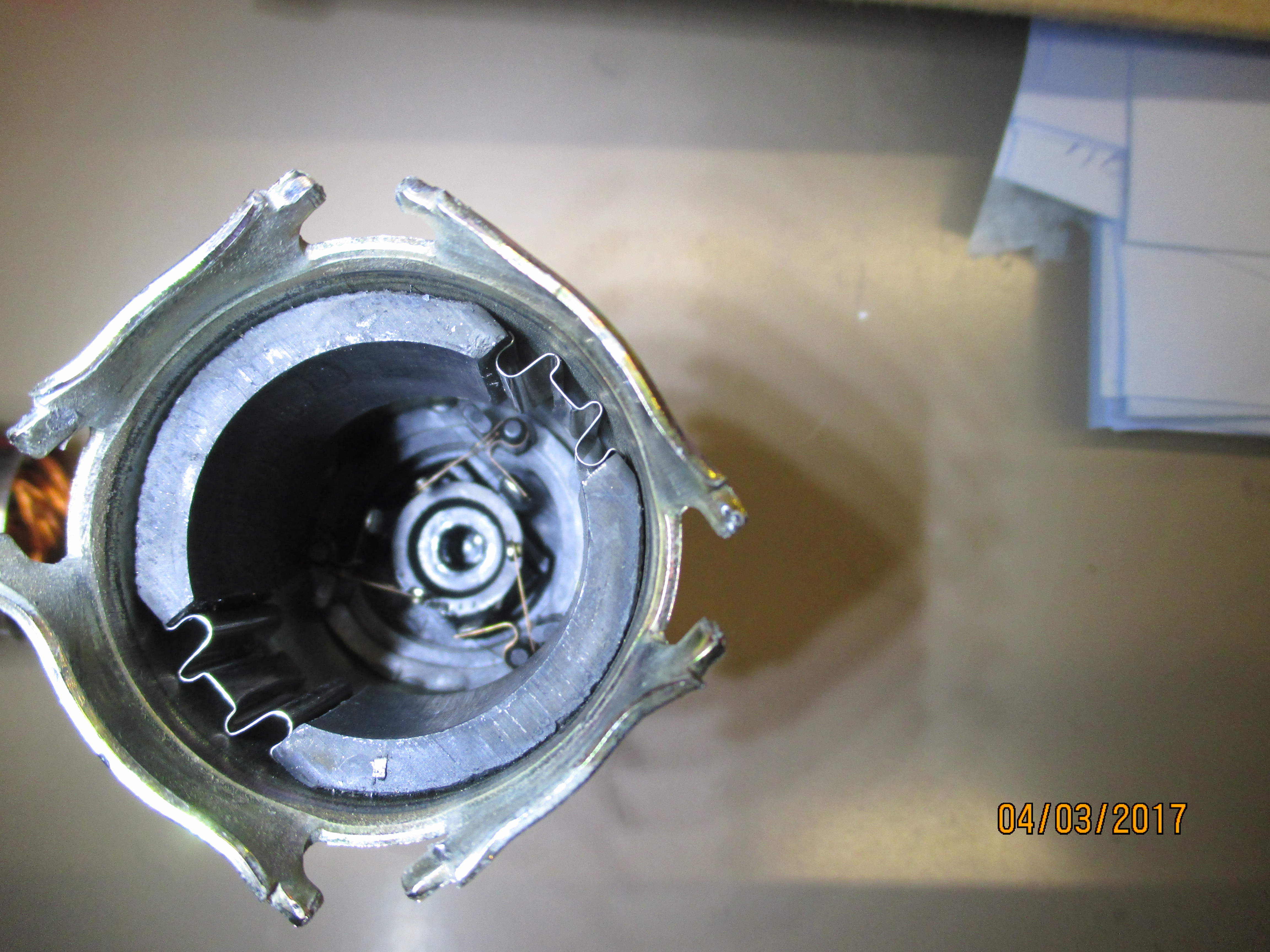

If you look at photos 1 and 2 you see a round thing in the bottom where the long center pin/shaft sits into.
That piece floats loose in the bottom and sits under the six brushes you see. The brushes are very delicate and easy to bend or damage.
They can be straightened, if bent, using very long skinny needle nose pliers. I bent one with my finger by accident trying to straighten out the round cup part.
The cup part will rattle around in there like a dice in a cup. You just have to shake the housing to get it back to center where it is supposed to sit and the shaft will go back together properly.
Be very careful when pushing the winding back into the upper unit because it only goes in one way. If you are off by 90 deg the unit will not sit all the way up inside the upper portion "the section with the hose barbs" That part as seen in the photos secured in place by the clip.
There are two synthetic washers. One site at the top of the shaft. The other synthetic washer sits underneath the metal washer and then secured in place by the clip. You can see the groove where the clip goes.
Be sure to make note of the orientation of the unit when you take it apart. The center winding/upper hose barb section can go into the bottom section 180 degrees apart so make sure you get the correct orientation for that also.
