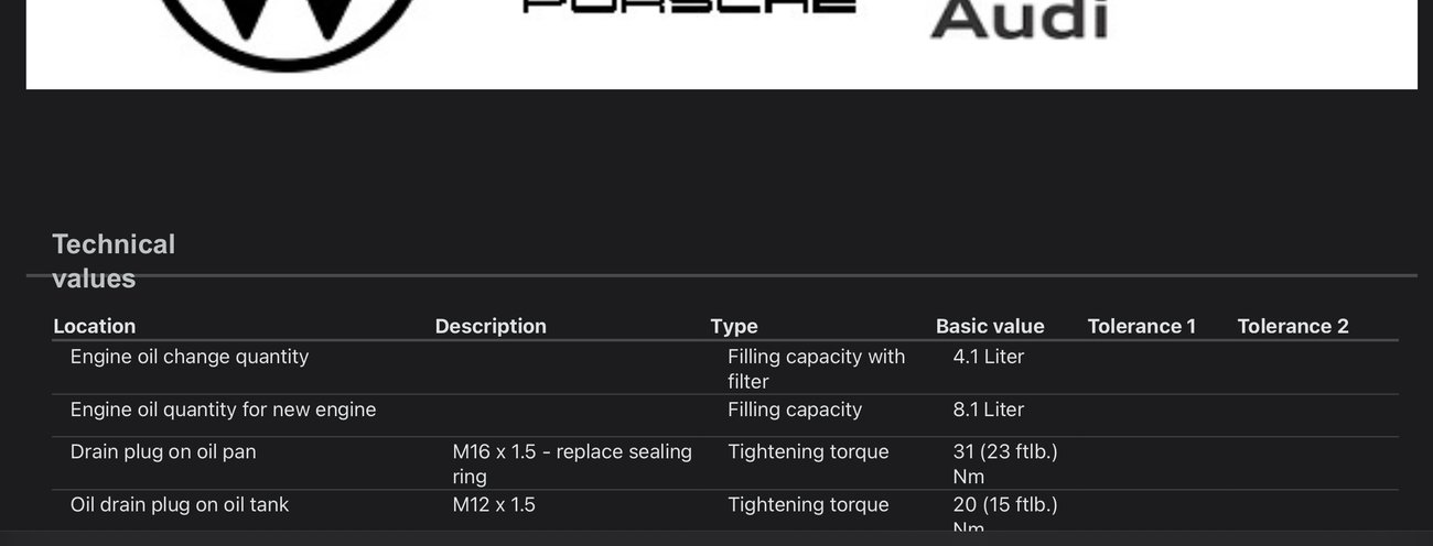

Two questions regarding oil changes for the new 992 GT3.
The 992 GT3 holds 8.1L total capacity but only calls for 4.1 L for oil and filter change per Workshop Manual and confirmed with dealer. Also, now calls for Mobile 1 ESP X3 0W-40 (Porsche C40).
Really don't understand only changing half the oil at a time. I understand concerns about environmental impacts but that has nothing to do with the care and feeding of this ICE engine. For example, if you are only changing half the oil, you are really only diluting the degraded/contaminated oil by 50% so the next service interval will start off with 50% contaminated/degraded oil at the start of it's service interval. The third service interval will start off with even a higher percentage of contamination etc and so on. Granted, its probably more important to replace the filter than all the oil but this still does not make any sense to me.
