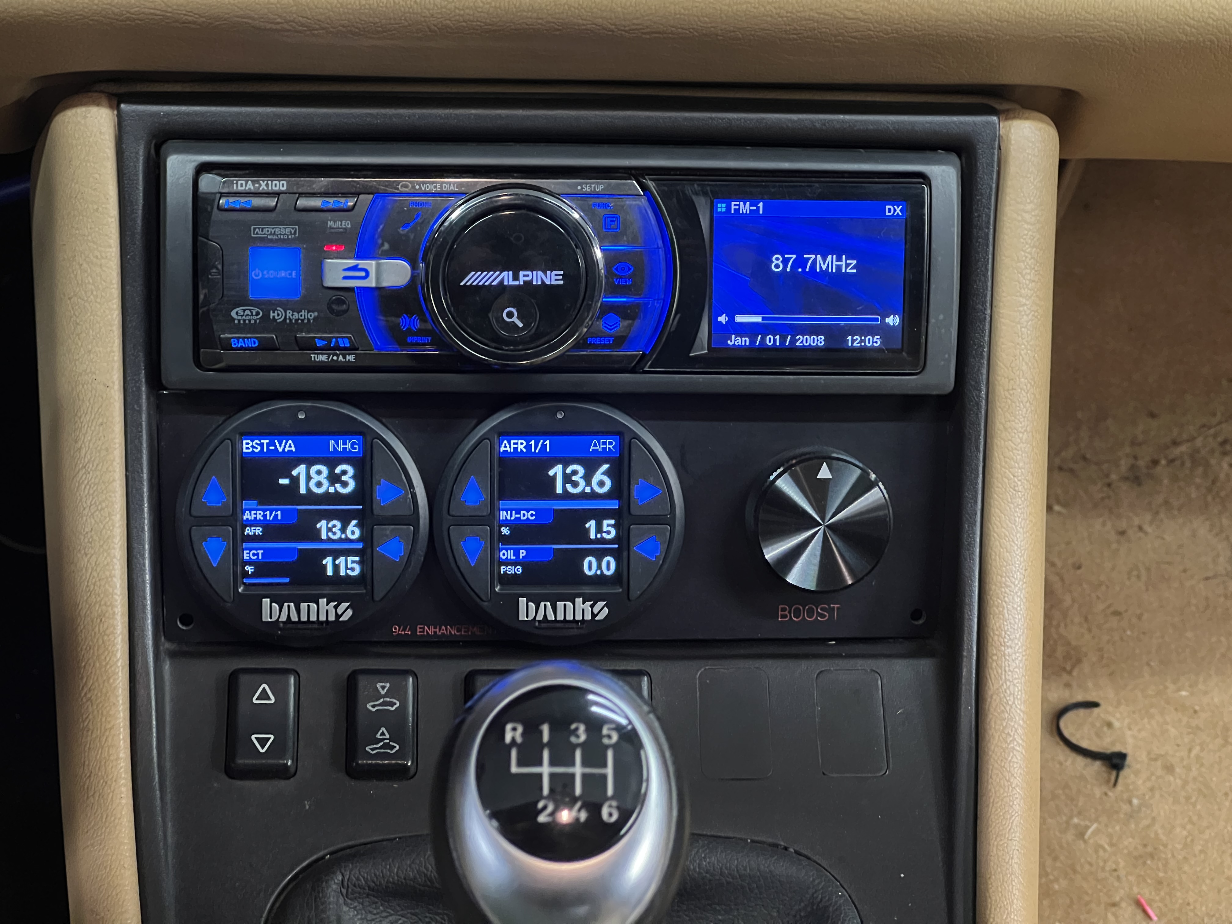

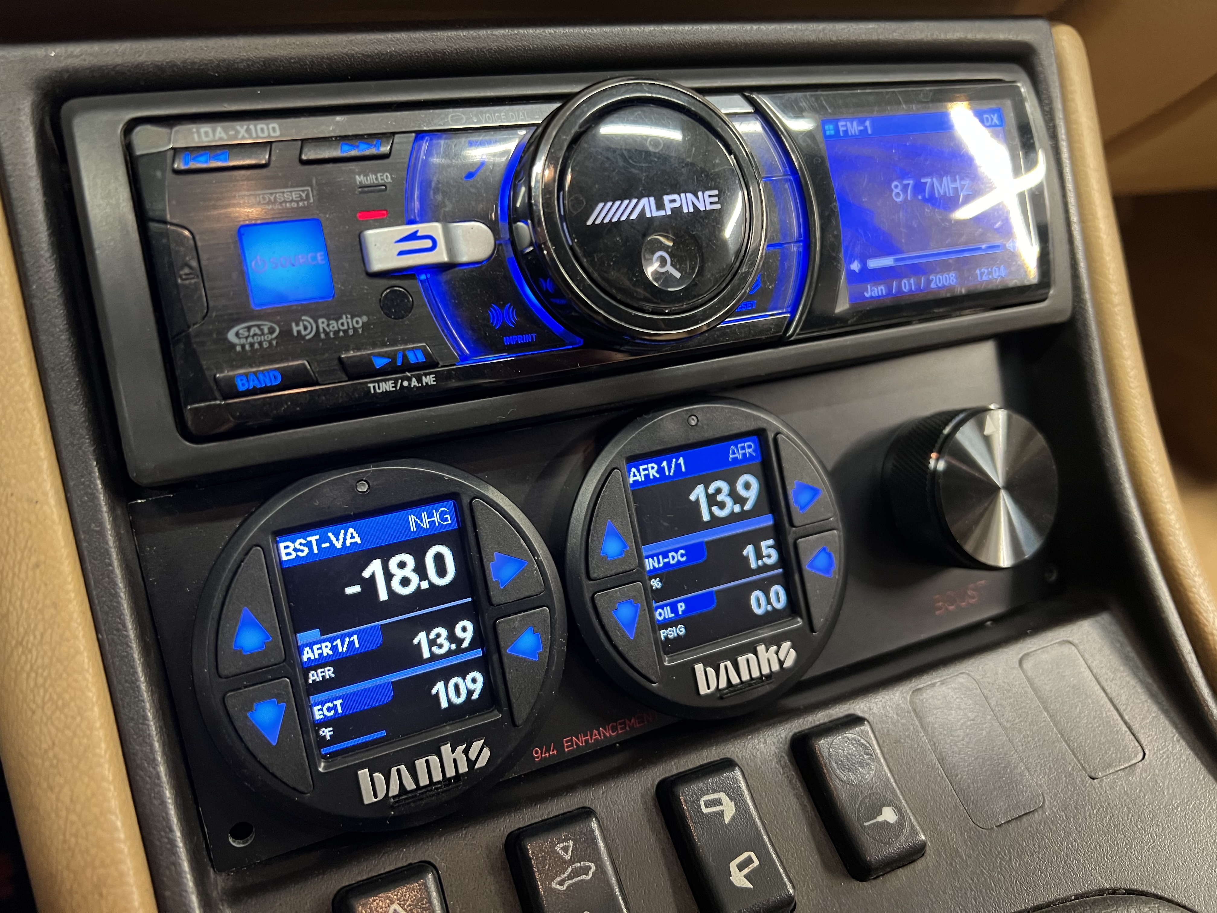

Finished up the Can Bus gauges and some ECU wiring updates just in time to put it away for winter. Posting it here because it’s a turbo 968!!
Big knob is boost control via ECU (link). 9 to 22 psi

Very nice. Front Panel Express?

Yes, great place - been using them for many years

If anybody wants the perfect starting file for a front panel design just let me know. It fits so well you don’t even need screws! It does have the crew holes!

The iDash gauges work well with the Link G4+ ecus. Lots of data to choose from and layouts with 2, 3, 4, 5 or 6 channels to display at the same time. Selectable colors and warnings. Also a updates quickly (a lot of OBD stuff refreshes way too slowly). One quirk for link is that the gauge has to power on before the ECU. Not a big deal to set up as long as you know!
