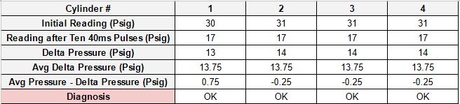

Hey all, so the check valve came in today. I'm gonna hold off on the fuel lines for now and come back to them later although i will definitely change them, those fittings were real rusty. However, replacing the valve i did another leak-down test. After 20 minutes she came down from 31 to 18 psig! Finally she holds pressure! On another note, I attempted to start her after this to see if she'd start up with the sensor plugged in, and after about 10 seconds or cranking she started up! no funny business needing to pull the sensor!
So that aside, I went to do a balance test I end up getting just about the exact same results across the injectors...
Balancer Test.JPG (30.66 KiB) Viewed 2897 times
So from here i can assume cylinders 1 & 4 being dirty are attributed to something else other than the injectors.
For anyone curious, the balancer i made uses an Arduino to trigger a relay to stay on for 40ms then turn off for 40ms and loops this 10 times. I found that 20 times would completely depressurize the rail on all injectors so i stuck with 10. I might mess around and lower the off time between pulses or the amount of time the injector stays open to see if I get any different results with the test.

Sounds like some success there. I'm unclear where things stand? Is the only remaining question about why cylinders 1 and 4 seem to be sooty? Where are you seeing the soot? On the plug? Black soot usually means it's rich, but could also mean those cylinders are missing. Since you've had a lot of no-starts, it might also just be a result of that. I'd clean them up or change them and see if it keeps happening on those cylinders only now that the motor is running smoothly.
How are you measuring fuel pressure on a cylinder by cylinder basis, and also measuring flow quantities? Or am I misunderstanding your chart?

About the fuel pressure measurement, i have a fuel pressure gauge on the end of my rail where i pressurize it by running the pump for about 3 seconds till it reaches its maximum on the gauge (about 31psi) and record it. Then I start the tester, once it finishes pulsing i record the pressure gauge reading and move onto the next injector. I put a dixie cup under each injector so i wasn't dumping it all into my cylinders but i wasn't actually measuring the flow in terms of volume. I can assume the volume flow rate is proportional to the pressure drop before and after the injectors pulse and balance them that way basically. I havent taken another compression test since re-torquing the head but I should probably see what results i get now. I am hesitant to remove the head just to clean the cylinders since i'll have to flush the oil and coolant so if anything ill have to get a small enough brush to fit in the plug holes.
