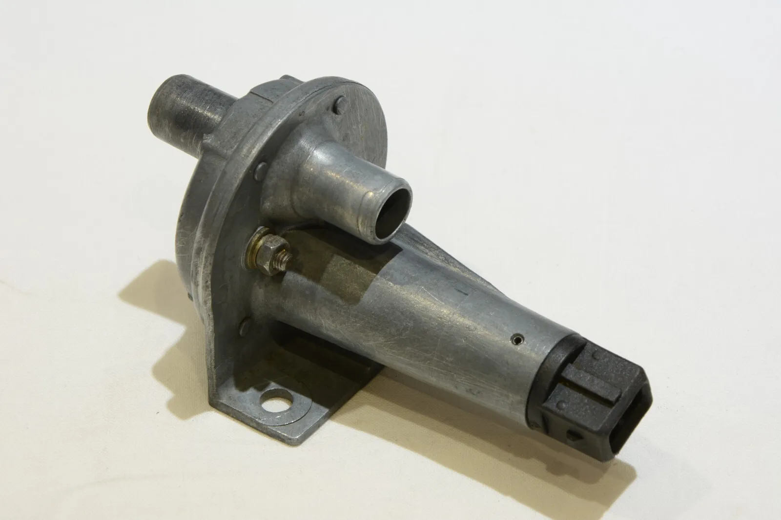

Hi,
I’m chasing a rough start issue and currently have the auxiliary air regulator off. Ice connected it to 12v and it closed within 2 minutes. Should I accept that it’s working fine and put it back together or give it a clean through with brake/carb cleaner?
Regards Rob

I would clean it, always easier while its out then having to take it back out at a later point.

That’s what I’m tempted to do, is brake cleaner the best thing to use as all I can do is spray it in and hope it washes out?

Thats what I used for my idle control valve, I would also go and do you aos seals with the intake off, should help stop it form ever getting clogged up in the future

Hi,
Sorry, I don't think I was clear on the model I have, its the a 1984 model with the Bosch AAR fitted as pictures. When I've watched the videos of it on you tube it takes a while to close which seems to be the Norm.
Posts: 9095
Been thanked: 4080 times
Ah, sorry about that. My bad. I have no insights on that version. Carry on. :)
