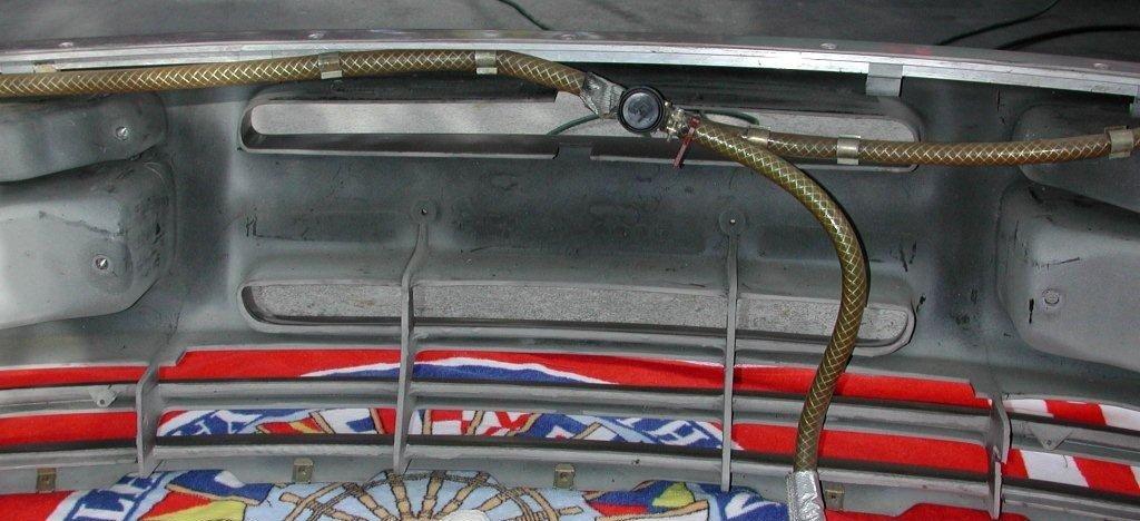

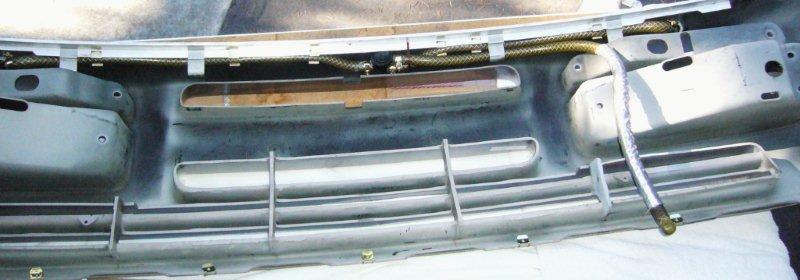

I found something from Crazy Eddie from 2011 and he posted the two pictures below with the question:
Does anyone have a picture as to how the headlight washer hose is run through the bumper cover?
Is this correct .. I took pictures way back when, but the only ones I can find are blurry and I can't tell how the clips and hose are supposed to be run through the bumper cover. Darwantae951 and Ollie Snellman both replied the second photo (lower of the two) is what they saw when they took the bumper cover off.

Thanks for those pictures. I called Ed too, and he confirmed the same. Now I just need to find (or make?) those clips.

I found a part number on 944Online..94462818100..punched it into Google and found multiple applications. I'm not certain if it is the exact part you need but 944Online has it and listed as clip for washer hose. If you just put the number in google and hit search, you can find other sources but Ian's price is the least expensive, but you could probably print your own.
