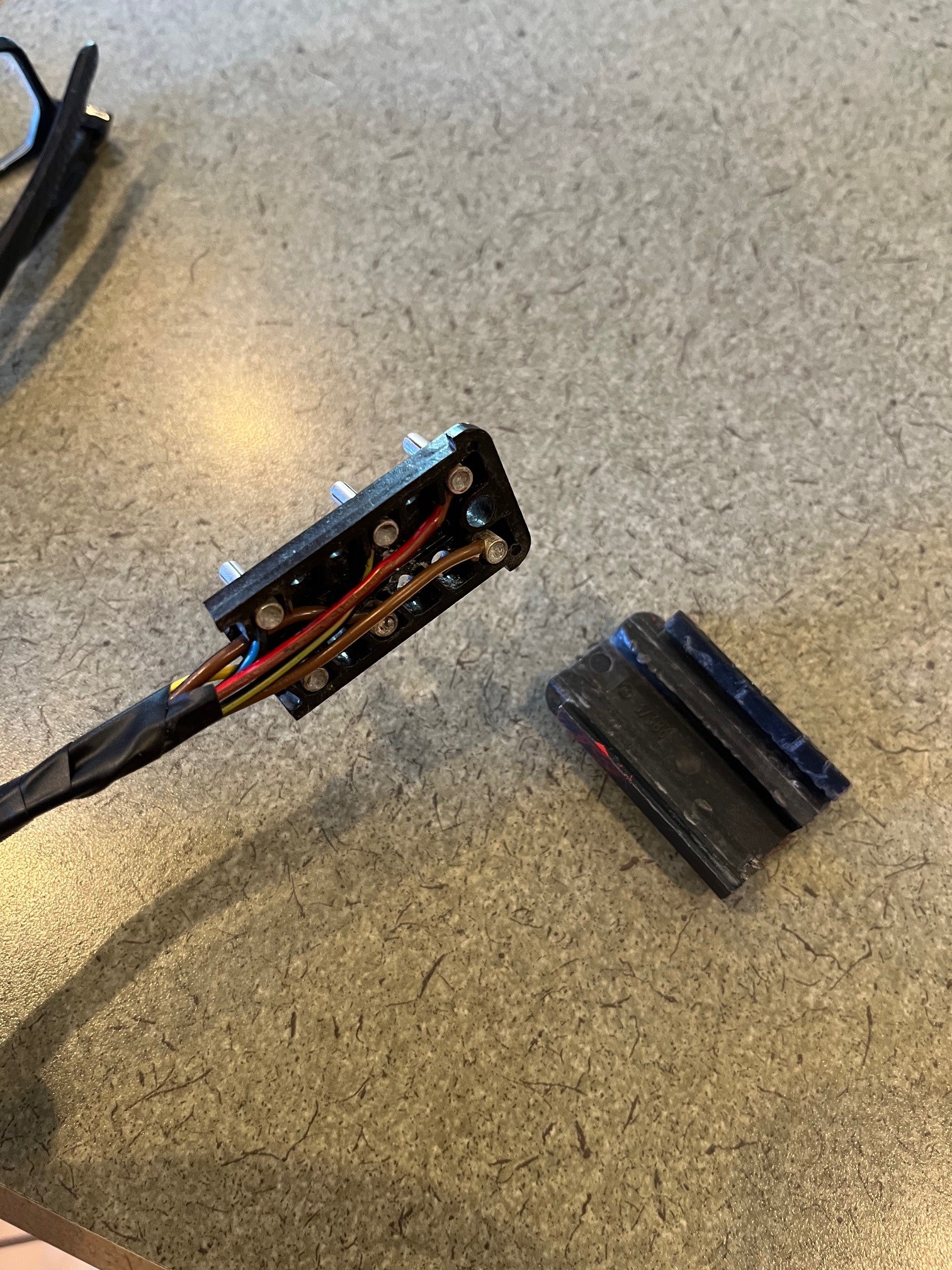

I think you are onto something @Tom - I might just take the back off the door harness connector and solder on a wire at the pins needed and then I don't need to make any cuts.
locks harness connector.jpg (993.42 KiB) Viewed 1422 times
Posts: 9093
Been thanked: 4078 times
notny41 wrote: Wed May 29, 2024 2:40 pm I think you are onto something @Tom - I might just take the back off the door harness connector and solder on a wire at the pins needed and then I don't need to make any cuts.
That works electronically -- I'd just check before soldering to see if the cover will still clip on. Those things are often a super tight squeeze around the wires, and adding 2 more wires might preventing it from clipping shut. I generally avoid those vampire tap things, but for something like this where a super clean connection isn't critical, I'm sure they'd work fine too. I just wouldn't use them on stereos or engine management signals...
