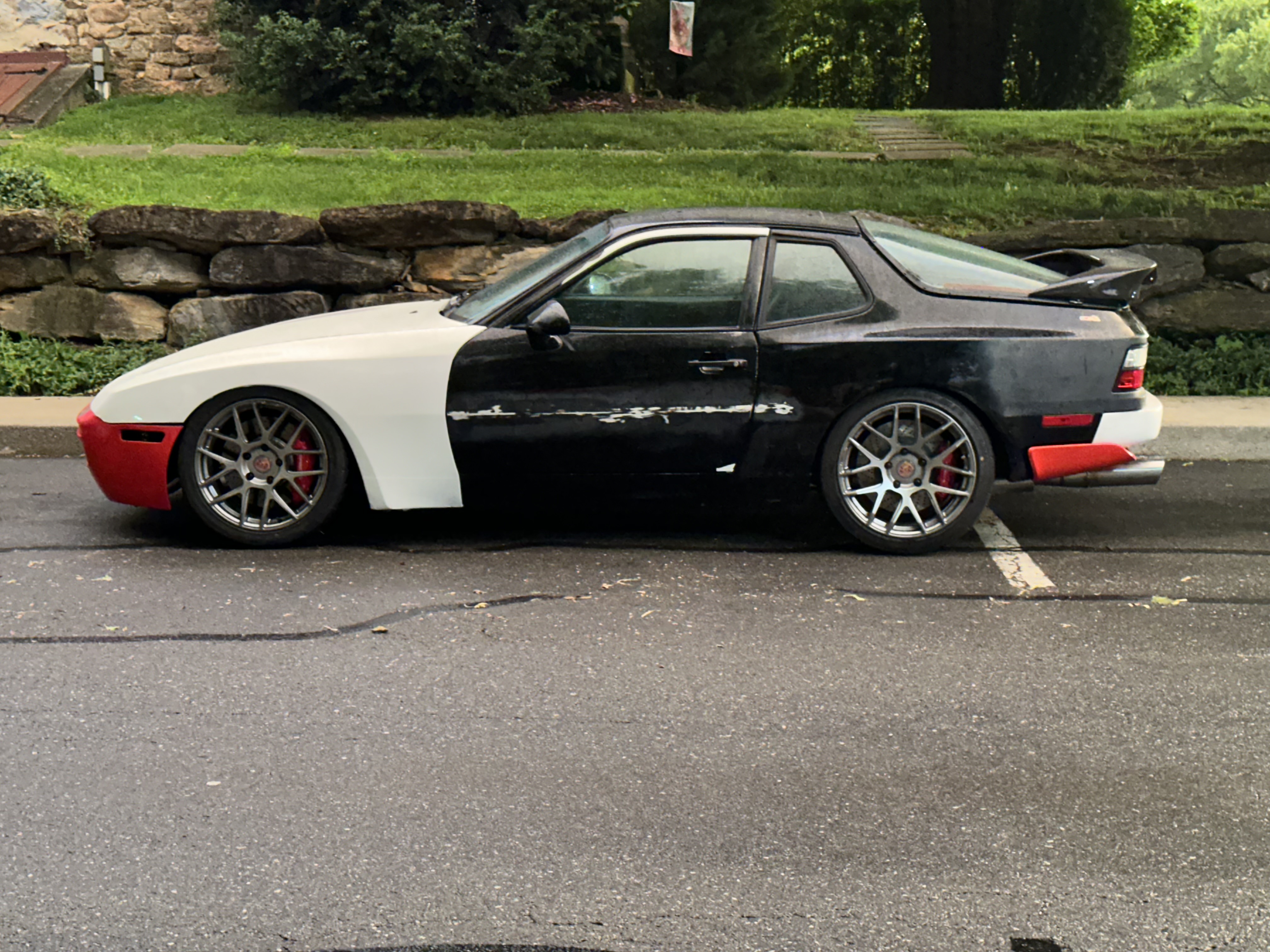

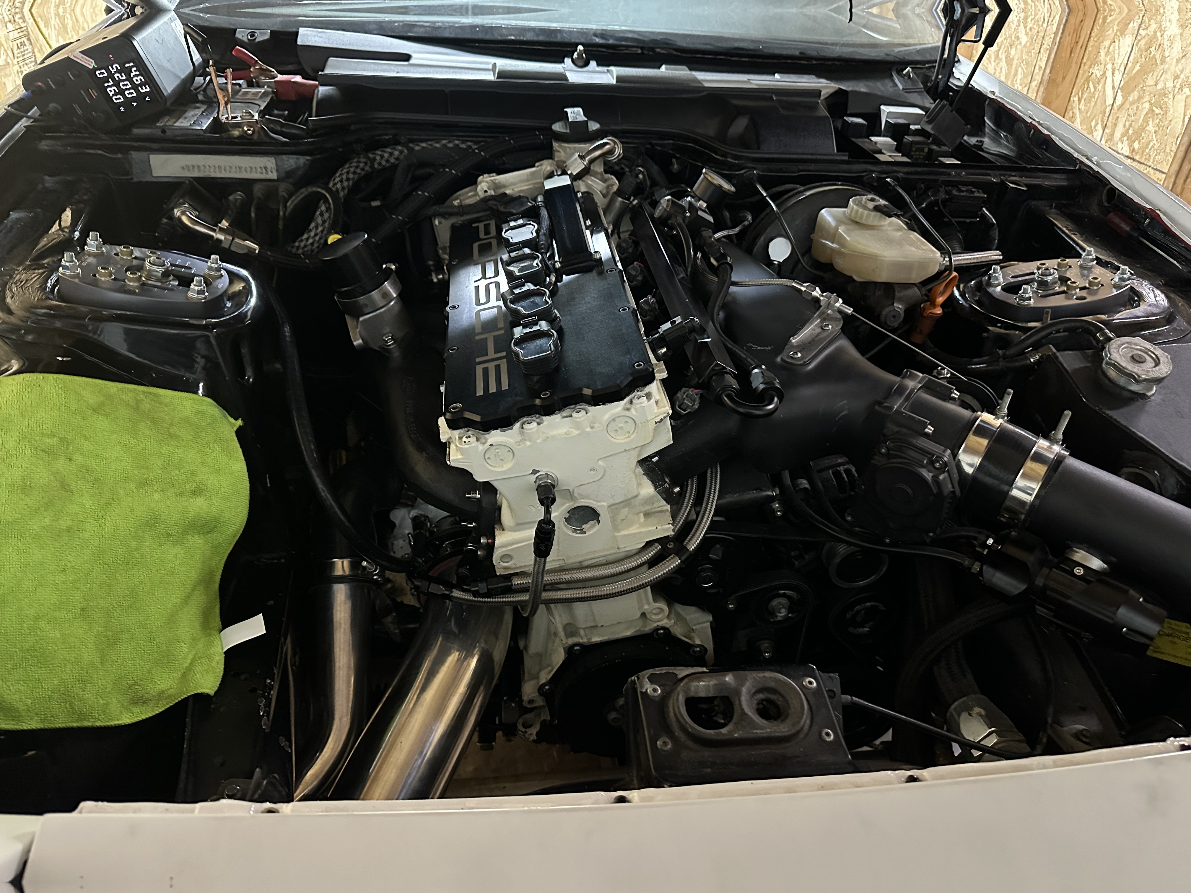

I have a running and driving car! Finally Tom’s dash is next!

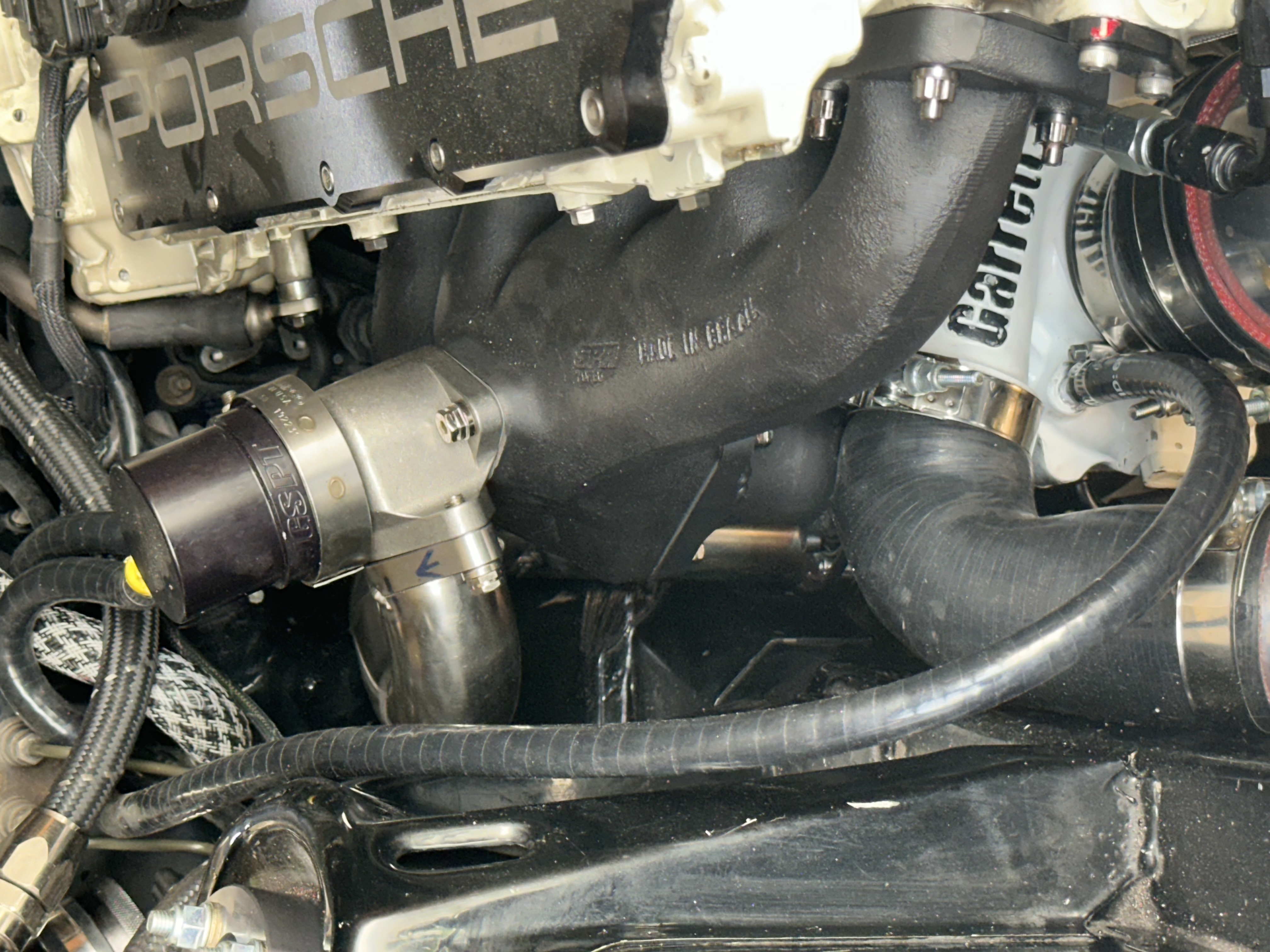

Thanks! Stock long block for now. Have a brand new 07k on the pallet that I’m going to build. Probably do a girdle and 5 bolt mains. The turbo is a g25-660 with room for a g35. So I have so big power options.

I have the rev limiter set to 7200. With factory cams and a small turbo it wouldn’t make any power over that.
