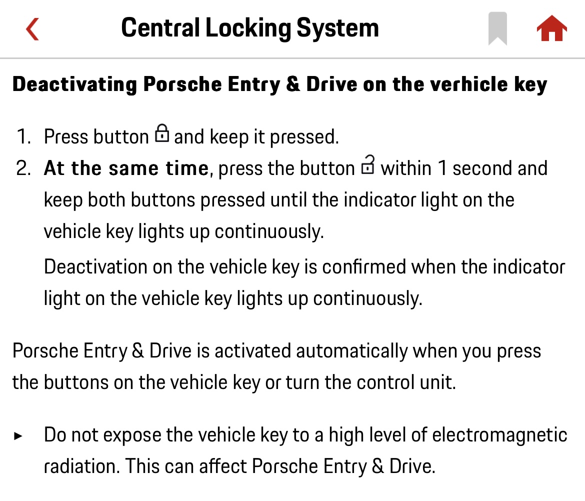

Button sequence on key will disable E&D as well. Below is for my 718, check your Panamera Manual.
Used in combination with a hidden key box may give you a solution. If the box is also a faraday box, that’s another layer of protection. Cybersecurity concept
