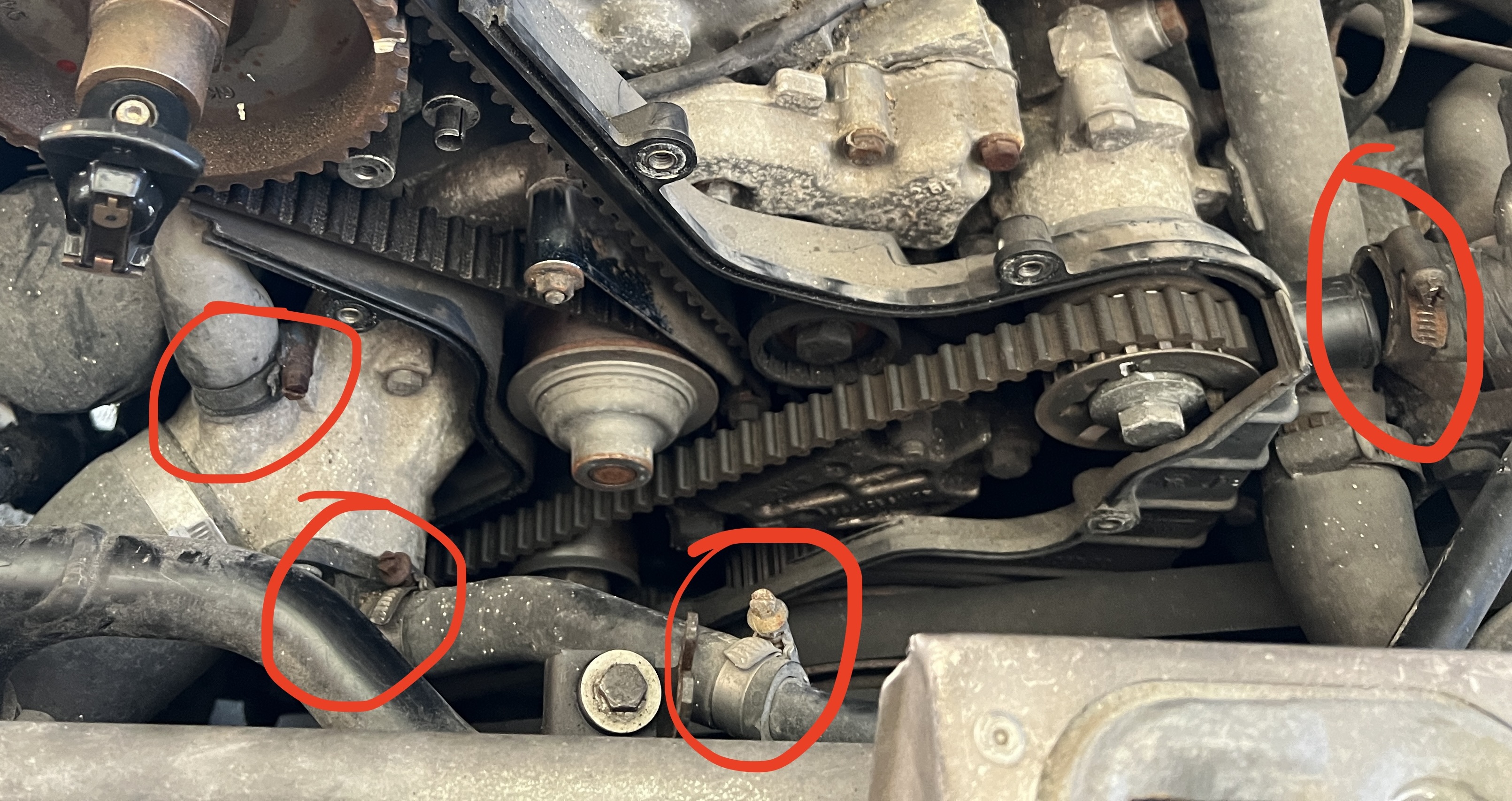

As I am sorting through the new-to-me car, I want to replace all the corroded-looking hose clamps (among many bits!) in my engine bay.
Bel-Metric seems like a good site for good prices and quality with the OEM looking yellow-zinc.
The 944 parts catalog just lists the part number and "Hose clamp". No sizing.
Can anyone give me an easy method of measurement of each hose-clamp so I can make a list of the correct sizes before ordering?
Thanks.
See examples of condition.

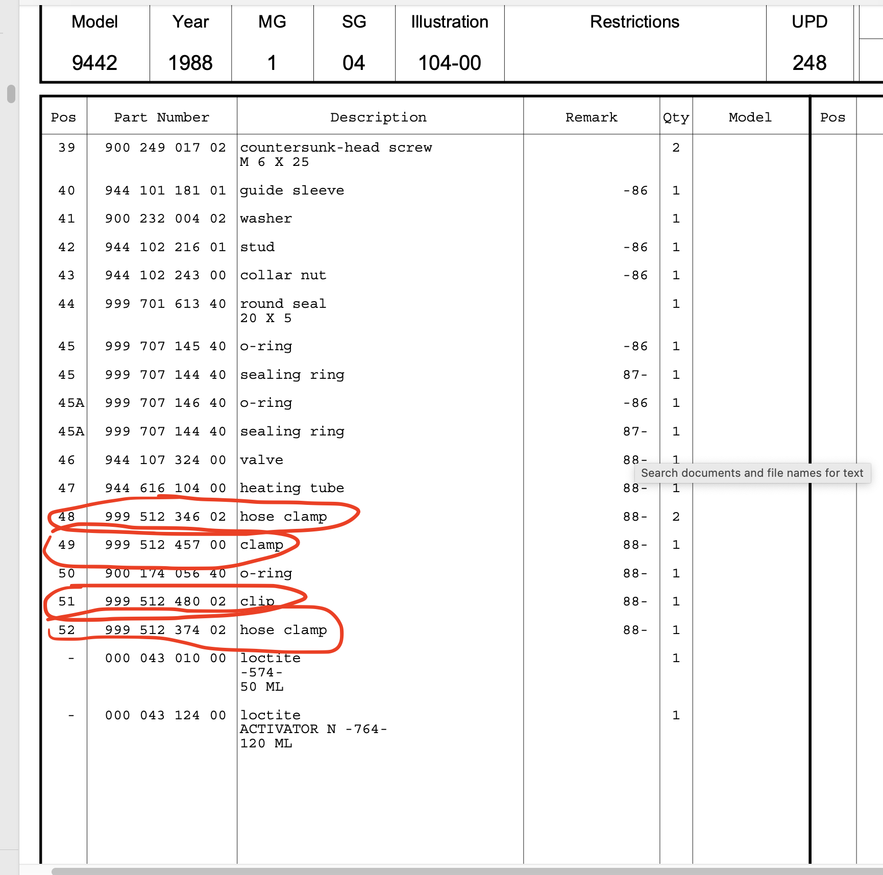

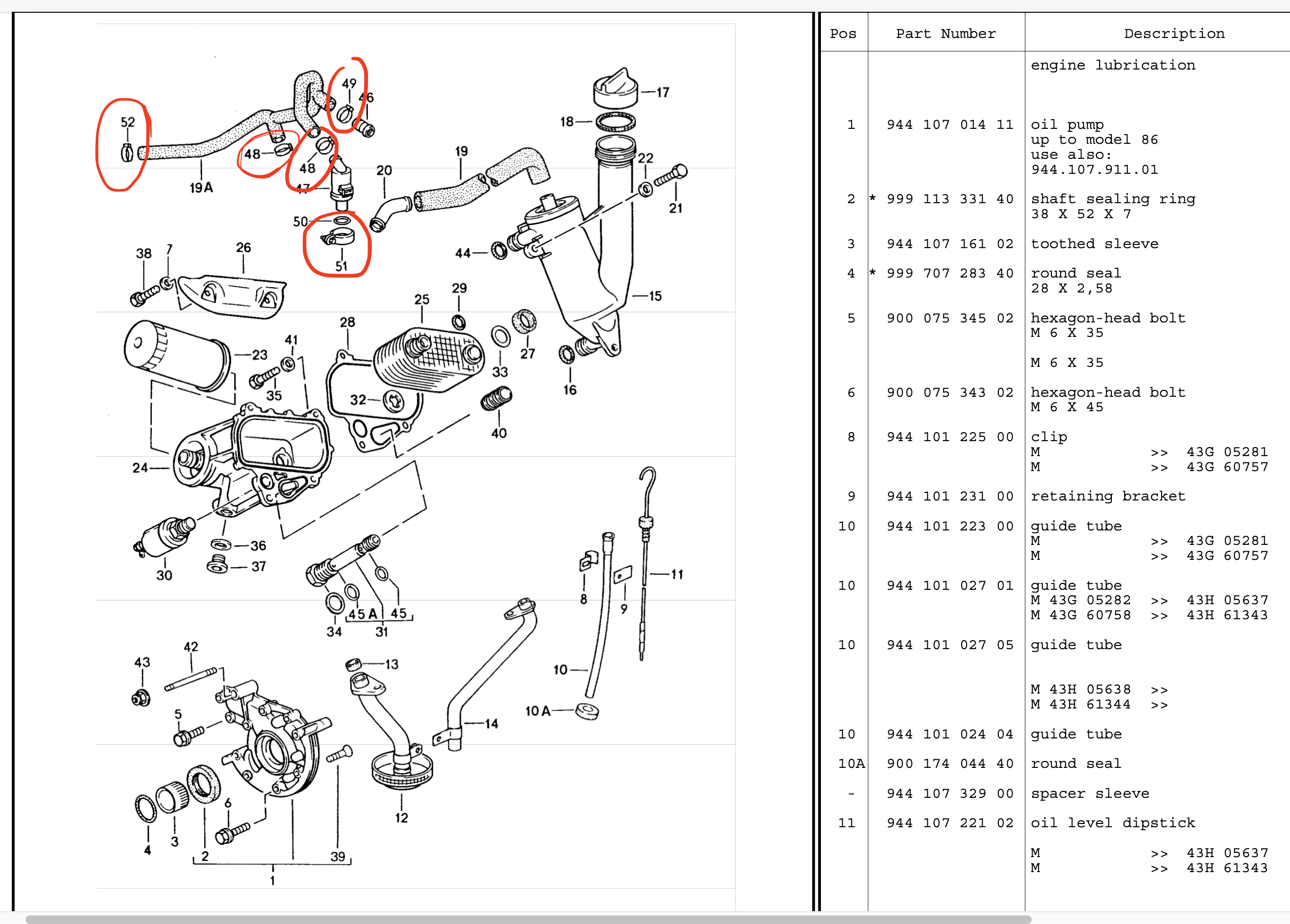

Yes, I have a PET. (And thanks for the link!)
But for example, the hose clamps on this page (# 48, 49, 51, 52) are all listed as "hose clamp", or "clamp" in the PET with no sizes.
I have tried to cross-reference the part number online and found some links with sizes, but was hoping for a faster more efficient method to do a bulk order from Bel-Metric. (The dealer web-pages for the parts do not list sizes unfortunately.)
