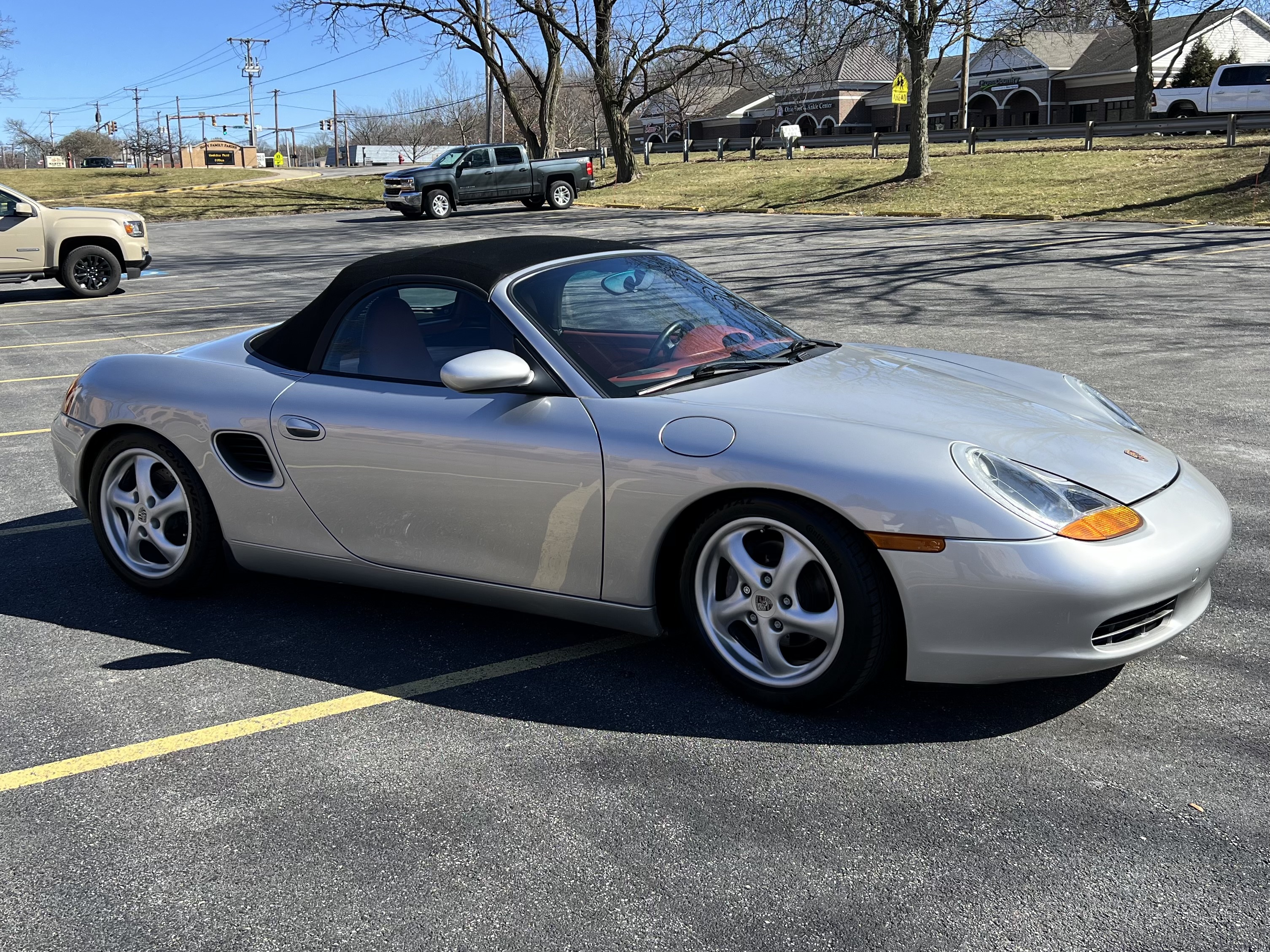

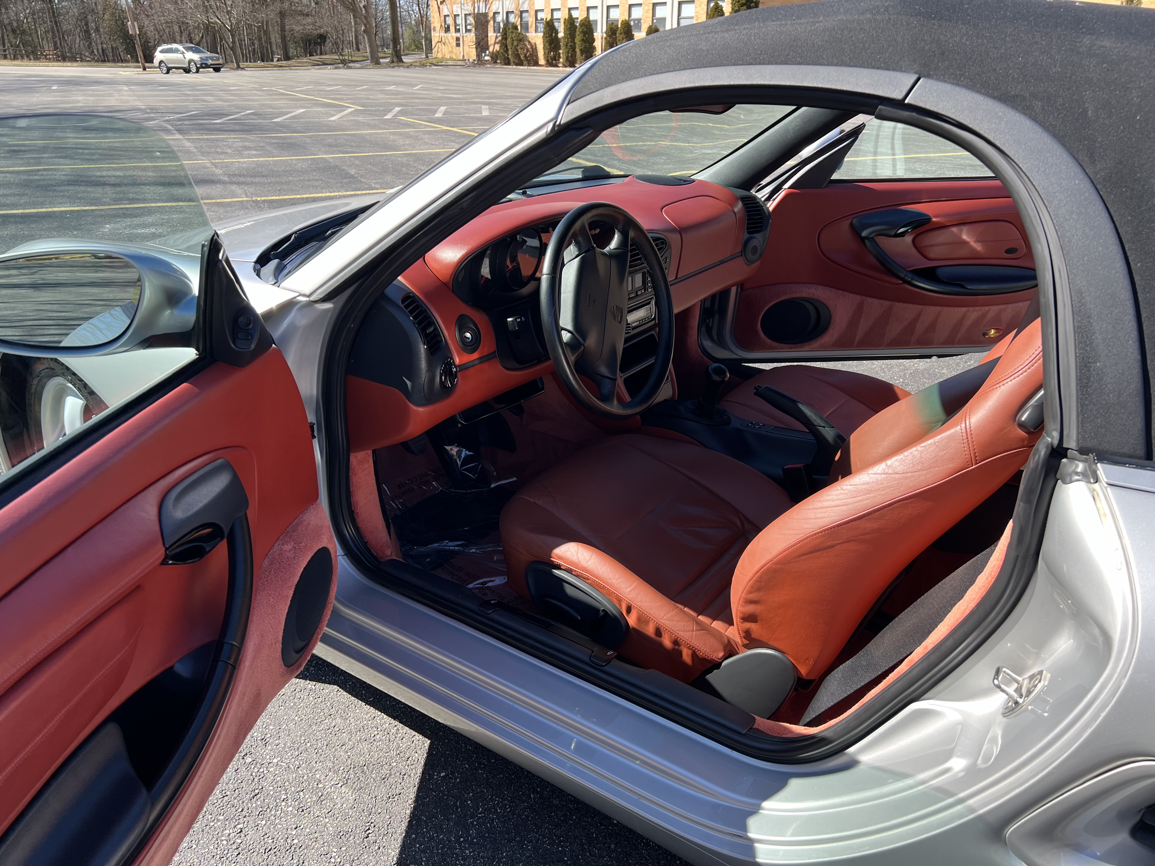

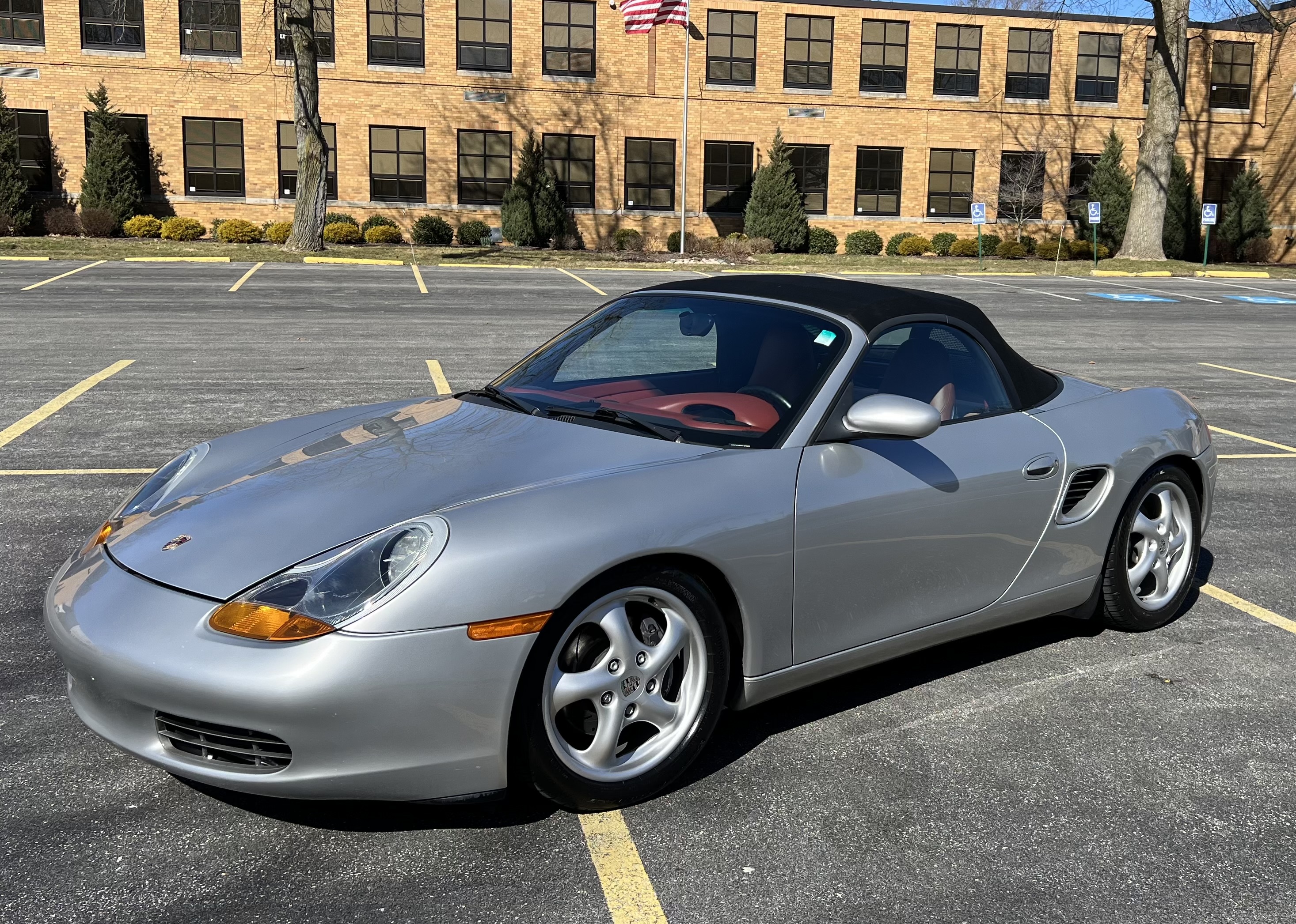

I just picked up a 1998 Boxster to use for autocross and track days. Anyone have experience with early Boxsters used for this purpose and suggestions on modifications for improved performance without significant compromise to reliability and the overall character of the car? Appears to be a solid example that is mostly stock. Has H&R lowering springs and an aftermarket muffler.
