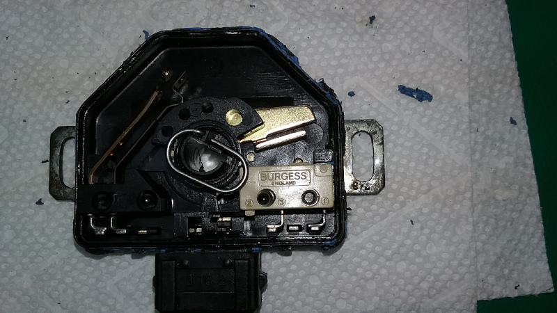

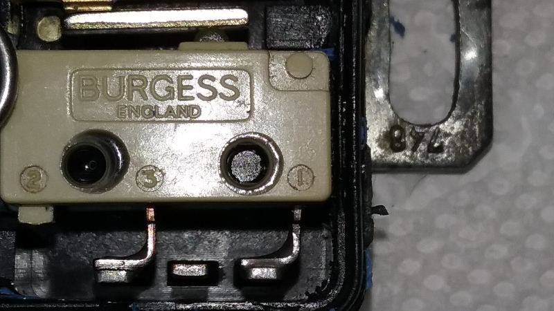

You probably wouldn't be wasting your time taking a closer look at the TPS. I've opened/cleaned/serviced mine twice. They are difficult to open without ruining, but possible of you go slowly and carefully. It helps lower the anxiety if you have a good spare. The first time was during a throttle body rebuild, and it was full of oil from the leaking lower throttle shaft seal. The WOT switch is an open switch, literally, unlike the enclosed micro-switch of the idle contact. Any oil in there has direct access to the WOT contact. It's hard to see in this photo, but the WOT contact is right at the top and slightly left.
As a side note, carefully check the solder joints inside; an invisibly cracked joint at the idle switch (the left one in this shot) was the cause of a very hard to track down high-idle-when-warm condition that haunted me for almost two years.
