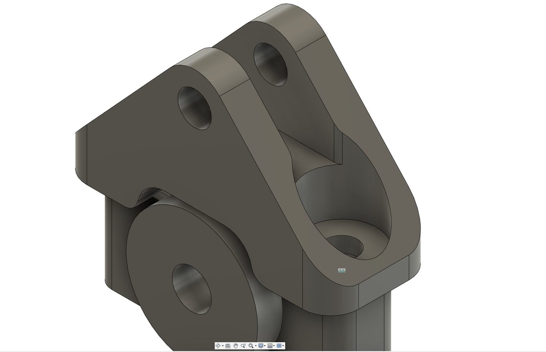

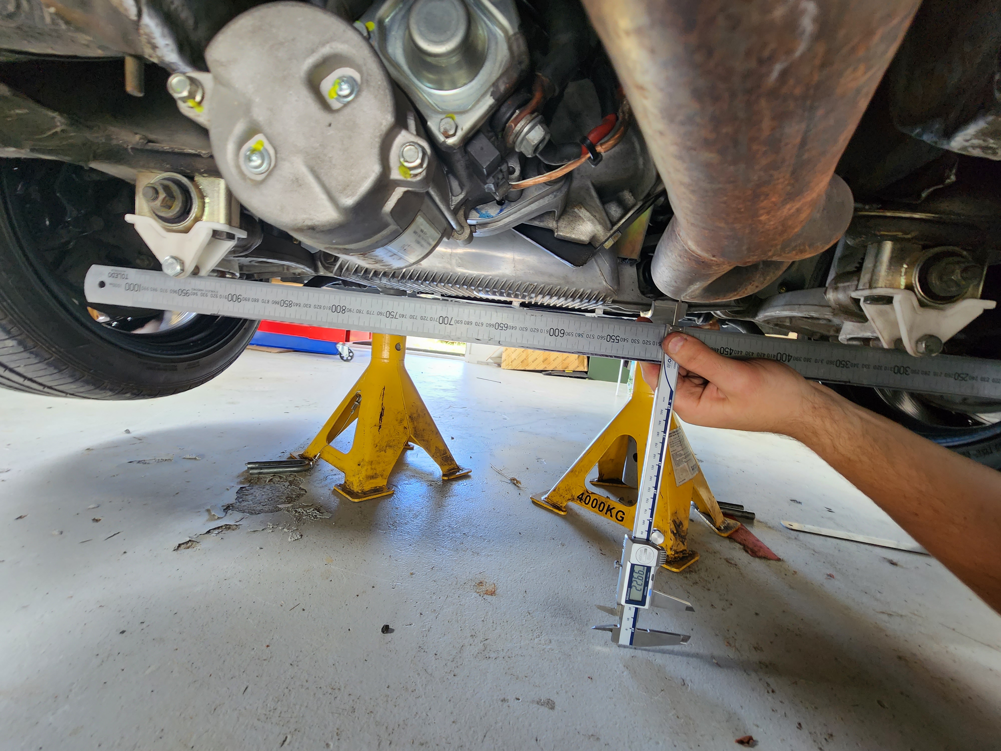

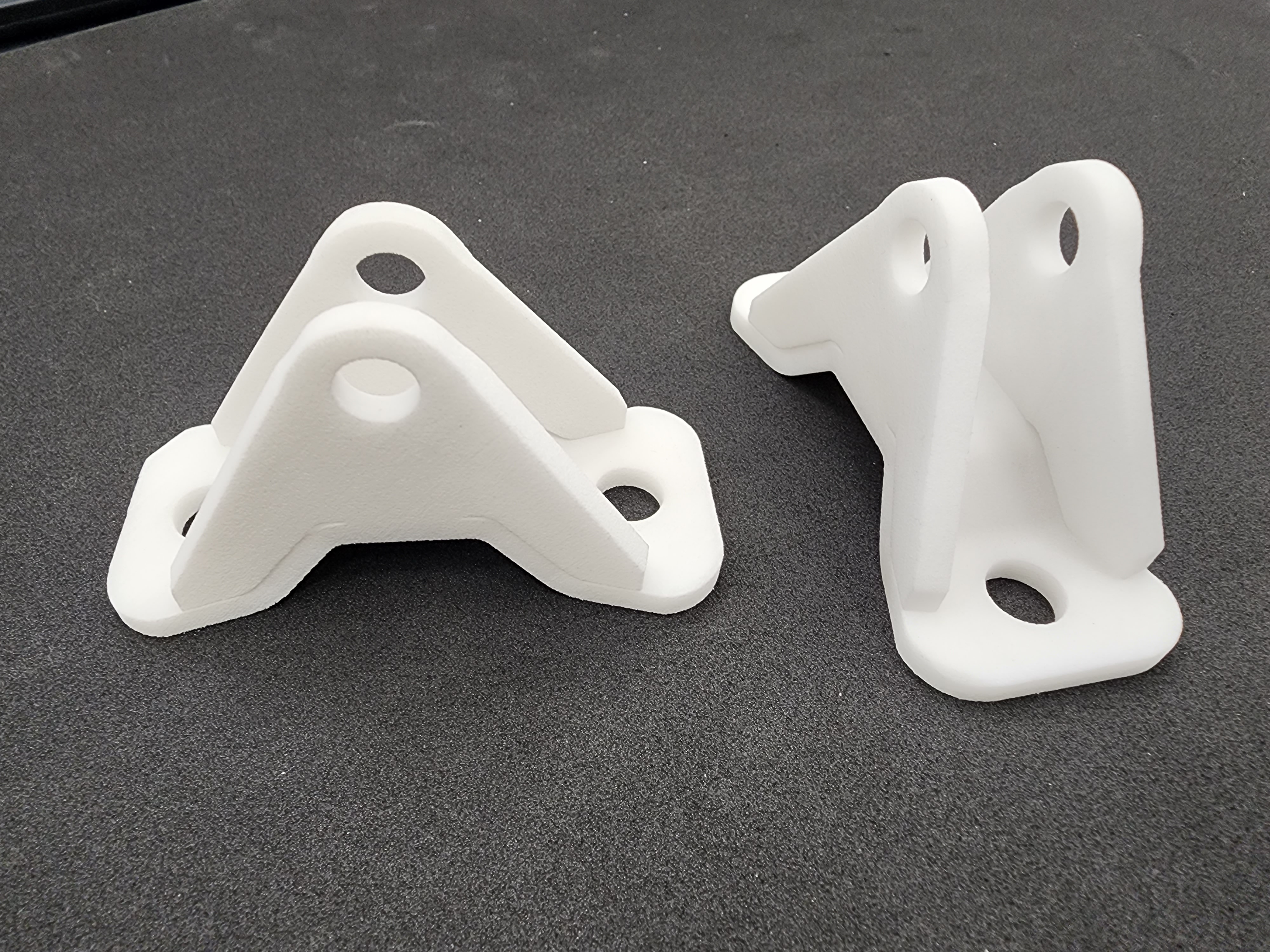

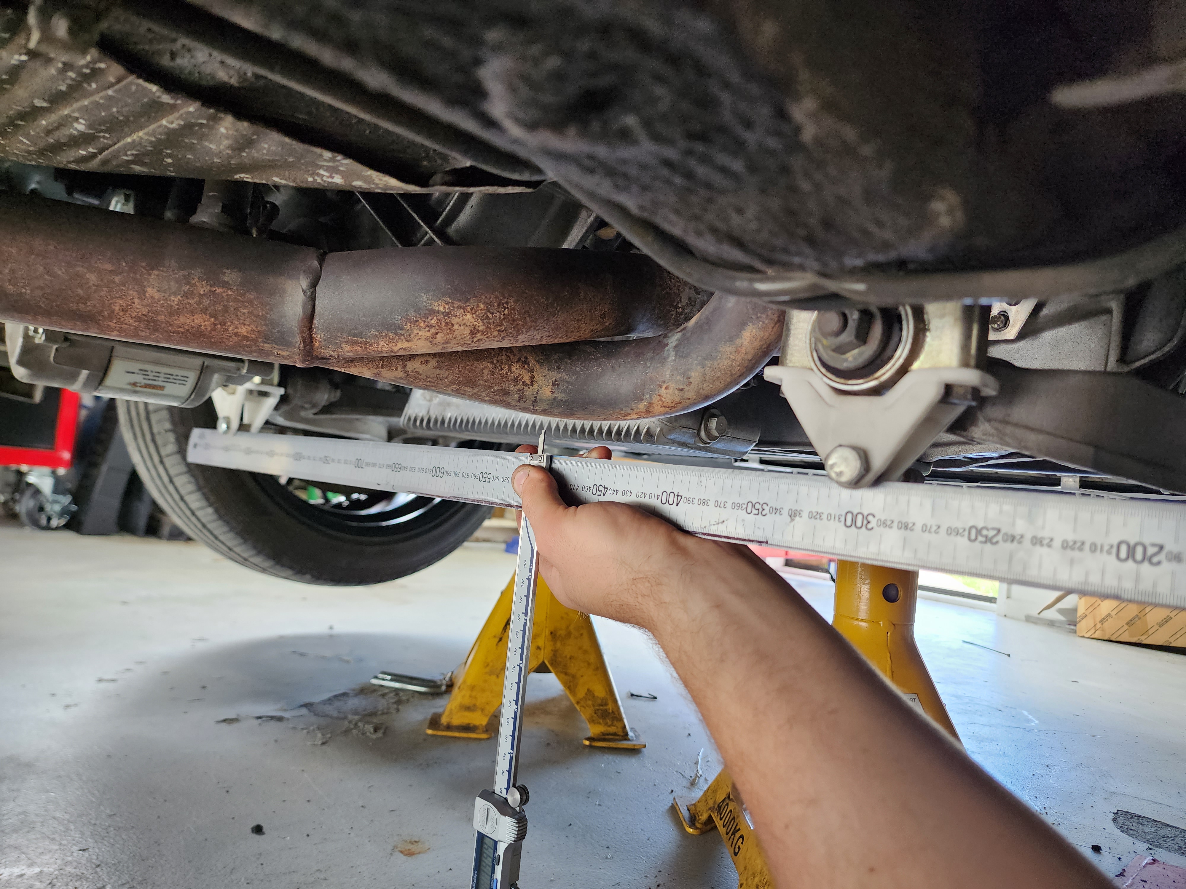

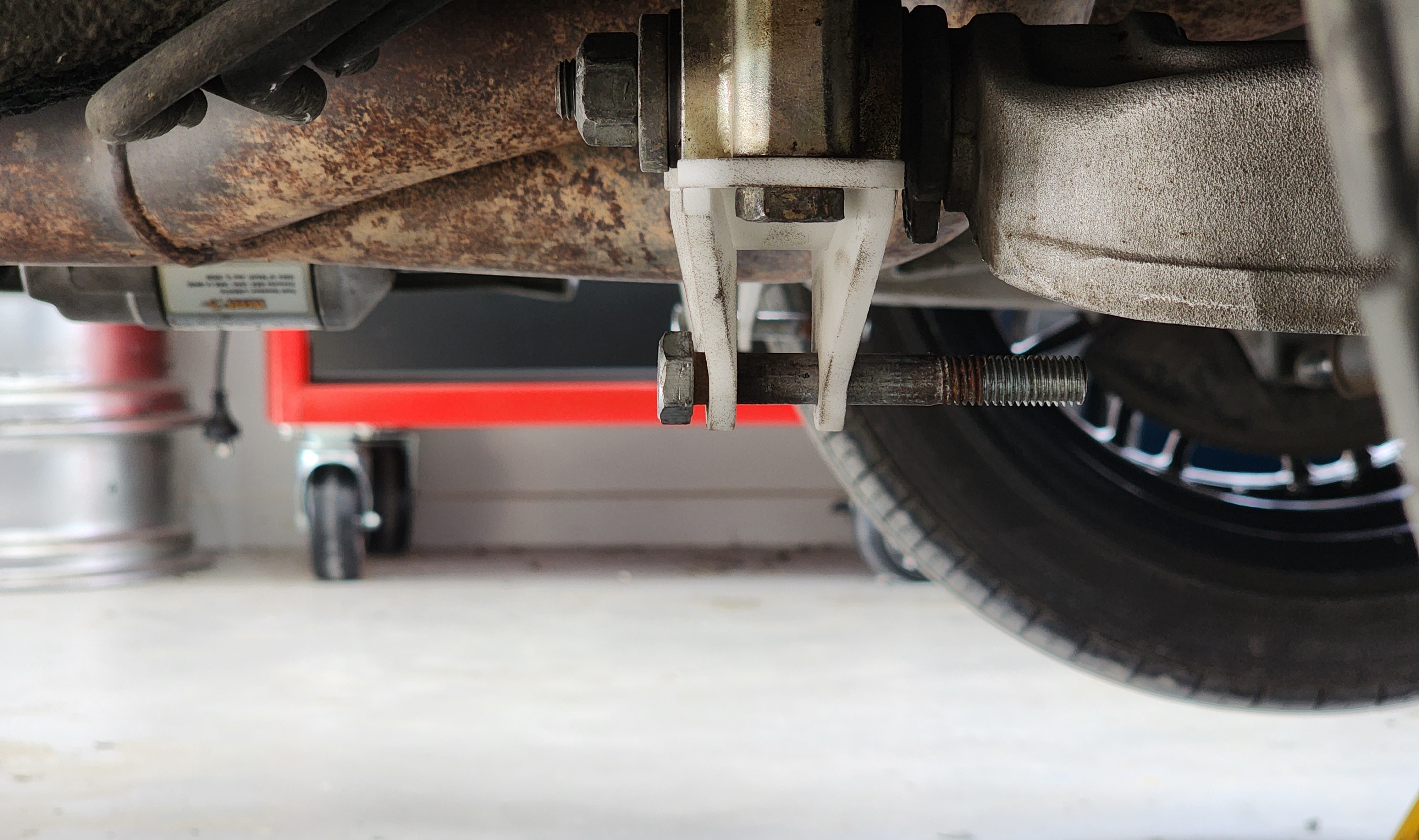

In the past I have made up strut tower braces and c-pillar braces now I am working on a castor block brace for my S2 , thought it might be worth sharing with the group .
Designed in CAD originally from some guessed dimension. This week i had the mounts printed in nylon to see if my guesses were accurate enough.
It appears to be a success. There is a minor reduction in ground clearance but being just behind the front wheels it shouldn't be much of an issue. Bar will be a 20mm tube with weld on threaded inserts. Mounts to be made of 5mm bent steel plate and replaces the washers under the bolt to maintain thread engagement into the car .
Screenshot 2024-01-21 114625.png (289.05 KiB) Viewed 1235 times

blade7 wrote: Wed Mar 06, 2024 5:13 pmAny progress?

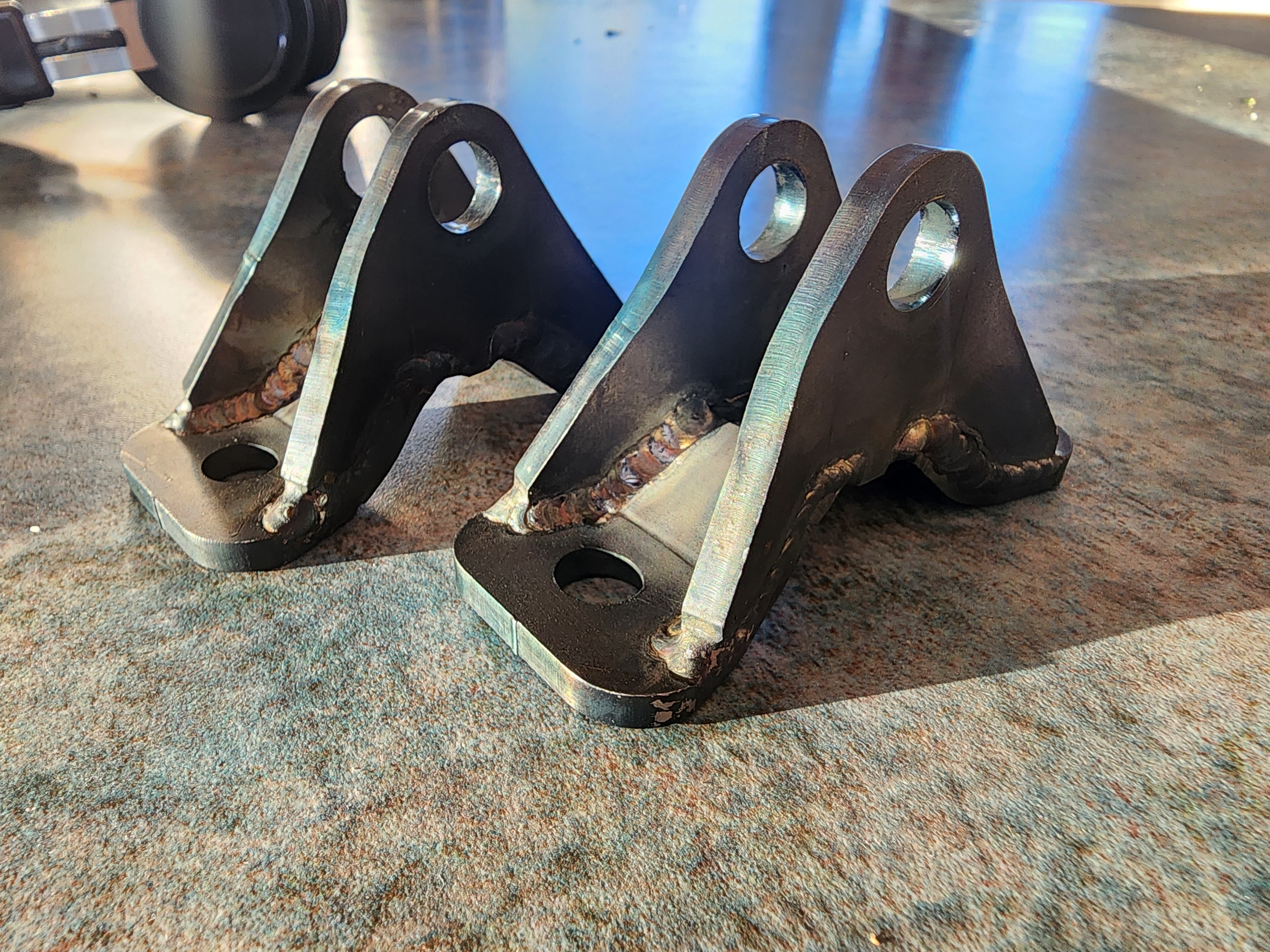

Yes , have had the first prototype mount made up to test position .
Redesign with same mounting locations for a machined aluminum mount . Gained production quotes.
Weld in threaded tube bungs made .
Awaiting items to come in for center bar at the moment.

Considering what it's mounted on to, I wonder if it needs to be this strong?
R3wir3d
Posts: 14
Joined: Mon Mar 21, 2022 1:21 pm
Location: New Zealand
Been thanked: 6 times
blade7 wrote: Fri Mar 08, 2024 5:17 pm Considering what it's mounted on to, I wonder if it needs to be this strong?
Would be able to check fitment on a 968 locally.
That mount would be made from 6061 so a bit beefier to take any hits or deal with deflection.
blade7
Posts: 231
Has thanked: 27 times
Been thanked: 22 times
R3wir3d wrote: Fri Mar 08, 2024 6:21 pm
The castor mounts are bolted to a couple of captive nuts, that are a PITA to access. So if if I was fabbing that up, I'd be looking for it to deflect, rather than dislodging the nuts.
