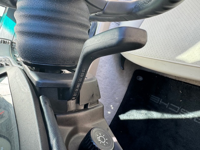

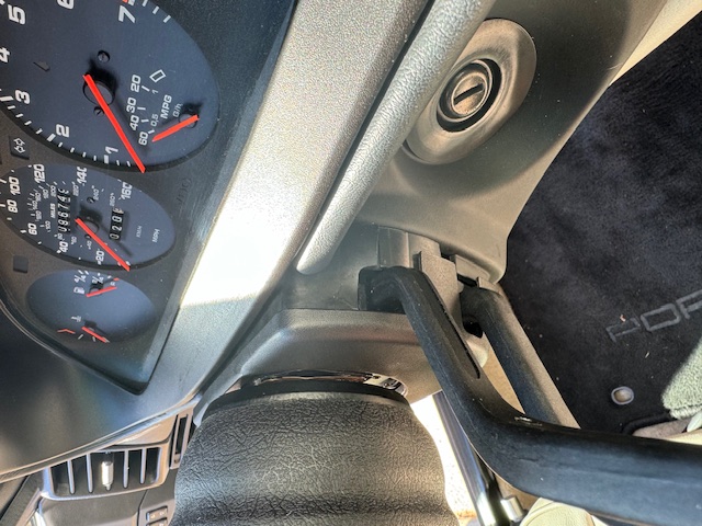

Here you go. This is the closest I could go without getting the scraping sound and still allowing the horn to work.Tom wrote: Sun Jan 21, 2024 2:15 pmI have a 968CS-style wheel (aftermarket) and never noticed the gap being excessive. Can you post a picture?NCGermerican wrote: Sun Jan 21, 2024 1:43 pmThat’s what I ended up doing and the scraping sound went away. However the gap is noticeable. I wonder if the 968 CS had a different signal stalk cover so the gap isn’t seen.944er wrote: Sat Jan 20, 2024 4:35 pm Have you tried a less extremely minimal gap yet? I can't help but believe a nasty scraping sound doesn't indicate excessive wear happening.

Looks pretty much like mine. I think it's pretty normal, no? When mine started making a scraping noise, I 'polished' both pieces with fine sandpaper, then new electrical grease, and that quieted things down. Here's mine:

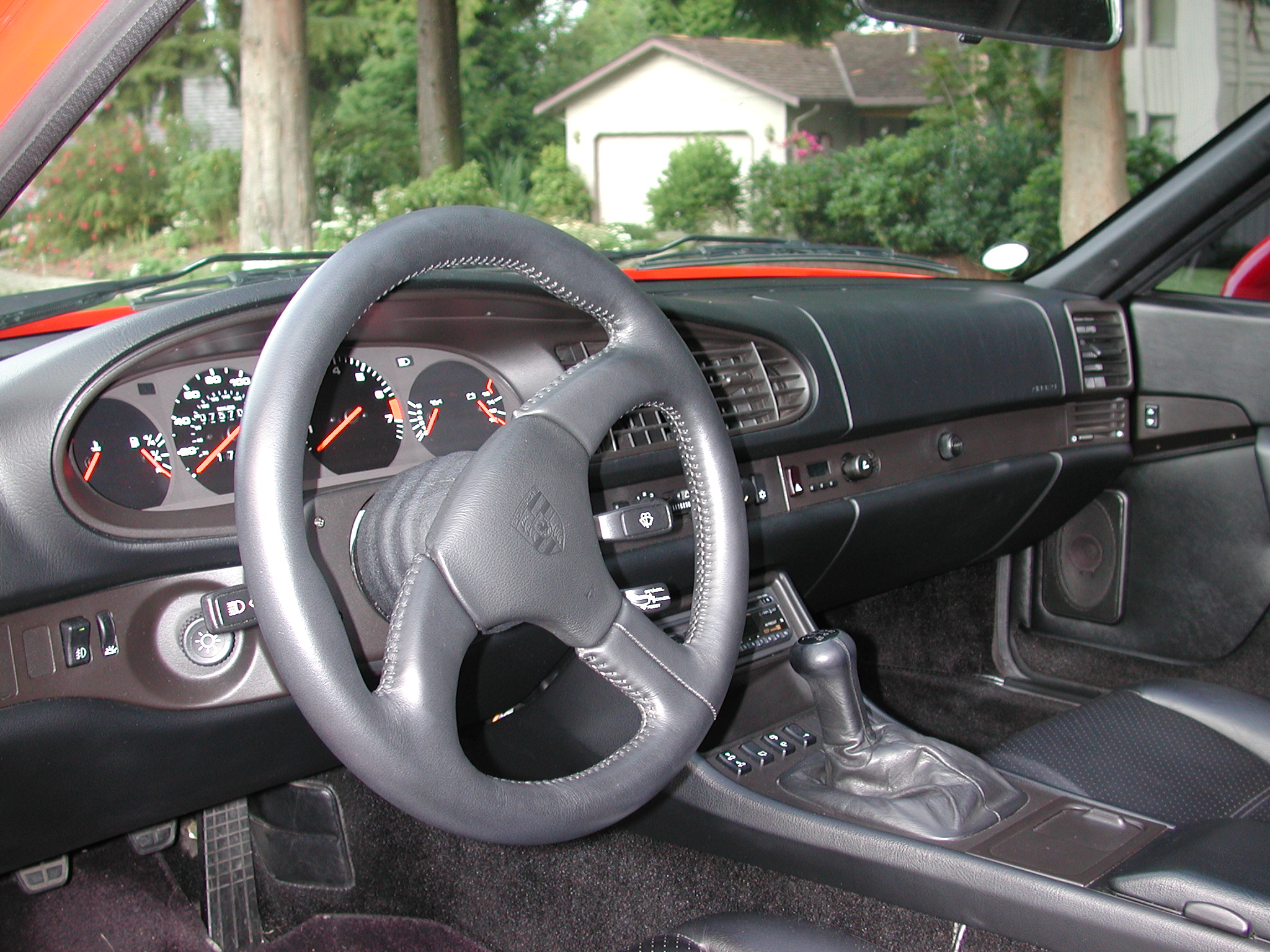

FWIW, I have the 968 CS wheel on both my '89 944 Turbo and '90 944 S2. Both of these cars originally had airbags. The CS wheel fits perfectly with the stock airbag clockspring cover. Maybe this cover and rubber bellows could be retrofitted to the non-airbag cars? But that might require a different signal/wiper/cruise switch since the newer ones have tapped holes for the four screws in the plastic cover, and I think the earlier version has the two top corners clipped.
Here's the best picture I have handy of mine installed.
- DSCN1023.JPG (1006.15 KiB) Viewed 1407 times

I bet you just solved the mystery. I didn't even think about how the clockspring covers different than the non-airbag cars. I know that the screw holes are in different locations when comparing my 87 S (non airbag) and 87 turbo (airbag).Latitude48 wrote: Mon Feb 05, 2024 6:27 pm FWIW, I have the 968 CS wheel on both my '89 944 Turbo and '90 944 S2. Both of these cars originally had airbags. The CS wheel fits perfectly with the stock airbag clockspring cover. Maybe this cover and rubber bellows could be retrofitted to the non-airbag cars? But that might require a different signal/wiper/cruise switch since the newer ones have tapped holes for the four screws in the plastic cover, and I think the earlier version has the two top corners clipped.
