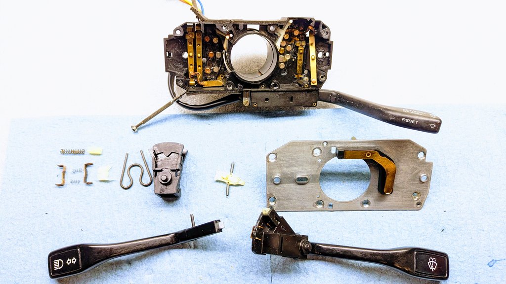

Tantalizing Exploded View
Insides Exploded
Insides Exploded

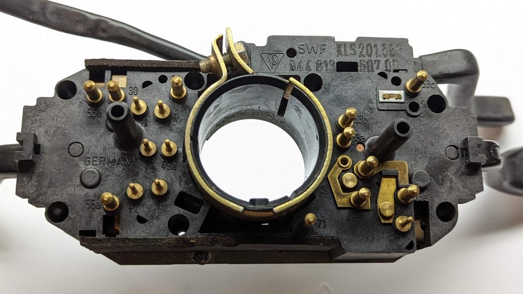

This is the "Combo Switch" from a 1987 Porsche 944. This version has the cruise control lever but NOT headlight washers. I understand the same/similar switch assembly is used on 928's and possibly some 1980's 911's?

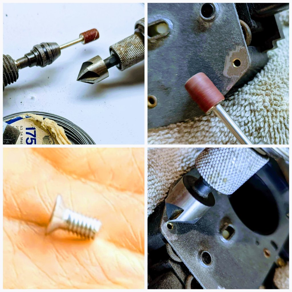

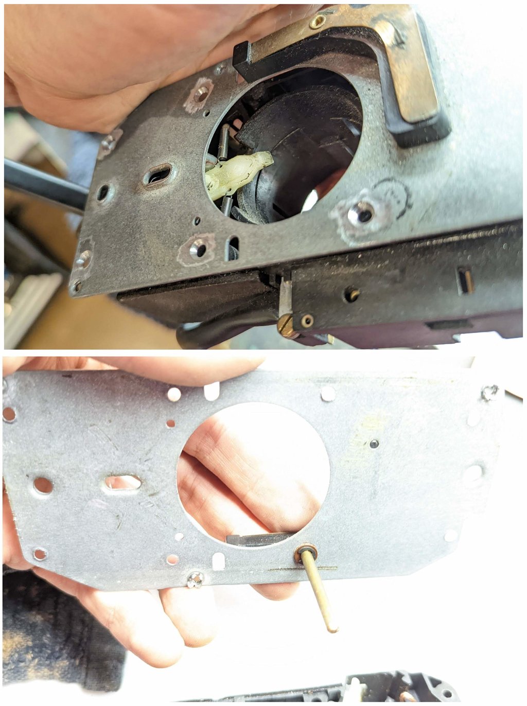

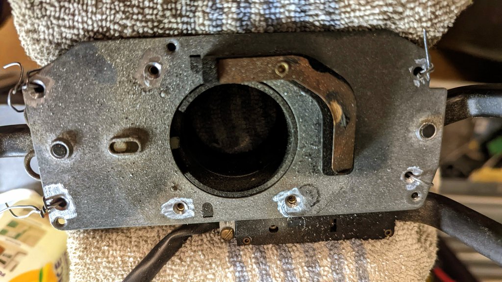

Removing Rivets

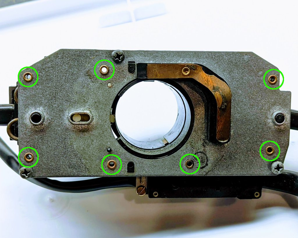

Seven rivets must be removed, circled in green. The three Phillips-head screws are the ones that normally attach the interior plastic cover. They are threaded through their holes only as a way for me to not lose them.
Don't touch the rivet for the horn contact. It is attached to a long brass pin that goes all the way through the switch housing and comes out the back side.
I used a Dremel sanding drum. This will produce fine brass dust. Be certain to thoroughly clean the interior of the switch prior to reassembly. You'll find decades-old lubricating grease inside that ought to be replaced, so a thorough cleaning was already part of the project.
Rivets, before
Rivets, before
Rivets, after
Rivets, after
I chamfered the holes as I went in preparation for reassembly, though you can really do the chamfering at any time. Ultimately I used M4x0.7 x8mm long machine screws with a countersunk heads. I also tapped corresponding threads into the plastic switch housing. This solution is strong and works better that using small wood/sheet-metal screws instead (which I had tried for the first reassembly).
Grinding Rivets and Chamfering

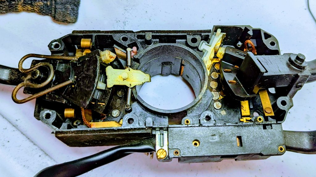

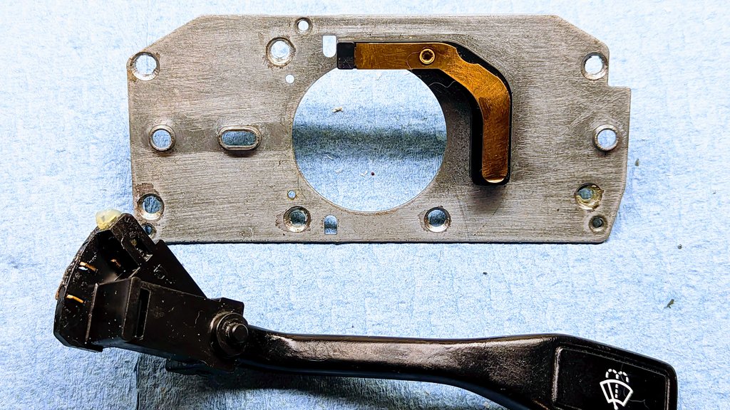

Disassembly

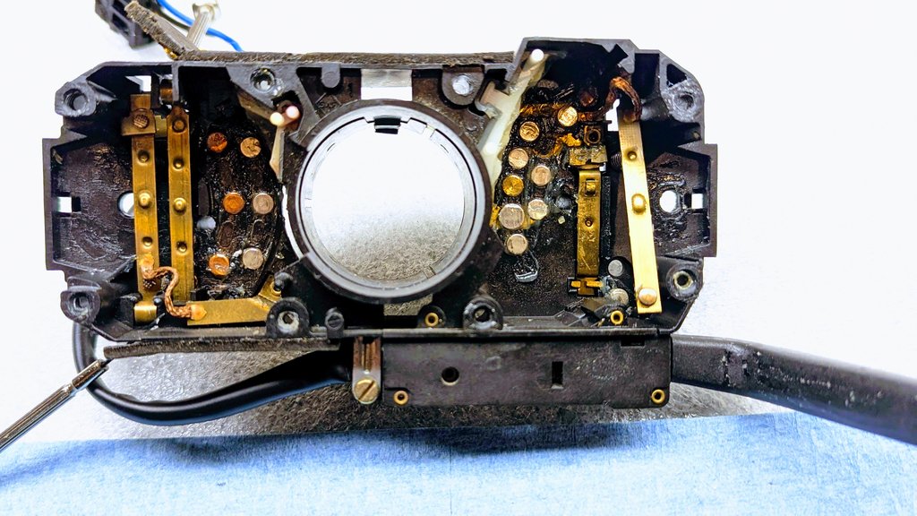

This switch is spring loaded. It will fly apart. I say it has a high "boing factor".
The photo above showing all the rivets removed also shows small wires threaded through a few of the holes. The wires are simply twisted together beneath the switch housing. The wires allow the metal plate to restrain the internal components until you carefully and deliberately intend everything to come apart.
Loosen the wires and start walking the metal plate away from the plastic housing. This allows for the controlled release of spring tension that otherwise would make you look for parts all over your workbench. Take care as the brass pin for the horn contact is quite long. Here you can see the nylon "cancellation tab" beginning to escape, still attached to its springs.
Walk the Cover Off
Walk the Cover Off
Cover Plate Removed
Cover plate removed
Cover plate removed

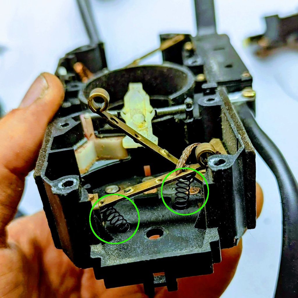

The turn signal side has two brass contact arms each with its own spring. (Those brass contact arms are responsible for hi-beams and flash-to-pass separately.) The windshield wiper side has a single brass contact arm also with a similar spring, not shown. (That brass contact arm does the windshield washer pump.)
Springs
Springs
Inside and Outside Contacts
Inside
Inside
Outside
Outside

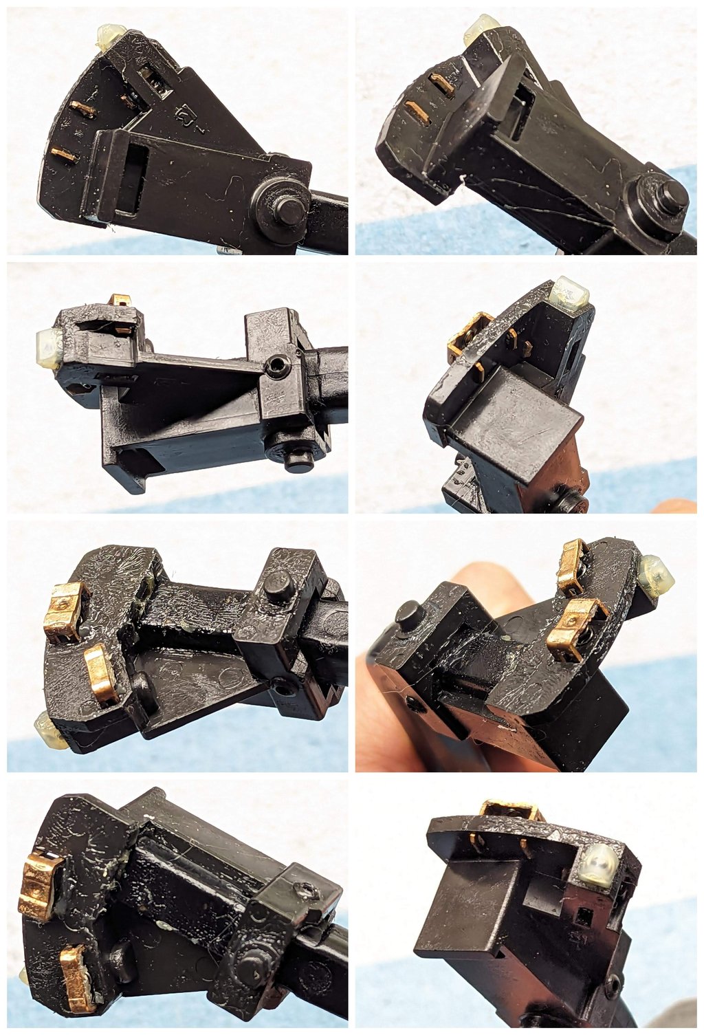

Windshield Wiper/Washer Side
Wiper Stalk
Wiper Stalk
Wiper Stalk Nose
Wiper Stalk Nose

Part 3 of 3
Turn Signals and Hi-Beam Side

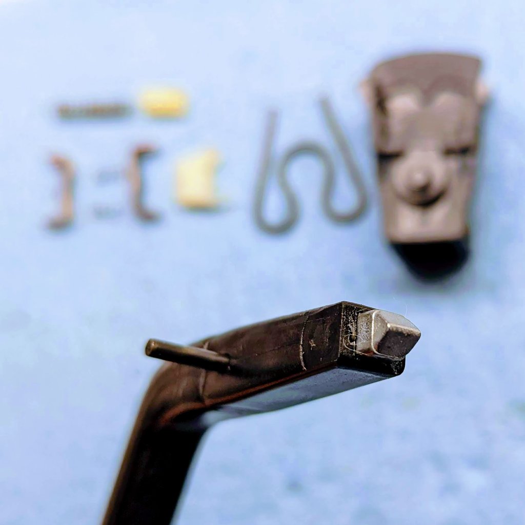

Broken "Wings"

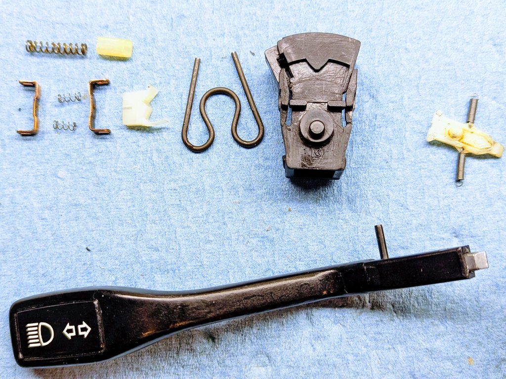

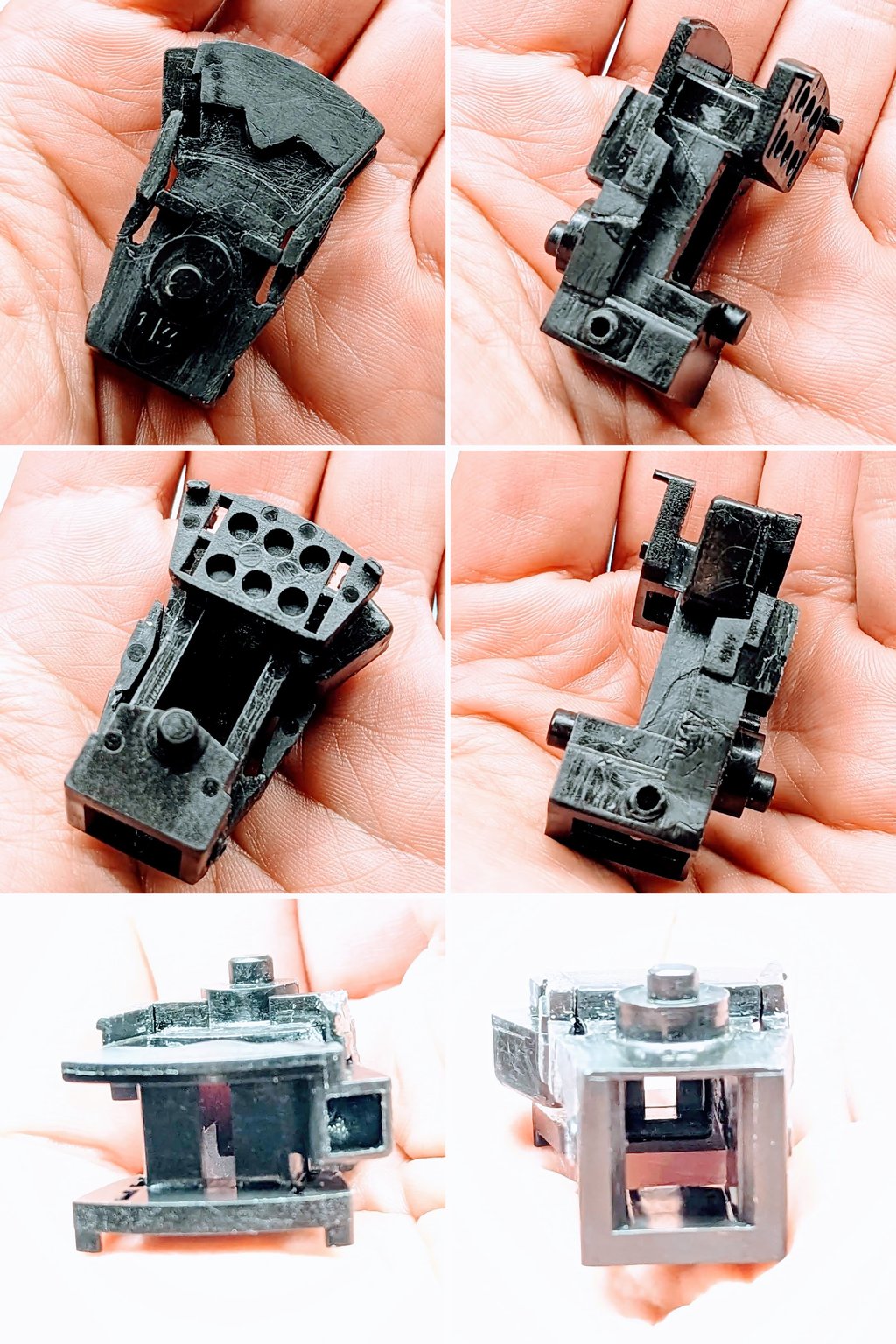

By the time I decided a repair was necessary, my turn signals were no longer consistently latching into position. I'd have to hold the stalk in the direction I was trying to indicate in order for my turn signals to remain on. I think the loose "broken wing" was getting in the way inside the switch housing. This was quite annoying, of course. Naturally, my turn signals couldn't self-cancel if they wouldn't even stay on.
There are little plastic "wings" on the internal business-end of the turn signal stalk. One of my wings was broken, and the other cracked. I found the broken wing wedged inside the switch housing. This first photo collage shows the condition of the plastic business-end part upon initial disassembly.
Broken Wings
Broken Wings
Here is the same part with the wings Crazy-Glued in place. (To be clear, Crazy-Glue is NOT a good way to repair this part.)
Glued Wings
Glued Wings
(I had Attempted a Repair which only "kinda worked"™. In fact, I had so much build-up of plastic in the attempt that whenever I used my left turn signal, my hi-beams also activated. Not flashing, just on. My repair had bumped the "flash-to-pass" contact into action when turning left. Not a lot of clearance inside the switch housing.)
Hi-Beams and Flash To Pass

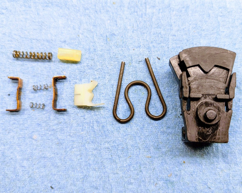

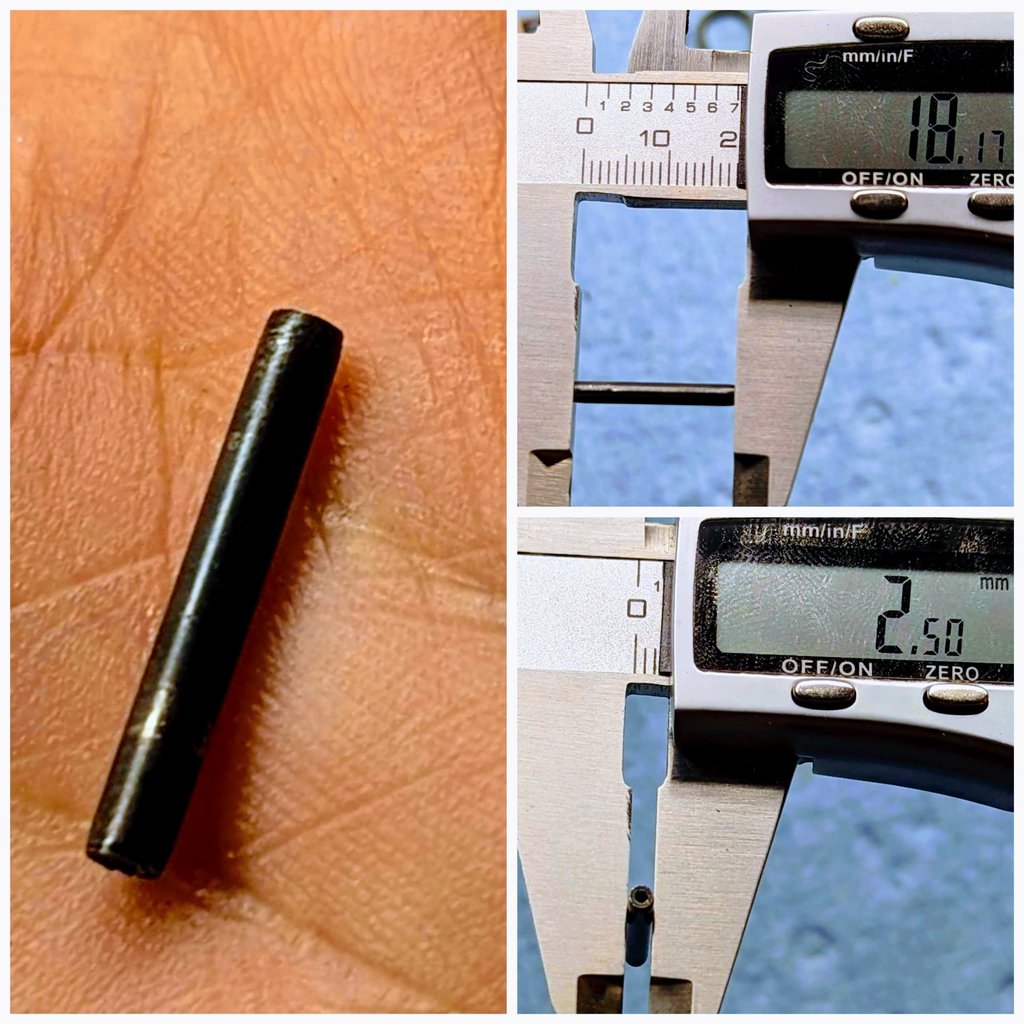

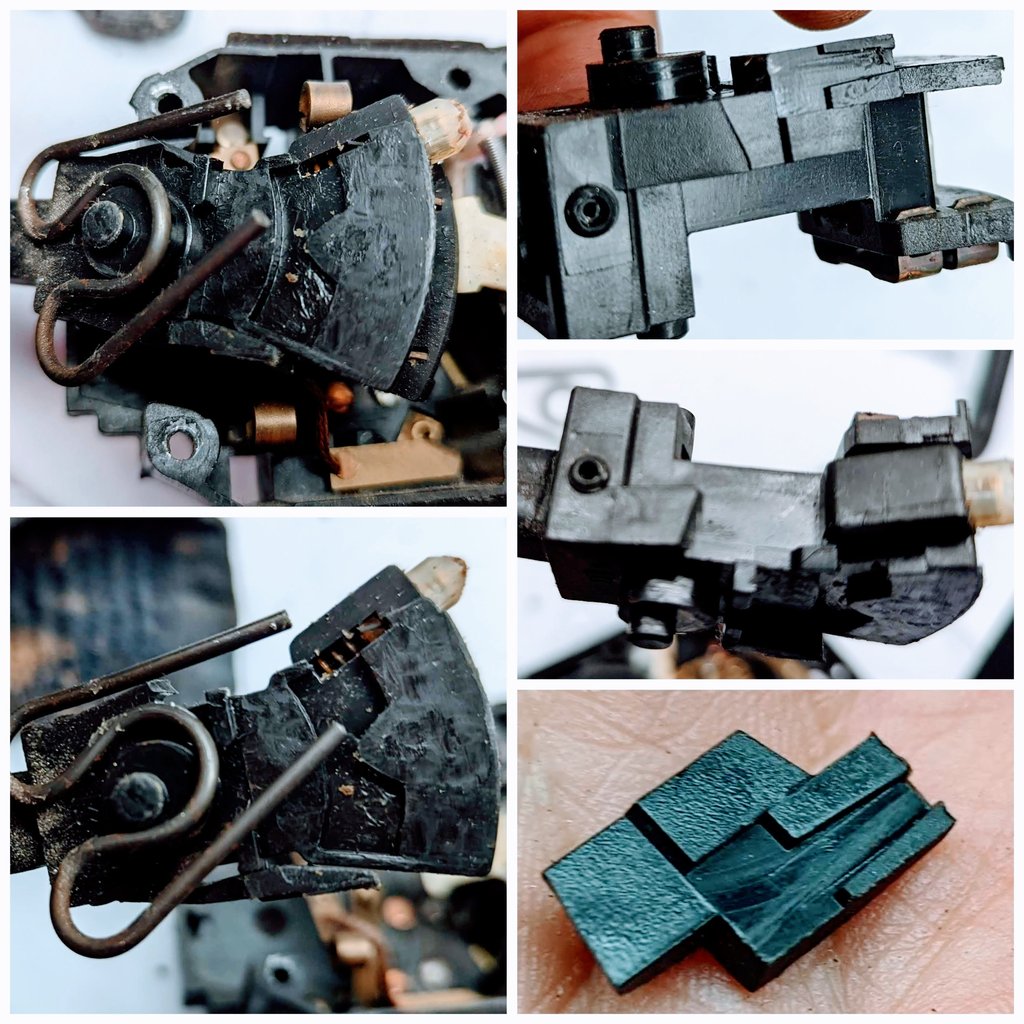

The spring-loaded tip of the stalk itself engages with a separate nylon component that resides inside the plastic "business end". In the first pic, the dowel pin that connects the stalk to the business end can be seen. It could easily be removed and placed somewhere safe so it can be reused.

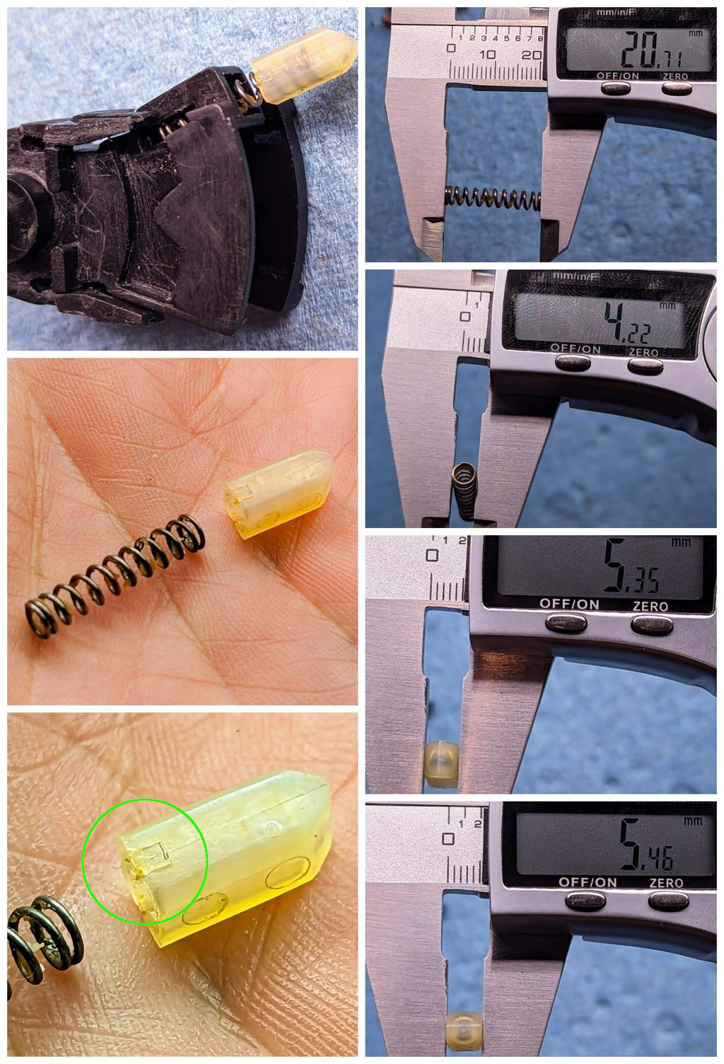

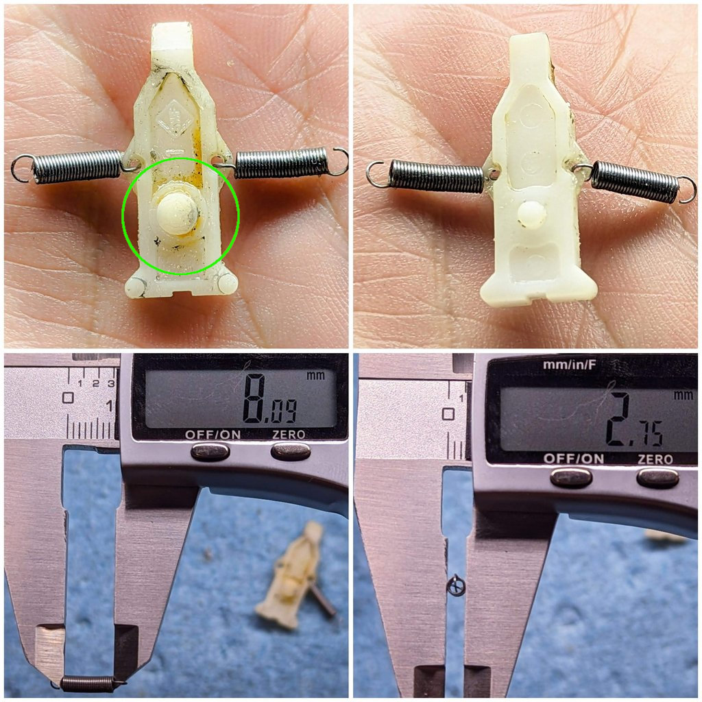

Details and Measurements

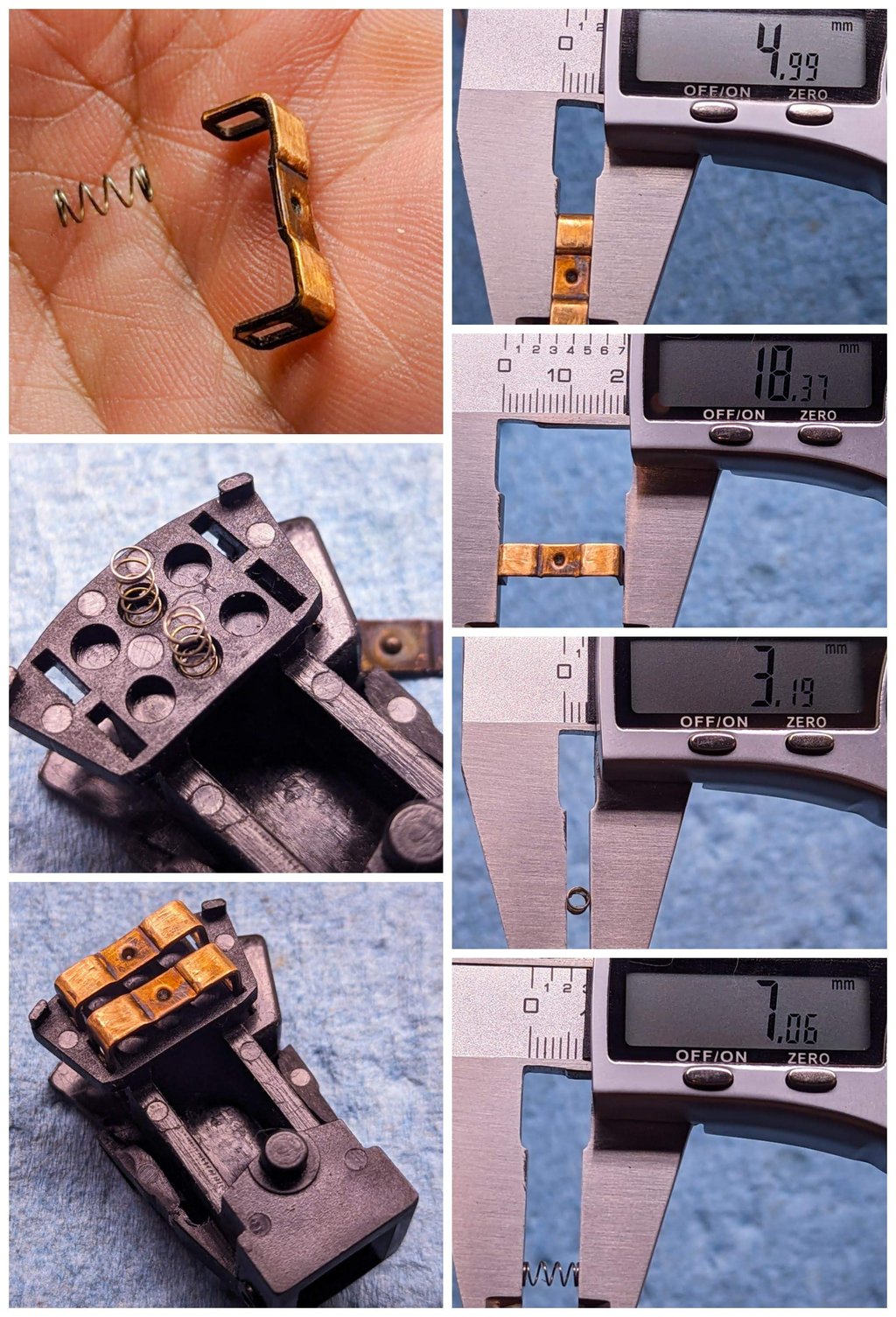

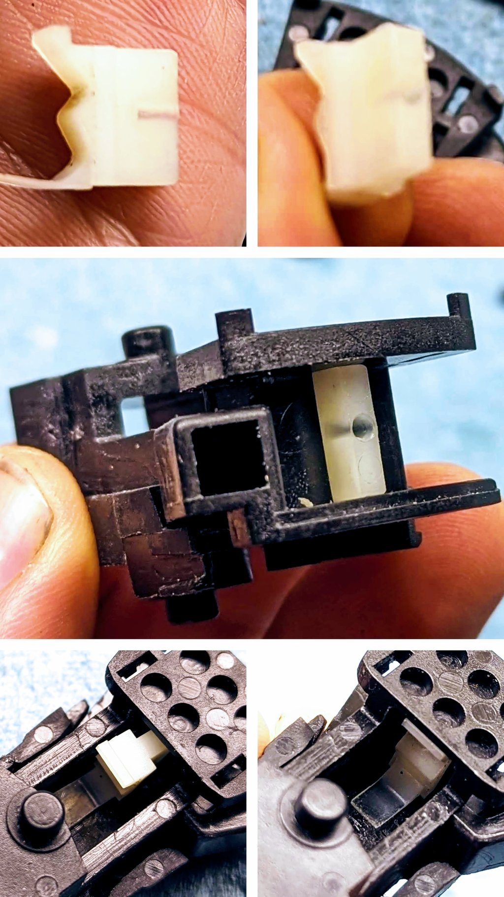

In case you misplace a spring, or find any broken, here are some measurements. The "tooth" (circled in green) that retains the square nylon turn signal latch must be installed in a way that it engages with its slot. The tooth is very small and would be easy to miss.
Turn Signal Latch
Turn Signal Latch
Copper Contact
Copper Contact
Dowel Pin
Dowel Pin
Cancellation Tab
The larger nub (circled in green) must be positioned facing the metal cover plate when reassembling. It engages with an oval notch exactly matching its size. The smaller nub engages with the pocket on the top of the "business end" of the turn signal stalk.
Cancellation Tab
