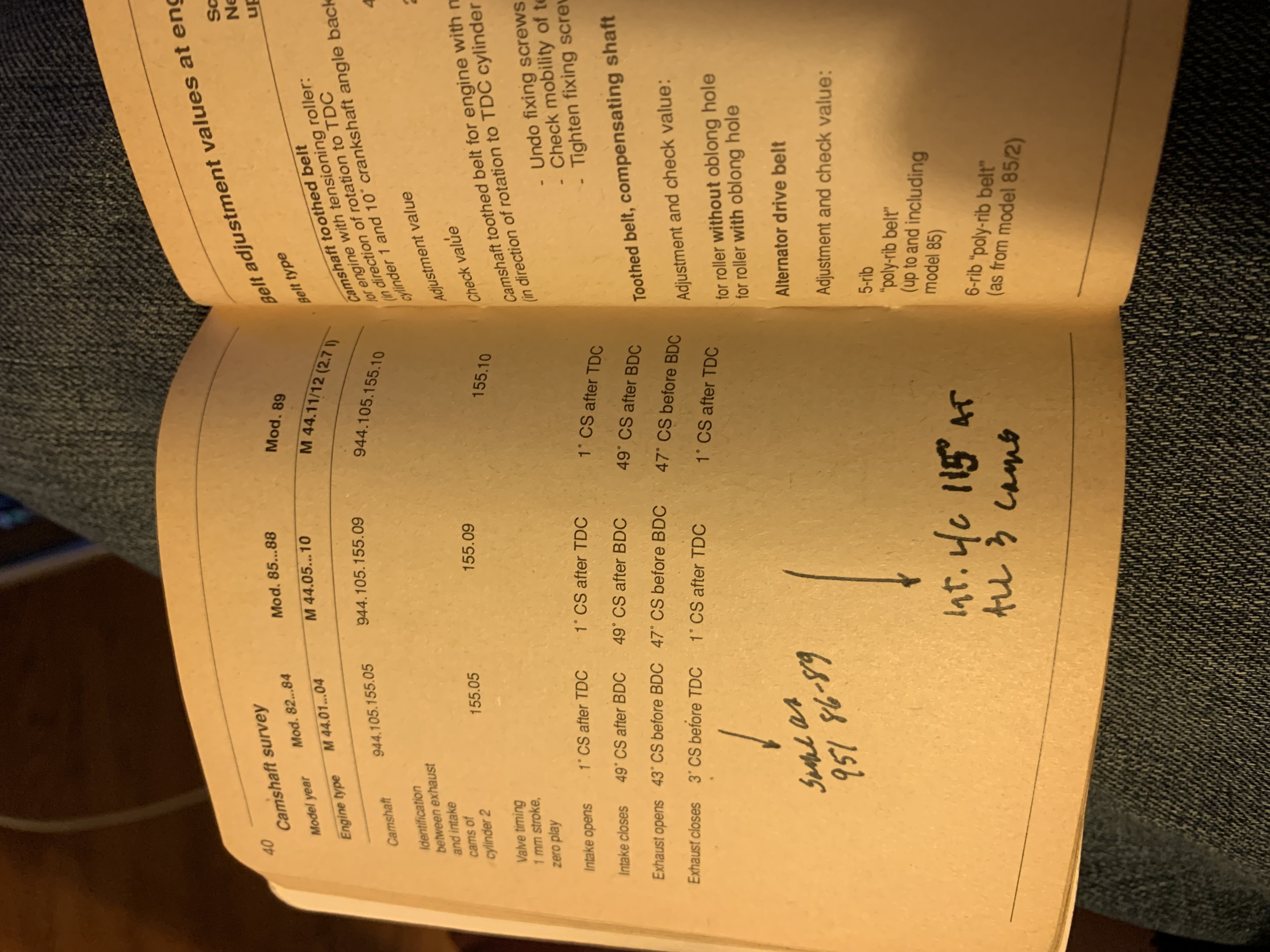

I checked my little Porsche Models/Dimensions/Tolerances book which says the late 944NA 2.5 and 2.7 have the same cam specs, but different part numbers. Go figure. Since the book doesn't provide lobe lift specs, the lift may be different between the 2.5 and 2.7.
The book also says the last sequence of the part number (155.10 for the 2.7) is between the intake and exhaust lobe on cylinder #2. Can someone confirm? Thanks!!

Hoping someone else can help out with identifying a M44/11 (944 2.7) camshaft. A friend in Spain wants to confirm what he has before installing it in his 3L turbo. He can't find identifying marks anywhere on the cam other than the casting number. The stamped number should be 155.10, but it's apparently not between cam lobes on #2 cylinder.
Thank you!

That's a red flag. Is there a spot on the cam that has been ground down? Was the original part number removed?
