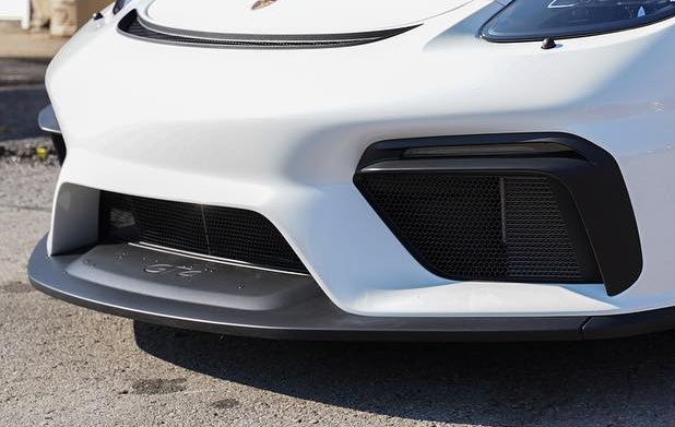

I'm not sure what kind of guards that Supra was running, but my 718 GT4 RS came with OEM grill screens already installed. These look almost identical to the Rennline grill screens I installed on my 991.2. I very highly doubt the Rennline screens will reduce airflow at all.

Are yours the same OEM screens that are on my '21 718 GT4? I've never had any overheating issues either and my car is on track a lot, often on hot days. And yes, it's pushed when on track.marin wrote: Fri Aug 11, 2023 3:06 pm I'm not sure what kind of guards that Supra was running, but my 718 GT4 RS came with OEM grill screens already installed. These look almost identical to the Rennline grill screens I installed on my 991.2. I very highly doubt the Rennline screens will reduce airflow at all.
PS - this pic was when the car was new...it's a little funkier now.
