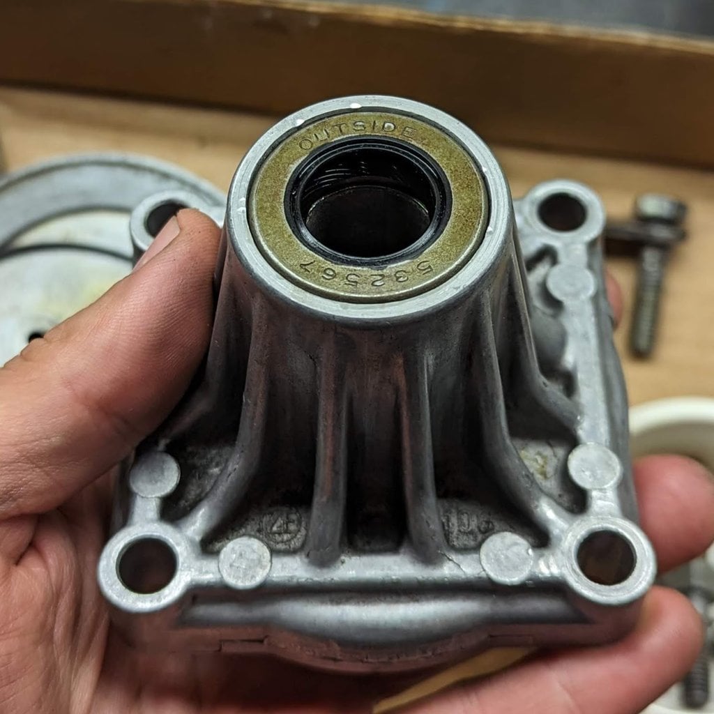

How far am I supposed to seat the shaft seal? This is where I have it right now, flush with the "nose" of the pump body.
PS Shaft Seal

I know Rennbay does have a YouTube video of the pump rebuild, but it's tough to discern given the 240p quality. The presenter tapped the seal into place without using a socket to drive it in. However, he says to make sure the seal is "seated completely", whacking it with the side of a screwdriver handle.
I did replace the pump seals (the hourglass-shaped one, as well as the shaft seal) about five years ago. When I did the shaft seal, I must have seated it completely with an appropriately-sized socket because it was about 2mm deeper than the outside face of the pump "nose".
When I removed that 5-year-old seal just minutes ago, I noticed there is a rectangular port beneath it, presumably for circulating fluid to lubricate the shaft. (I made sure the internal passage was clear by blasting it with compressed air.)
Perhaps the "seated completely" seal was partially blocking that port, leading to the Sucked Into the Ports problem I recently posted about.

So, first, how far do I drive the shaft seal?

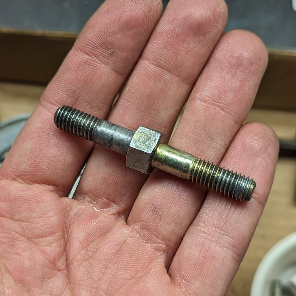

Second, there is one double-sided bolt (above) that attaches the two pump halves - which half goes into the pump and which half goes out? The "halves" aren't equal, so they aren't technically "half", but you get it.

So, how deep should the PS pump seal sit?

Re seals, I drove mine in all the way on the pump, but in general with that type of seal, I try to position them on the cleanest (least worn out/grooved) portion of the shaft.
Re the stud, I'd bet a nickel the side with the grease and no gold/yellow is the side that sticks out into the elements.

Tom wrote: Sat Aug 05, 2023 7:16 pm Re the stud, I'd bet a nickel the side with the grease and no gold/yellow is the side that sticks out into the elements.
Now that you said it, seems so obvious. :D
