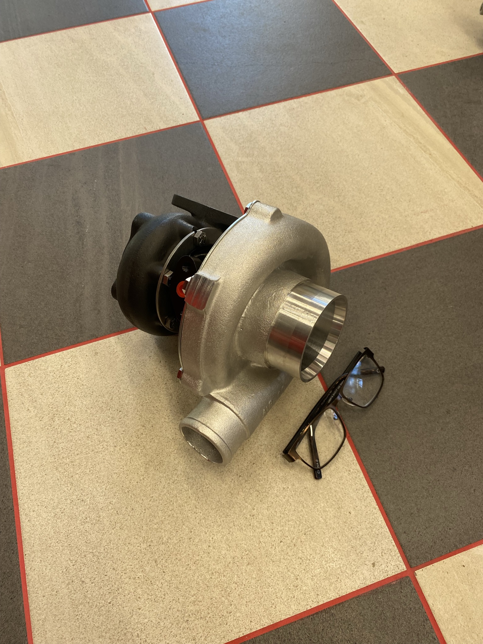

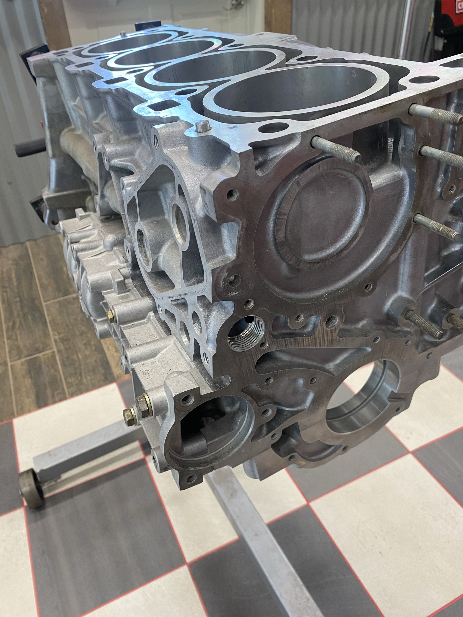

In California, we have smog constraints that create a real challenge. The car not only need to stay under the prescribed limits at the tailpipe (some of which are lower than when the car was built), but the bigger constraint is that the car must pass the "visual" inspection -- meaning most noticeable mods won't "pass smog" even if pure oxygen is coming out the tailpipe. That's why 8 valve 3 liter motors are a popular choice here -- since they can outfitted to look bone stock. I have a new motor I've been threatening to build forever, mostly Heritage-prepped machine work/head/block, and Vitesse turbo/MAF etc. My existing motor has been plugging along just fine for 12 years and 30k miles, but as you say, hoping to step up the tech a notch. I actually pulled it out the other day to size up the build...
Block prepped by Jason Lee several years ago. Note the port for the main oil galley. Jason believes there's no way to get it clean without opening it up and getting in there.

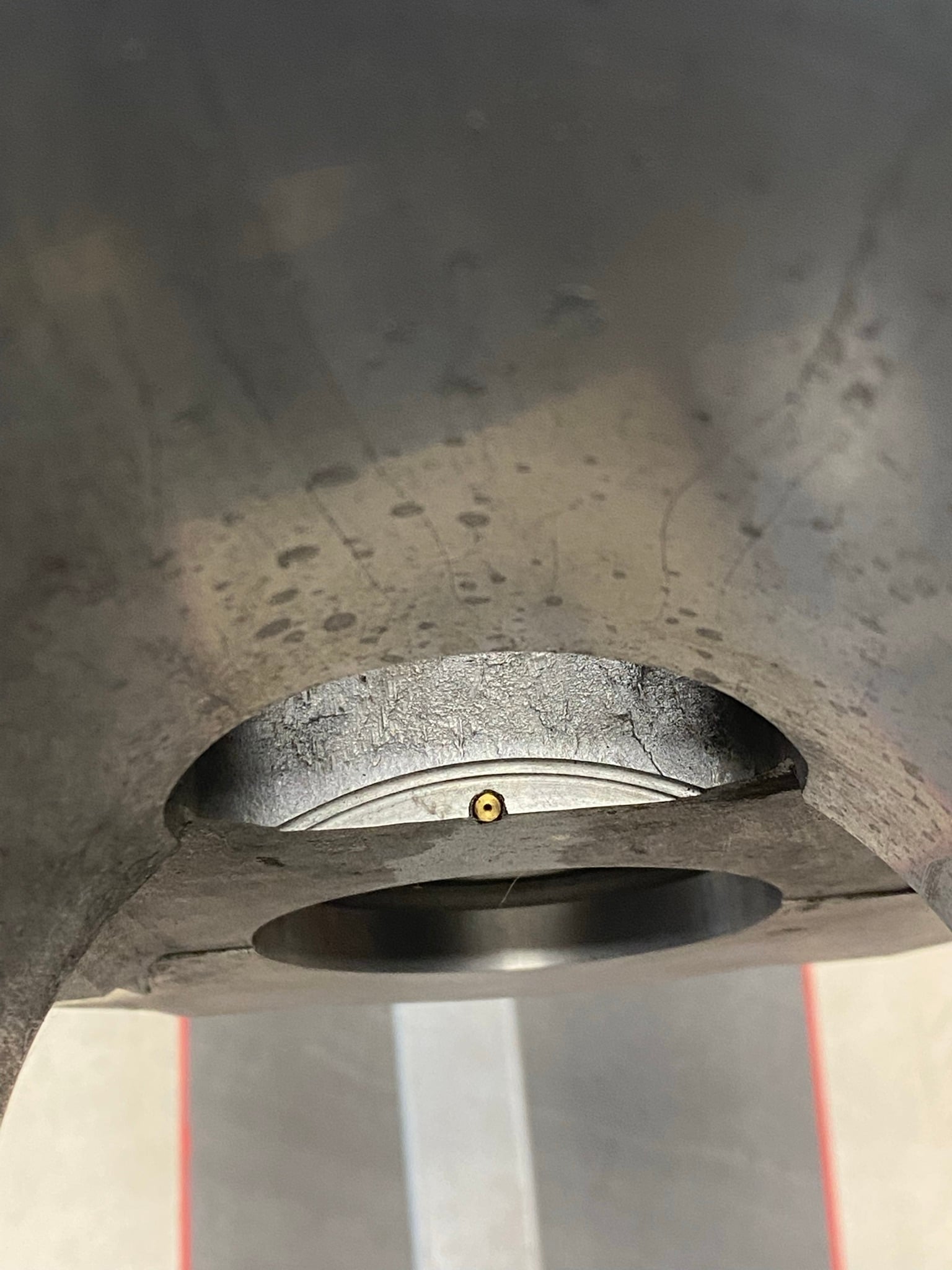

Oil Squirters!
Vitesse turbo.
