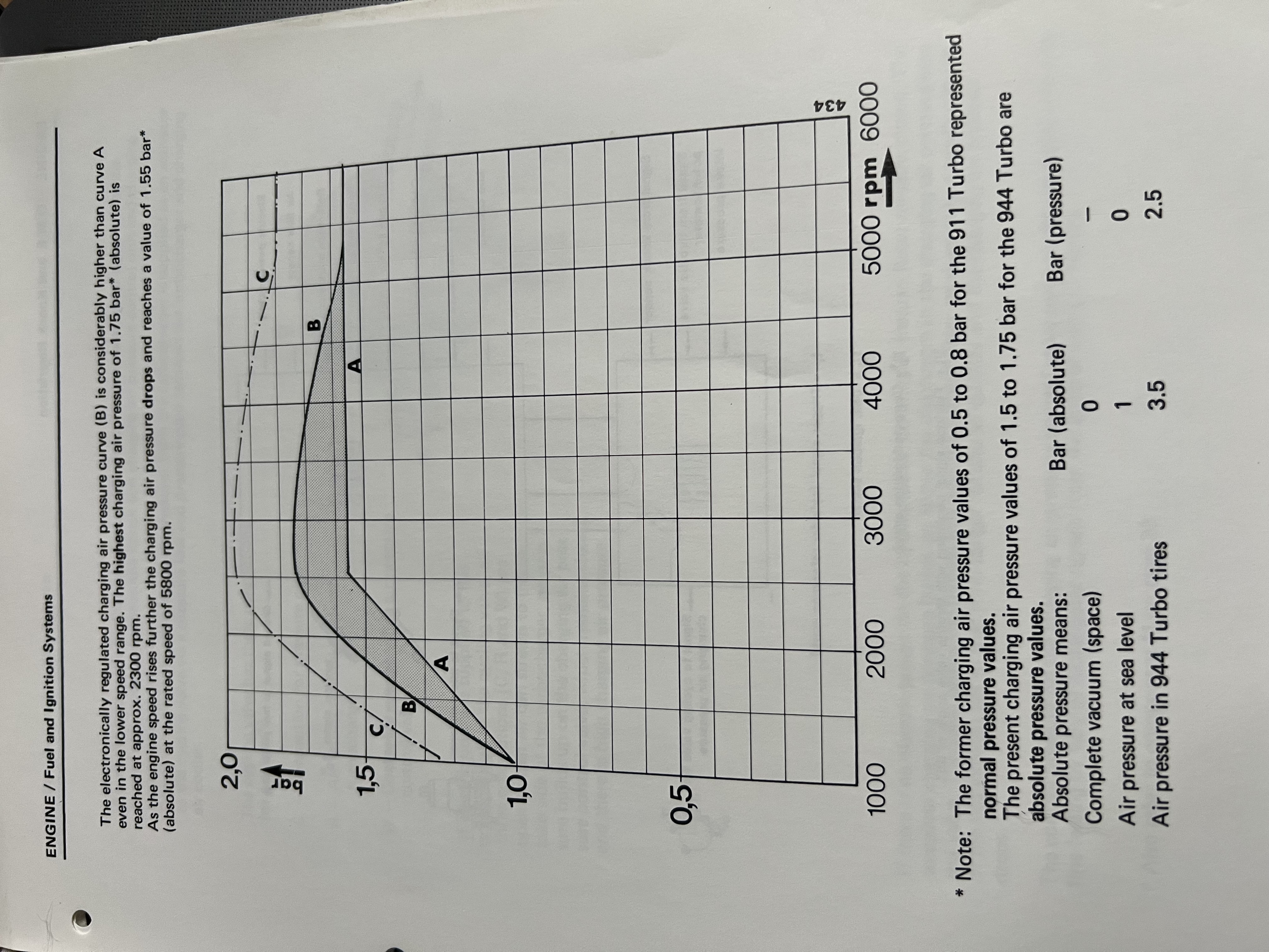

See the attached image from Porsche's original Service Information Technik manual for the 951----Porsche purposely regulated the boost curve to provide a smooth increase in torque rather than a sudden spike.
If you install one of the Lindsey Racing "boost enhancers" or upgrade to a dual-port wastegate with proper electronic control, the boost will build as quickly as possible and provide that 1980s turbo rush that you are accustomed to.

Q: What is the curve labeled 'C' depicting?
