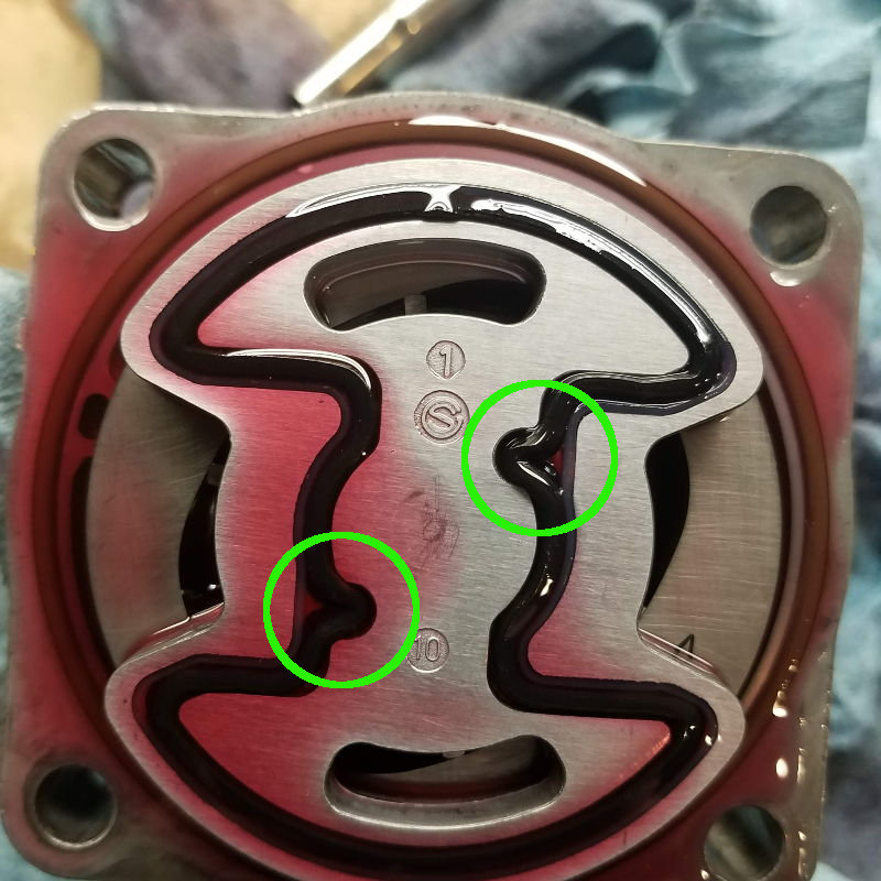

While I had the reservoir removed (and the fluid drained), I took the opportunity to inspect the internals of the PS pump. I had replaced the seals in 2018 and posted about a "groan after rebuild" on RL. At that time I discovered that the new hourglass-shaped seal had been sucked toward the little openings.
The same was true now in 2023 (circled here in green)...

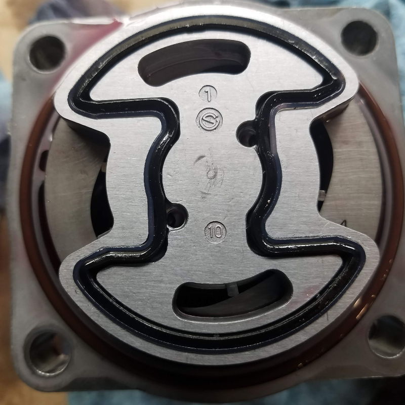

This is how it's supposed to sit.

The PS pump is currently quiet and operating normally. No leaks. No noise. Nothing unusual.
My working theory as to how this happened is this...
  • PS Reservoir has restricted flow due to gunk in the 250k mile filter
  • In lieu of a constant supply of fresh fluid, PS pump sucks the hourglass seal into the ports
  • Ports get blocked by seal further starving pump of fresh fluid
  • PS Pump groans
Anyone else have ideas?
and Wrench Warrior
Seattle, Washington, USA
Posts: 8923
Has thanked: 932 times
Been thanked: 3991 times
Did you confirm the old reservoir was blocked/clogged? Pour a little fluid in and see if it flows out normally? If it was clogged, your theory sounds good to me...

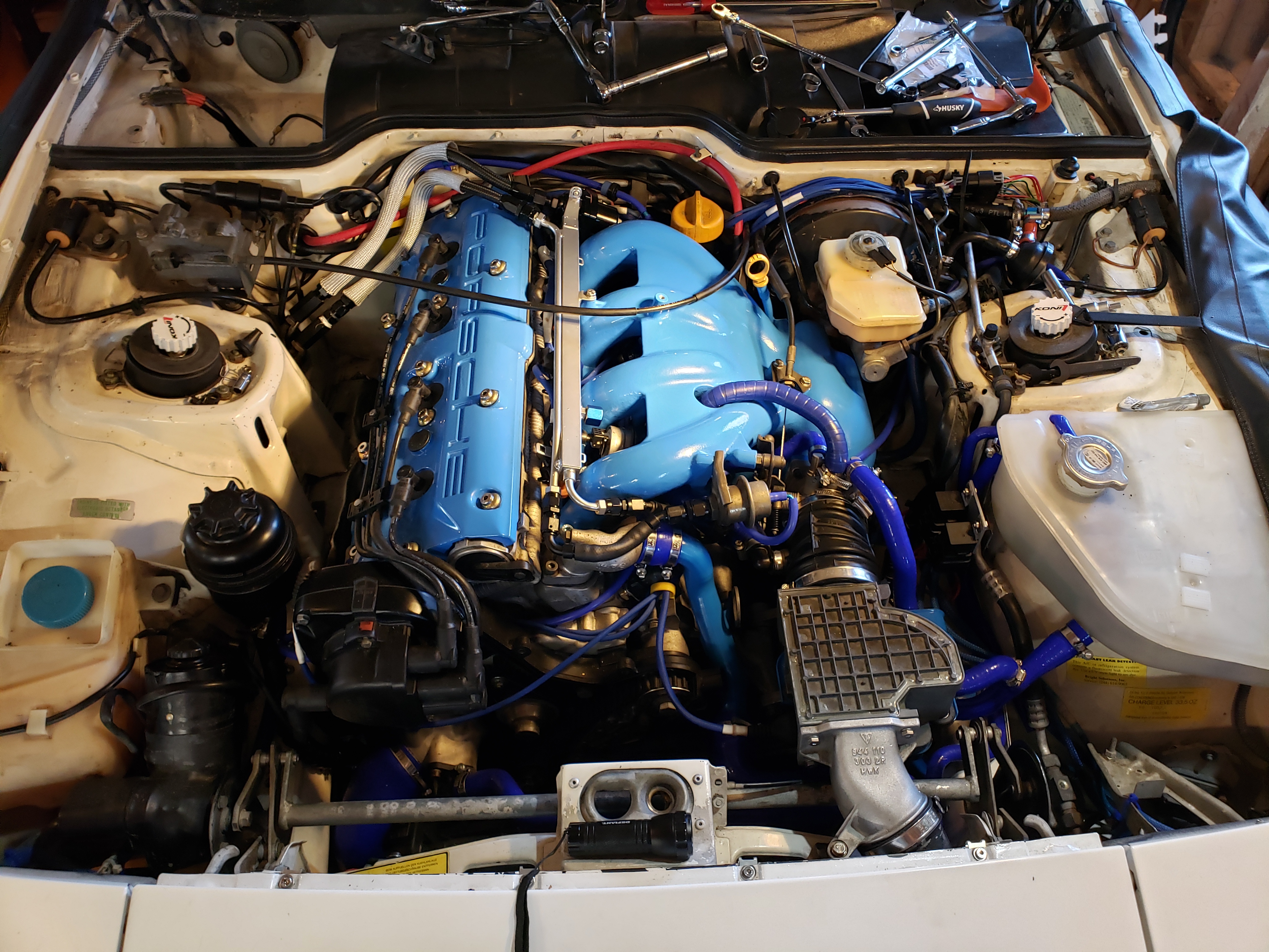

Zirconocene wrote: Wed Jul 19, 2023 9:03 am At some point we'll have to have our engine bays open together; that color scheme in yours is very similar to what I have going on in mine. (I'll post pictures later, but it's a funny coincidence)
Some engine compartment p*rn (taken last fall when putting everything back together)...

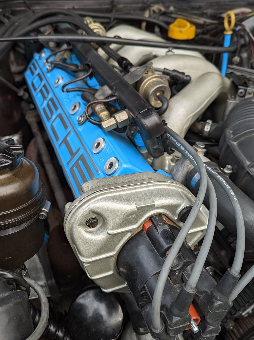

Unrelated, but here's an older picture of my engine bay. I'm pretty sure the only update since then is new blue spark plug wires.
Jinx!
