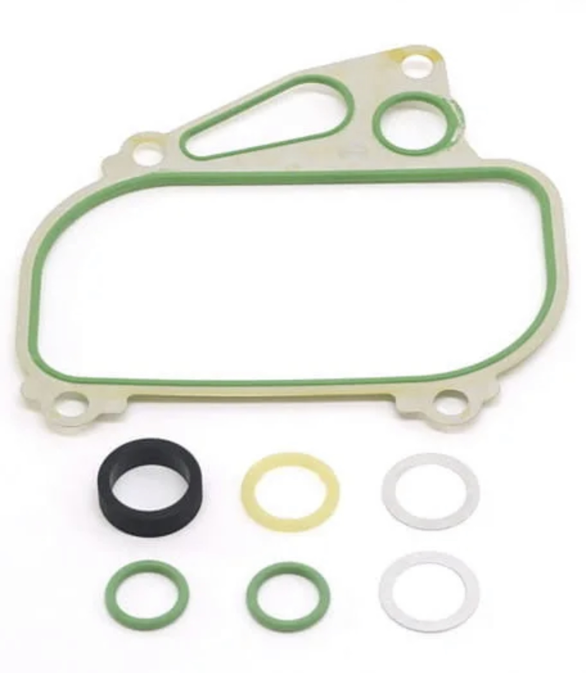

The oil cooler seals are probably leaking internally given your symptoms. I wouldn't drive it with water in the oil -- too hard on the bearings and such. I'd probably just change the oil cooler seals and hope that fixes it. No need for the external oil cooler unless you want one independently of this issue. Much easier just to change the stock seals than trying to work out all the details of an external cooler. We have a detailed how-to on changing those seals on a Turbo. Process is fairly similar on the N/A...

Dang,if it's like my s2 I battled this same issue for a number of years.The s2 has oil/coolant exchanger on the right side of the engine block, so in between the block and the cover the there is a sheet metal gasket that has "O" ring seals in it which do fail with age.Porsche over the years came out with a number of different "O" ring materials sold as the a complete gasket with the sheet metal ect. ect..Some were red, some were green & some were brown.

i think the s2 like stig said has an external cooler and mine the 1985.5 has an internal cooler so ill try the replace oil cooler seals trick and hope it works

I don't know what year you have but I would definitley do the seal change. If you have an early model with the old 3 piece OPRV, make sure you use an alignment tool. This is a very common repair for these cars.
