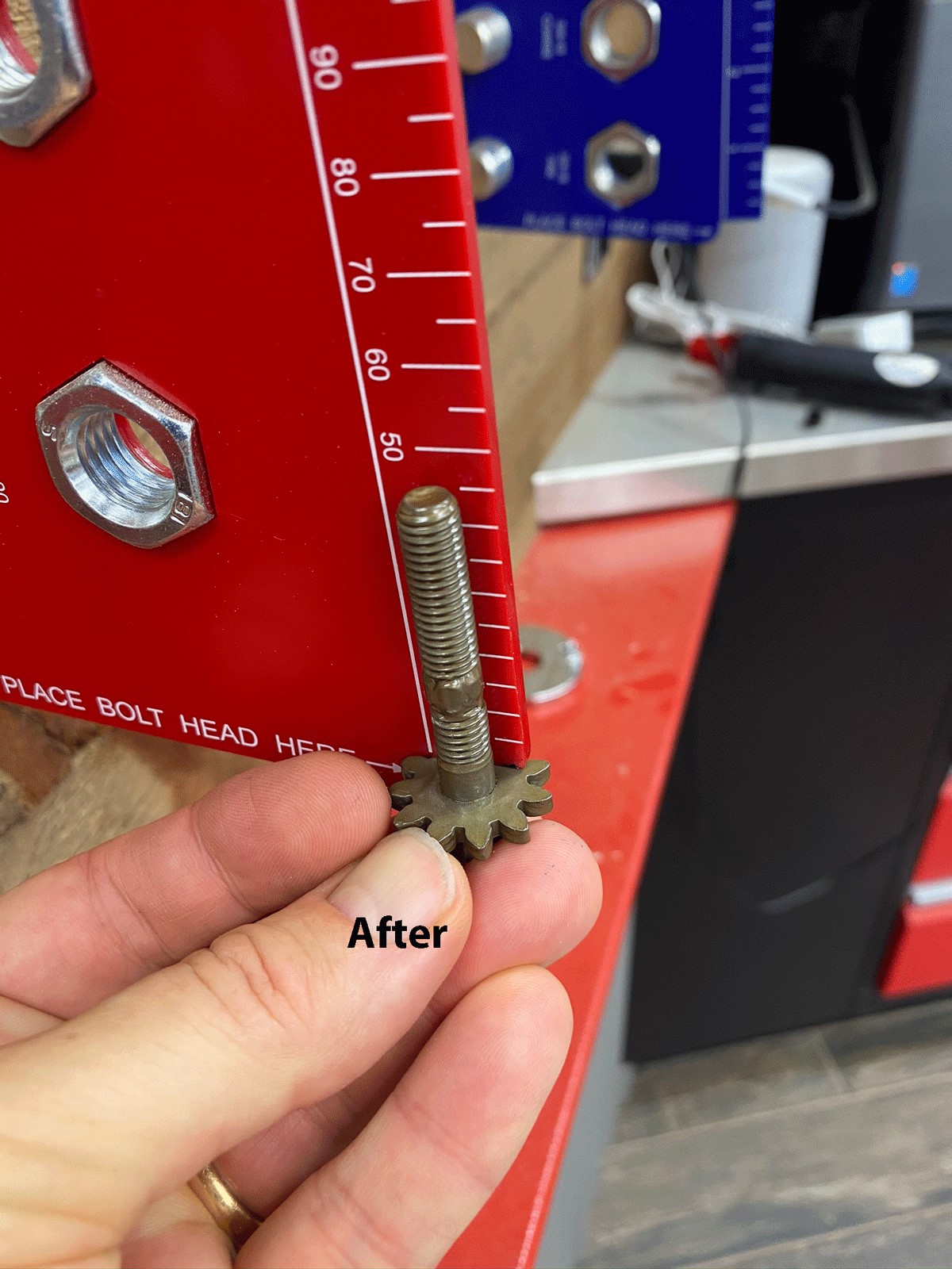

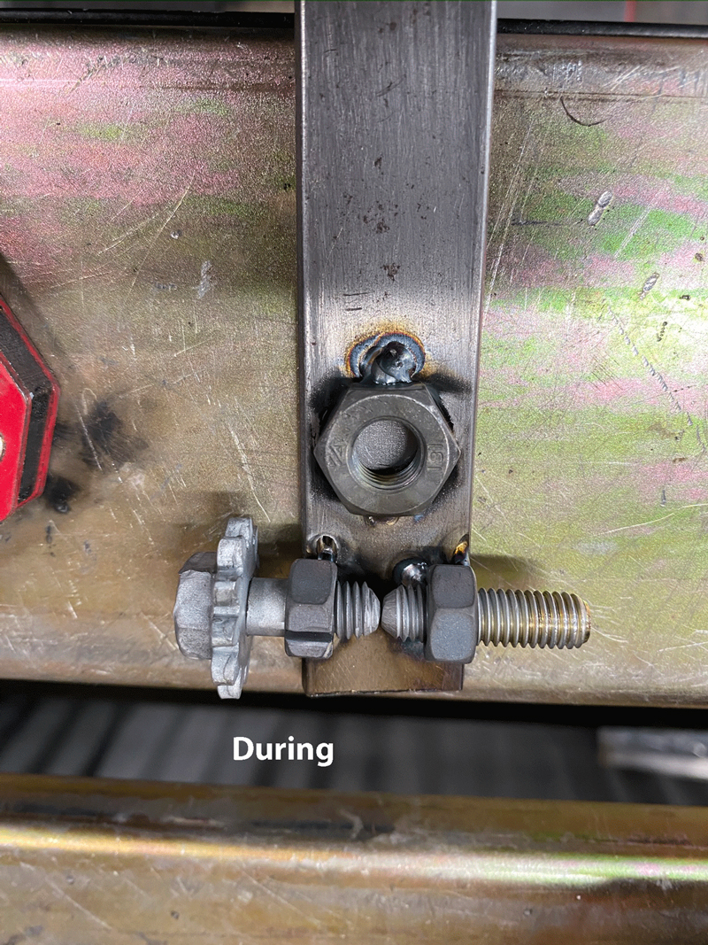

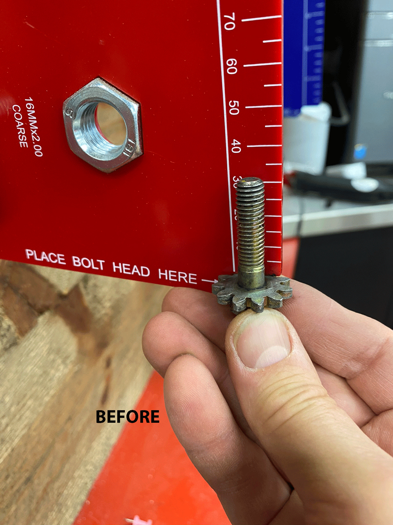

Wish I could help with the part numbers, but in lieu of that maybe I can inspire you to modify yours with these pictures. I have an old Mercedes. After MBZ updated the power steering pump on that car, the little adjuster bolt wasn't long enough to fix anymore. As best I could tell, they never made one in the size needed. So I did this with the original one. I made the fixture in the middle to make sure the bolt remained straight and true. That was several years ago and it's been fine ever since. :angel:

That looks like what I may have to doubt my mod will be much easier than yours for sure - no threads. I just need to insert a short piece of welding rod.
