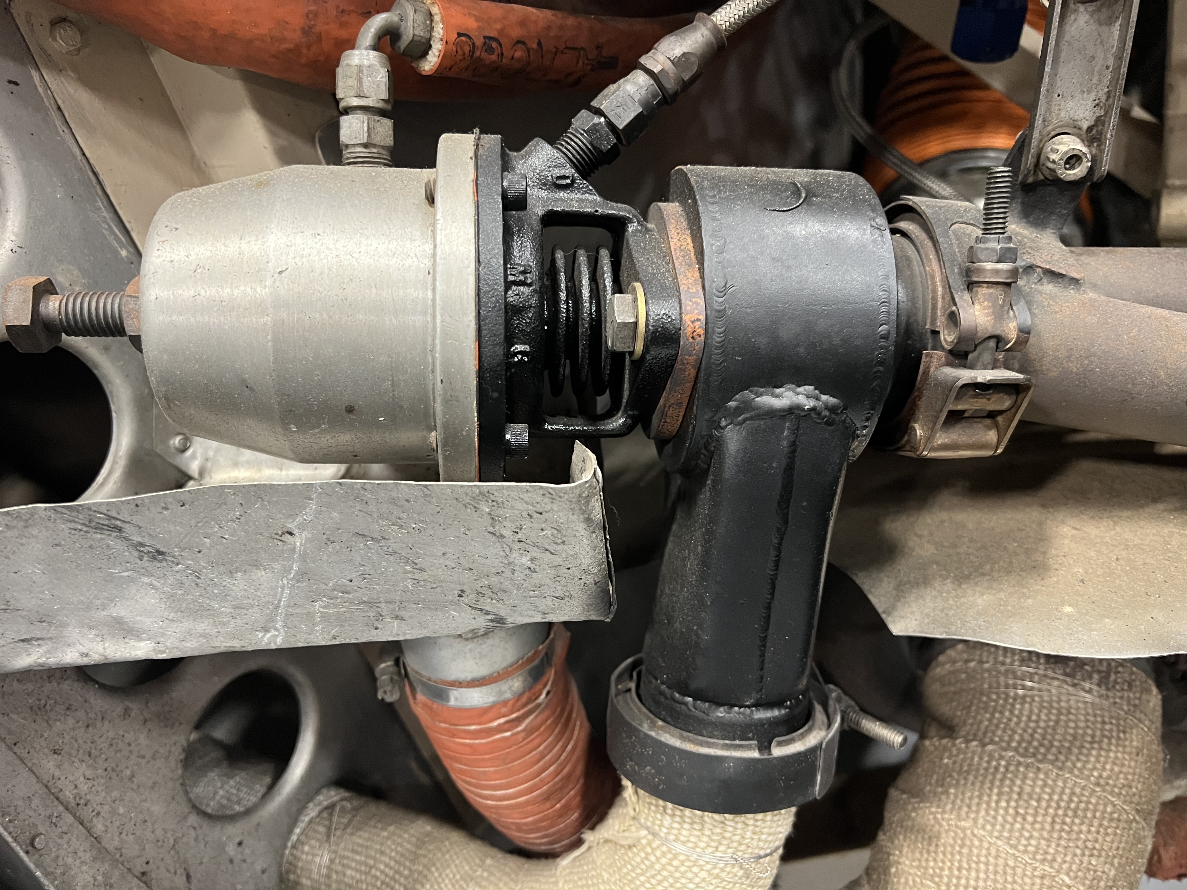

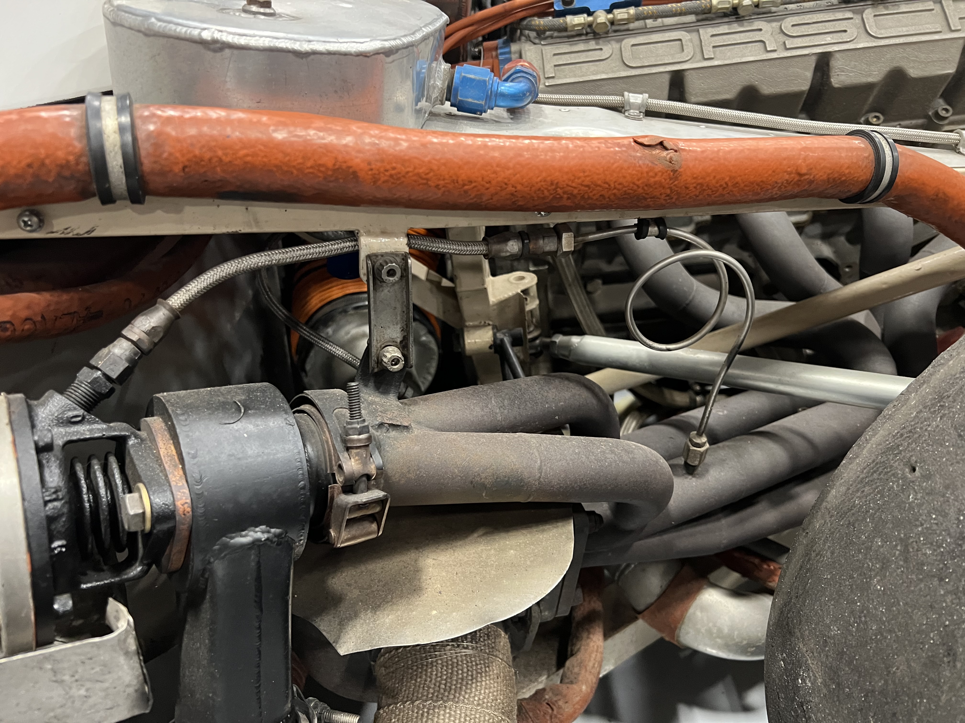

Here is one the mist interesting things on the 944GTR.
The wastegate is referenced to the exhaust pressure and not the intake pressure……interesting
No idea why!
Interesting wastegate setup

It makes sense if the boost to backpressure ratio is close to 1, which may well be the case on such an optimised engine.
A friend has now a higher boost pressure than exhaust back pressure, on a different type of engine though.

Yes, that is very forward-thinking for the time. Porsche was aware of the issue in the days of the 951 as they specified stiffer exhaust valves to counteract exhaust back pressure, but the agricultural triple-K turbochargers and constraints of production and spool-up requirements meant they had to live with what they had.Thom wrote: Sun Jan 29, 2023 1:50 am It makes sense if the boost to backpressure ratio is close to 1, which may well be the case on such an optimised engine.
The 944 GTR appears to have very "tuned" exhaust headers in addition to the ITBs and probably quite aggressive camshafts. I wonder what sort of wastegate spring would have been required for such a setup. Would be quite cool to pick the brain of the designer.

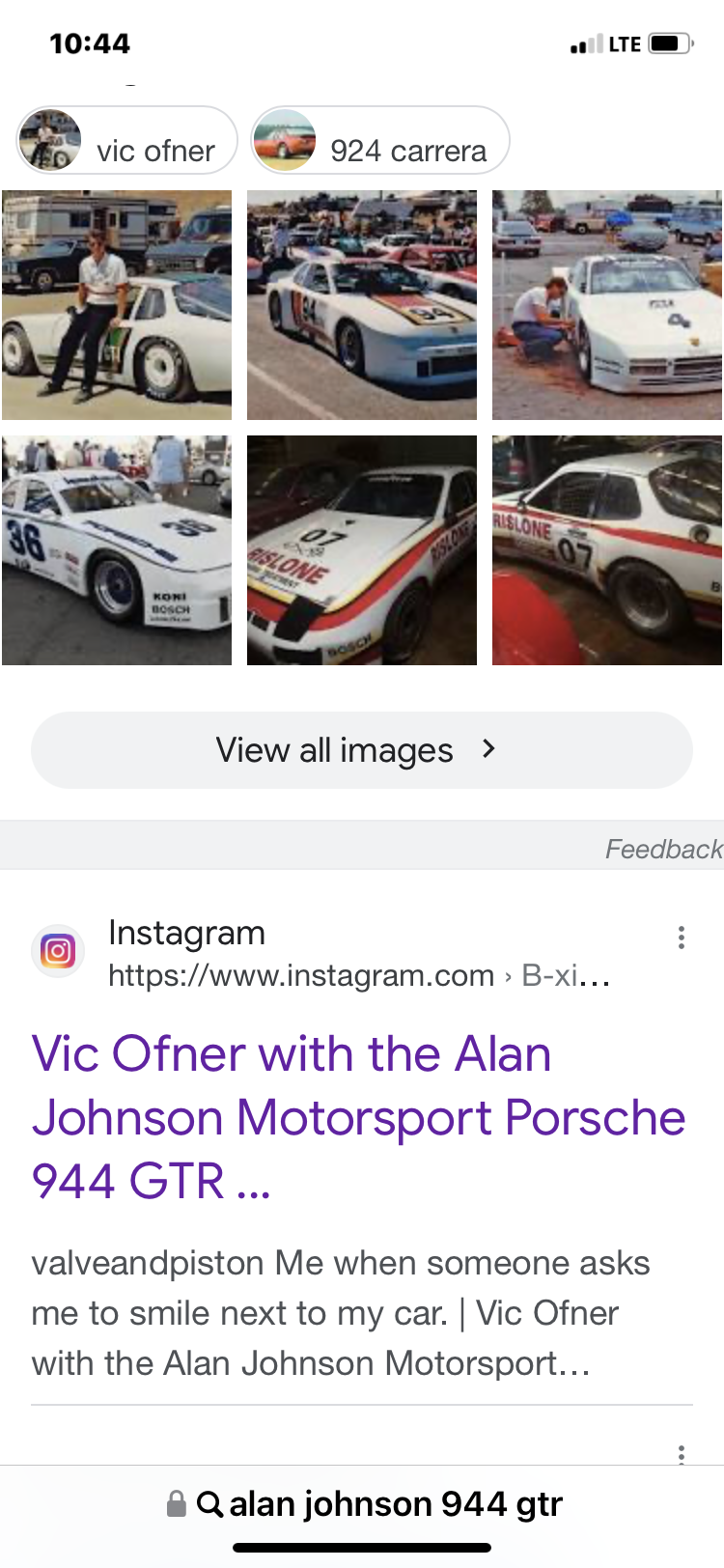

Here is the link to the Alan Johnson GTR I have mentioned in past posts.
As far as I know I am the only person that used their chip in my 86 944 turbo back in 1993-95. MCL Porsche in Vancouver got it for me.
Tom not sure if you came across this in your research for you article.
I was just searching for information on the chip I once had.

Yes, I actually spent an hour on the phone with Alan Johnson. Good guy. He was not a fan of the car -- hated the transmission. I still have a transcript from that call (and other racers). Piecing together history from a old memories like this was interesting, since everyone witnessed/remembered events from their own, sometimes limited, vantage point. My guess is that chip was done by (or for) Andial, since the original McLaren-prepped motors used a Kugelfischer mechanical injection system.
