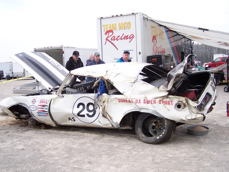

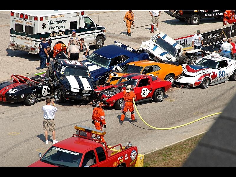

I say at least $3000 to do it well. It has to be measured with you in the car. You'll need a HANS to work with a good helmet and a fire suit (all required here for insurance reasons).
The helmet with the HANS will mostly keep you safe. I've hit hard twice in track/racing events. It hurts and bruised my tail bone once.
Don't kid yourself that it will never happen to you. It's a good probability that it will with the speeds of a Porsche. You are a great driver but the car in front of you can spin. You are going 120 Mph.
I've seen more bad wrecks than I can explain:
Here was Road America:

The second image you posted is at the top of the front straight rise at a vintage race at Rd America in 2005, a crash that's been pictured everywhere over the years. That pic is a bit sensationalist imo. However, you're correct that crashes are part of racing. Track days on the other hand, while not without risk, are not nearly to the level of wheel-to-wheel. The same for HSR where many drivers tend to run below 100%. Too much money and value in the cars on track. Plus it's the gentleman thing for vintage car racing.
